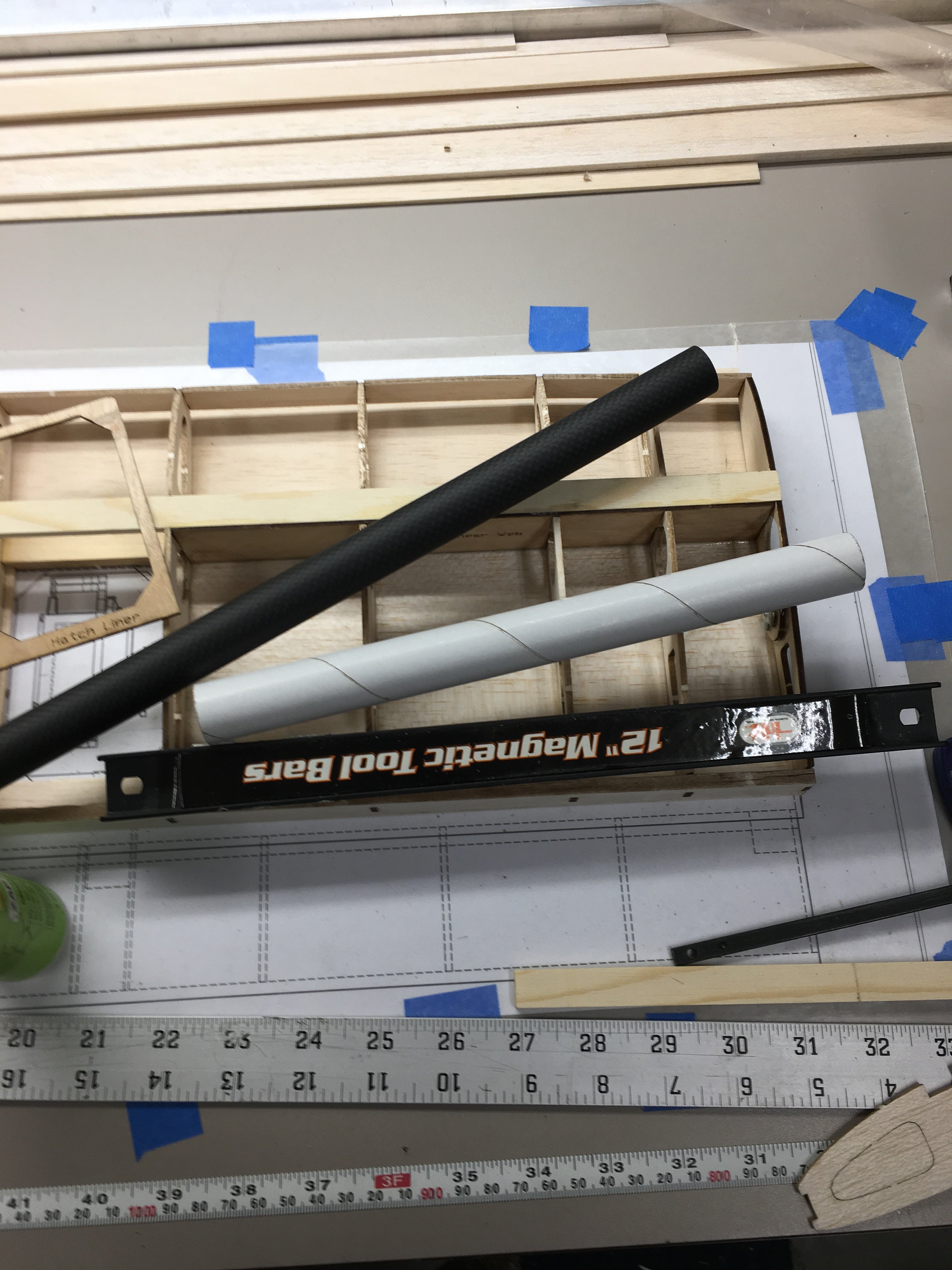

I was going to buy a couple of these. Some of the building methods are genius, but there needs to be a bit more clarity. Hopefully after more people build and comment on them the techniques will be improved a bit.
I was excited to keep going quickly, but I need to slow down to comprehend the steps better. There is hope for MMW. We’ll see as I continue to go further

Question. To use the cardboard wingtube sleeve or make a glass one or buy one?
