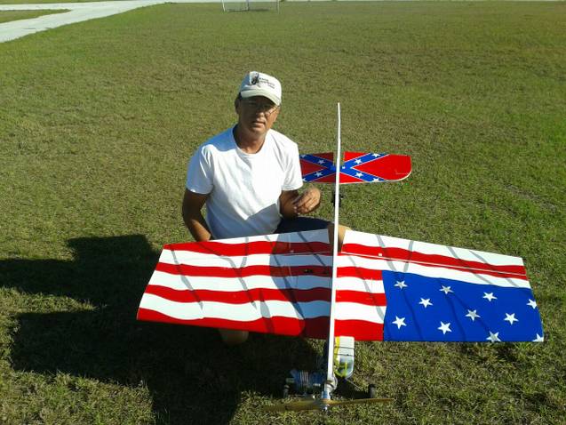

I ran an RCGF 26cc beam mount on this one for a number of years, the beam did need widening slightly during the build. Was a great little engine and even better after the Bowman ring install.
