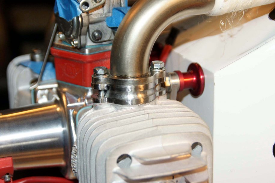

. Sometimes my neat ideas don't bear fruit...at least on the first pass. Case in point - if you noticed on the 1st pic in my last post you'll see some lovely 1" aluminum exhaust extensions. Well, I happen to already have headers, but they needed 1" more drop to fit better in the Krill.

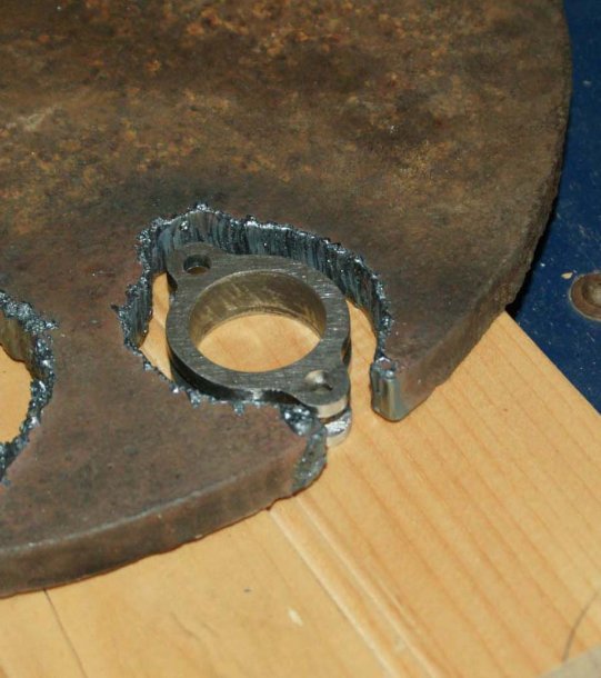

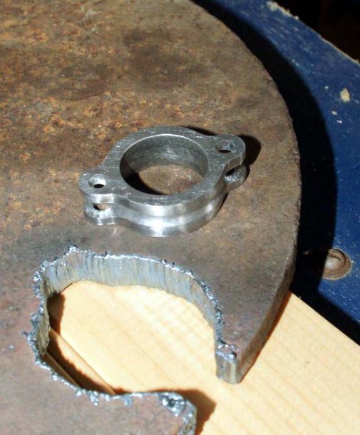

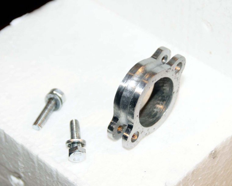

So I thought, gee...I have some 1" thick steel plate...I'll just drill a hole, cut them out and whittle (if that's a word one can use for steel) them down to what I need.

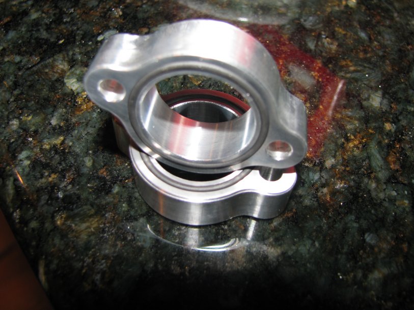

So.....out came the drill press(to drill a 1" hole), cutting torch, grinder, files and lots of elbow grease to create one of them. I think I spent 1/2 of a day making just one. Only THEN did I decide "screw this" and did the proper thing...contact a friend, Steve Siedlecki and had him machine 2 of them out of aluminum, with nice Viton O-rings (last pic)! Anyway, it was yet another learning experience....and I'll keep the steel one on the shelf as a reminder
