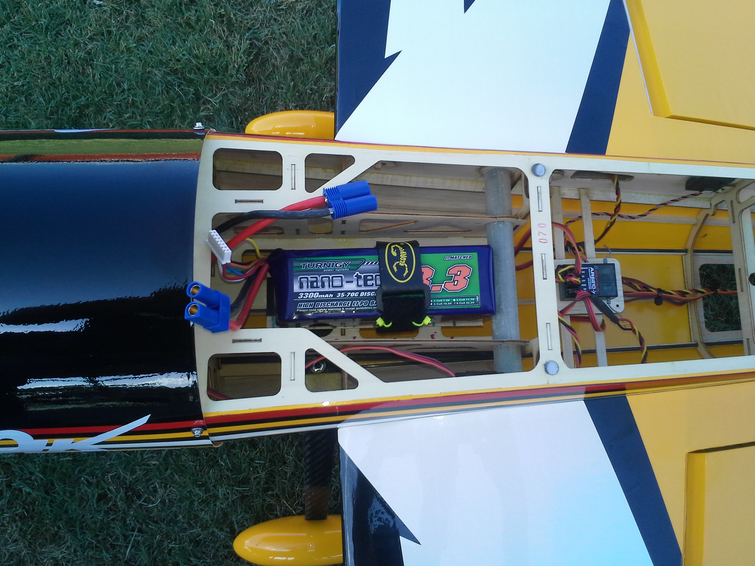

3Drew, I haven`t gotten that far yet, but knowing their product I would go about 1.5 inches in front of the wing tube to start...You can remove the canopy and use the method were you hang the thing with a loop of string just to make sure your not tail heavy. Let her rip....Gonna maiden mine this weekend.....
mazjag

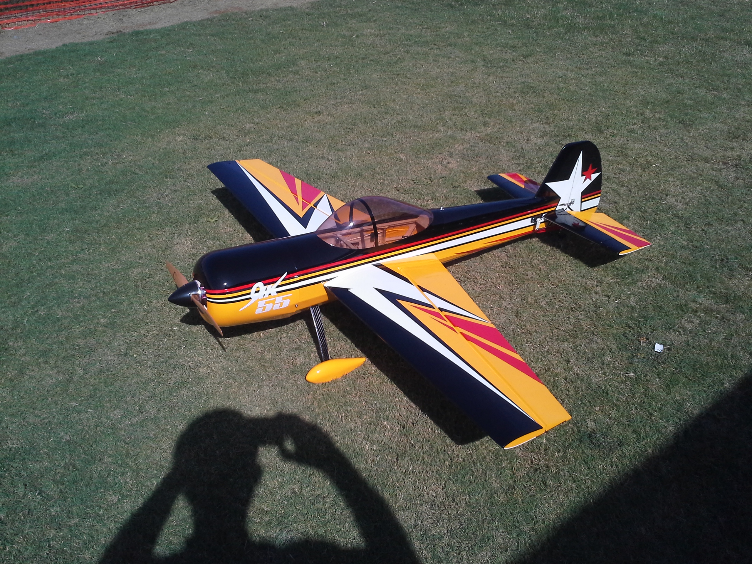

Check that on the CG as I was off by a good bit..I finally got to fly the Yak this weekend and ended up needing to have the battery all the way back against the wing tube as well as 1/2 oz. of weight by the tail wheel and I`m still not quite neutral enough.. I would say its gonna take another 1/2 oz. Overall the flight performance was just ok.It wasn`t as floaty as a slick and difficult to handle in high alpha stuff , but I`m still tweaking on it...CG throws etc...The combination of the Torque motor, 16x7, and a 6s 3300 is excellent as it has awesome power and speed and runs a long time... here are some pics. 20141011_150225.jpg20141011_150143.jpg
