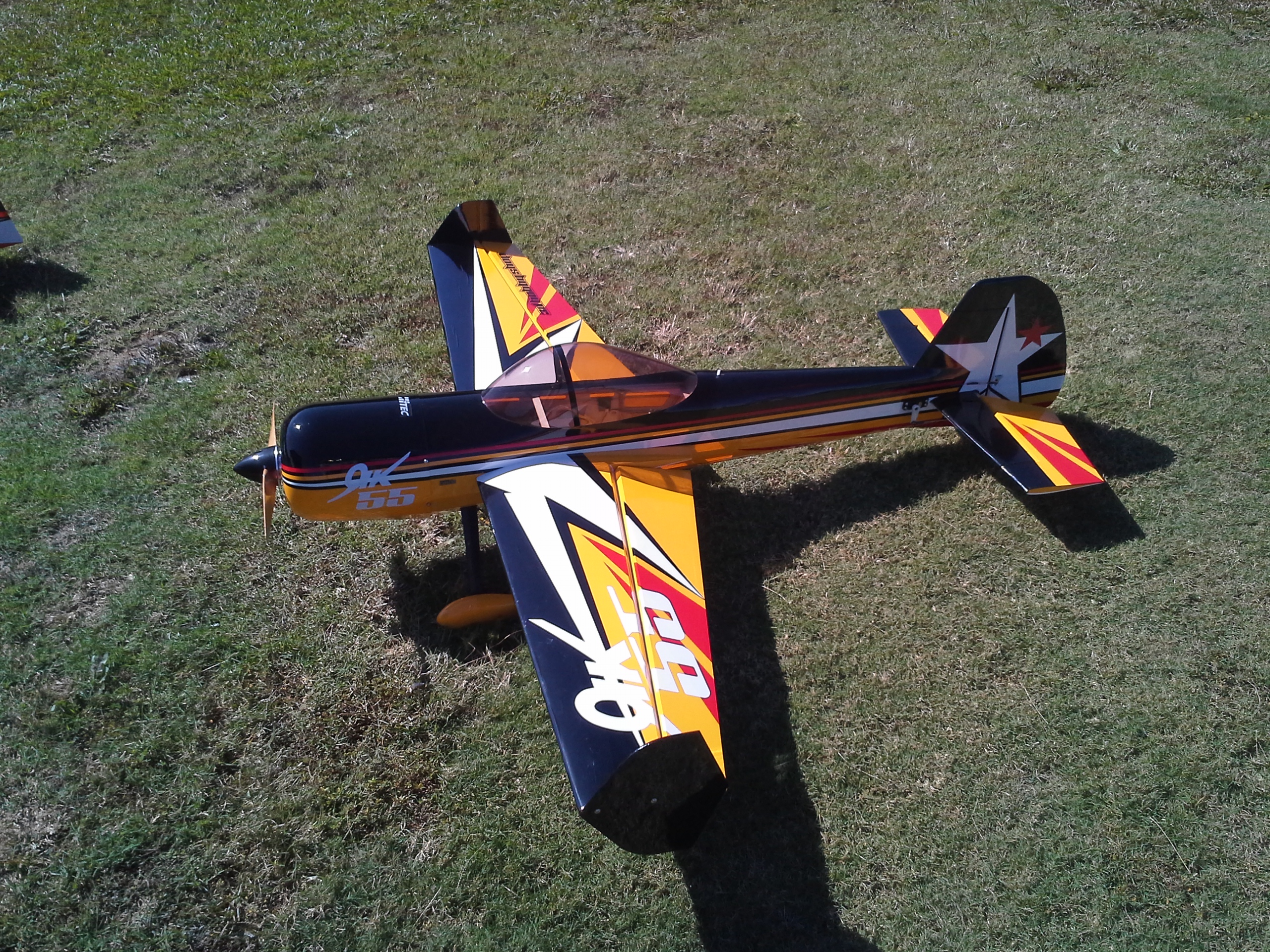

mazjag
Something I didn`t notice about it and it was pointed out too me is the size of ailerons...I had to take some throw out of mine(less than 100%) to get a better handle on the thing...I don`t normally like SFGs, but I like them on this one...Its a fun little plane overall. 20141018_142126.jpg
