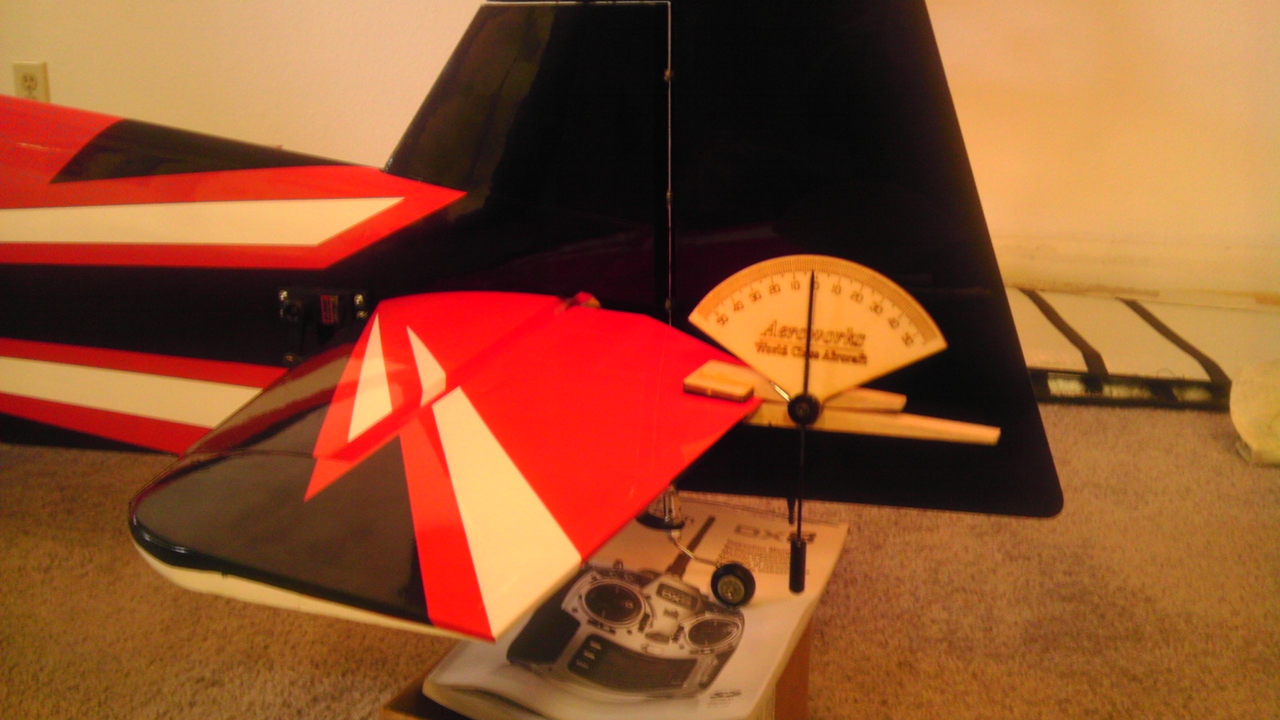

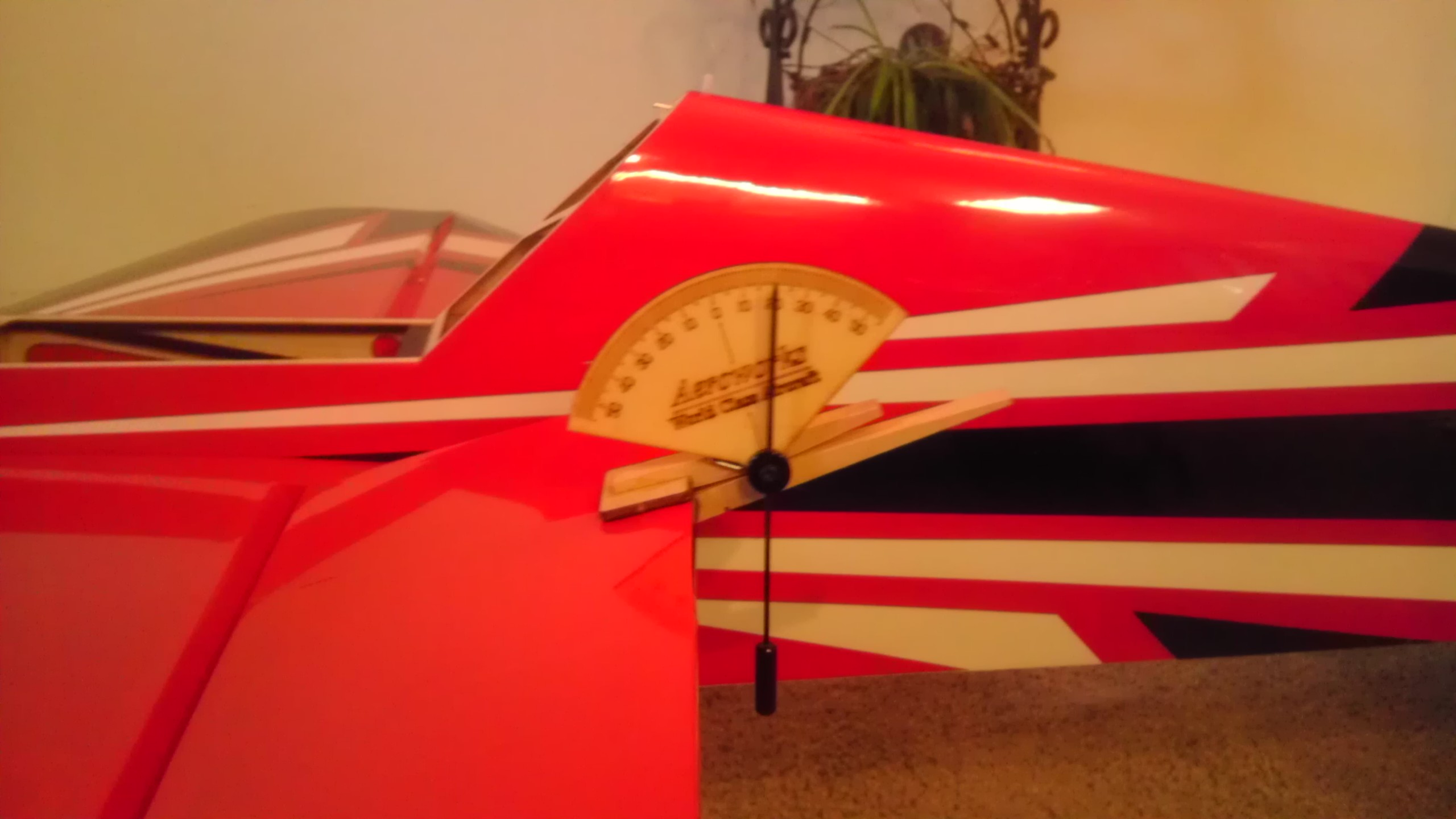

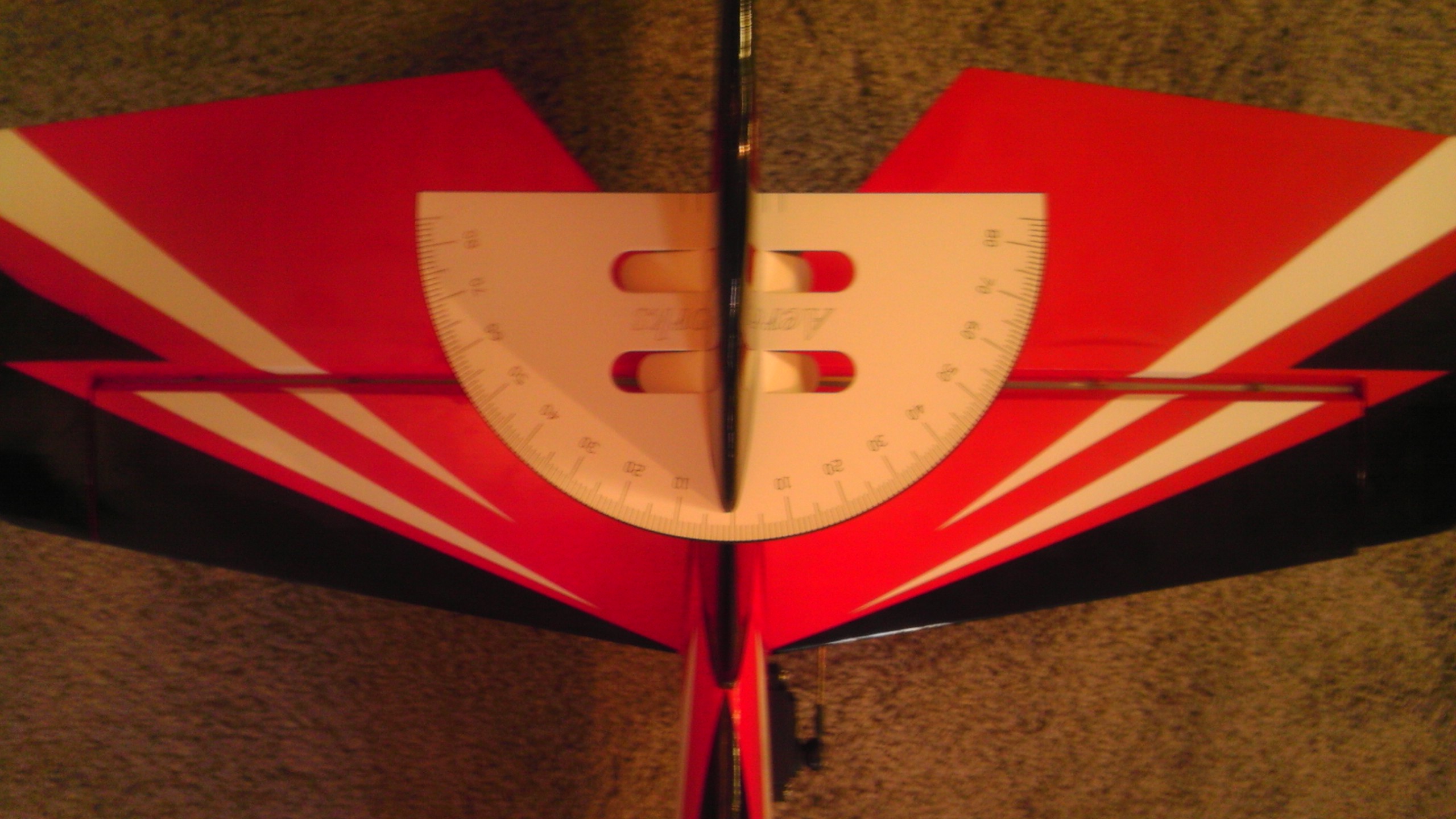

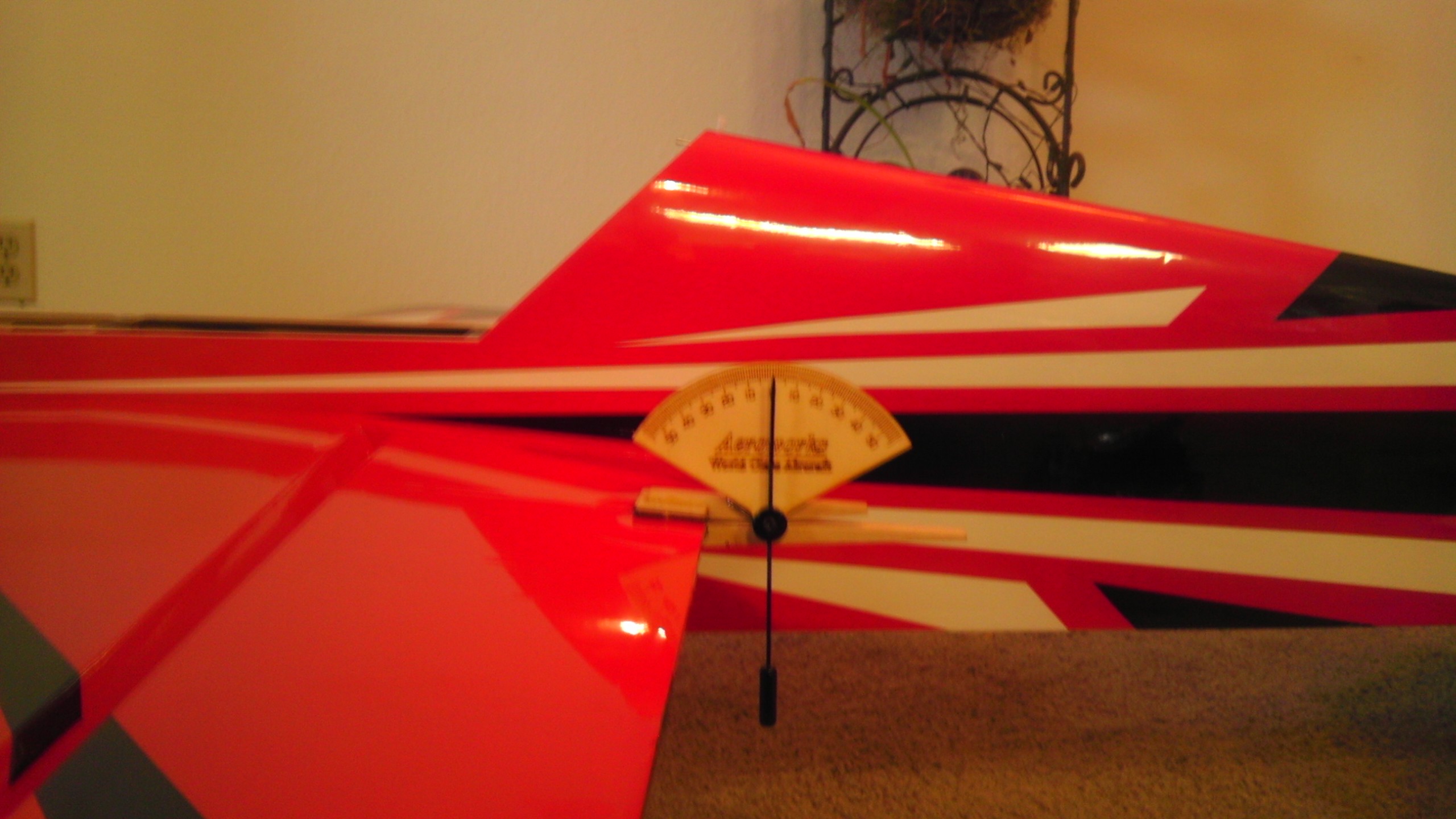

Ah Ha okay here's what I got. Plane leveled out.
Aileron:
Low Rate 20 deg up/down
Mid rate 30 up/down
High rate 40 up/down 45
Elevator:
Low Rate 20 up/down
Mid Rate 42 up/down 40
High Rate 55 plus up/down
Rudder:
Low Rate 35 <-- -->
Mid Rate 45 <-- -->
High Rate 49 <-- -->
Does this help better?

That does help quite a bit. It should be fairly tame with those throws on low rates. It will still probably have more control authority than an imac plane but will be manageable. With as much expo as you have in there it might feel a little soggy... but still manageable. Take it off, fly high, get her trimmed and get a feel for the control inputs. I think you are going to do fine ;)
