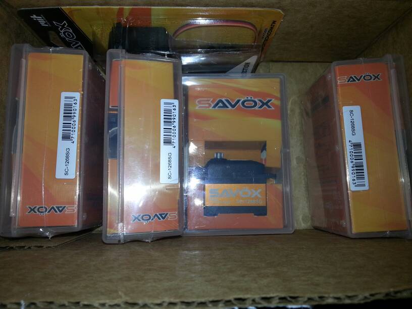

I love it when a plan starts coming together ;-)
The fifth is up at the top.. Didn't want to spend that much for the throttle so I stepped it back a little to only 111.1oz torque ;-)
"only" :D
I think the key to a throttle servo is durability and ability to absorb vibrations... as long as it's a metal gear standard size servo, you're golden. Also, I've been removing the throttle springs on mine.

Ha, well it's the savox standard mg Hv servo so I'm hoping it's good.
Thanks for the info on the throttle spring. I had been following another thread that was going back and forth on remove or not.
Now if I could just get usps to deliver the box from servocity.com that has my power board. Frustrating.
