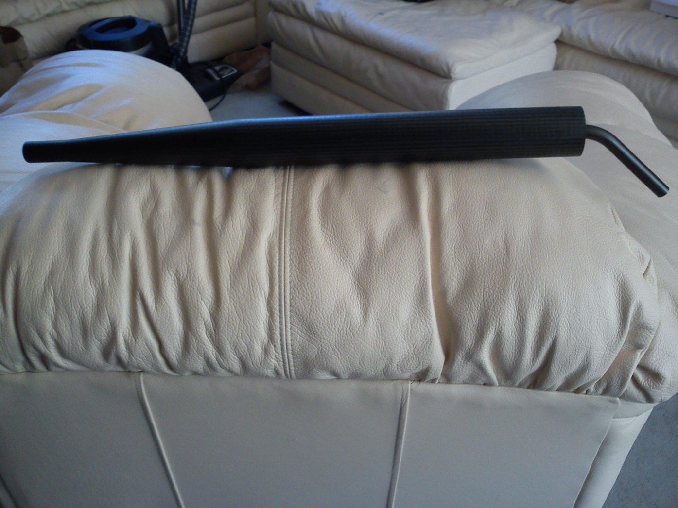

When i get my nice aluminum standoffs i'll take pics of my setup. My pipe is on the way to me so i should have that by the end of the week. I sent an email to order a Hatori #2301 return to center header. It has a 25mm drop which should work. I was told the the minimum distance between exhaust port flange and reflection baffle is 27'' with this setup. I'll need a 4 & 1/2'' extension to get the length i need.
Set up properly i should be getting over 24 pounds of thrust.

Well at the moment i'm out of luck as far as the Hatori header goes. Emailed a few different places but no one has it.
Good news is the pipe arrived today!
