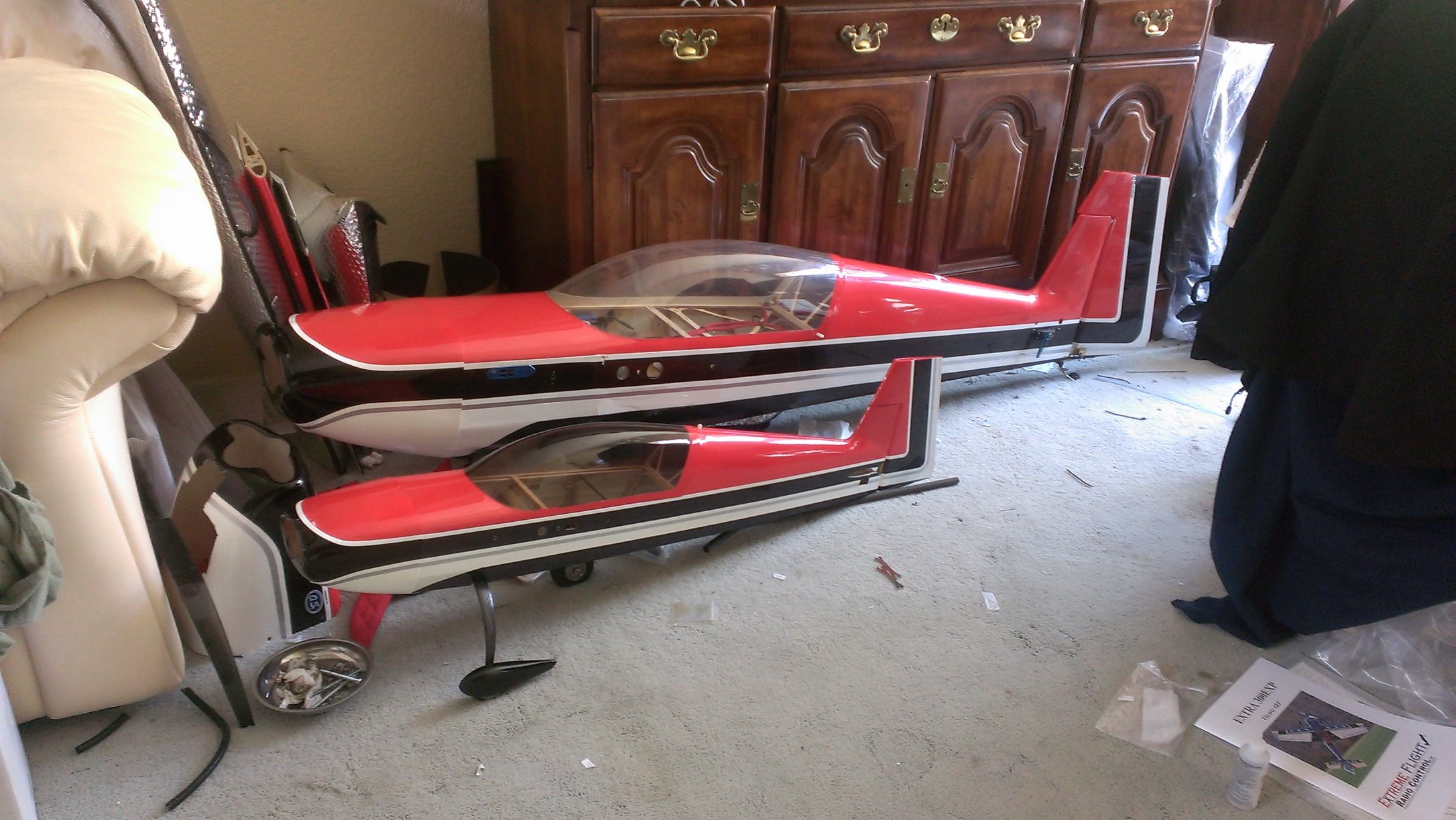

Good news is i just got my 48'' Extra to hold me over until i get me engine back :thumbup: IMAG1212.jpg
