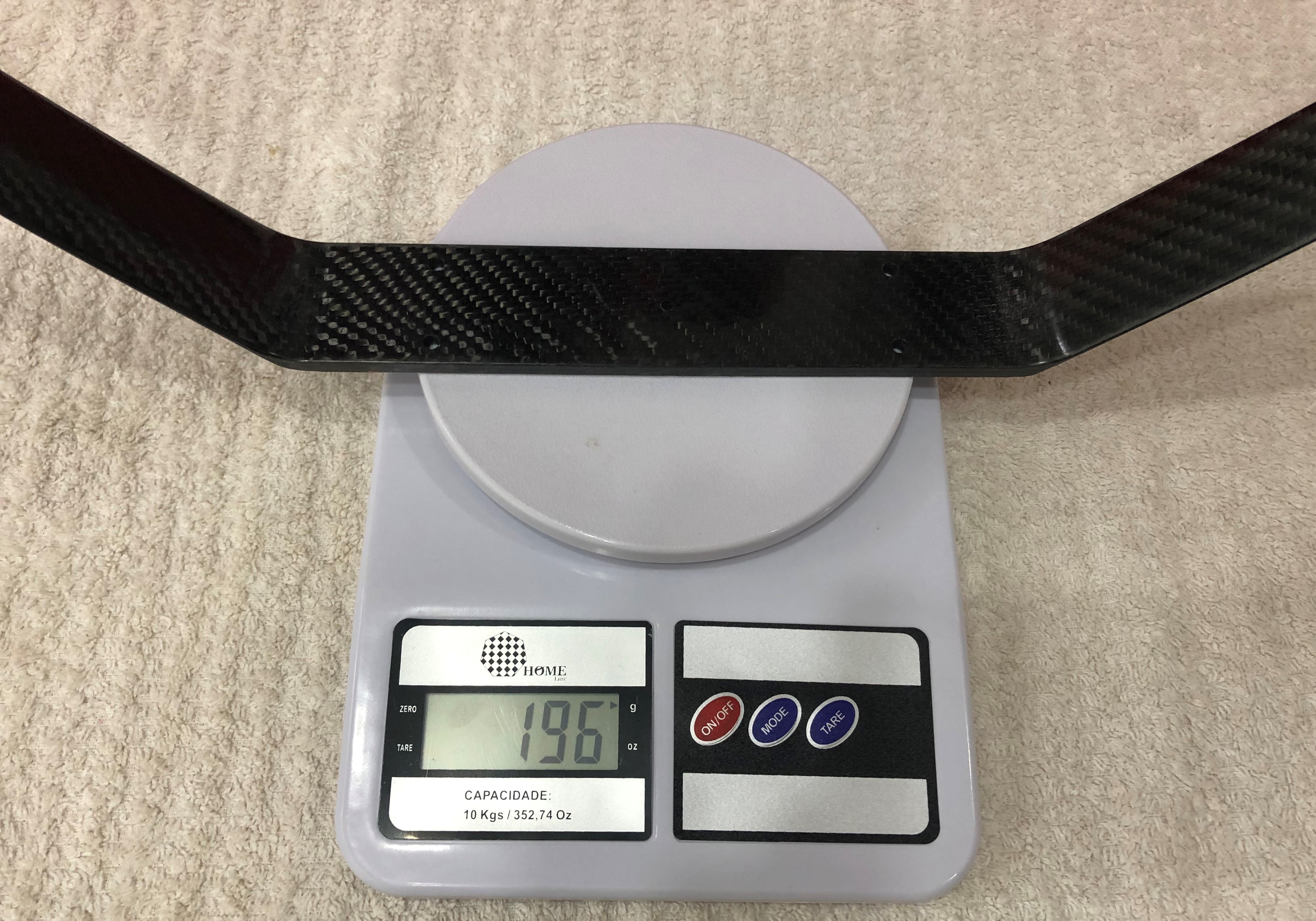

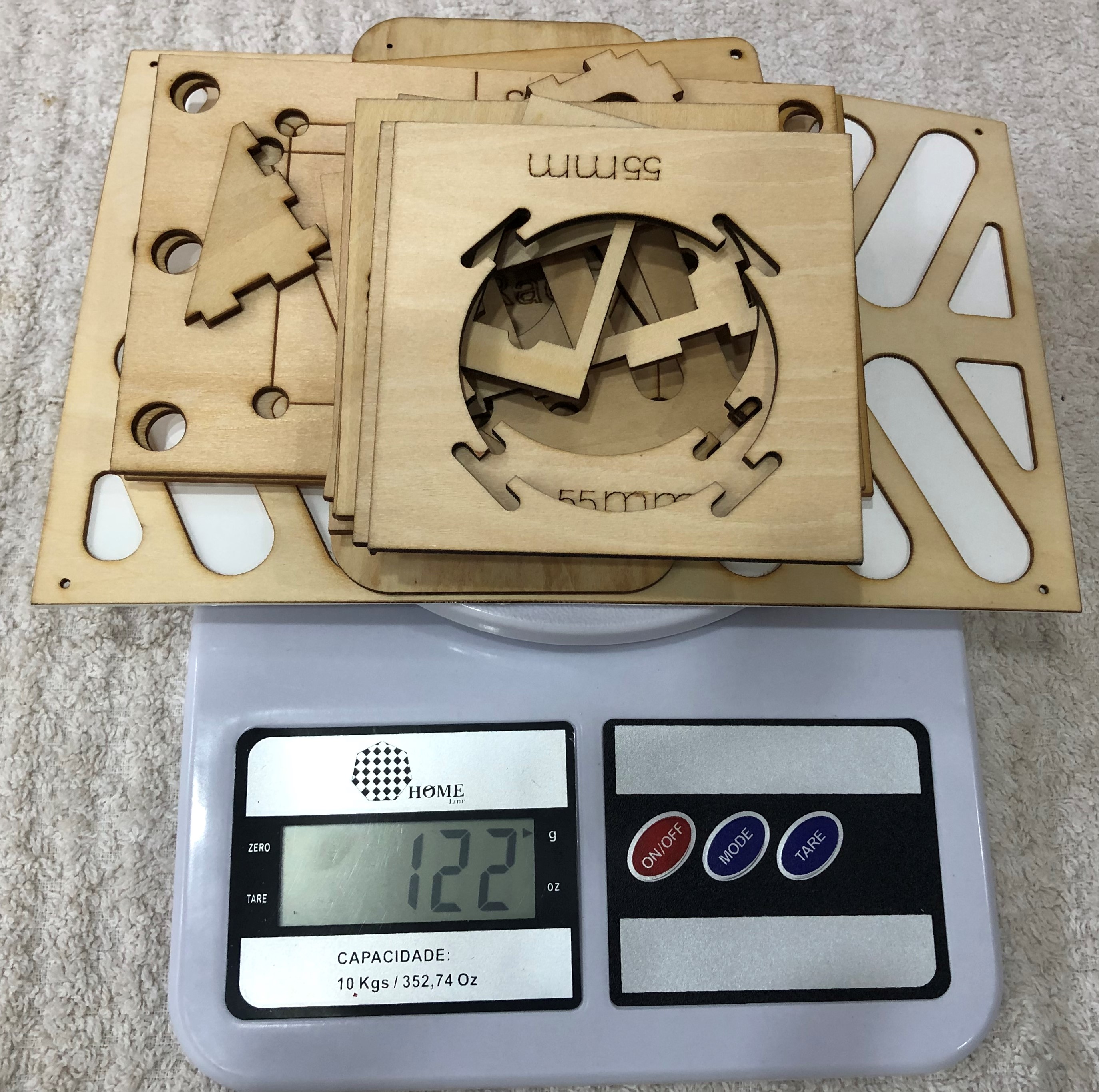

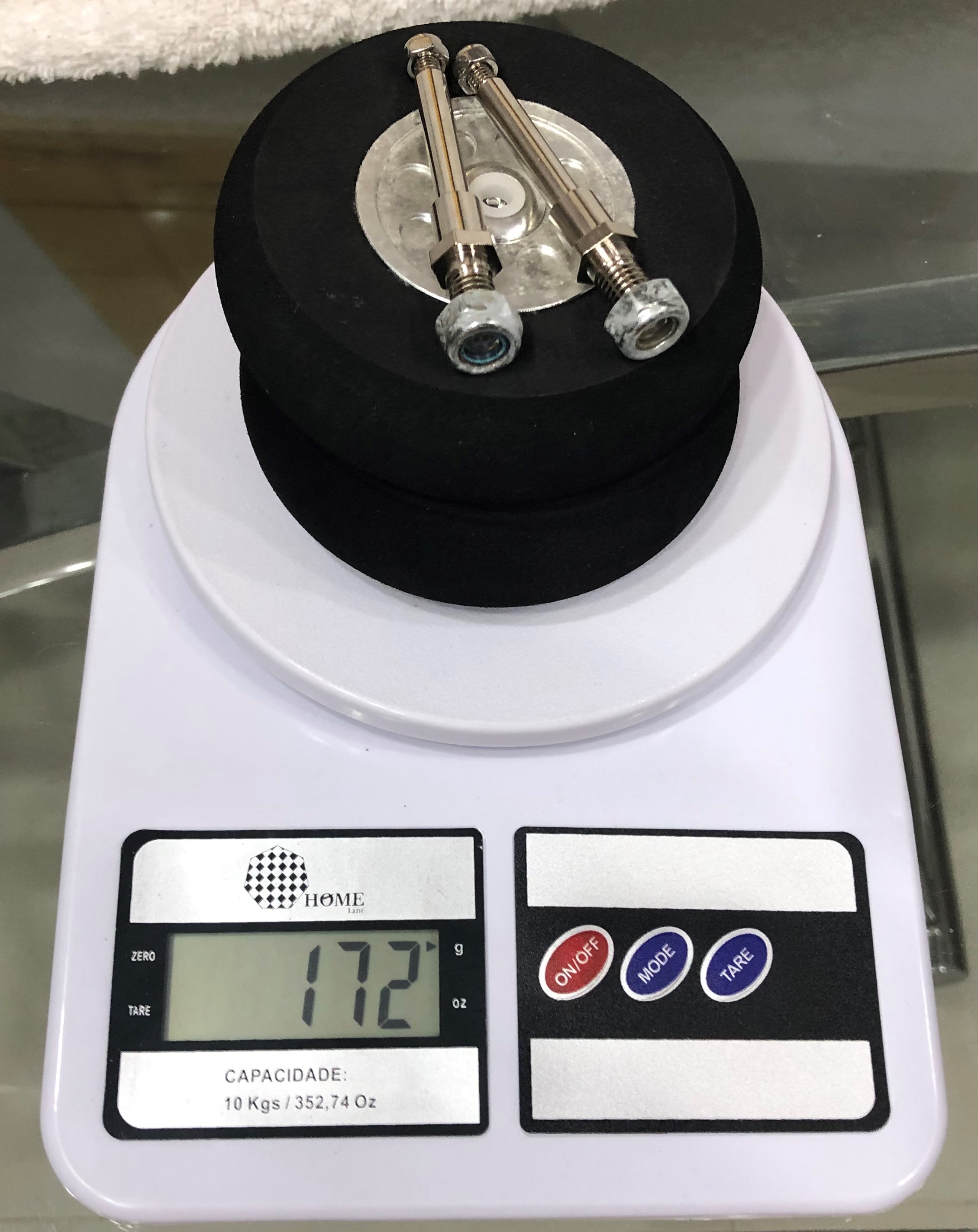

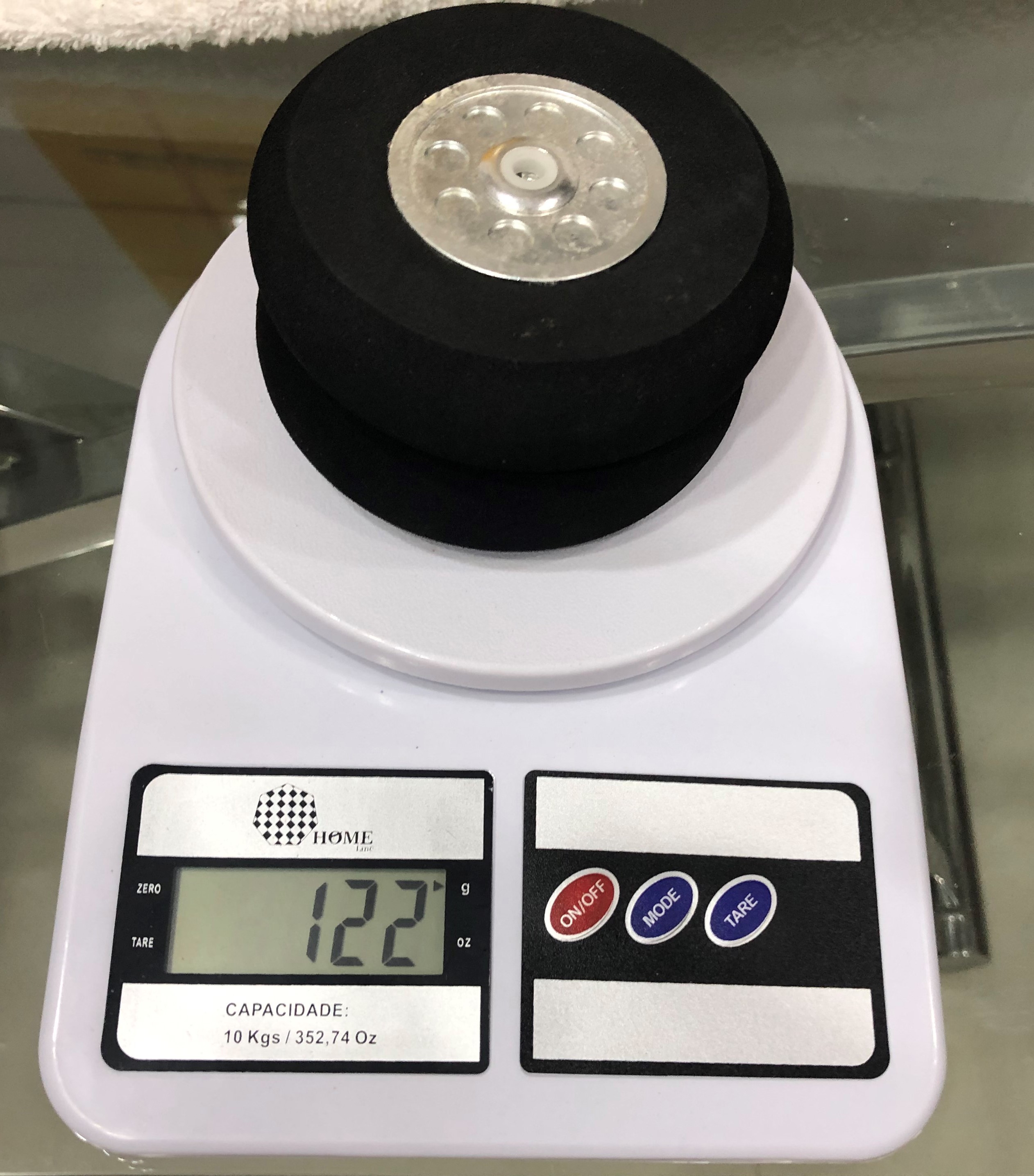

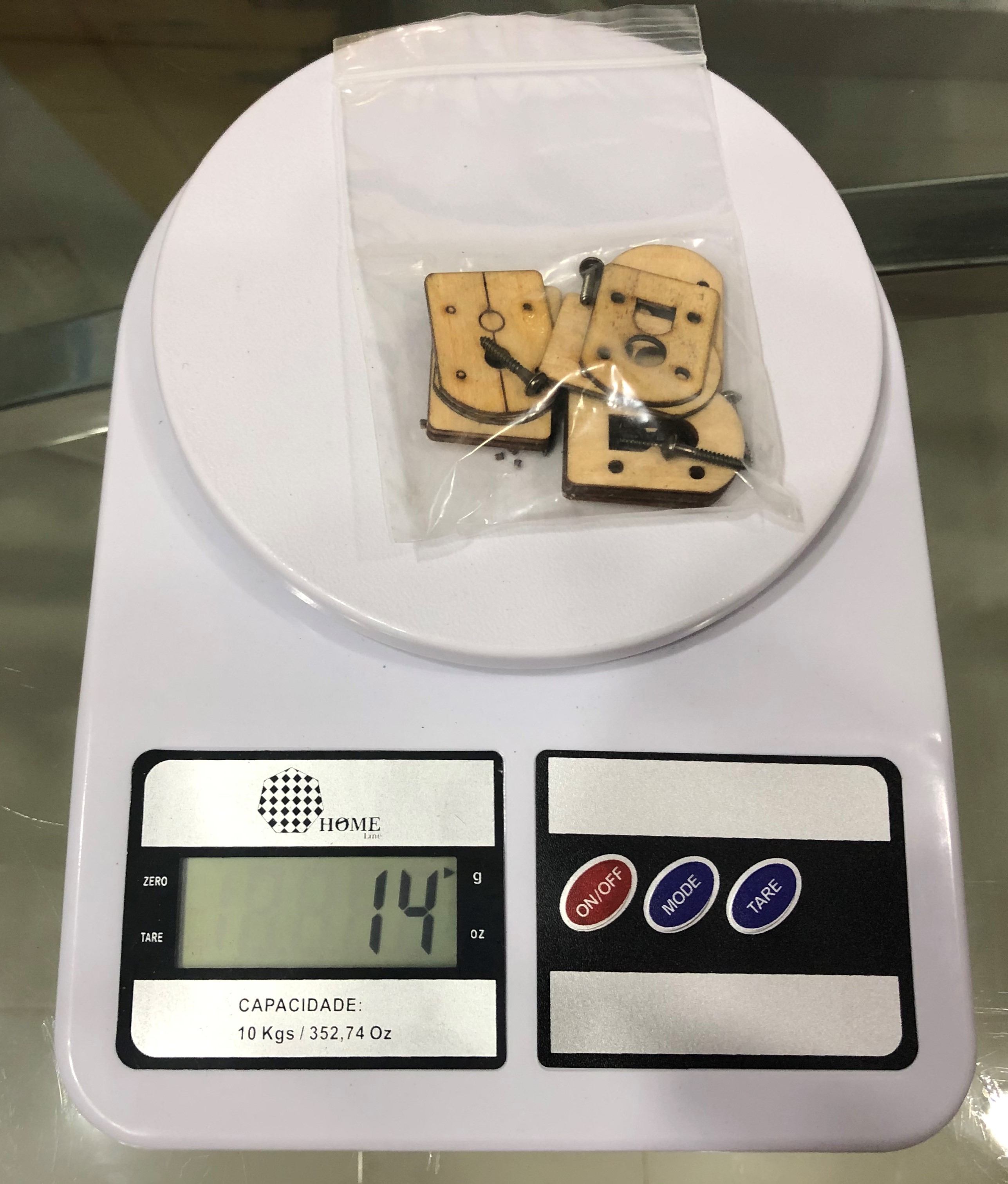

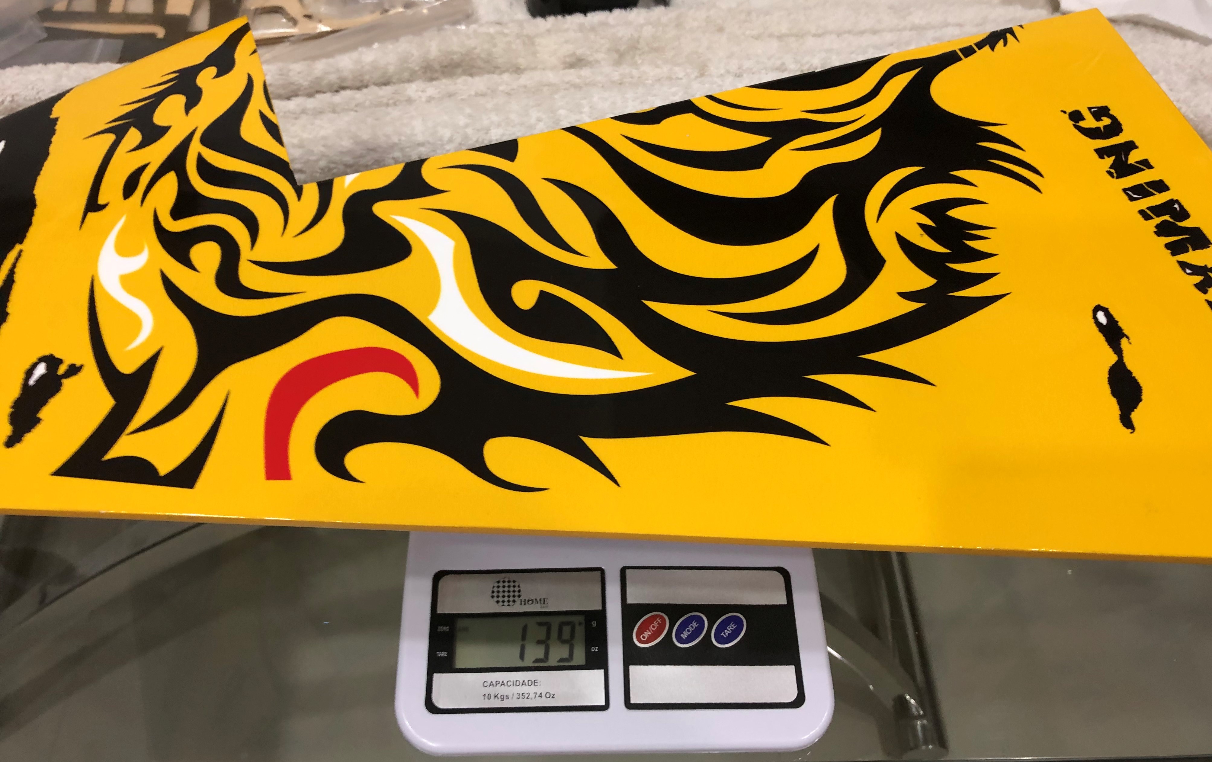

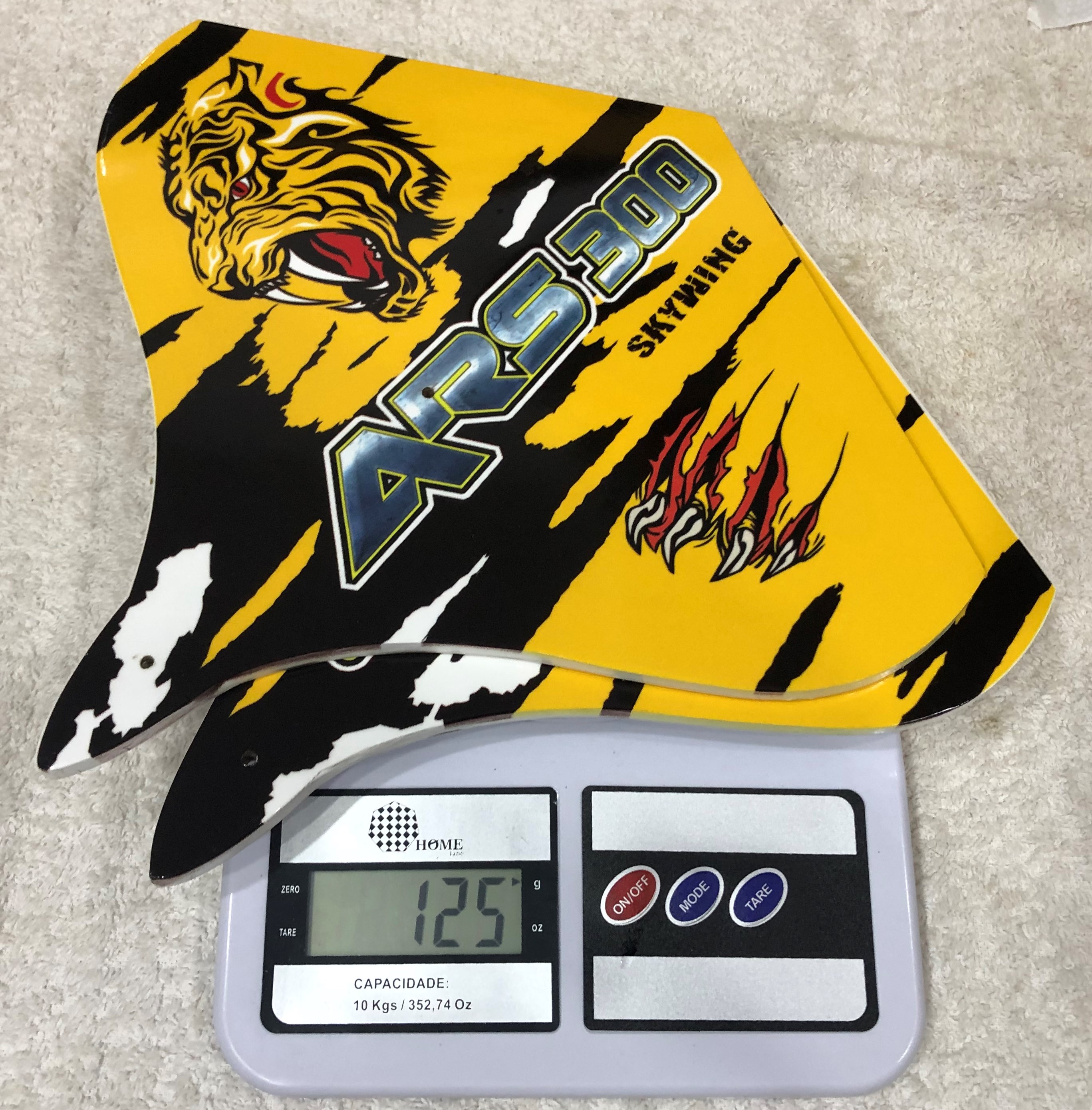

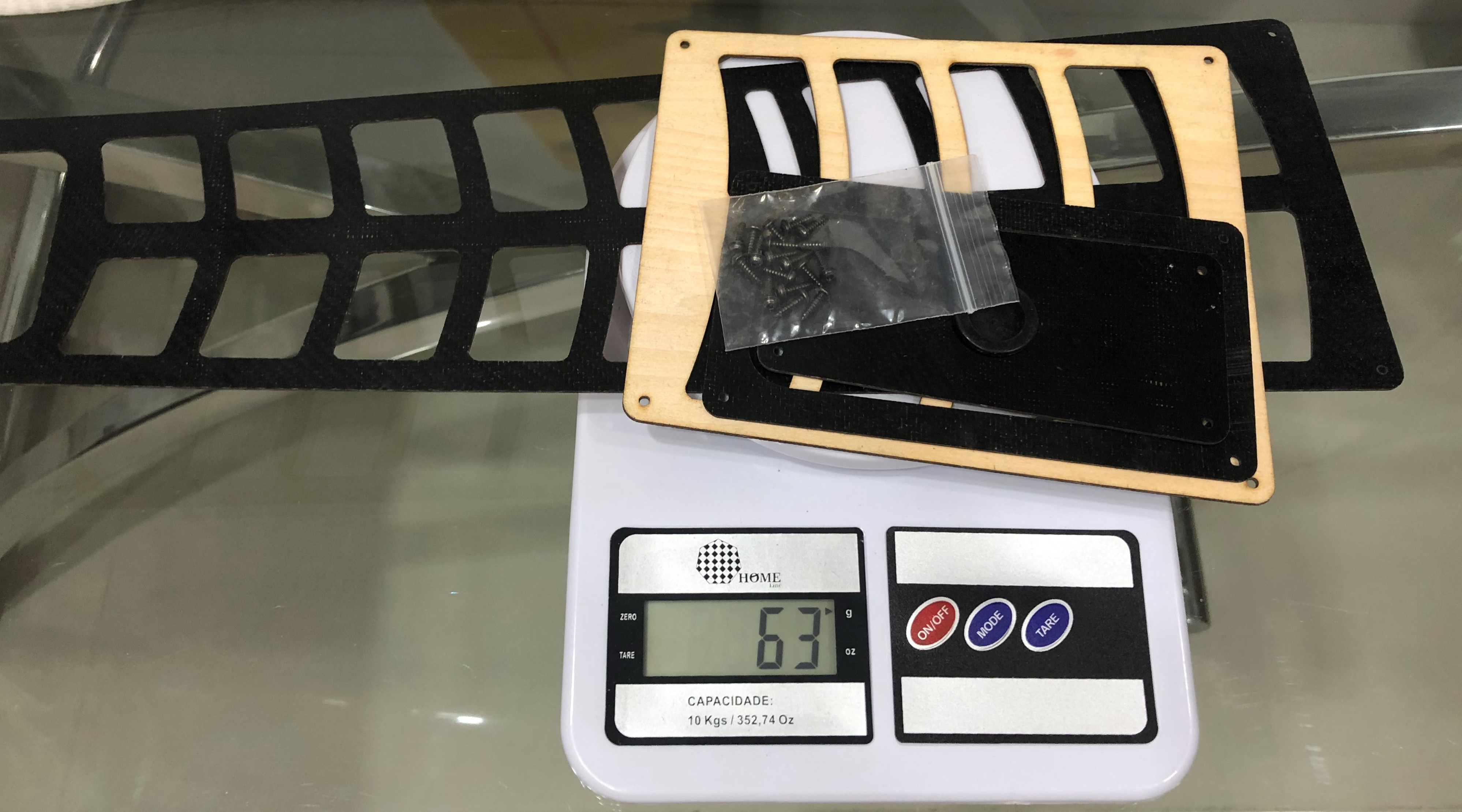

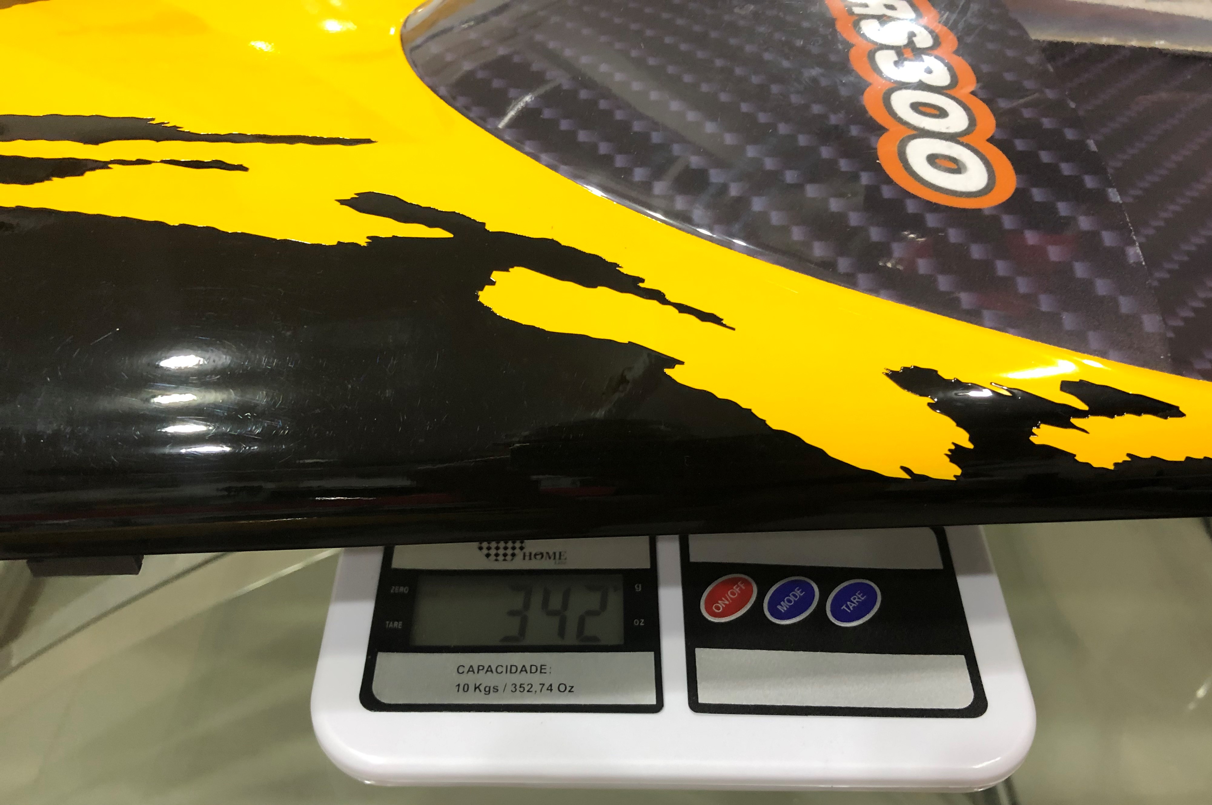

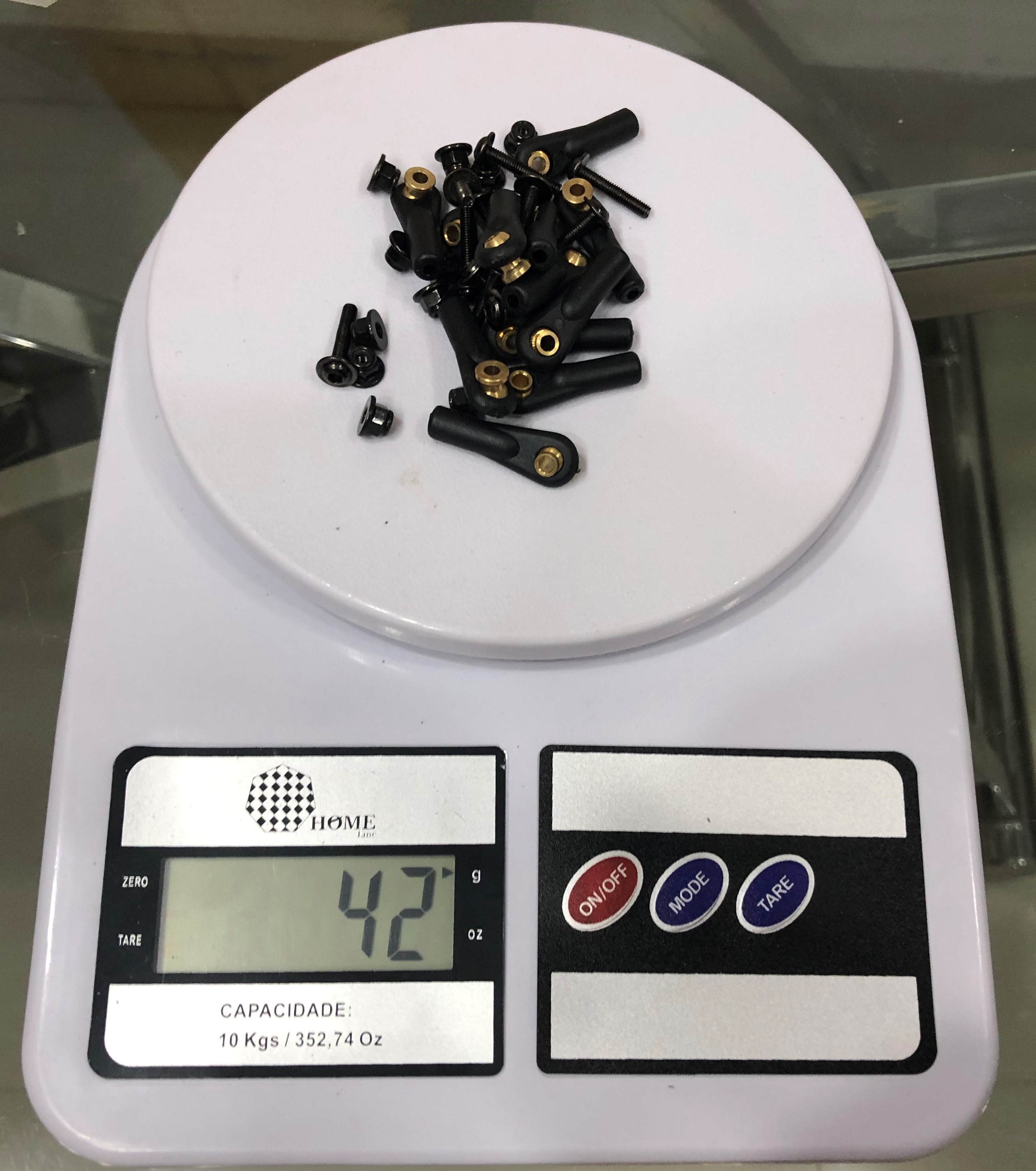

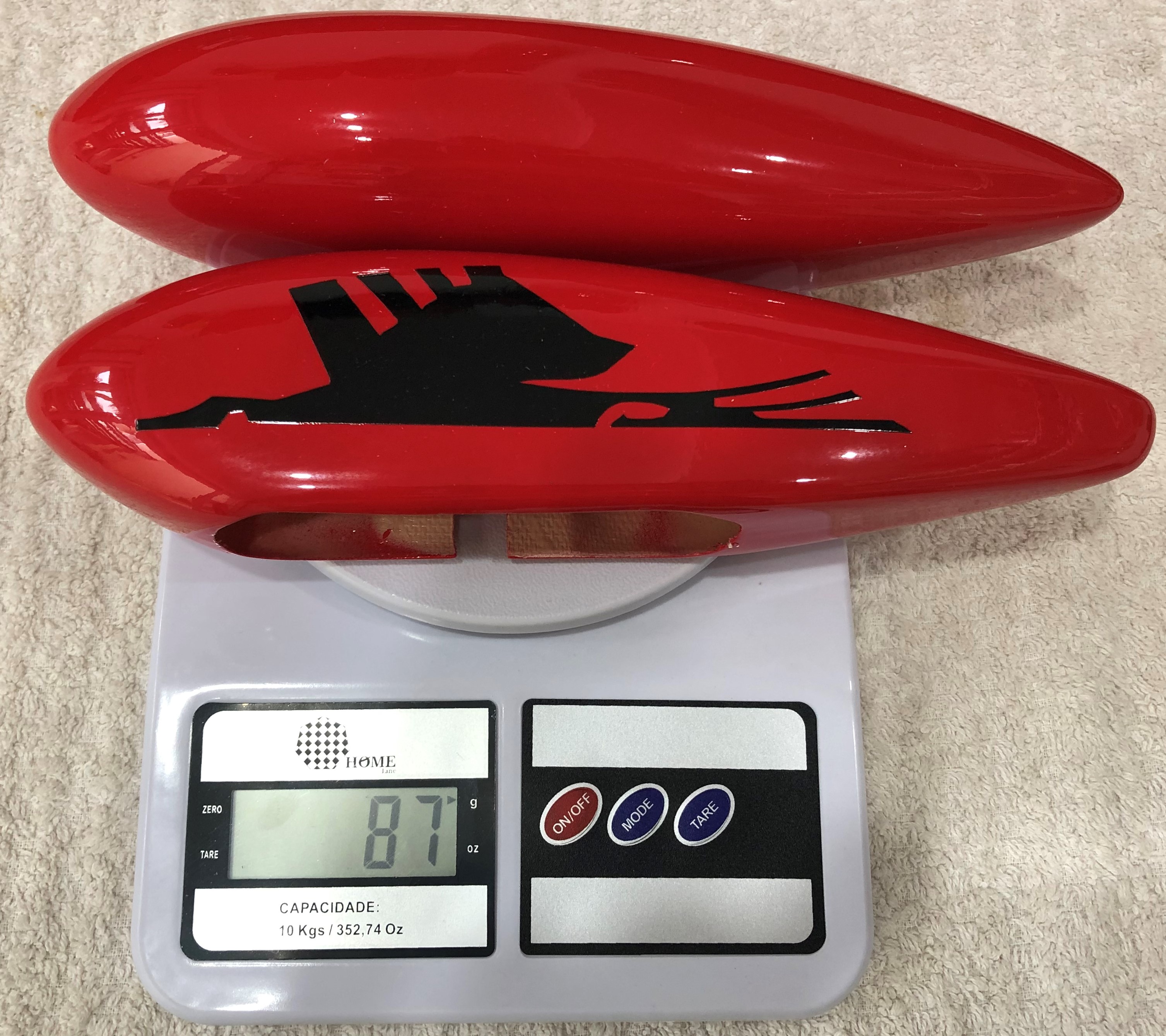

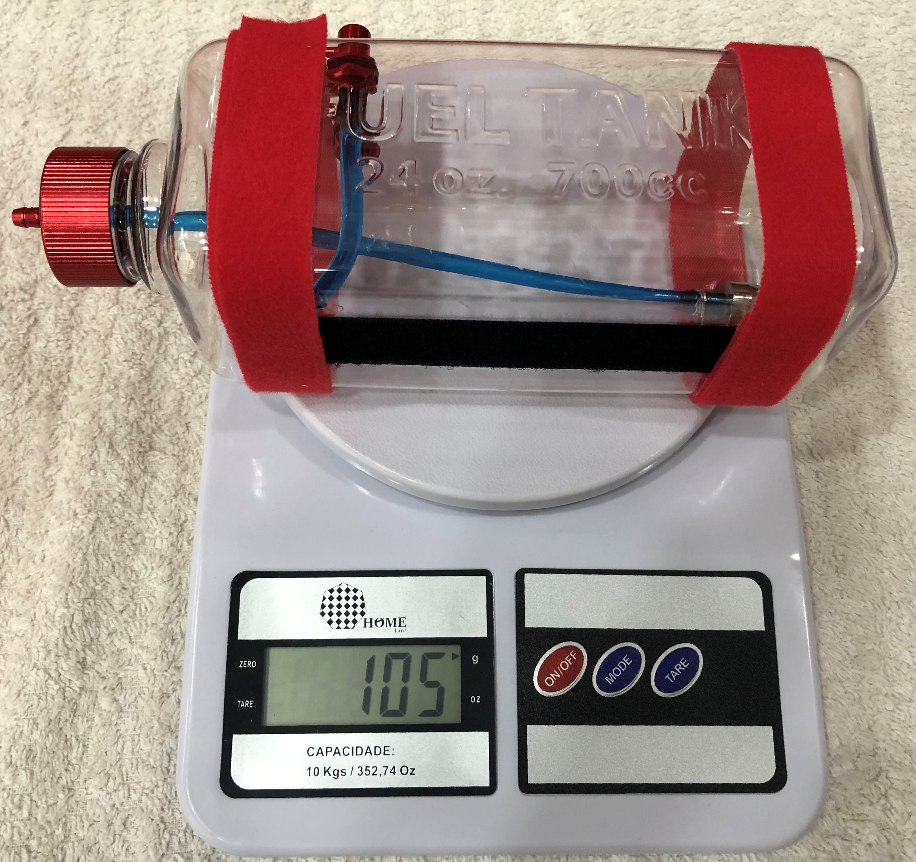

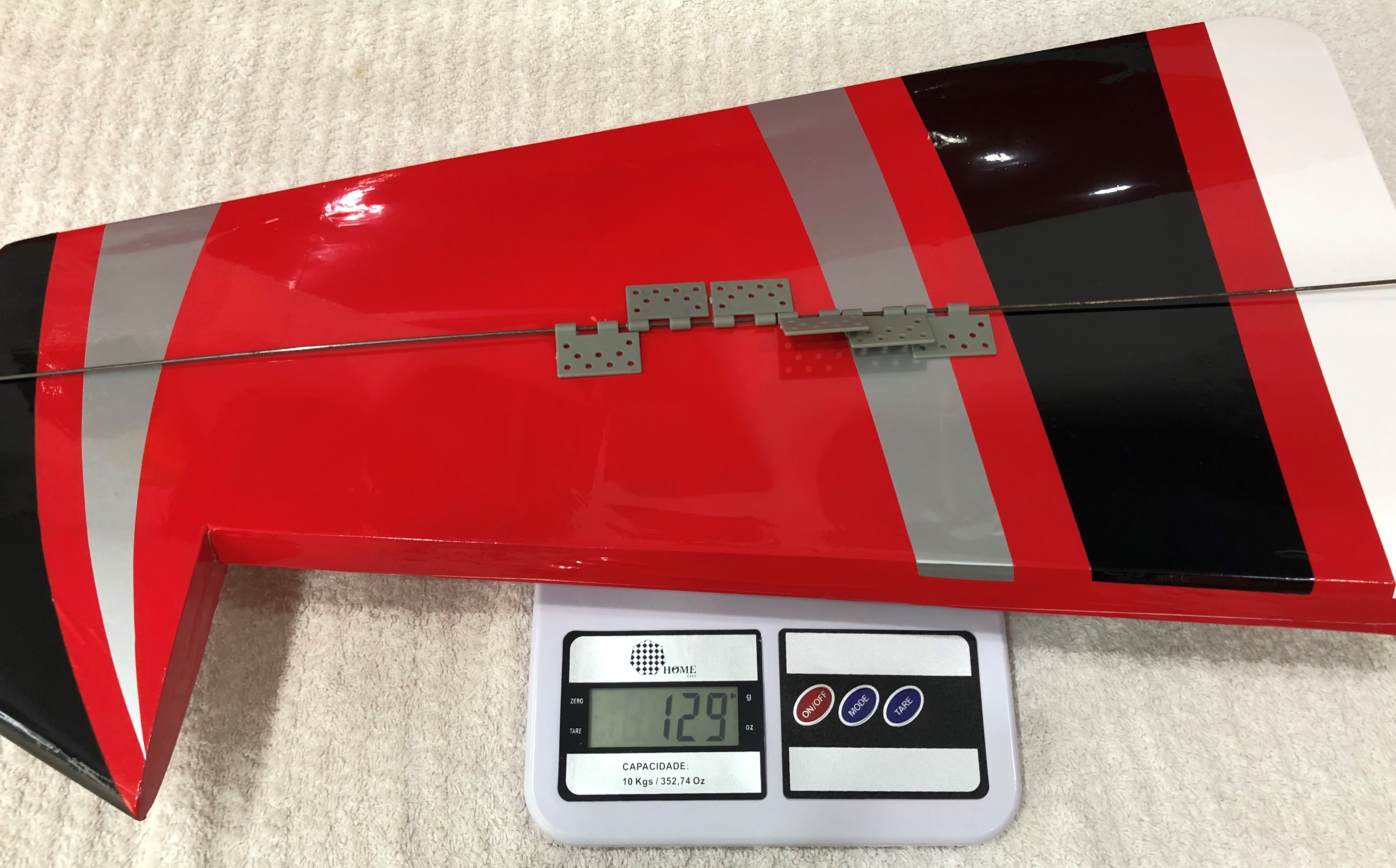

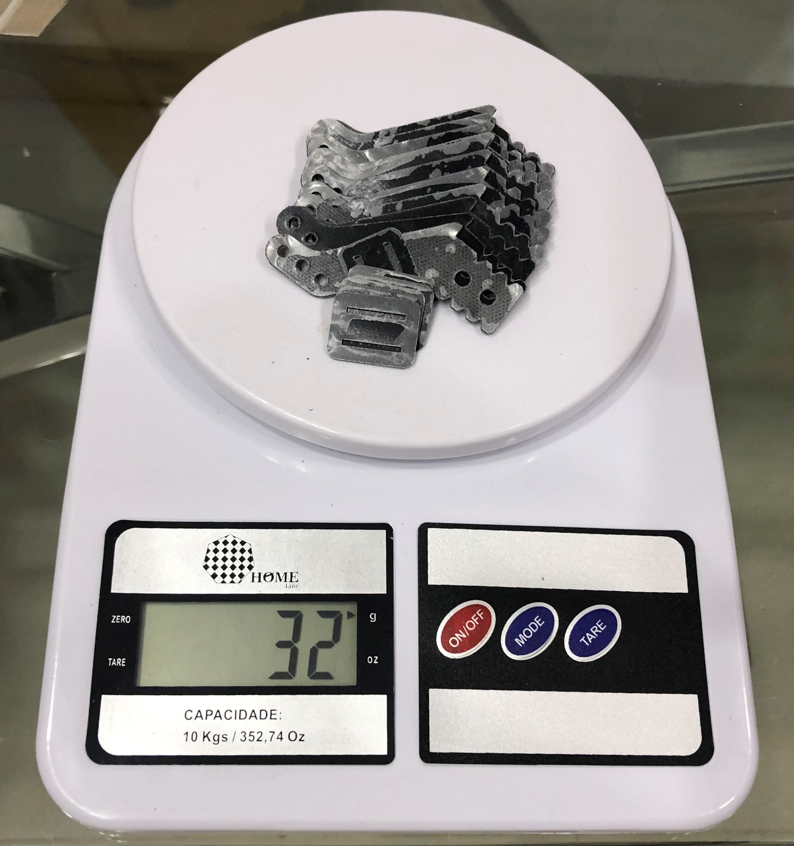

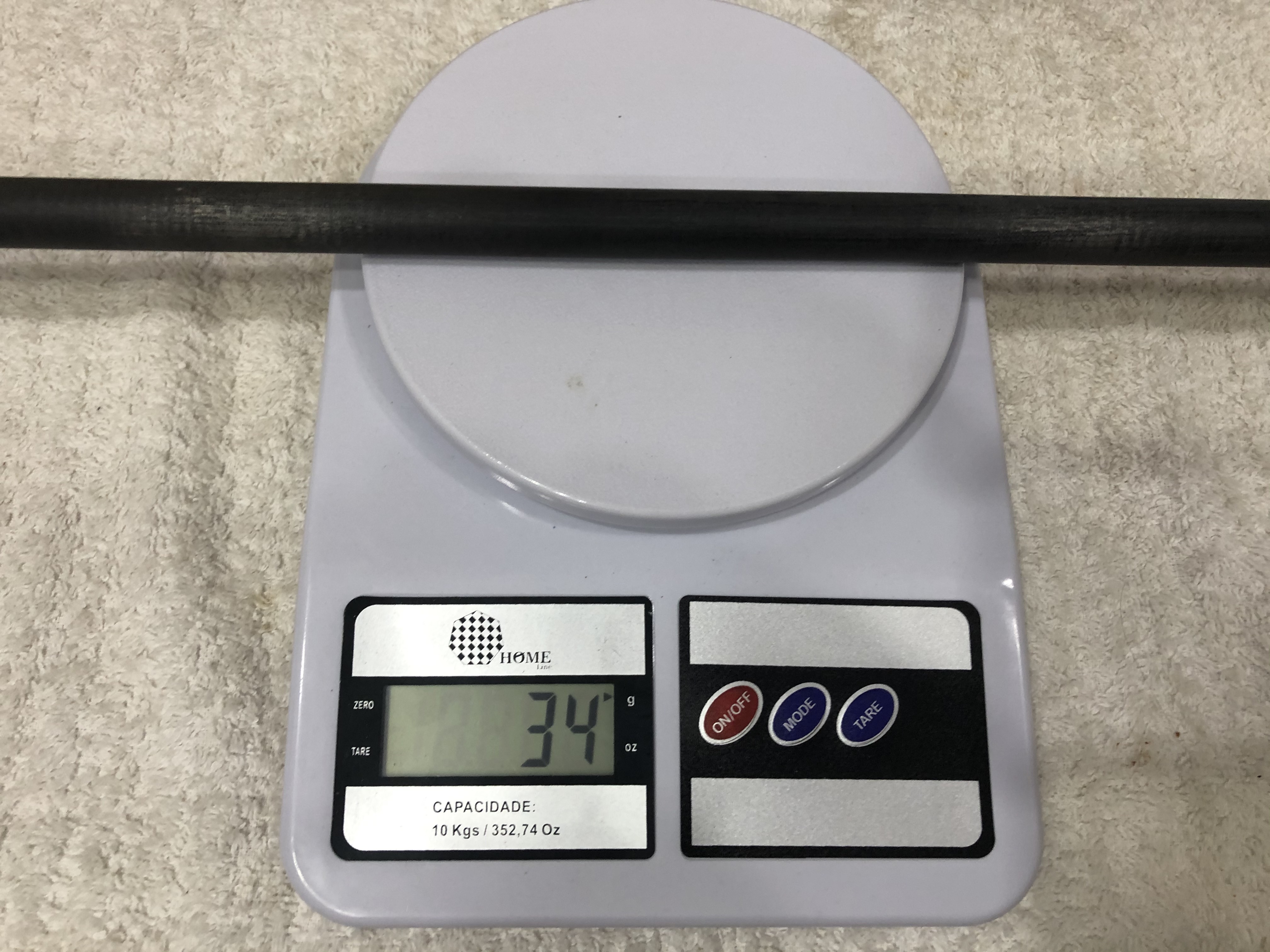

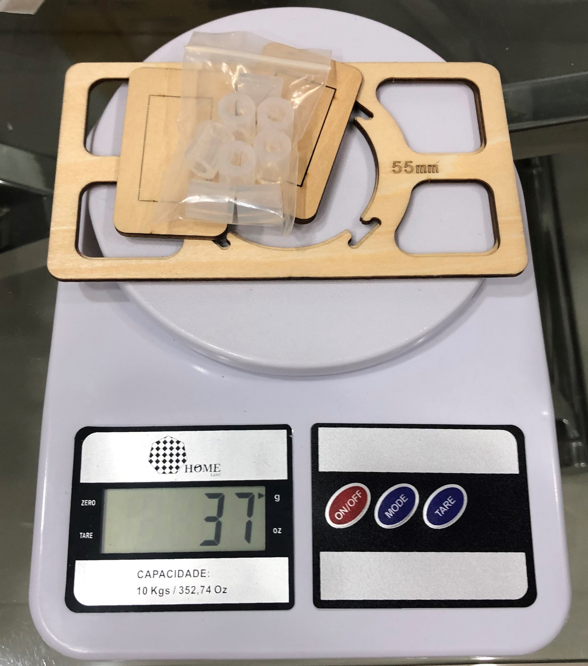

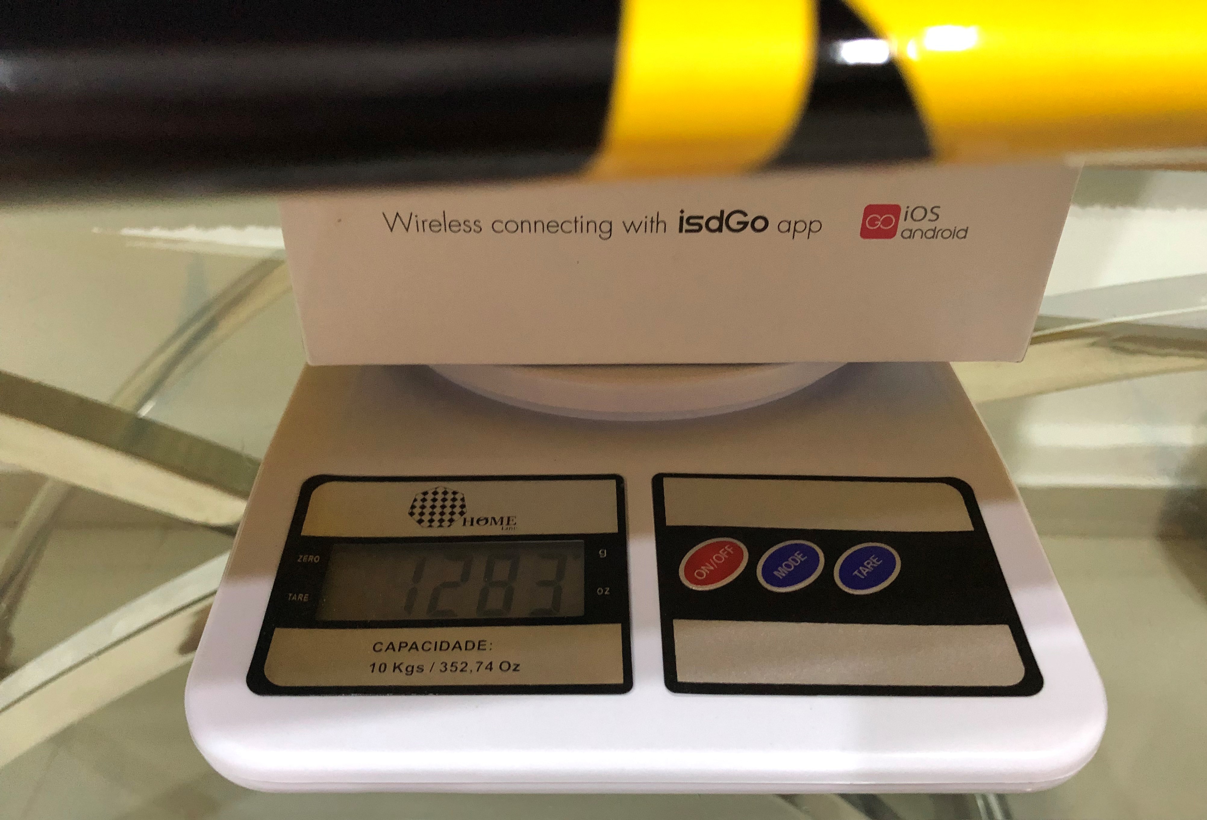

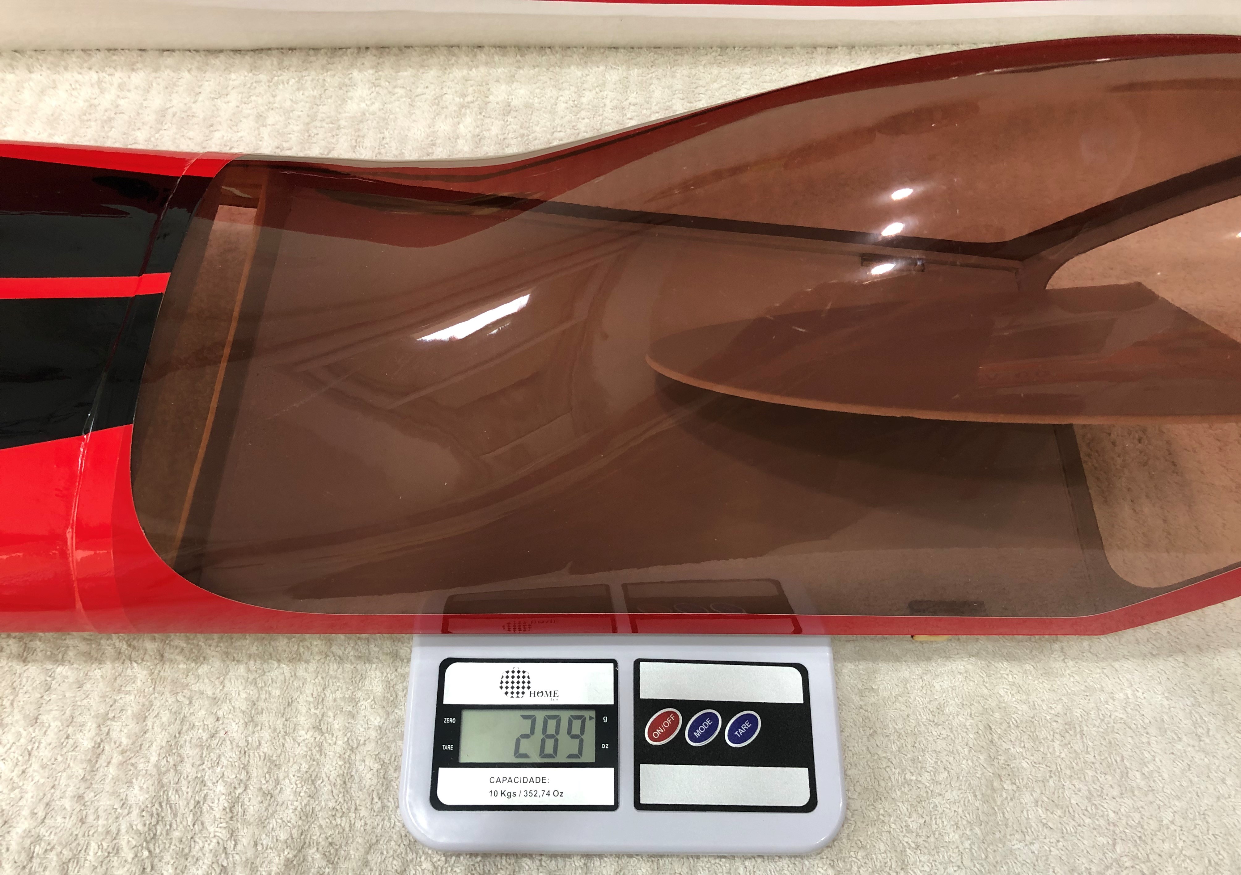

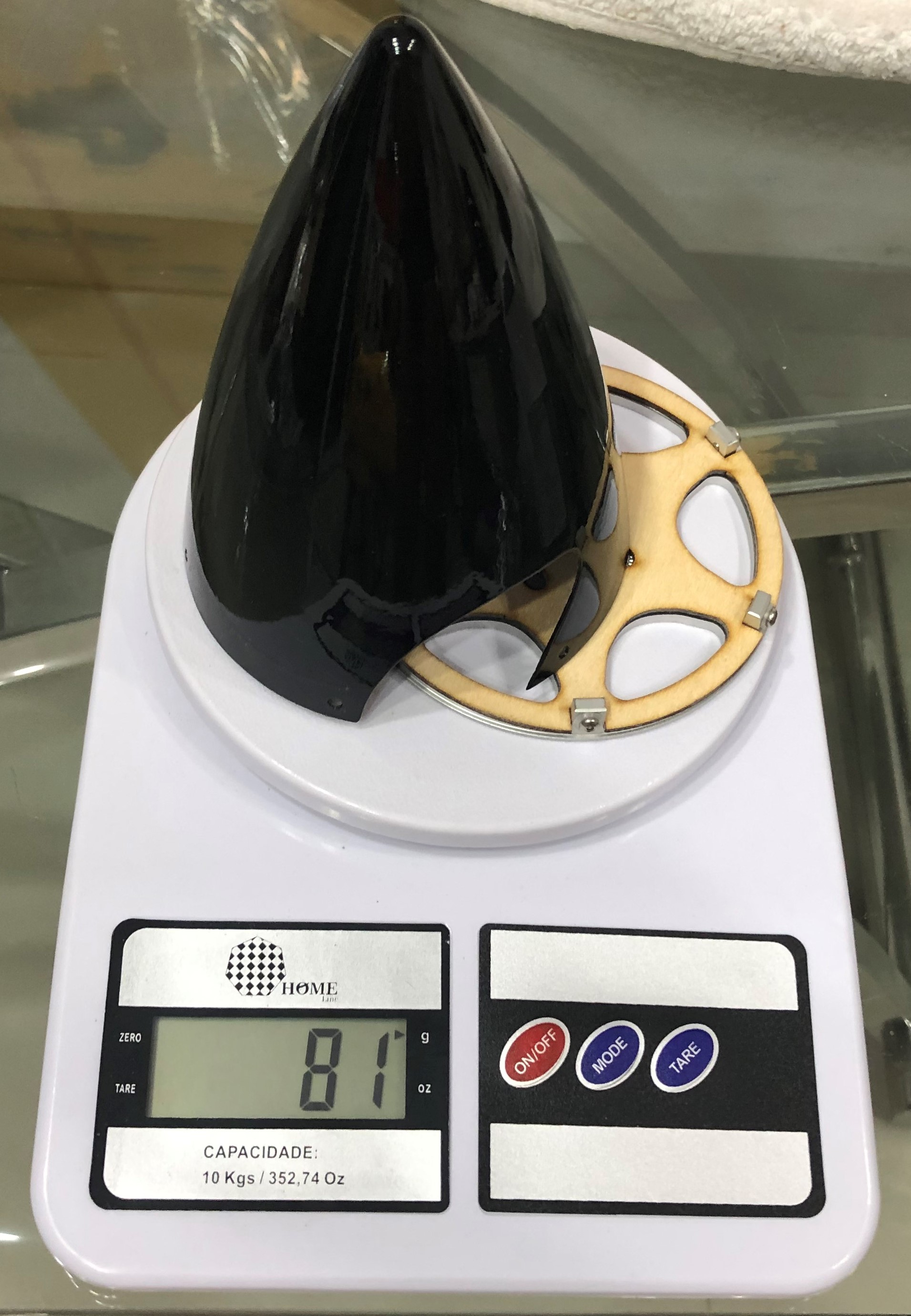

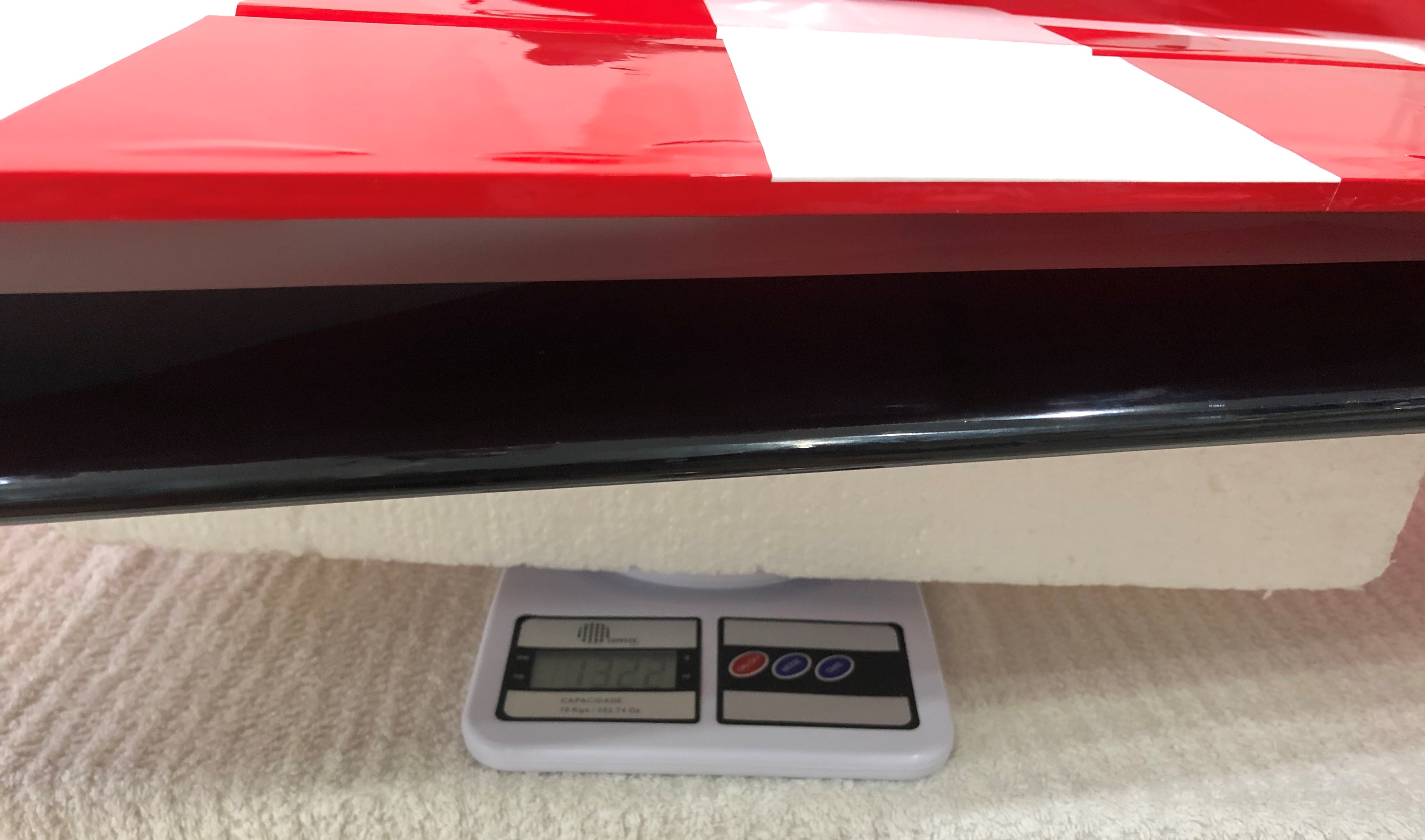

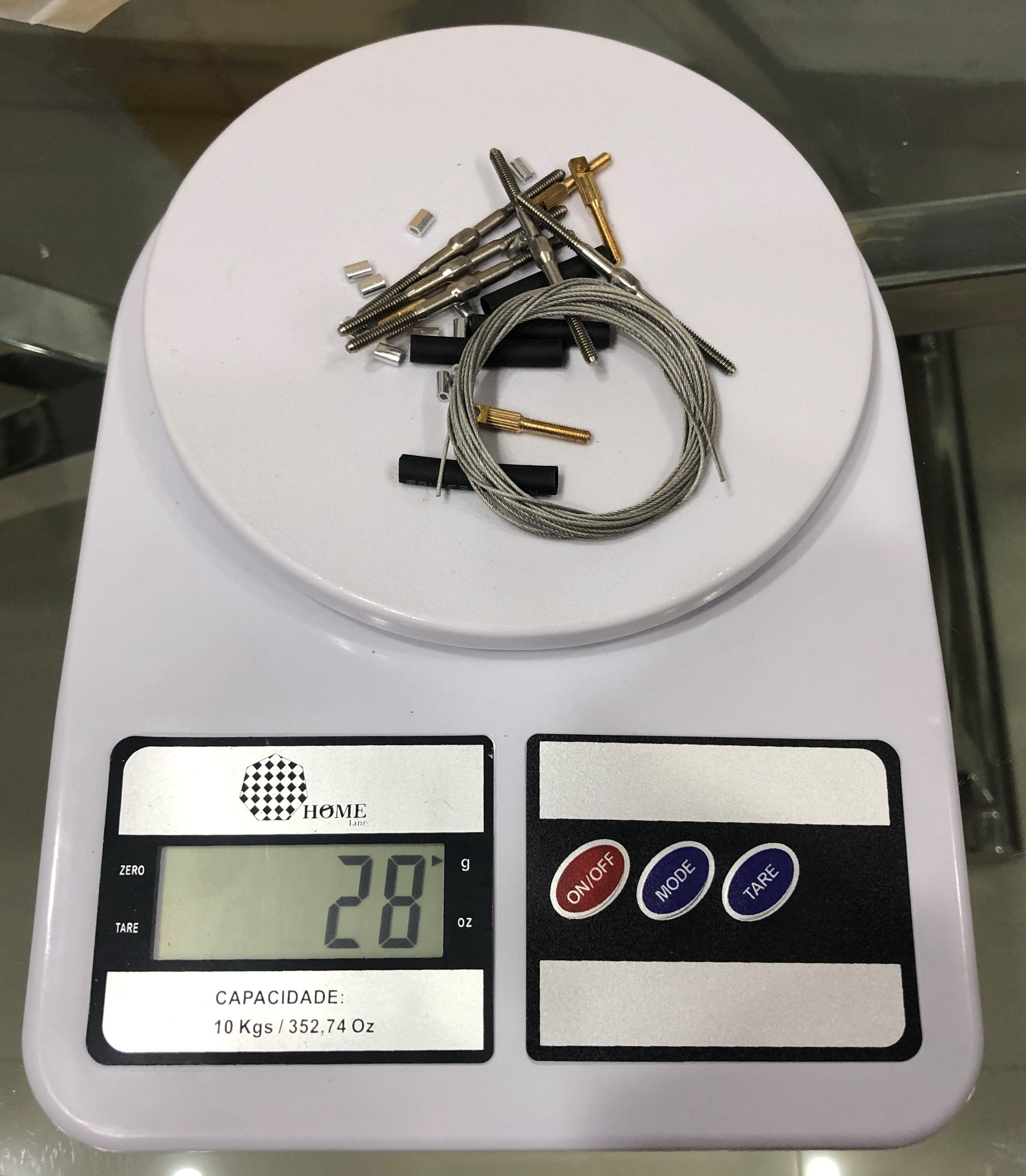

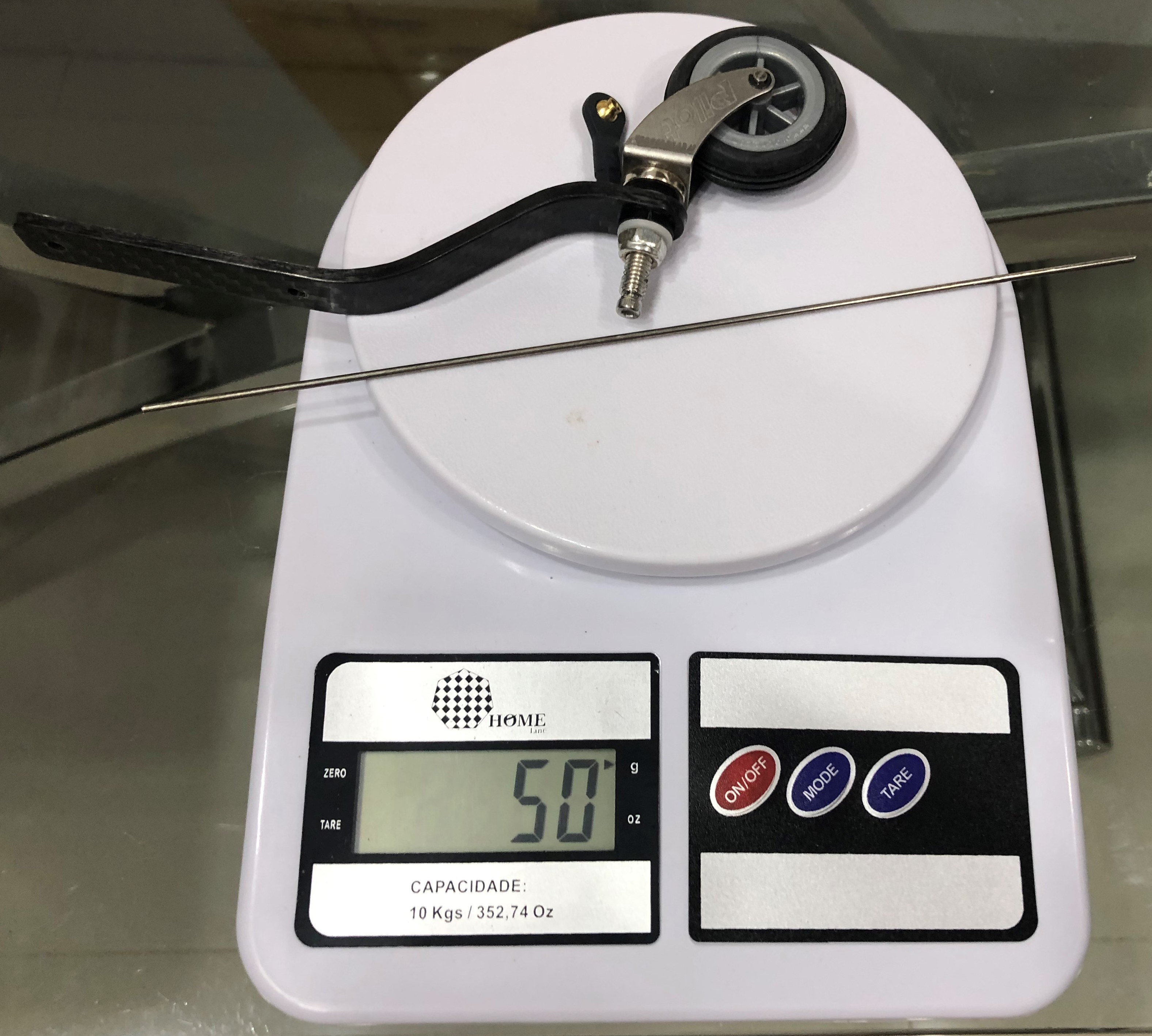

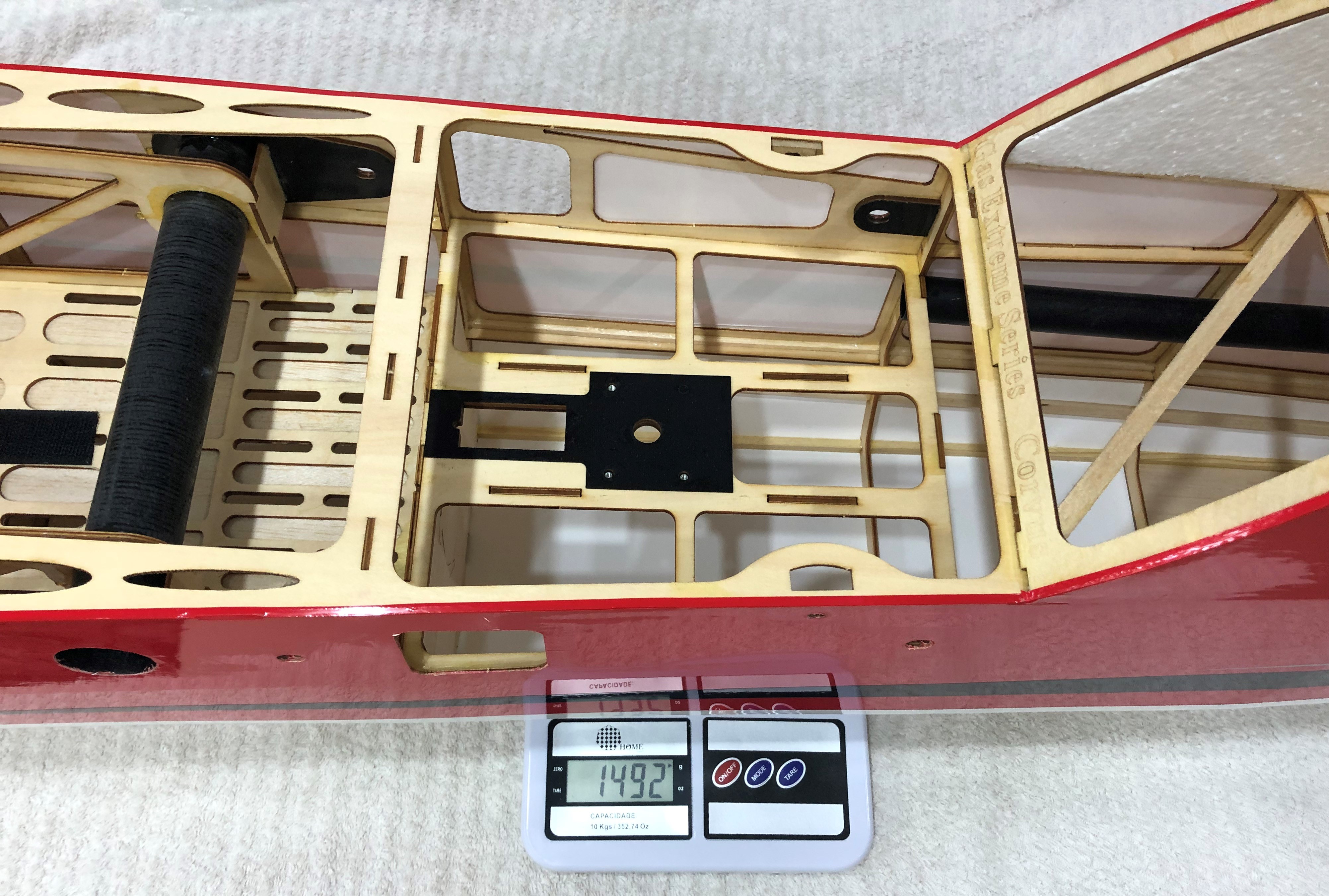

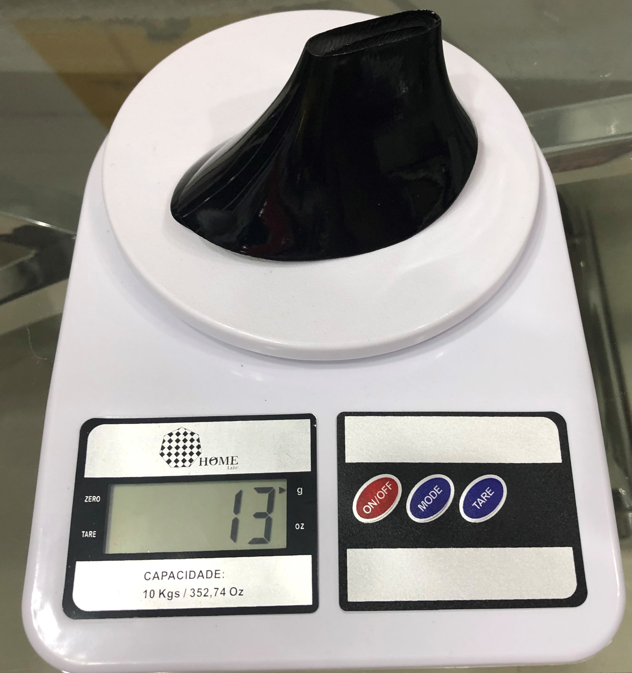

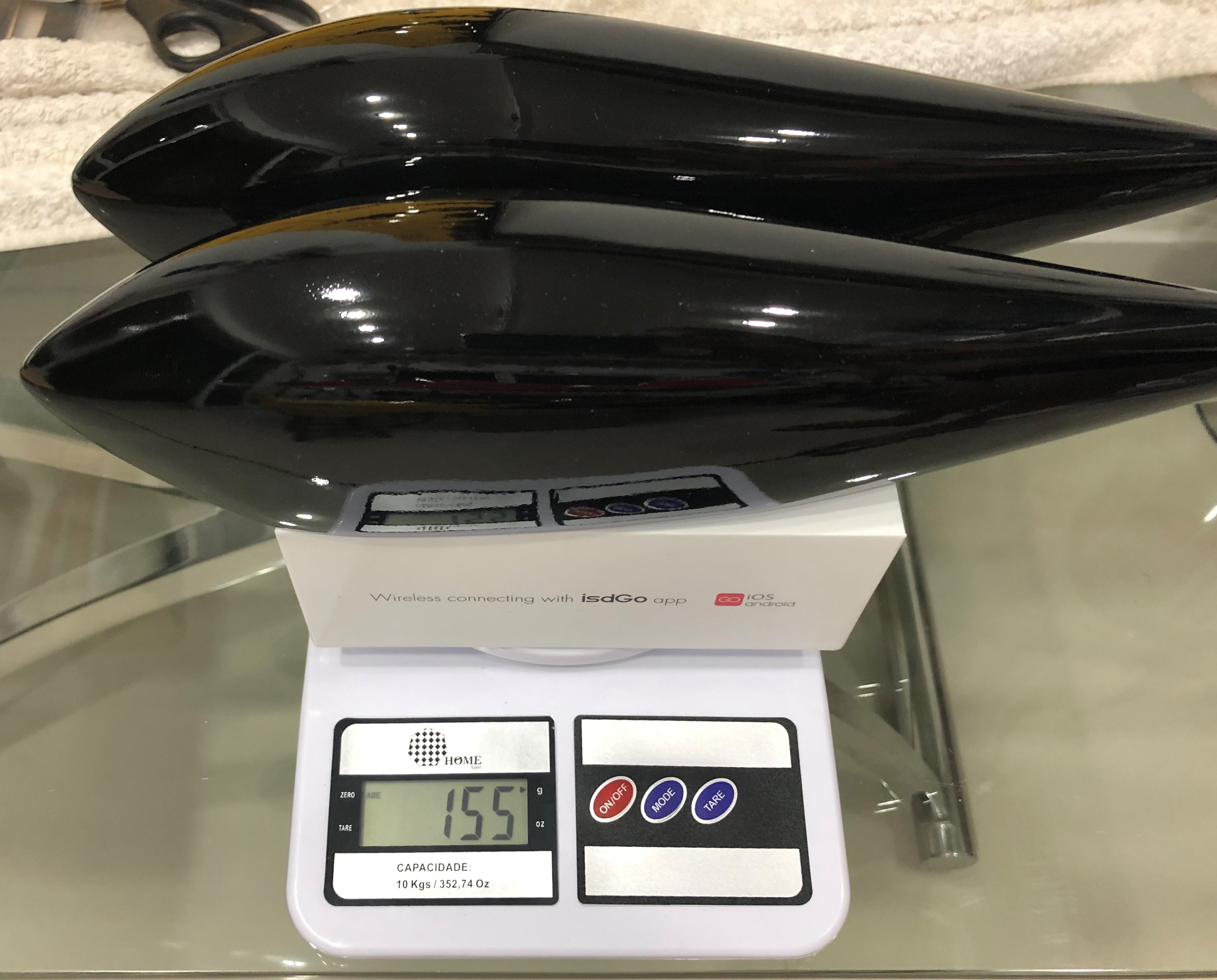

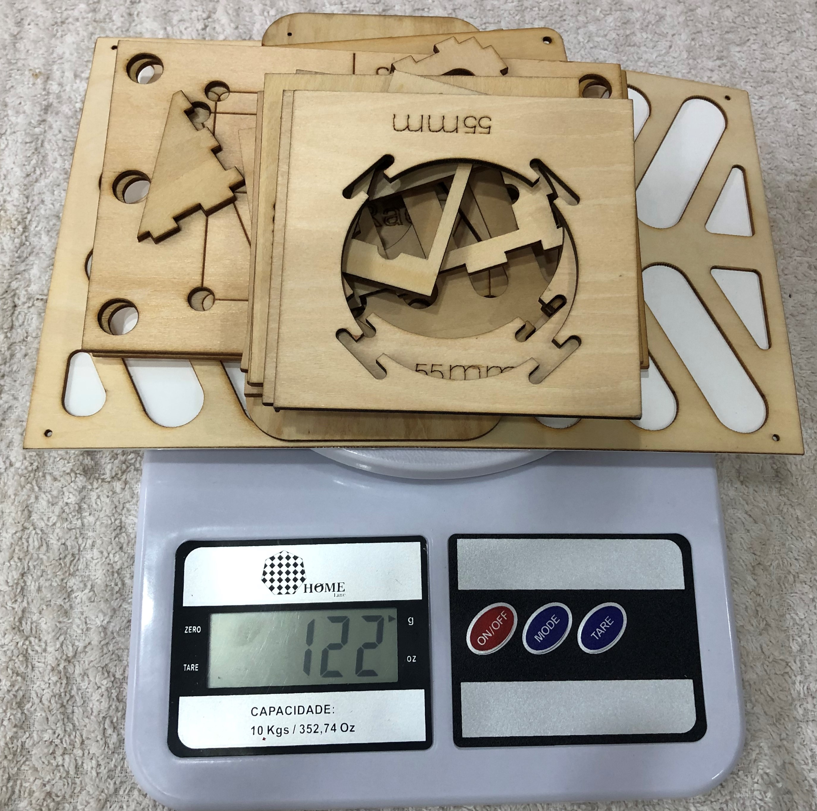

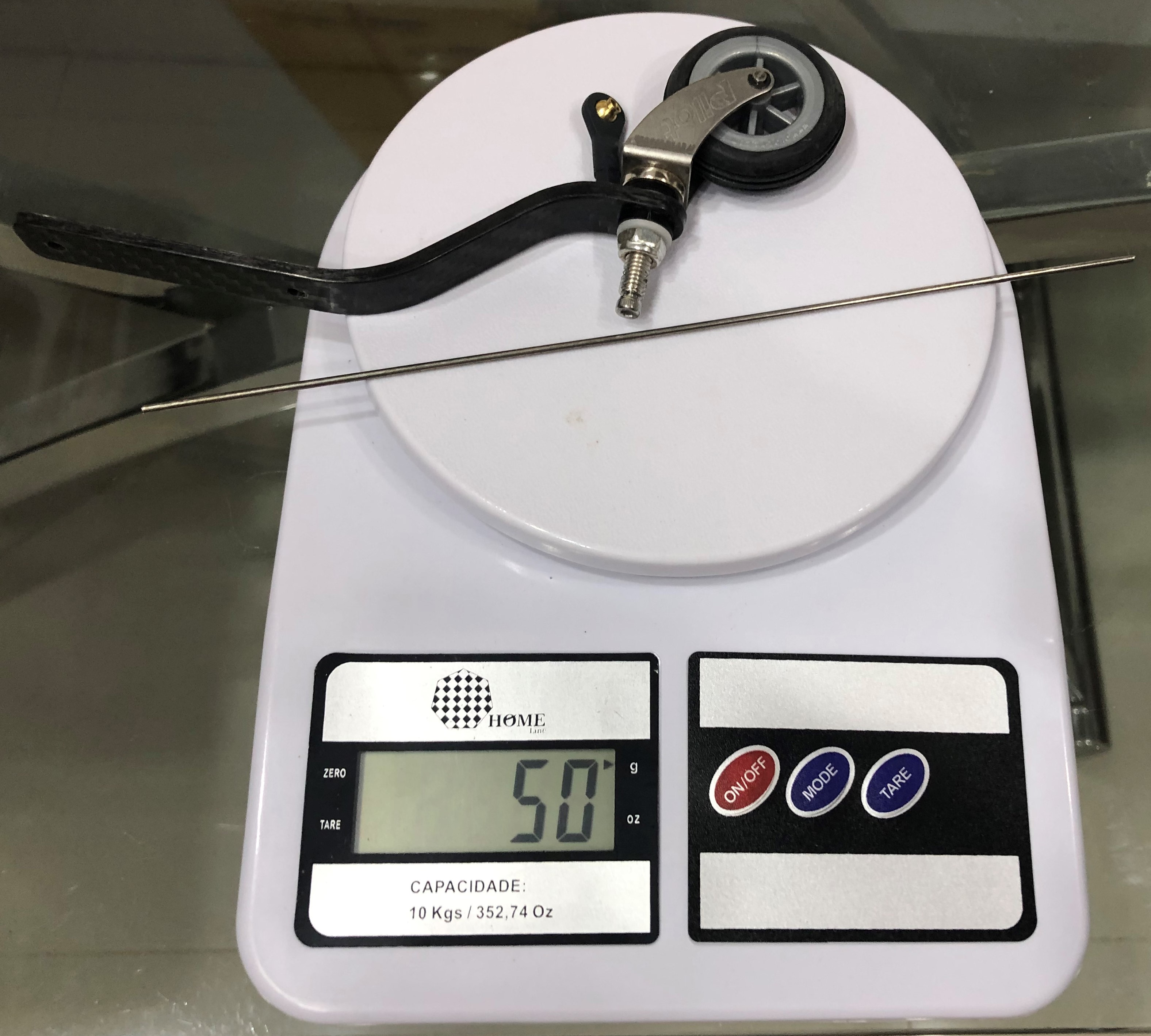

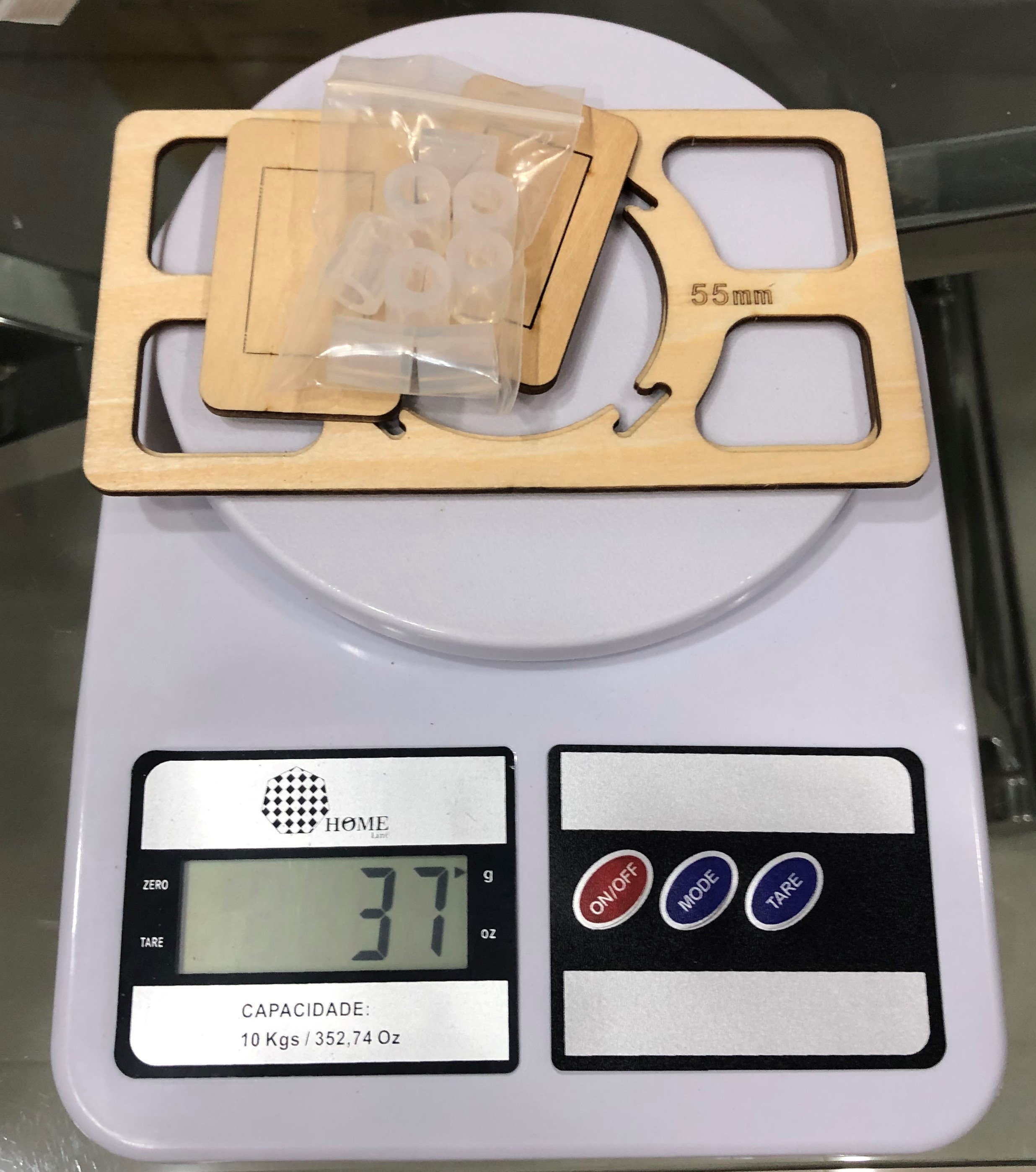

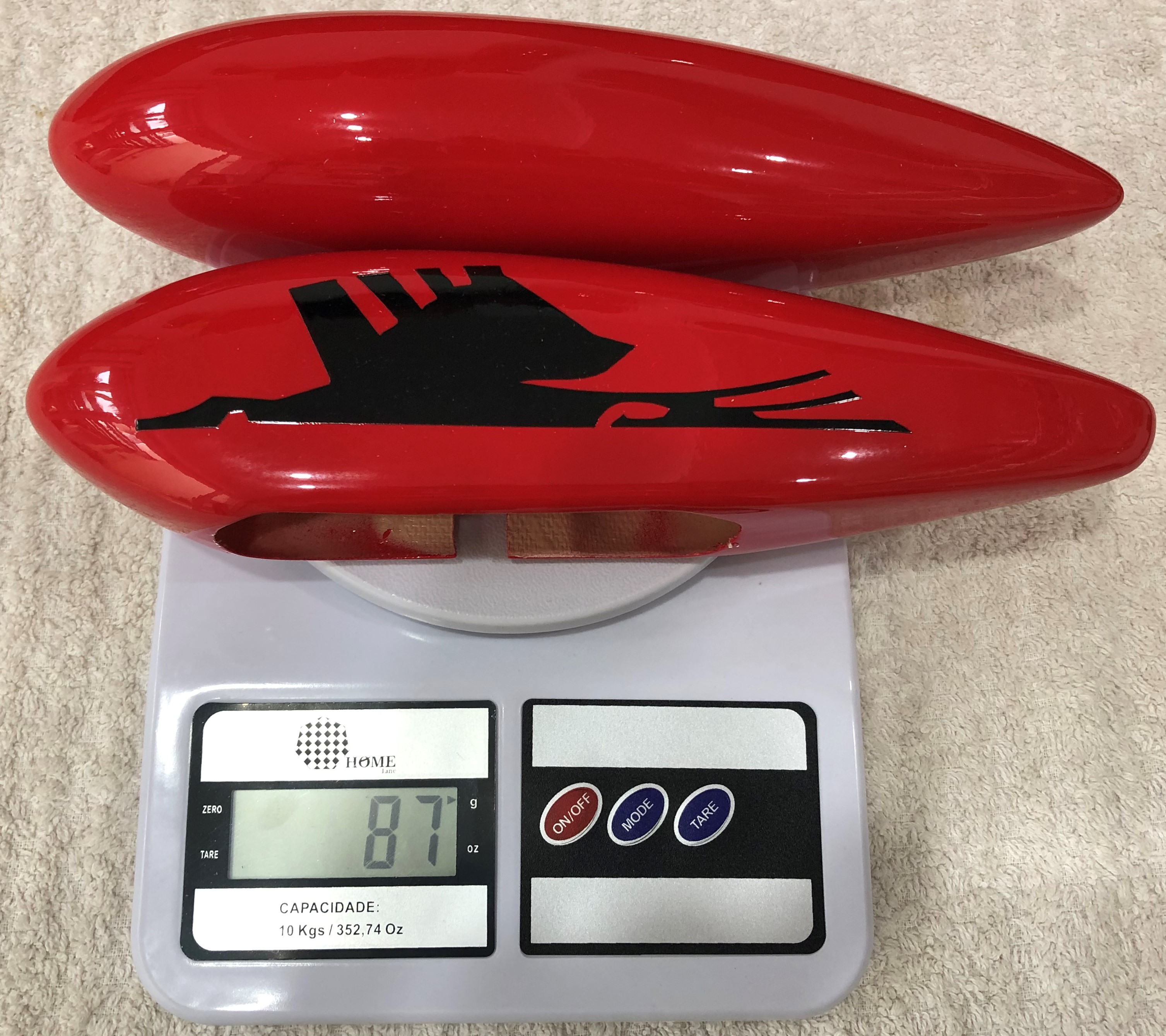

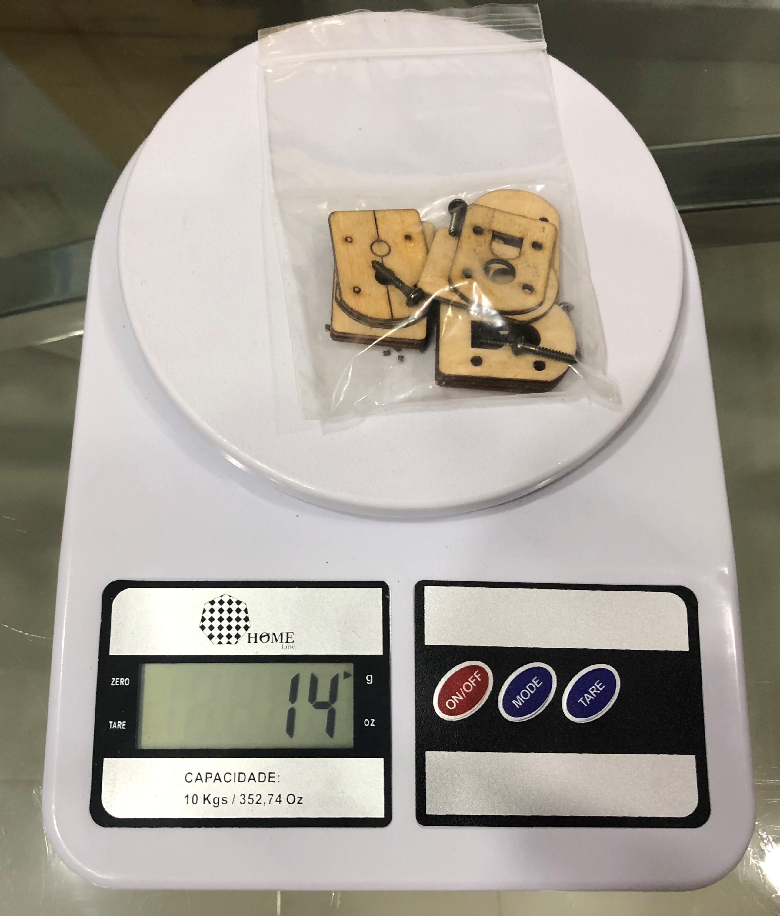

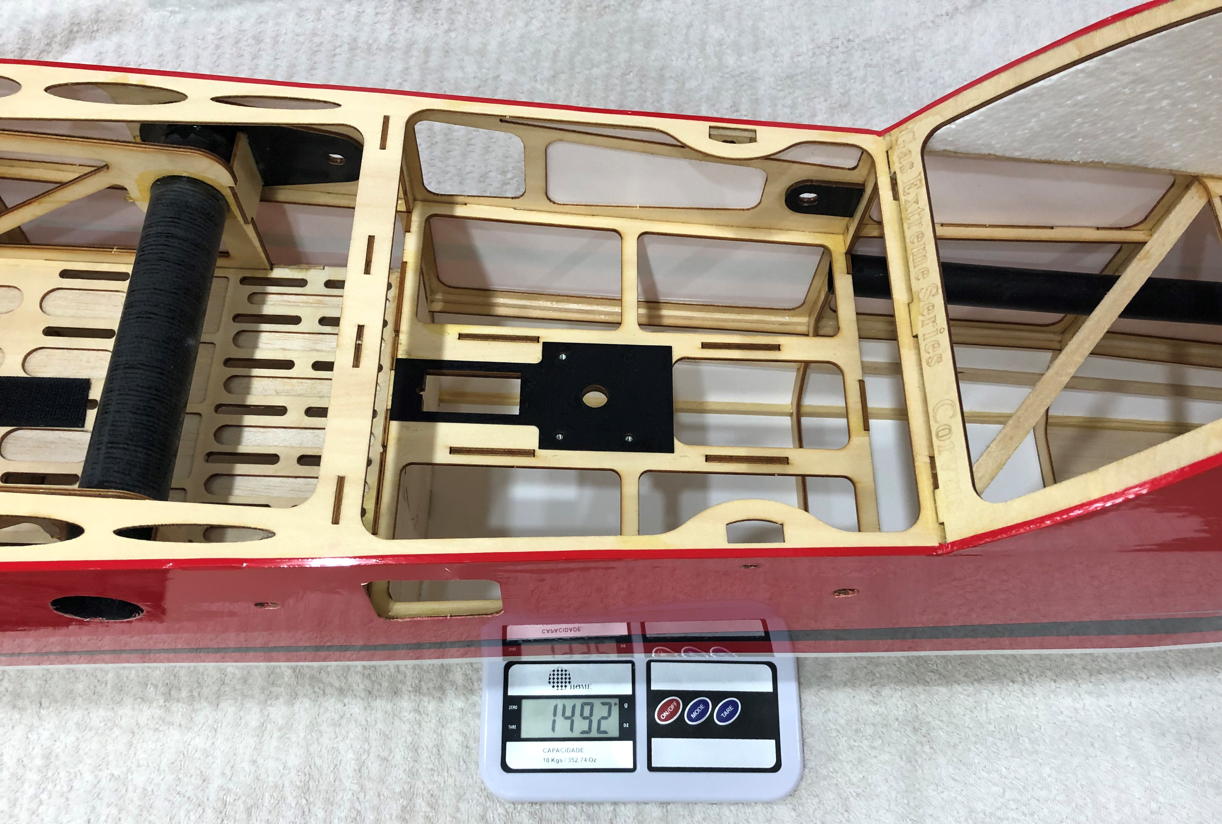

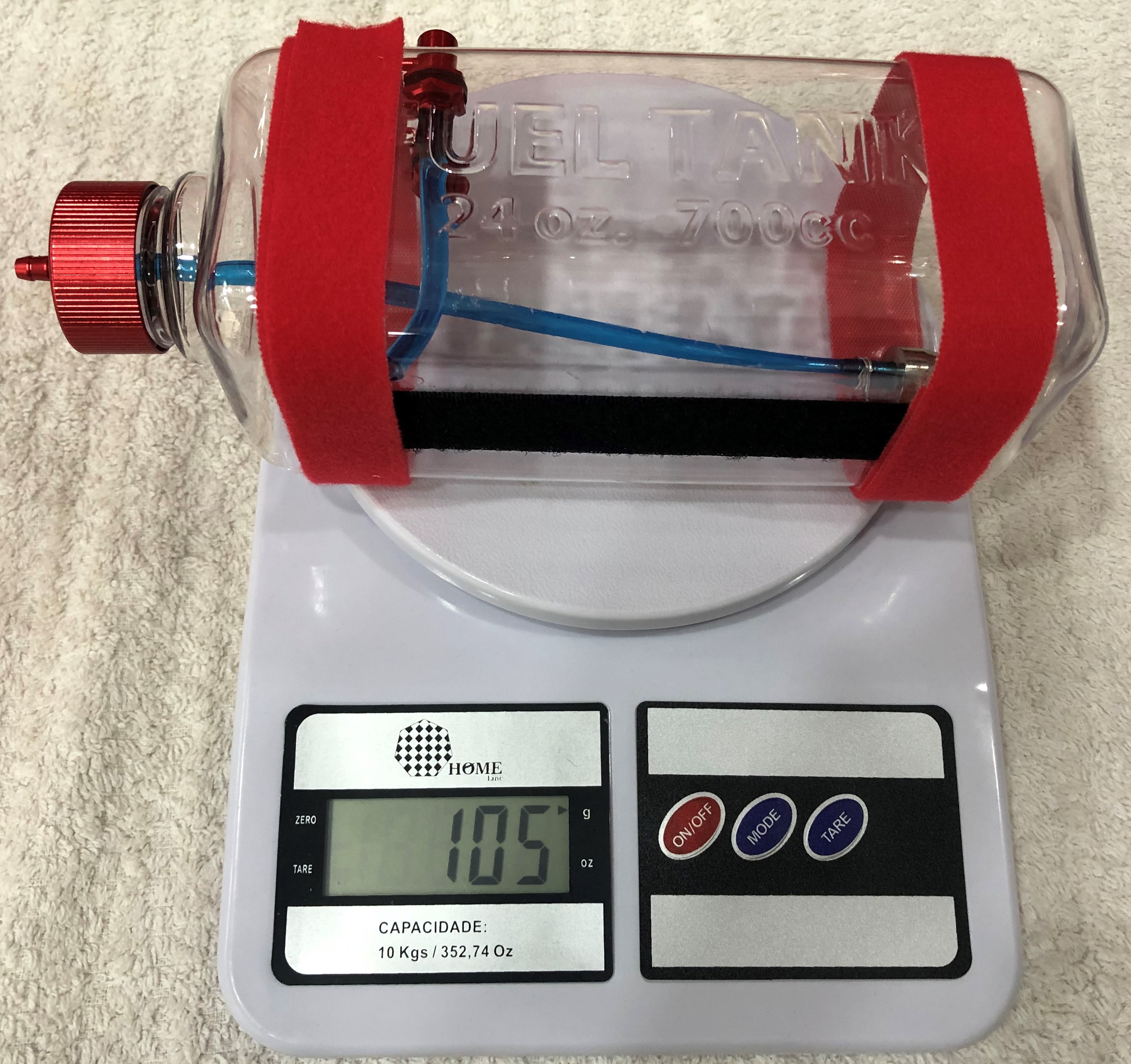

After 18 endless days it finally arrived. Very impressed with quality but my first perception was that the kit was a bit heavy. As I do with all my builds I took the time to weight the parts for reference and future comparisons.

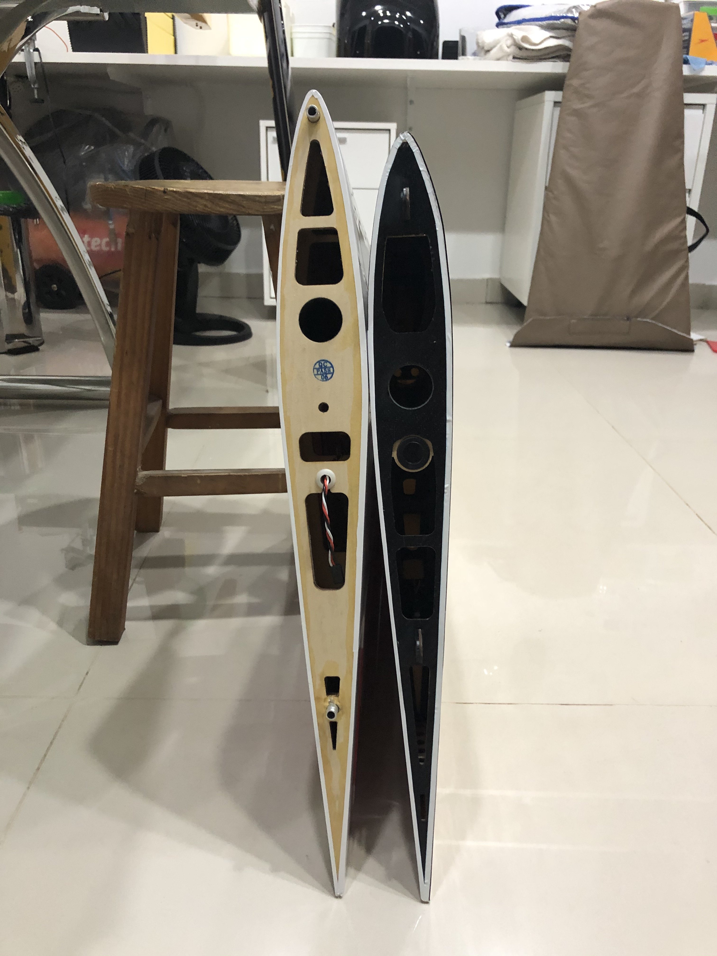

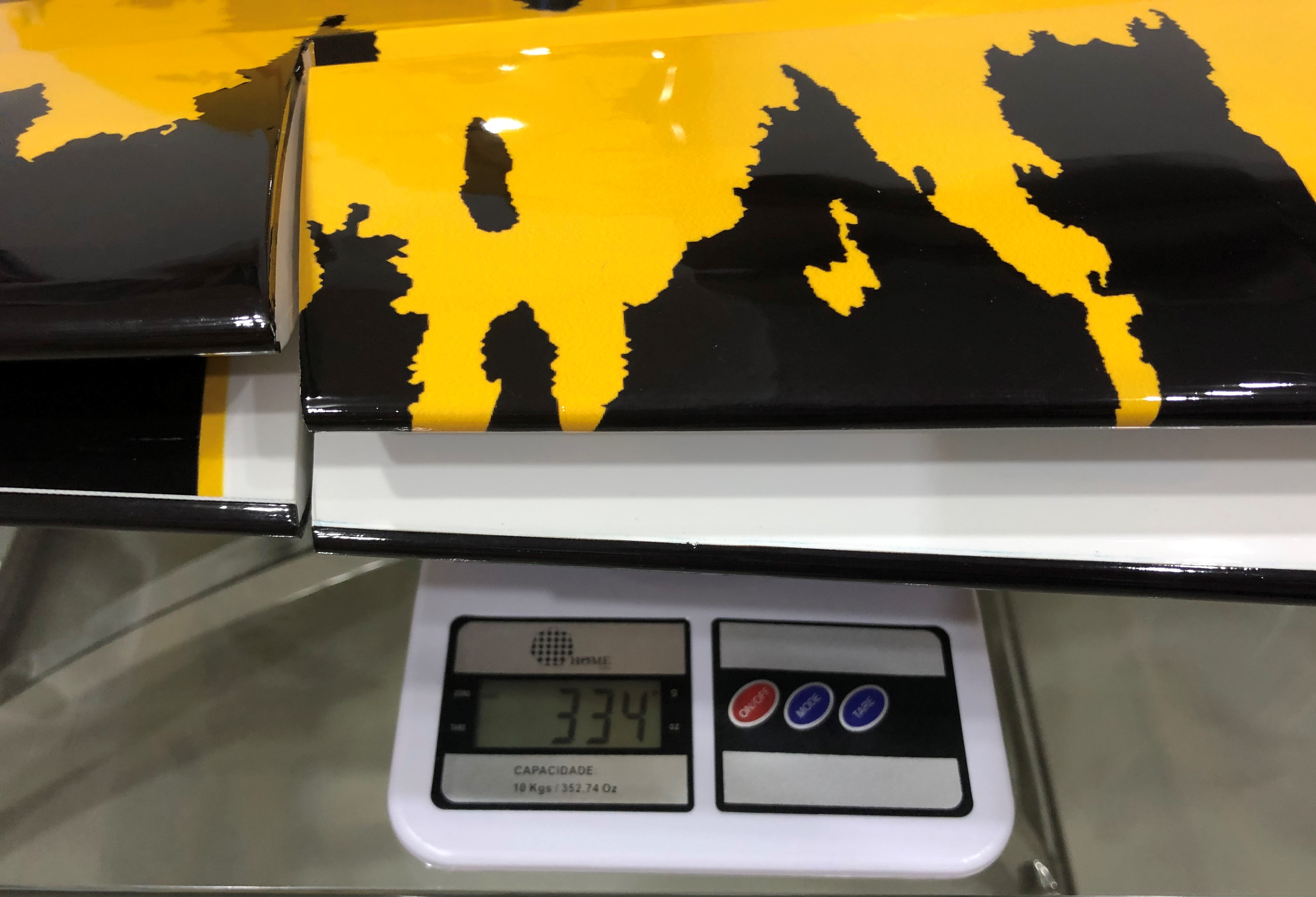

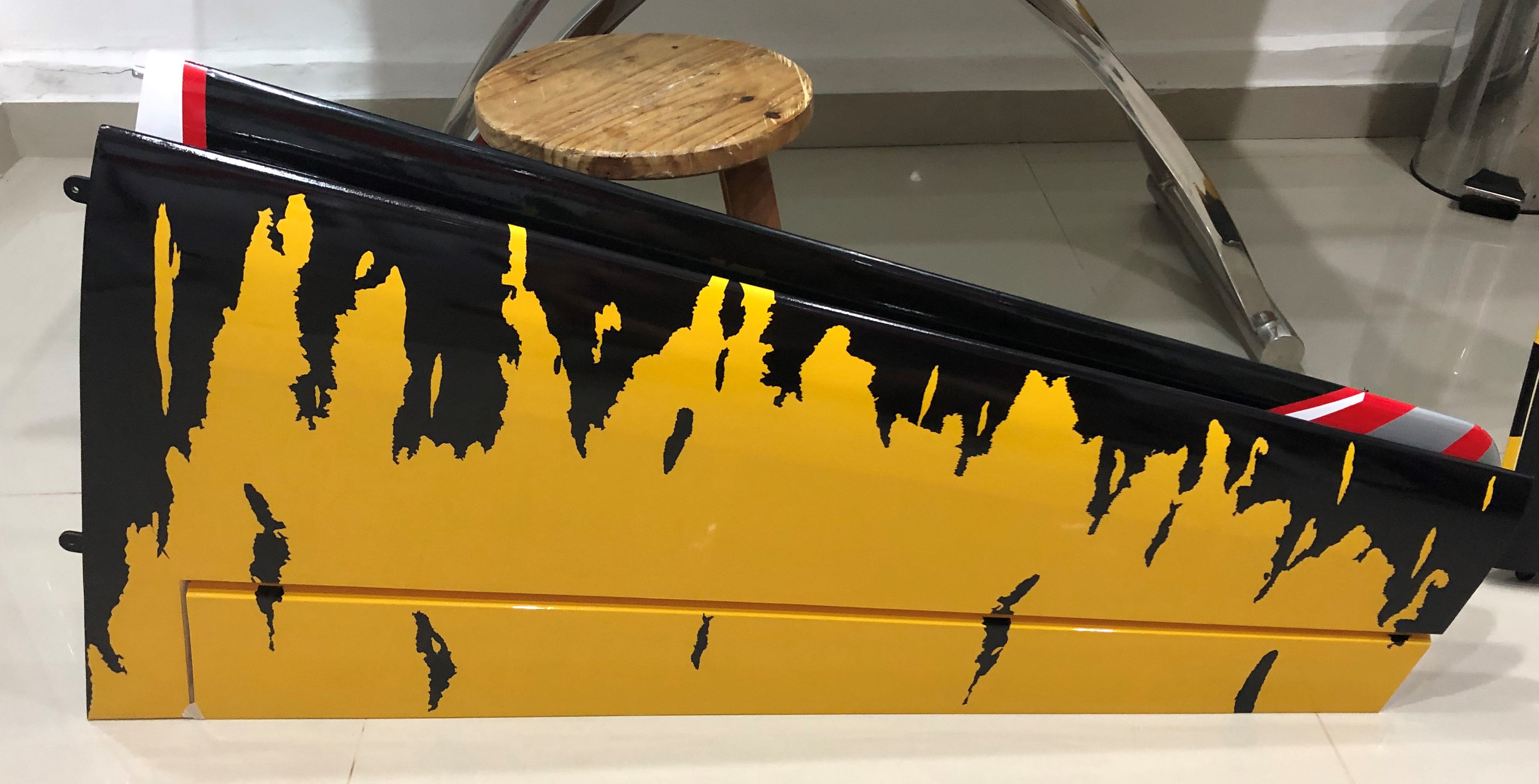

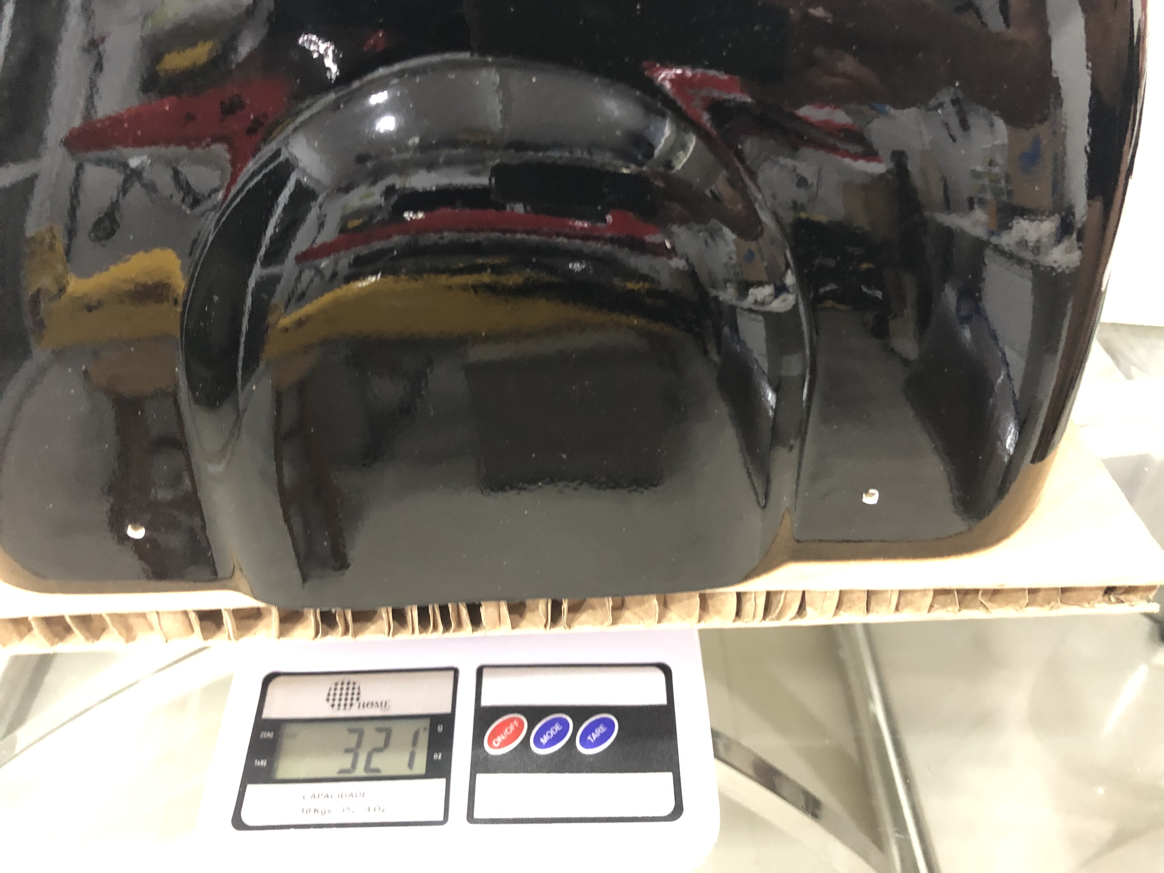

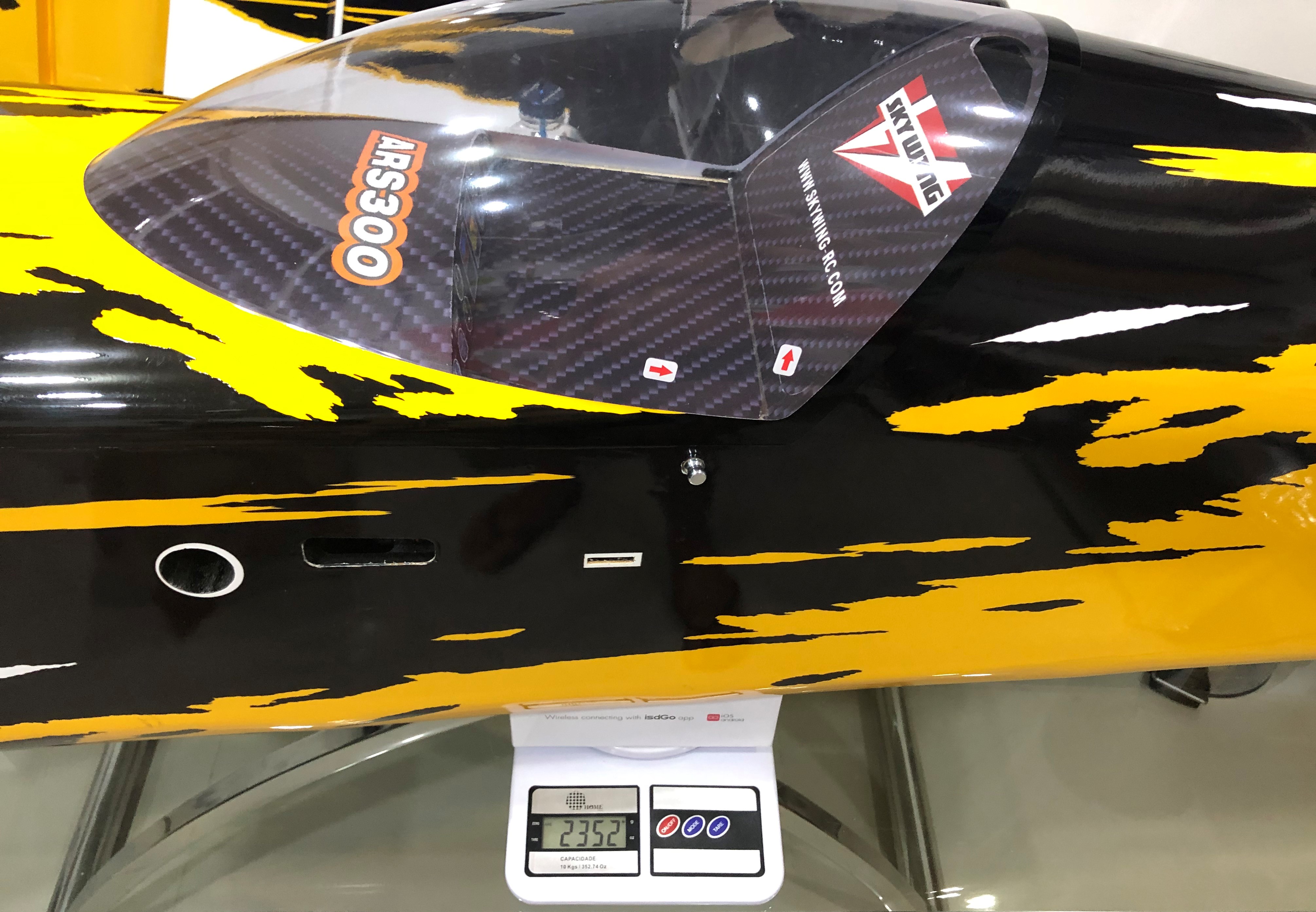

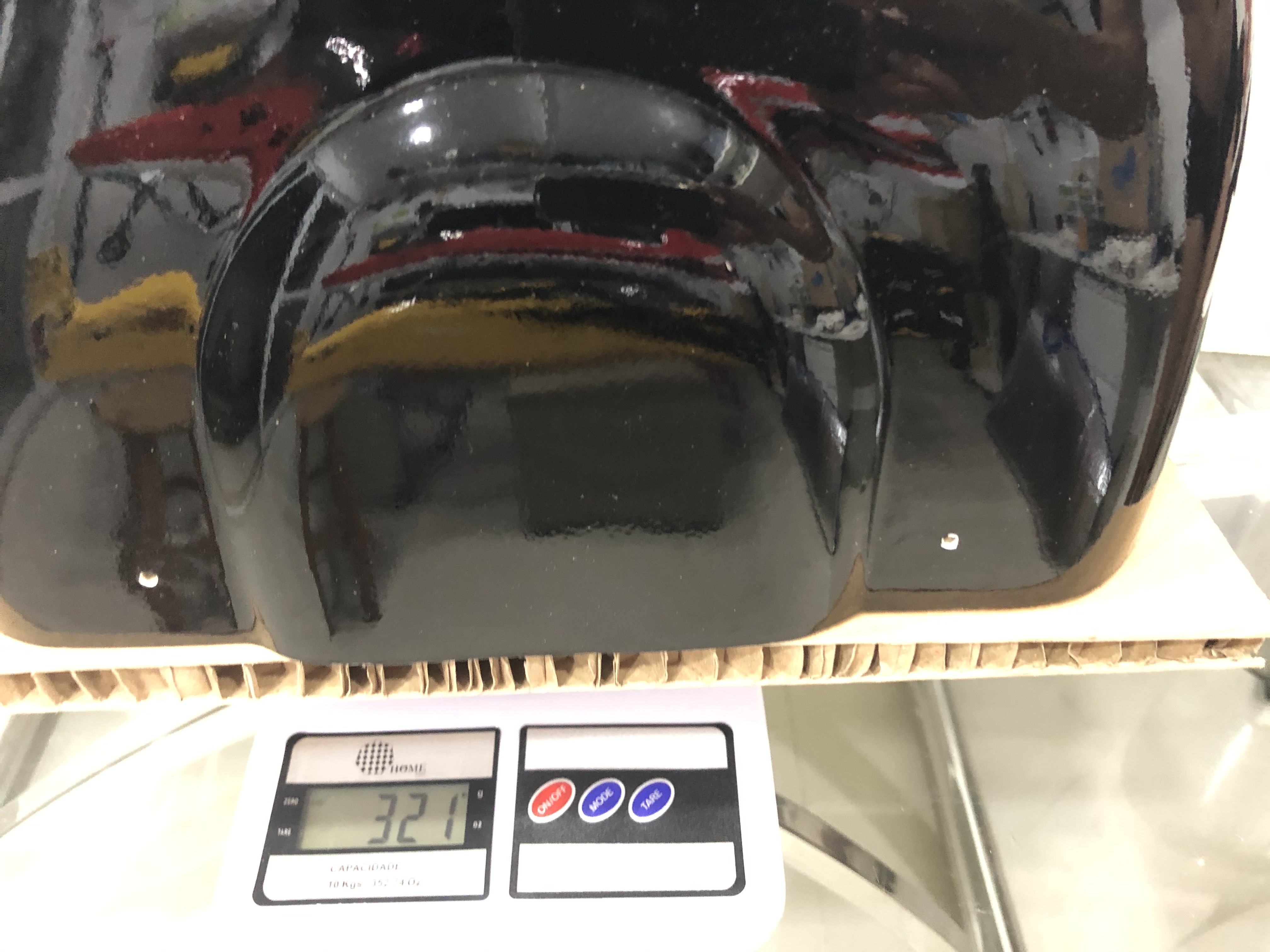

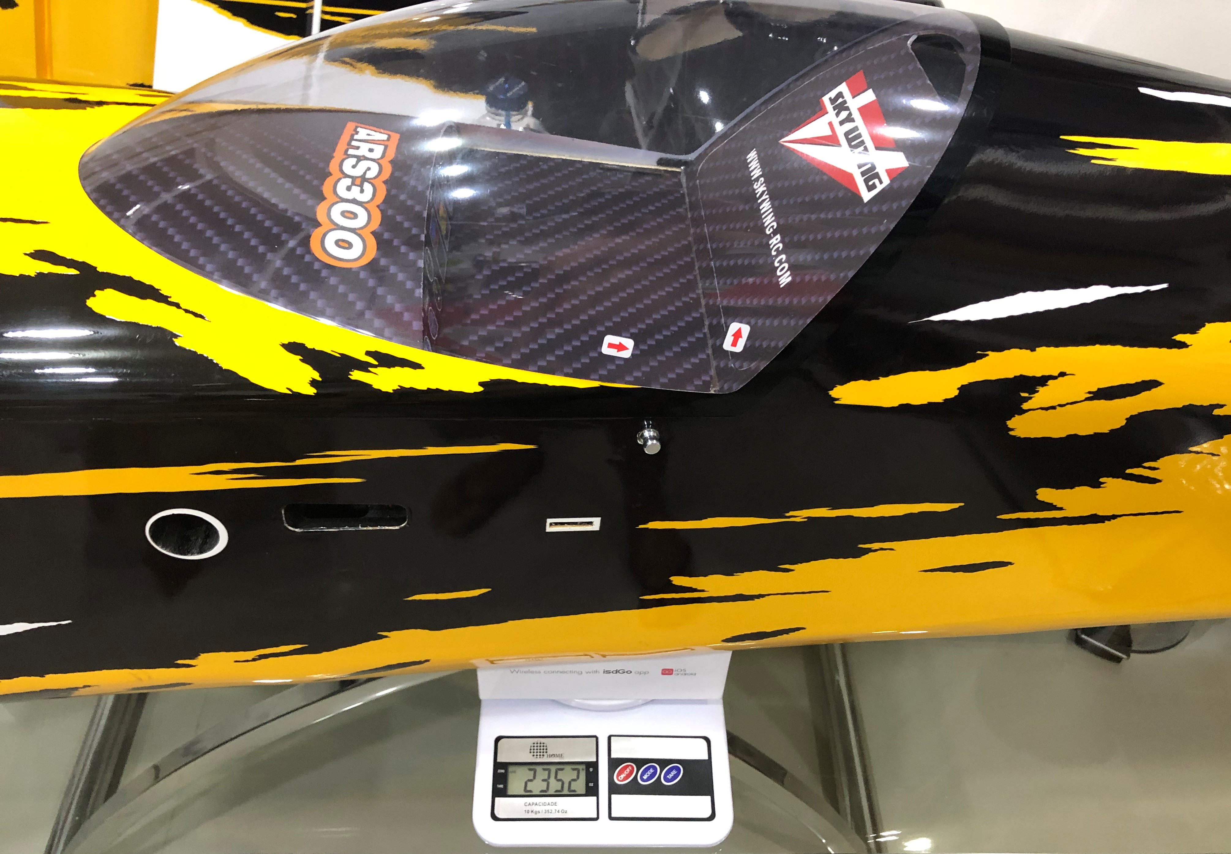

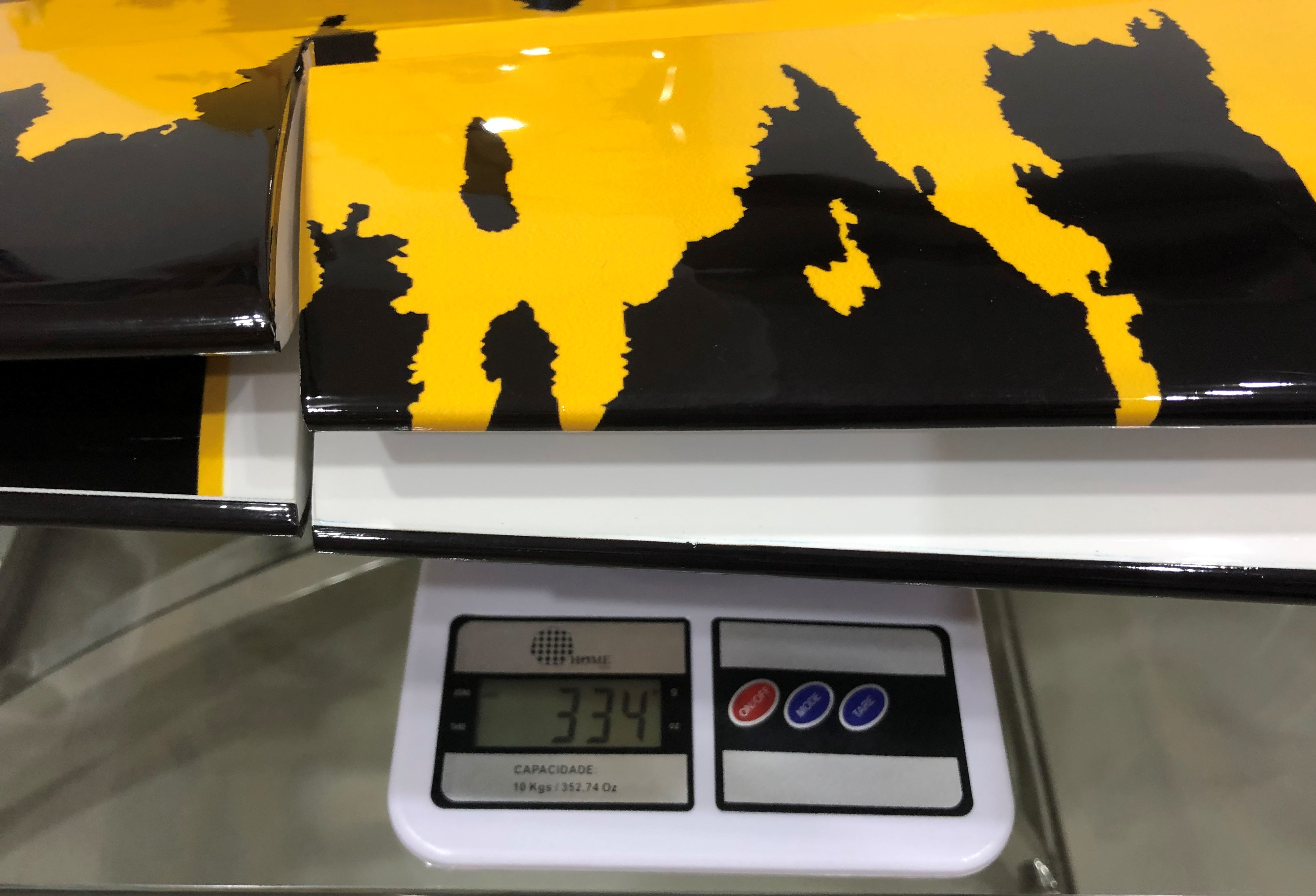

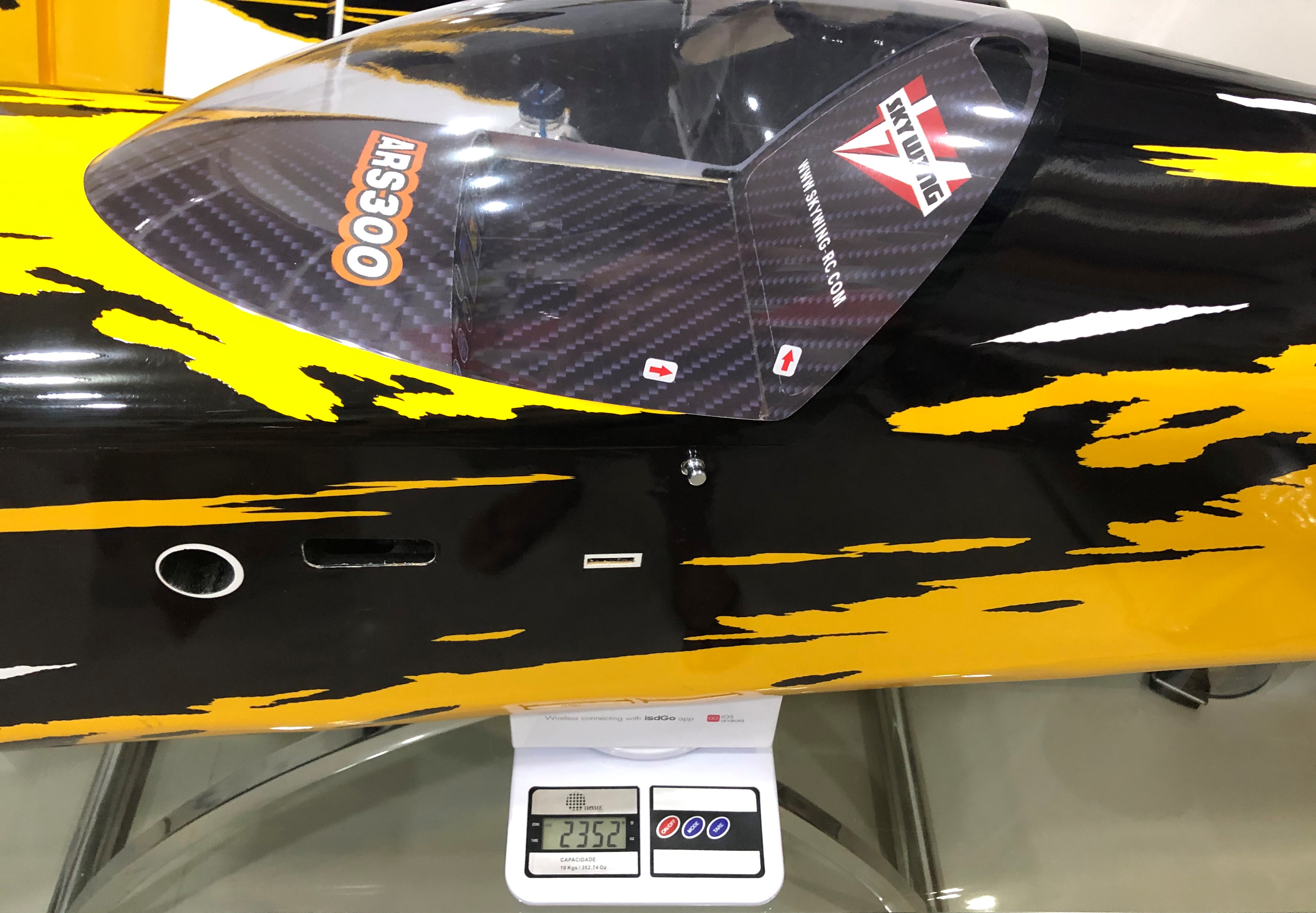

It is indeed heavier than my Corvus 91" except for the wings (which are smaller too). Main difference is on the fuse, the rest is quite close.
Corvus 60cc/ ARS300 91"
Fuse with canopy: 1781g / 2352g
Wings: 1322g/ 1283g
Cowling: 314g/ 321g
Stabs/ elev: 292g/ 334g
Total difference in these parts only=581g

Interesting, did you include the wing/tail mounting hardware with the goldwing? As it's built into the frame with the SW. Regardless, it's about a pound heavier by your comparison. The fuel tank could be lighter too, it's pretty robust. Thanks for sharing!
Ronaldo Nogueira
New to GSN!
Hello Nick, no I didn't include it, thanks for pointing out. Unfortunately, I did not weight the complete Corvus hardware or we could do the math now. I'm including a few more items from the Corvus on post #144 for comparison.
I just noticed I can't edit older posts so I'm including the pictures here.
The control surfaces are larger on the Corvus, except for the elevators which in the ARS extend all the way to the root as the stab is placed forward which eliminates the need to cut a chamfer to allow rudder deflection.
