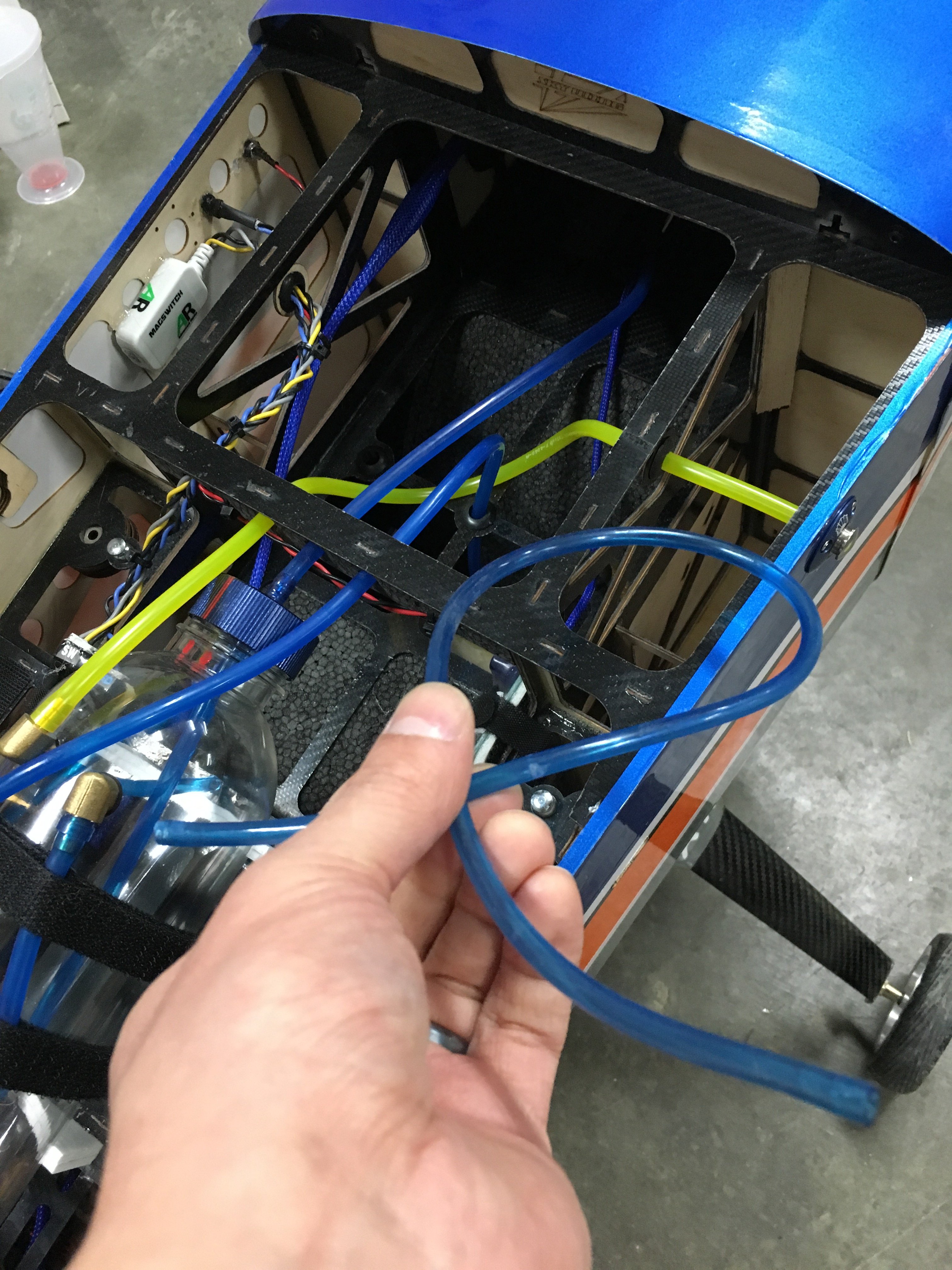

The magnetic fuel dot from NWRC has popped out 75% of the flights with the blue poly fuel tubing. Not like my spot on RC versions. Also that fuel tubing will pop off super easy after refueling and it’s a bear to get off for the first refueling. It has a step in it, no barbs. So I have switched to tygon there to see if the flexibility and softness will help... we shall see.

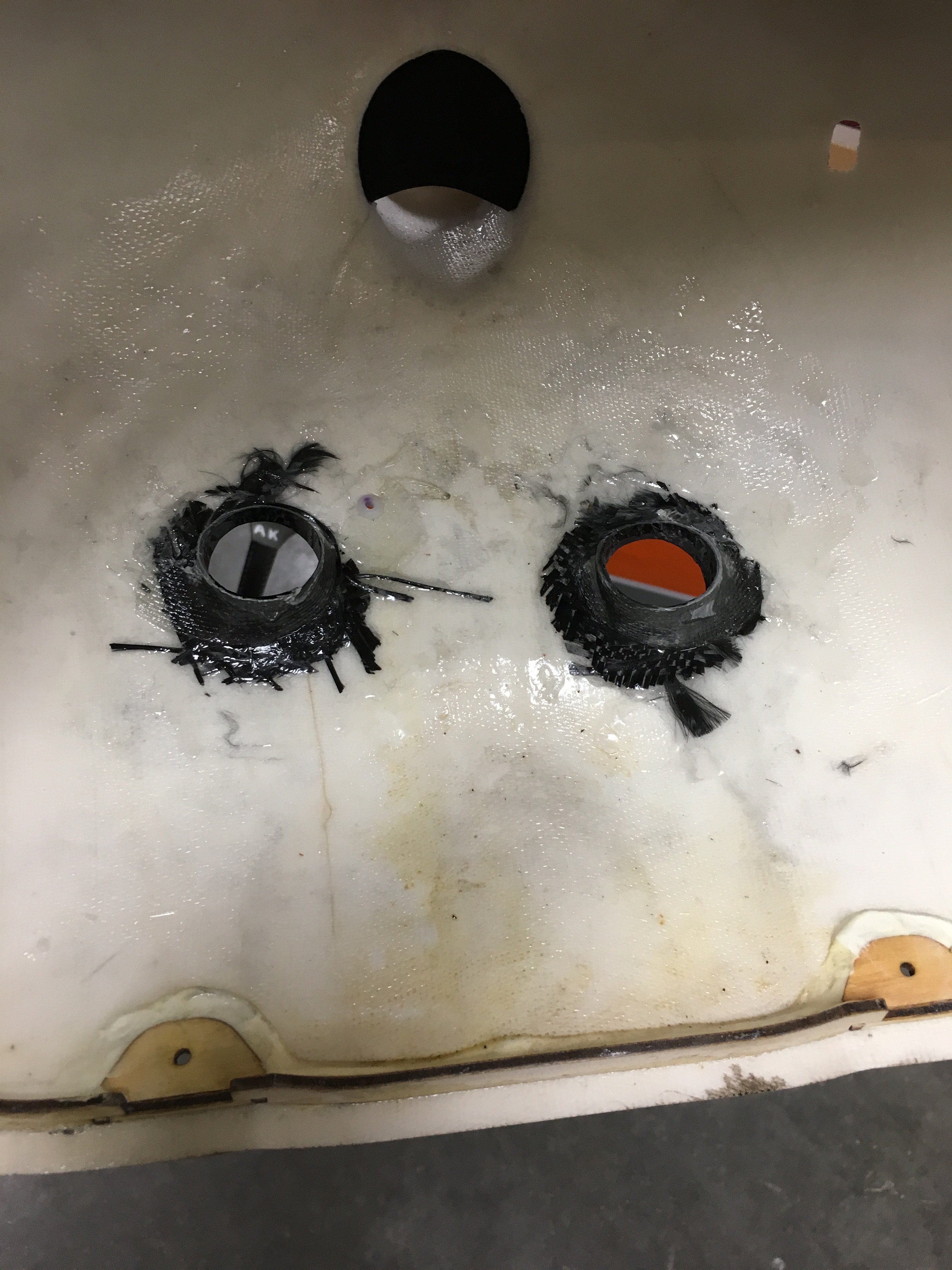

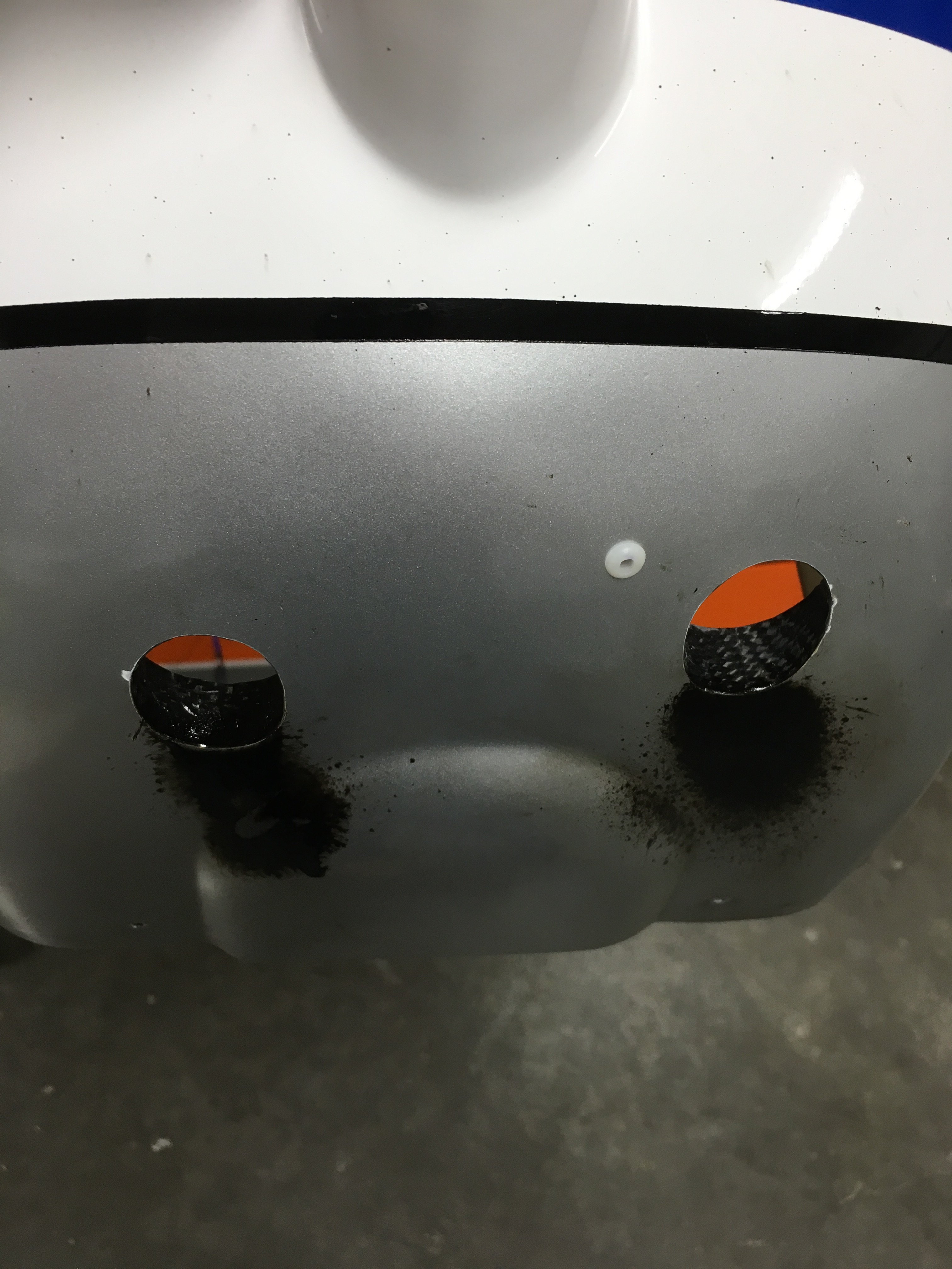

First off those cool little exhaust lips I made are working beautifully, not a single spit of black residue inside the cowling.
E780FF86-622B-4470-9E96-A243AACF57C0.jpeg 12BEE30B-227C-42FC-BE7B-898F9A073630.jpeg

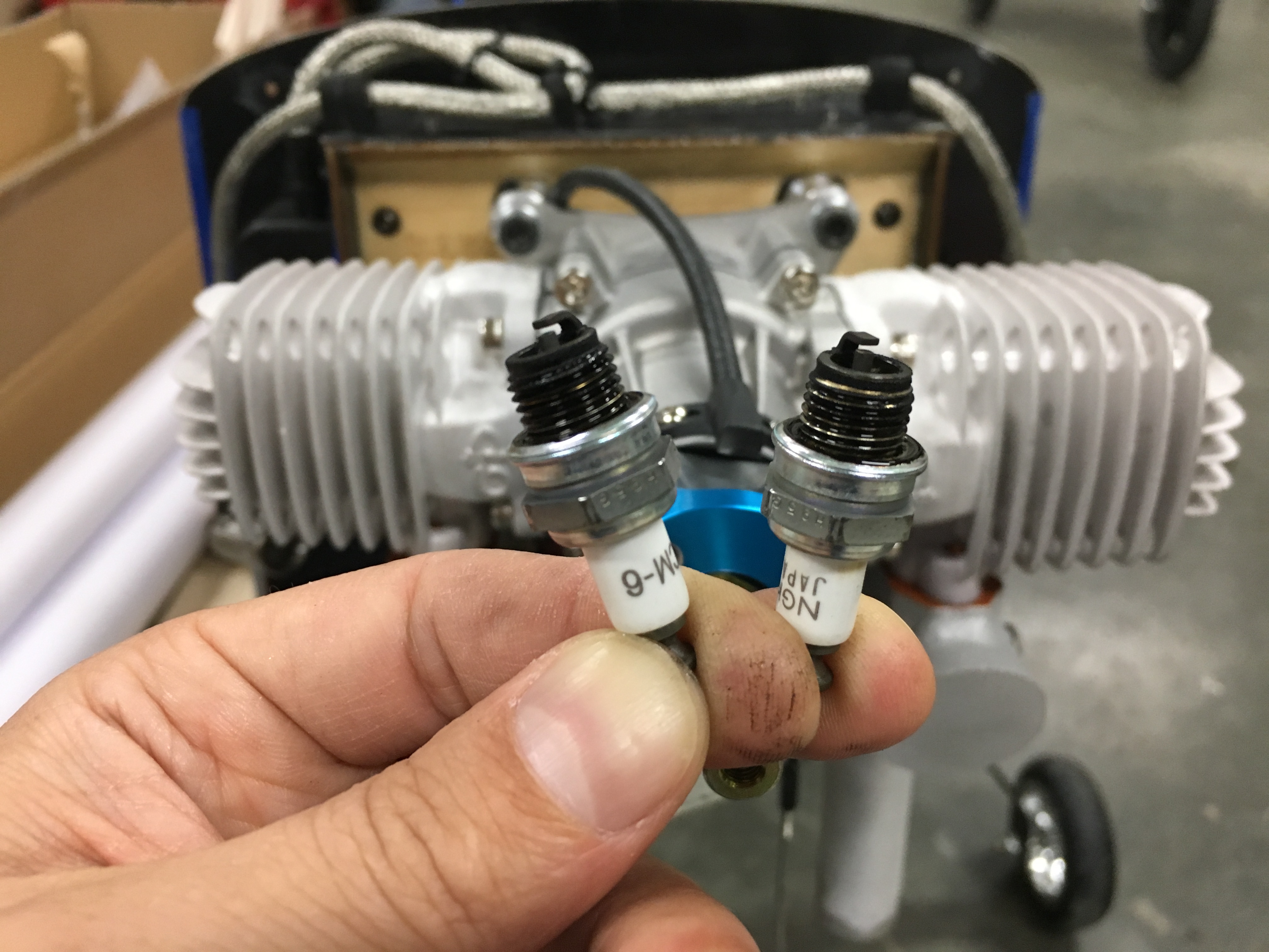

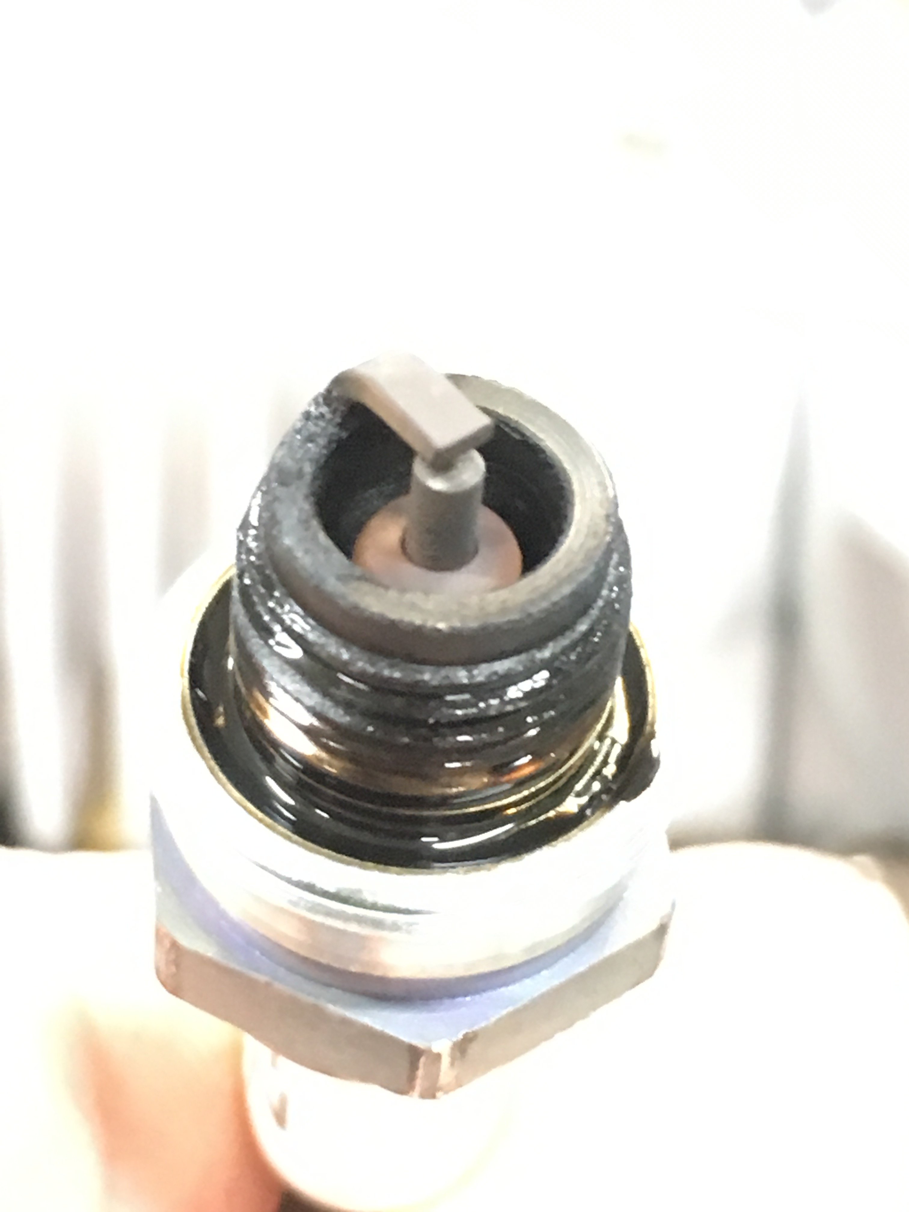

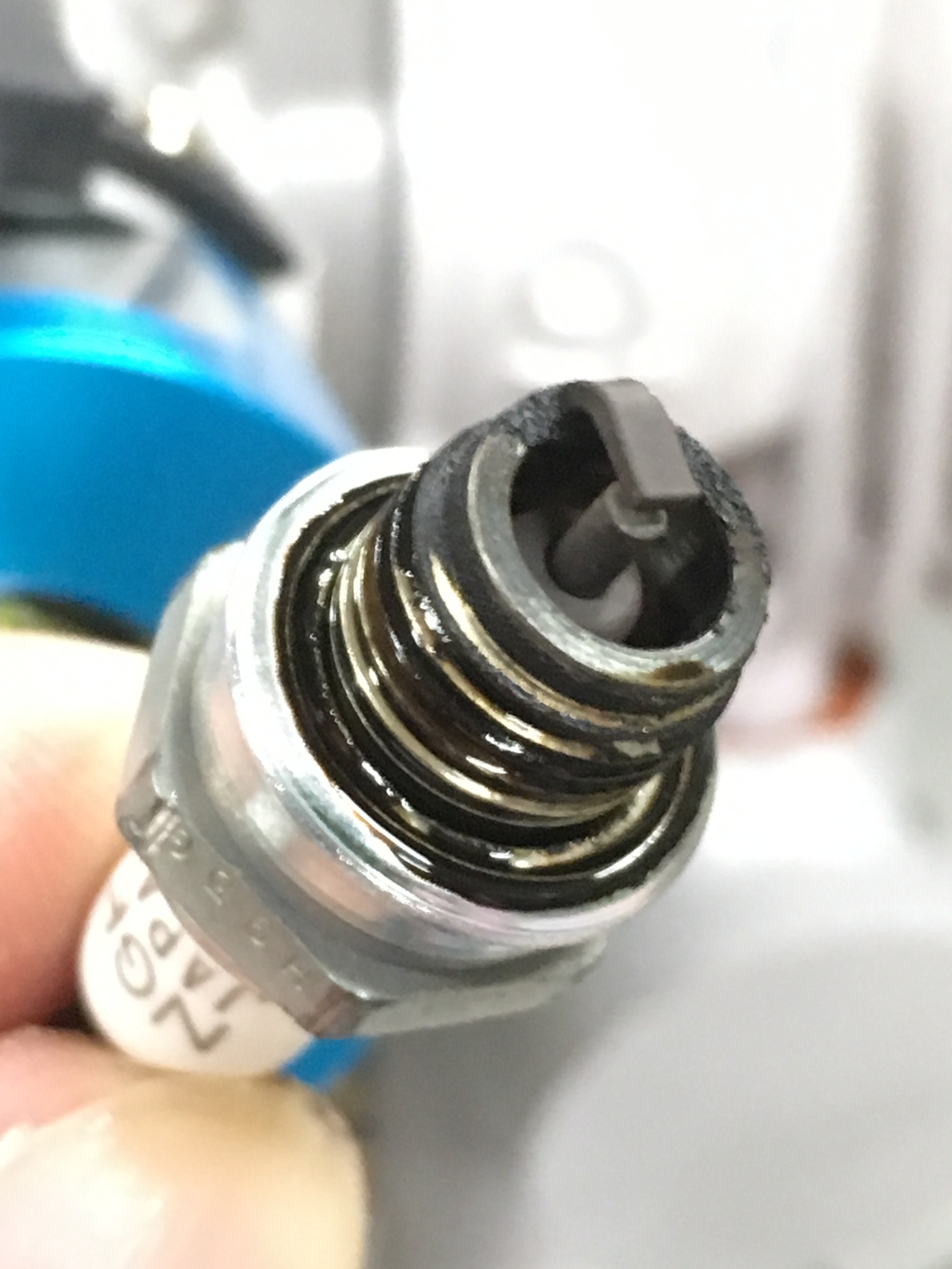

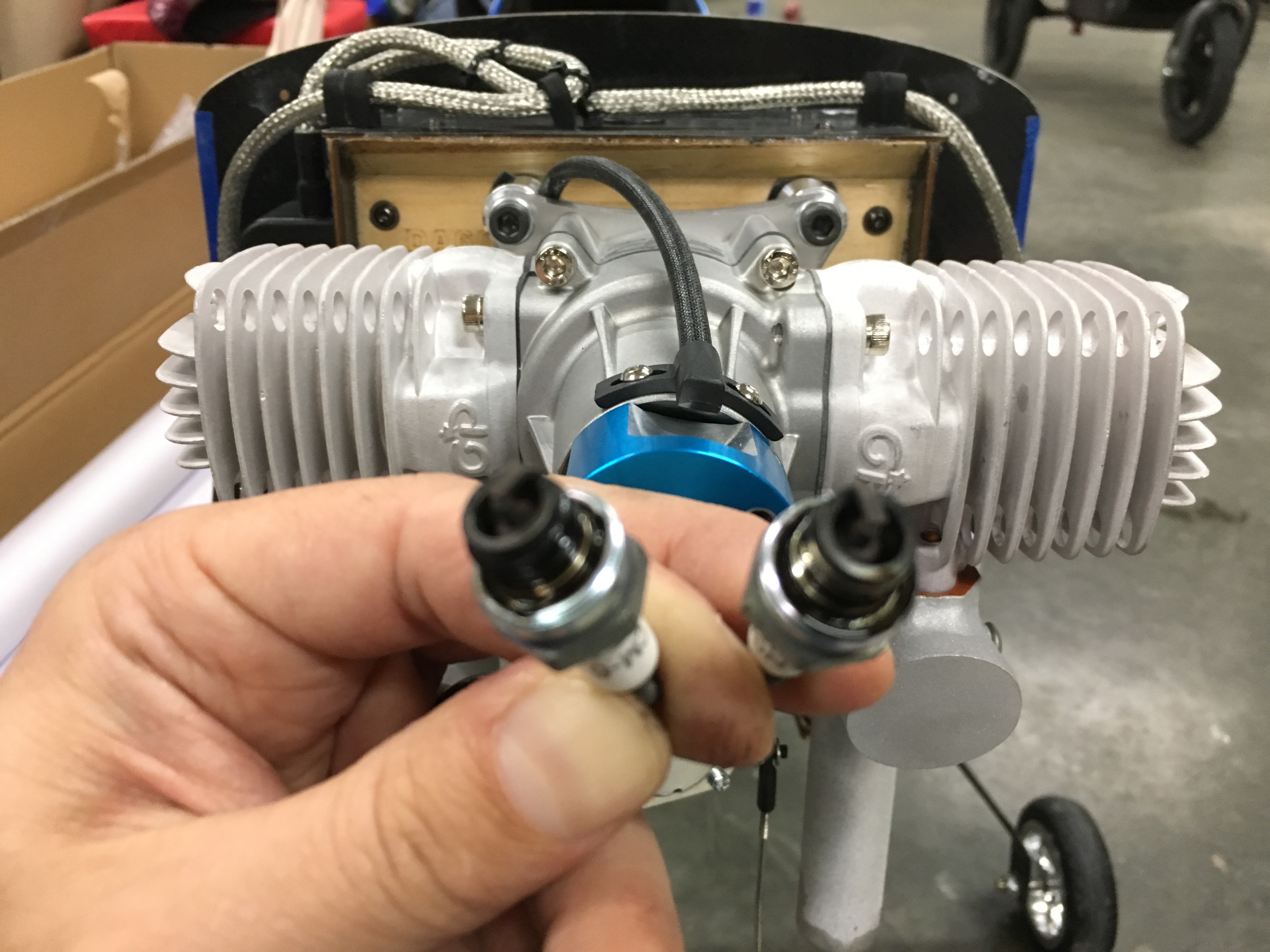

Next is I took the plugs out. Dark and gewy after 15 flights or so (10-15min each = about 3-4 hours of run time)
70548A8E-64E0-436B-8064-87C8858D2C20.jpeg 17CDF47D-5787-460E-AE60-200862103CD7.jpeg
Aircraft left:
Aircraft right:
Both plugs gap checked at 0.020”

Also switching to tygon for the fill line helped. The line stayed in the last four flights, and also grabs to the fitting better.
