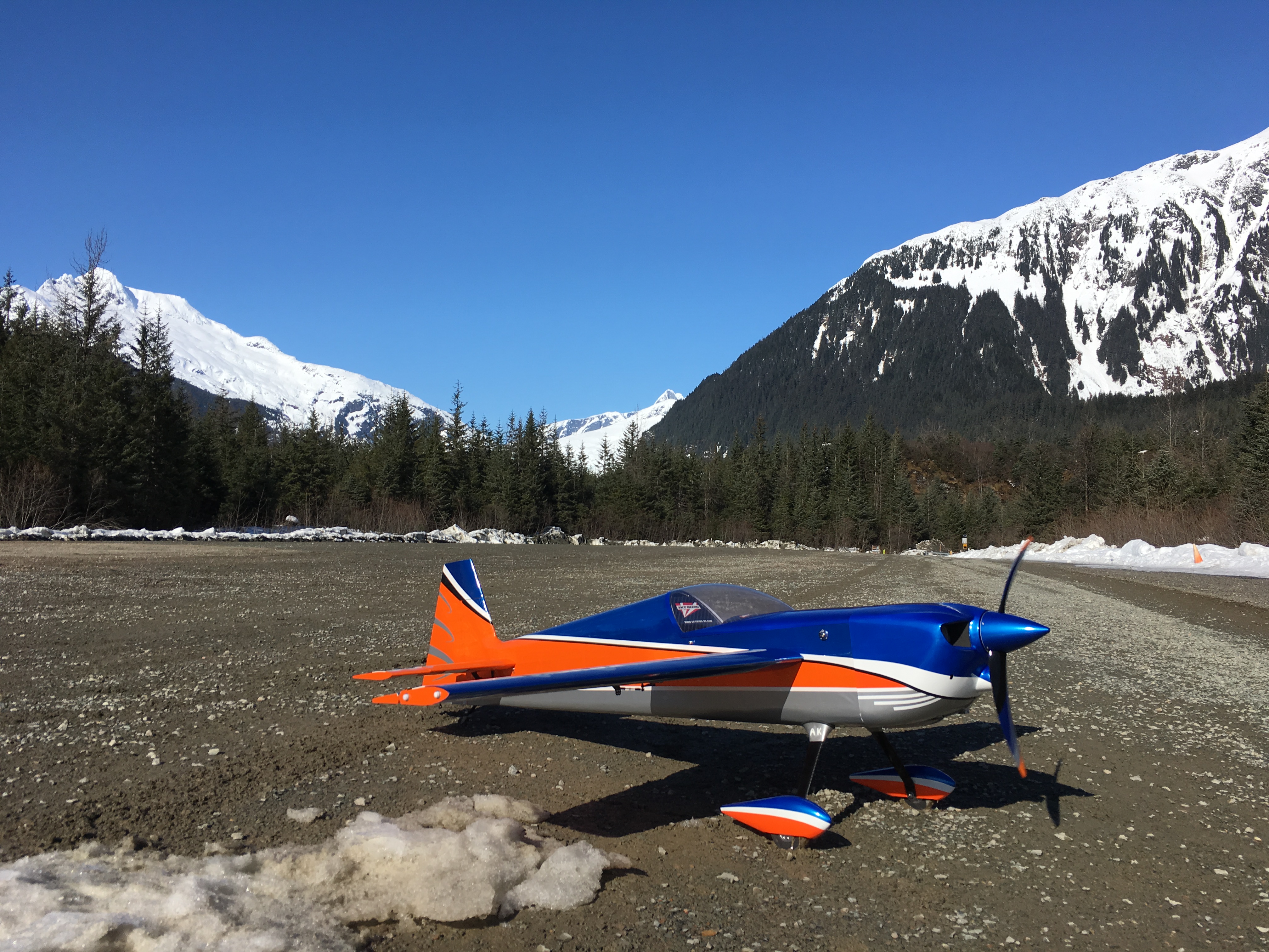

Got two more flights on this baby.
It was chilly, close to freezing, little swirly gusty wind from the glacier froze my fingers!

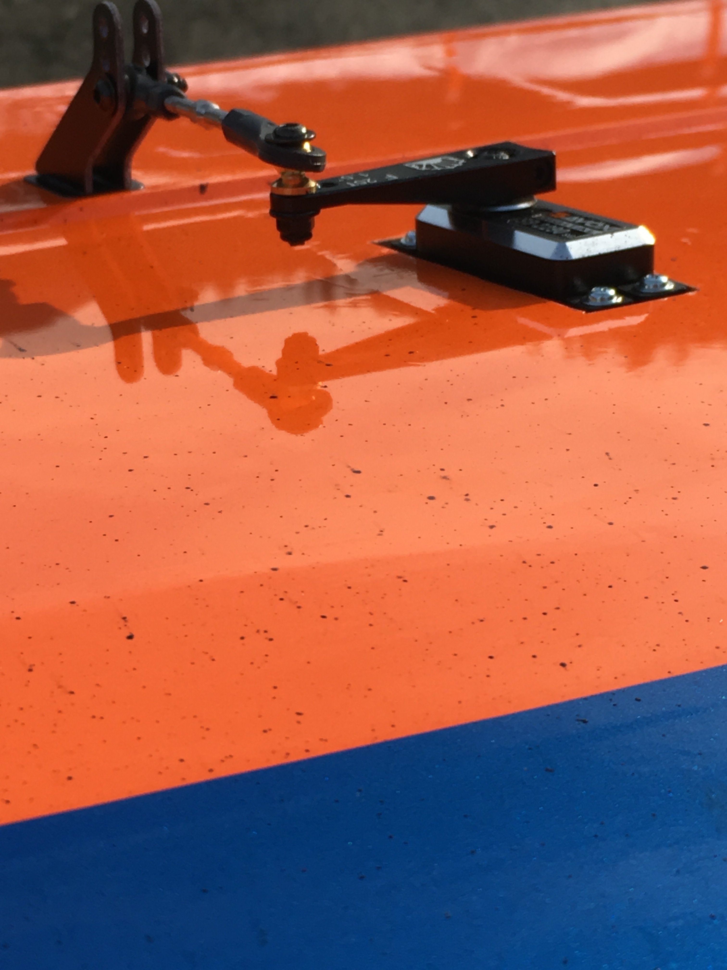

I need to fine tune the travel limits, the current deflections in maneuvers will stop the plane like an airbrake... kinda scary actually. Crazy tail authority. Other than that, the plane is predictable and fun to fly. Still breaking in the motor.

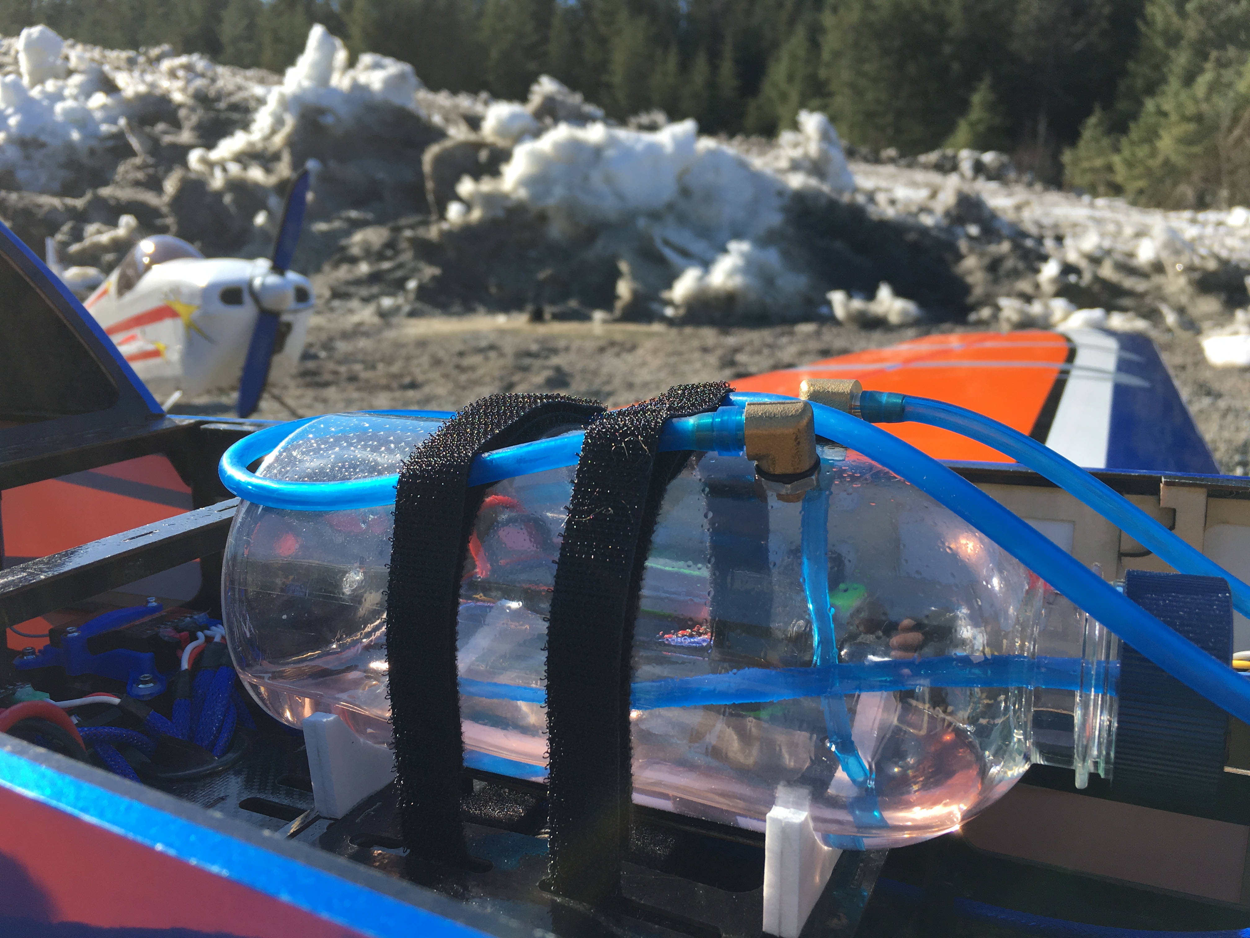

15-16min and the tank looks like this: so a timer at 14min is a good starting point

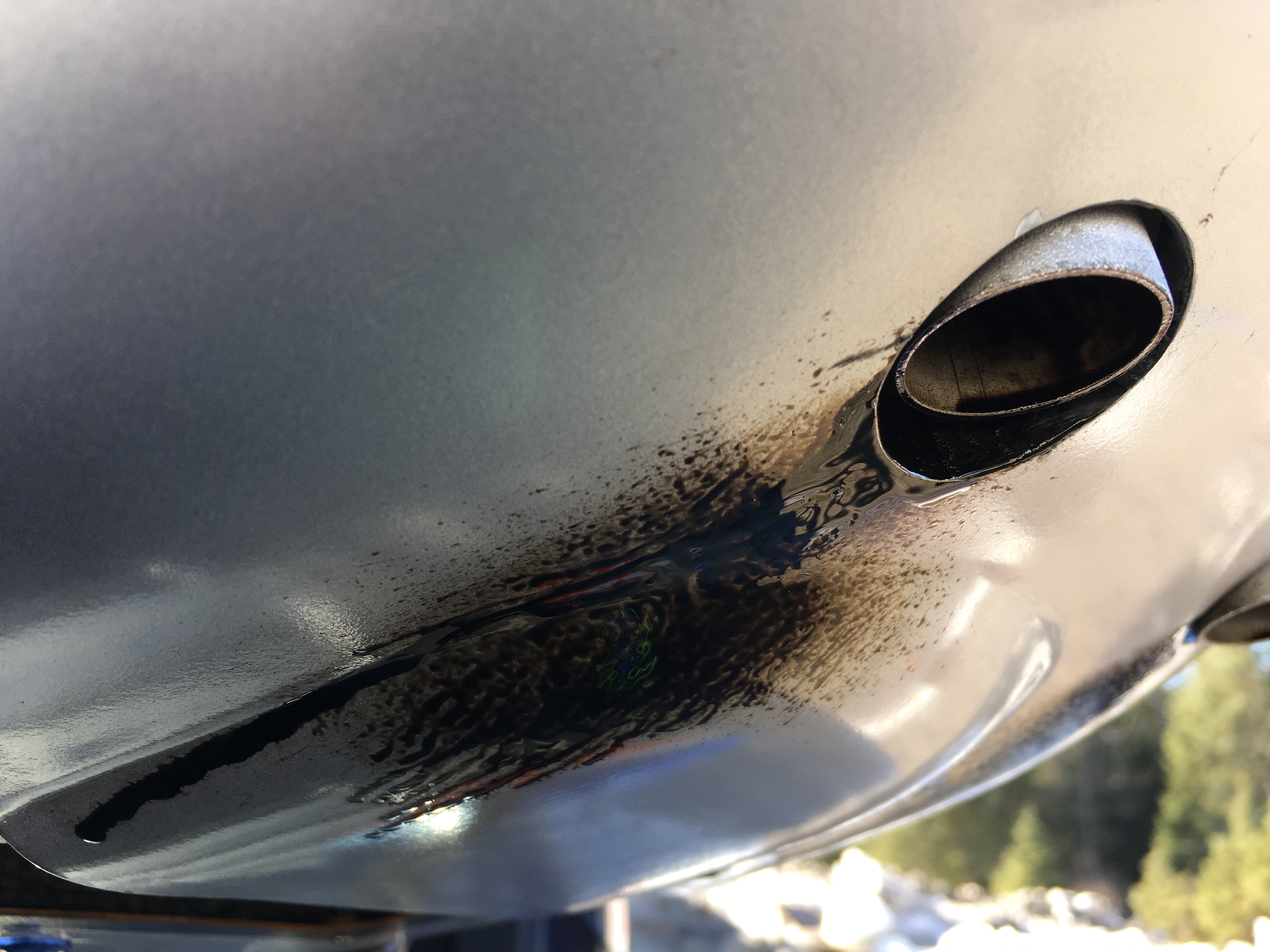

My little carbon lip seems to be working.

After four more flights I’m learning how the plane flies. It’s easy to give it too much elevator so I need to learn to tame my thumbs and rates. Each 14-16 min flight has averaged about 425mAh per flight. 14 min of flying is a safe place to stop with reserve if you are doing a lot of higher rpm stuff.

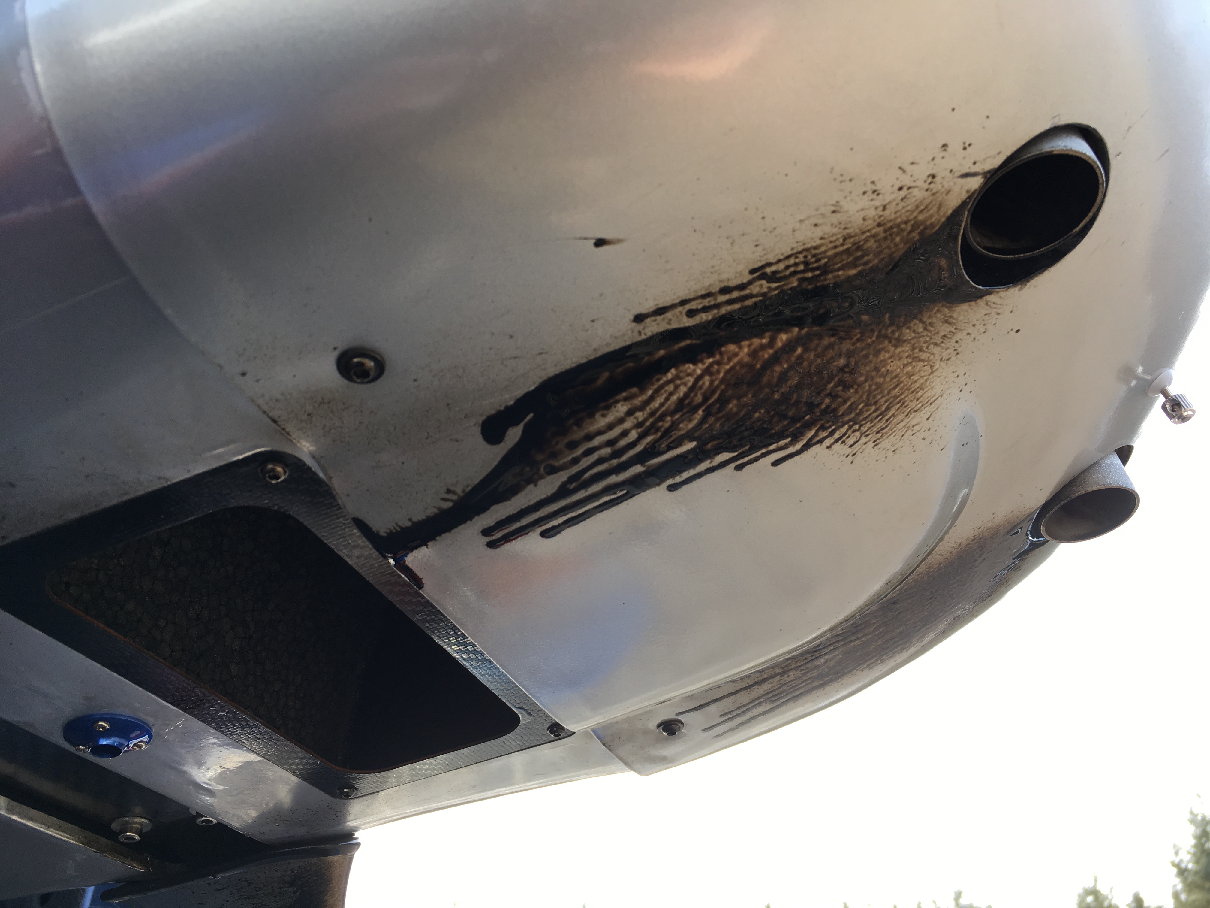

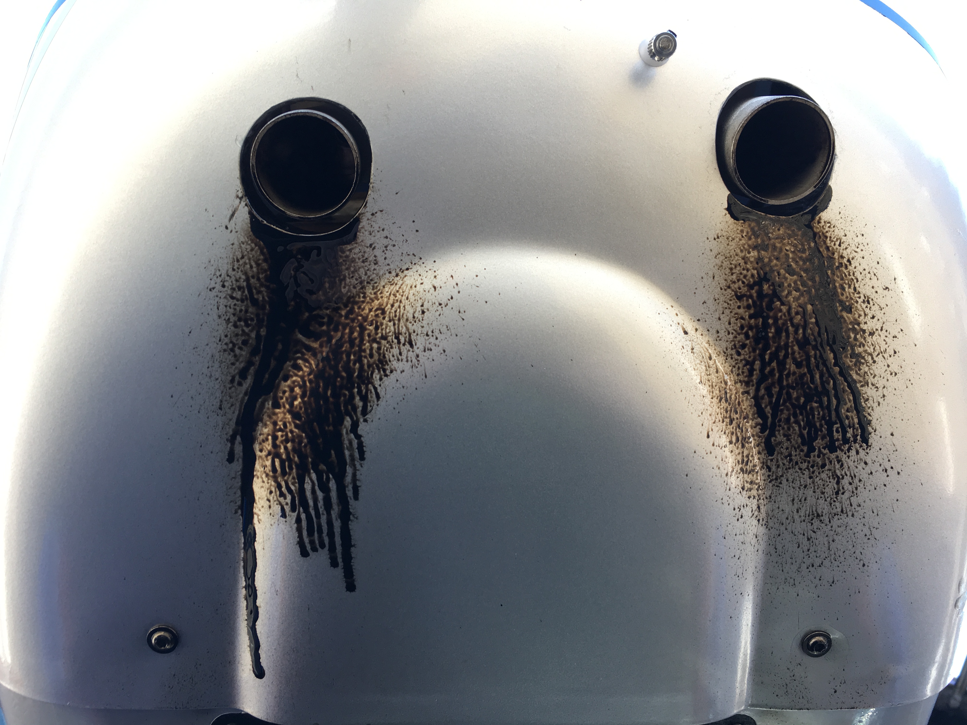

You can tell the engine is breaking in:

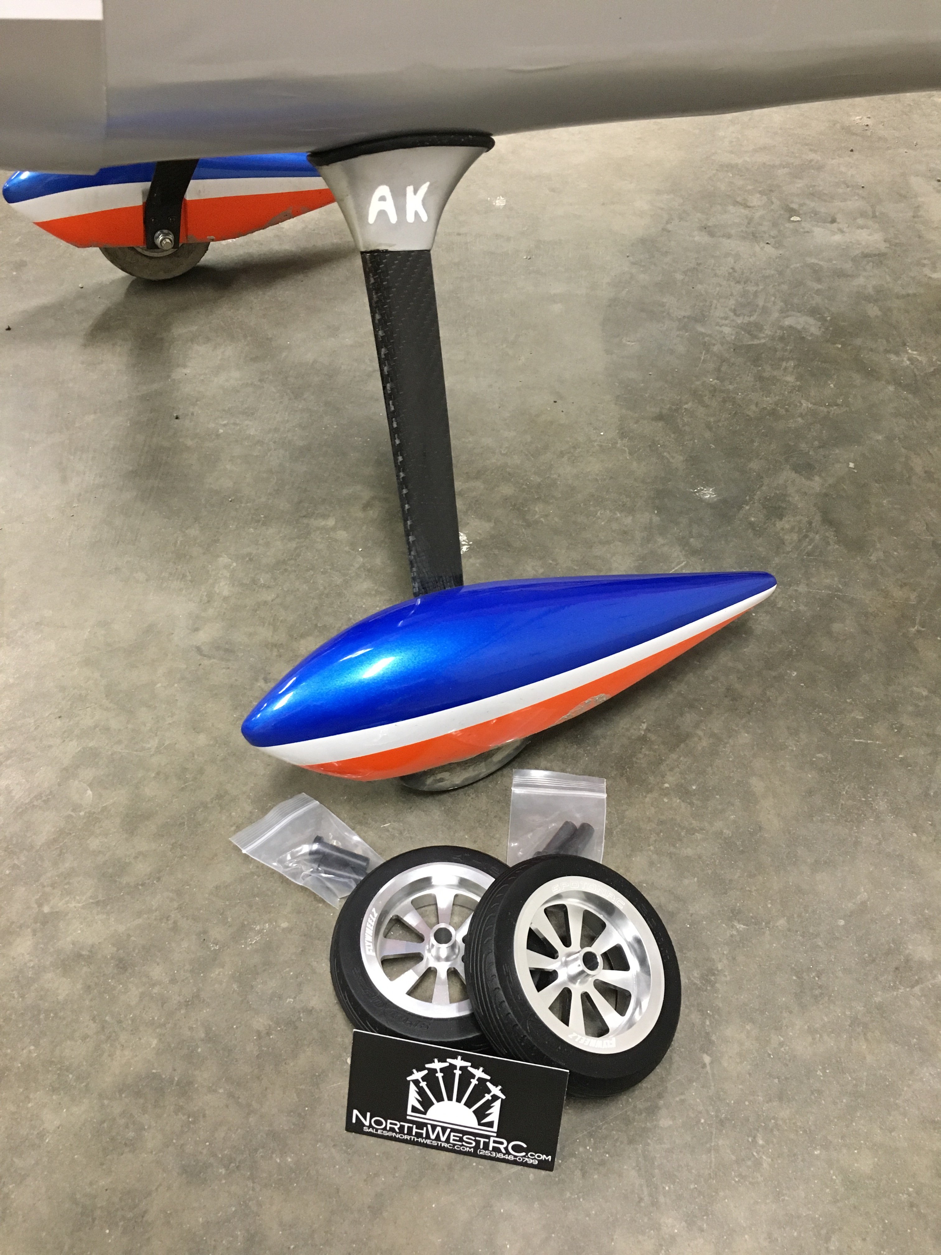

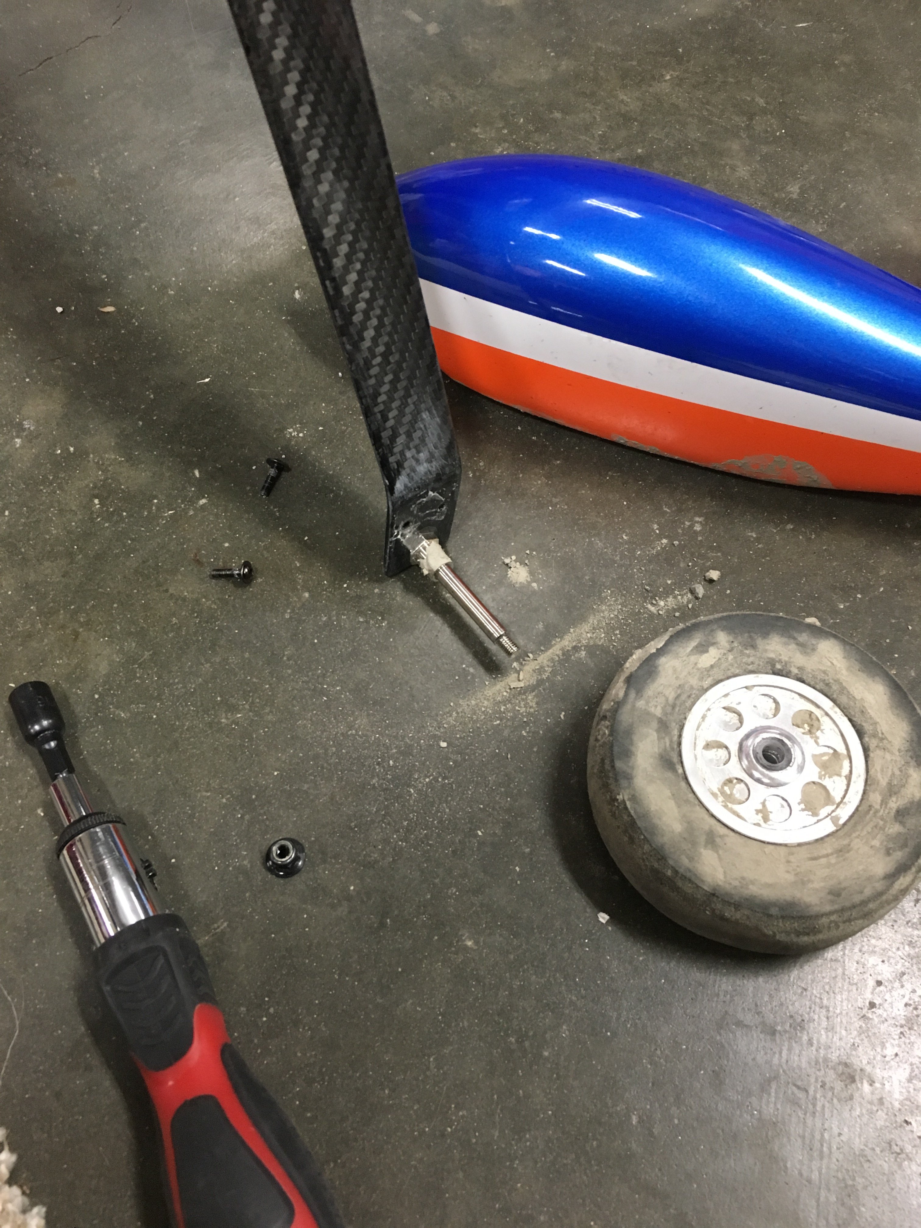

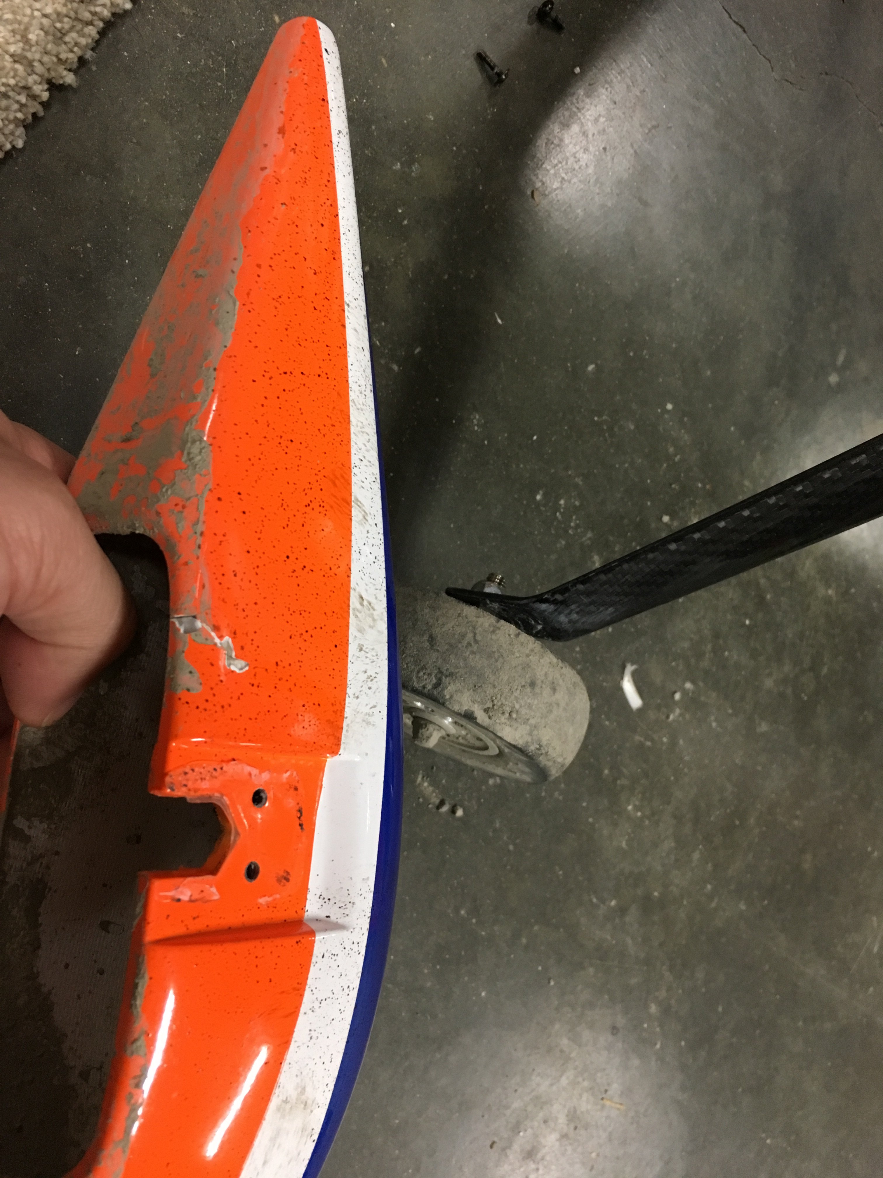

I was flying off some soft mud... I cracked out my wheel pants. I’ll have to take them off and repair them. I do have some spotonrc flywheelz to throw on so maybe this is the perfect time.

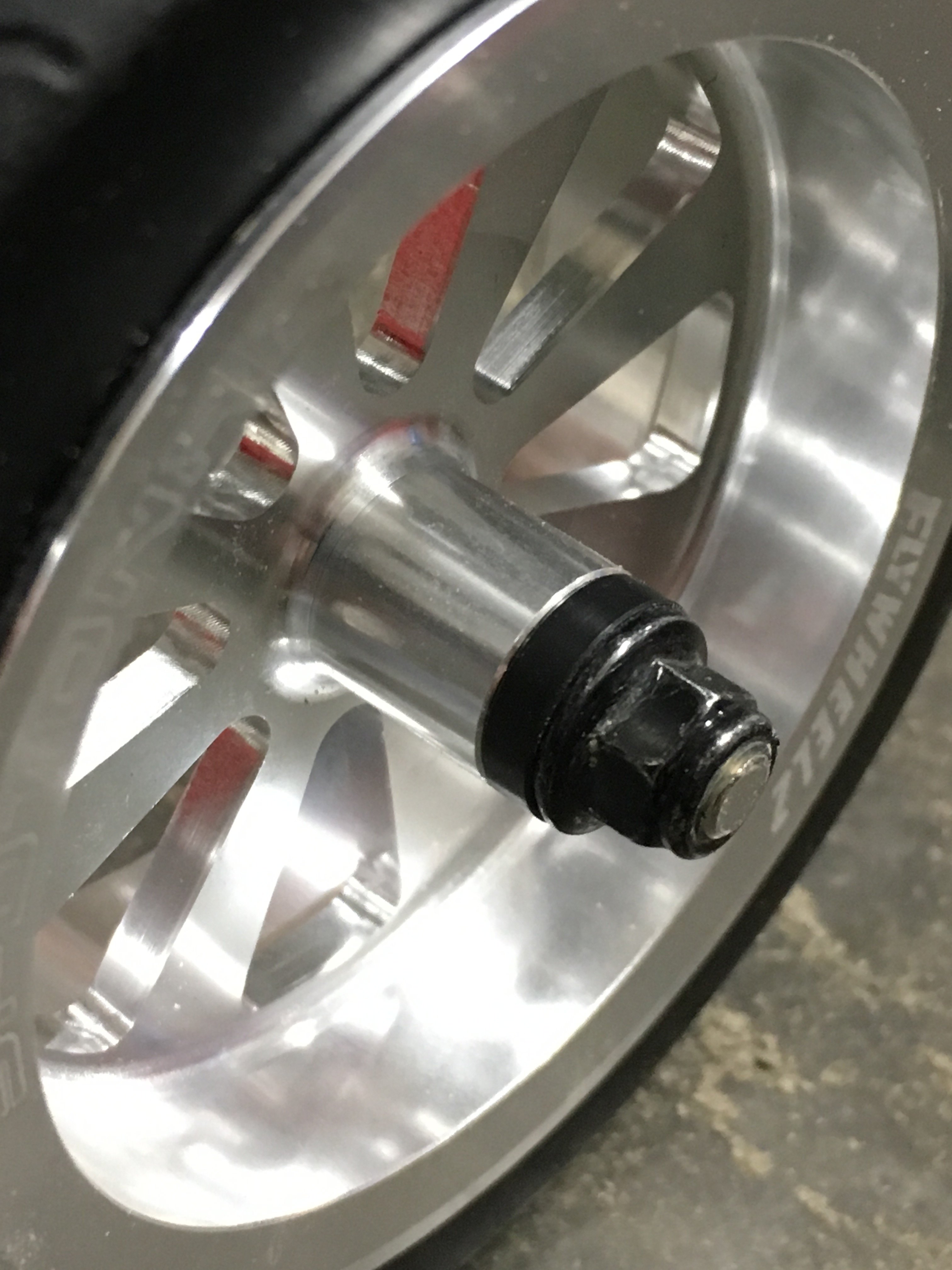

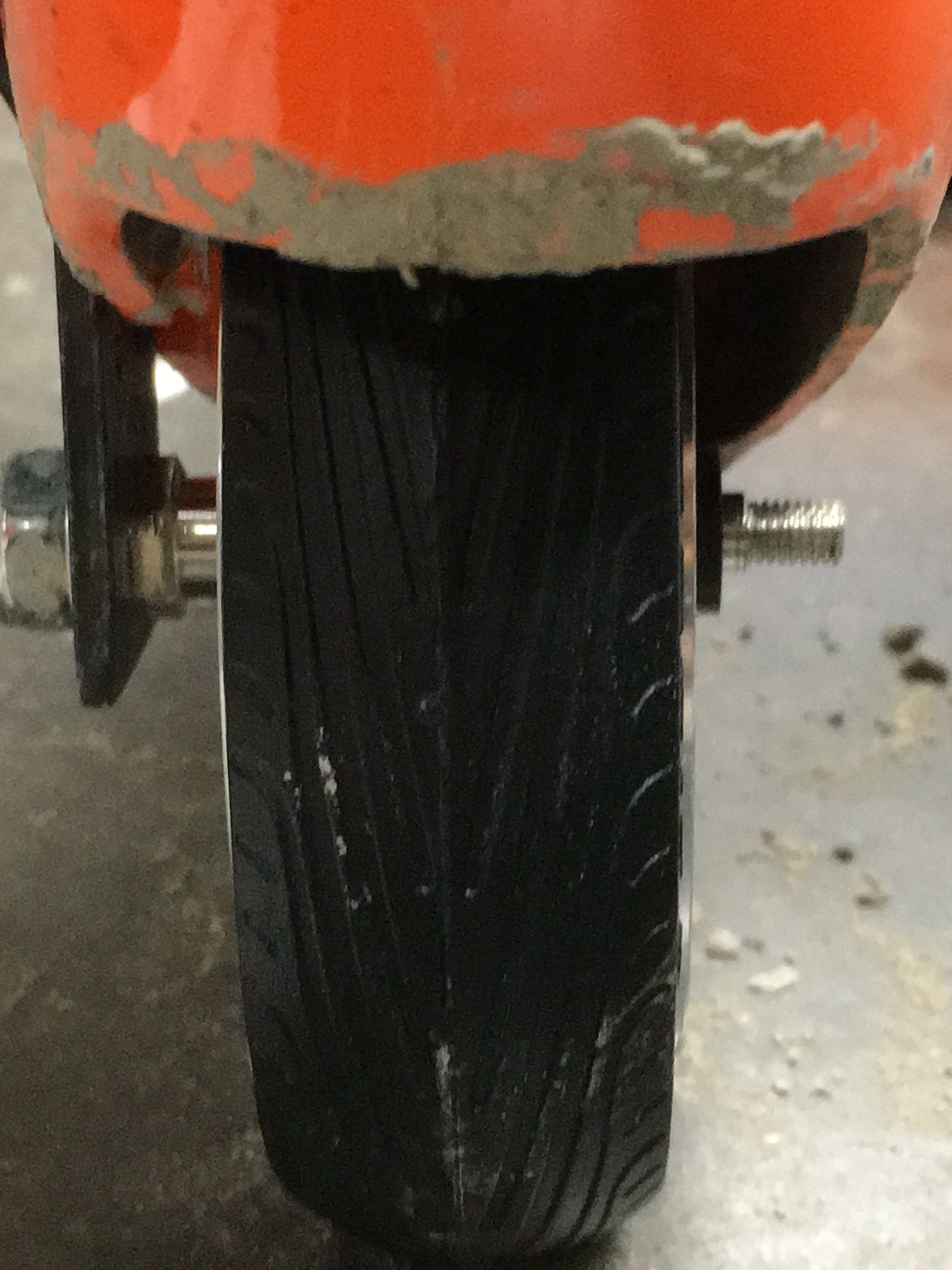

Put on some 4” SpotOnRC wheels!
Mud galore!
EDE67FEB-C337-4A0F-A21F-A47B5F692F3A.jpeg EBC2C849-4C33-4106-AE19-B50FA65B3BE2.jpeg 1282EFA9-FEDA-4ED9-B9A6-7A0E12EB15E1.jpeg

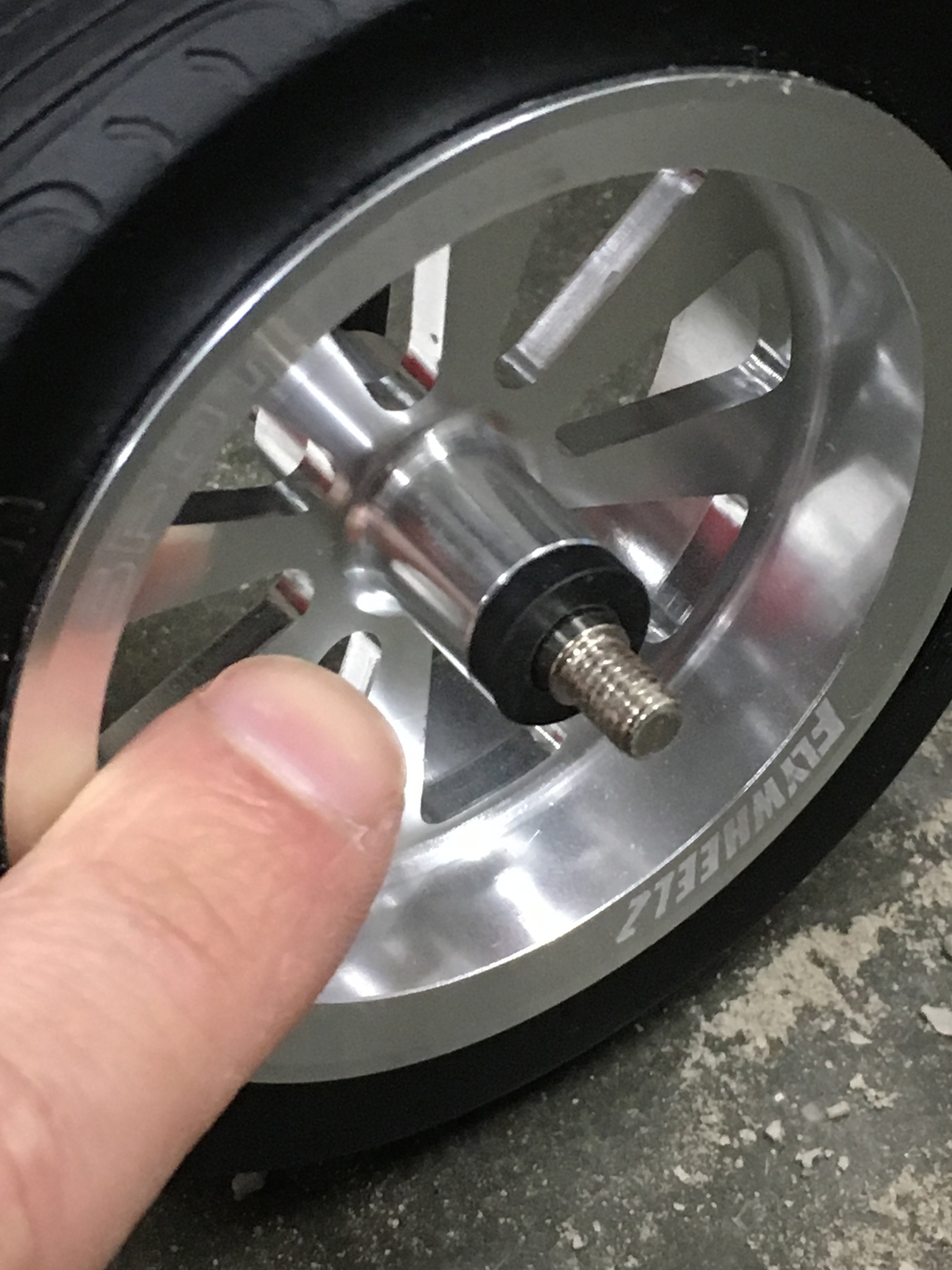

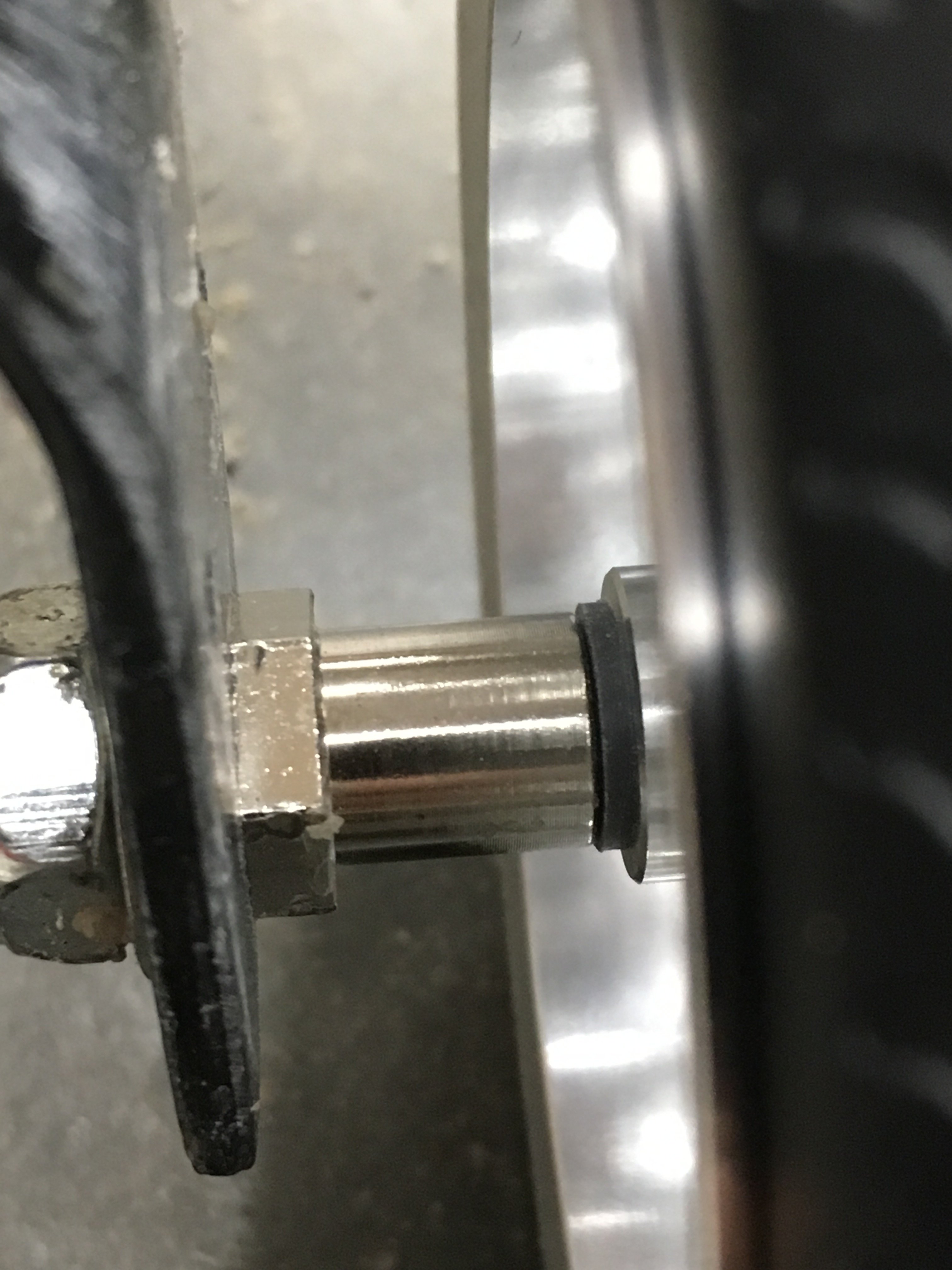

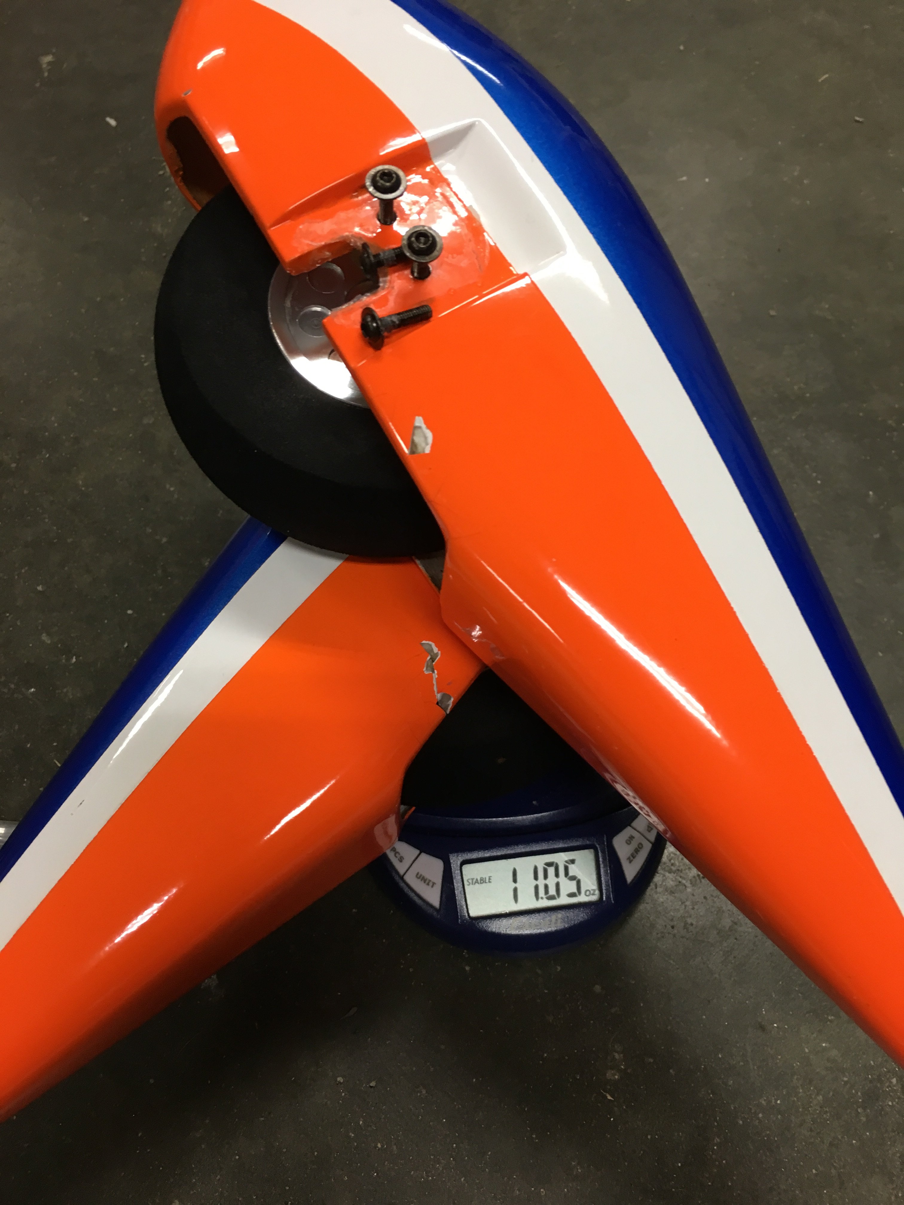

Note the rim of the shim/axel reducer/insert goes outboard if you want to keep the wheel pants on.
Like this:

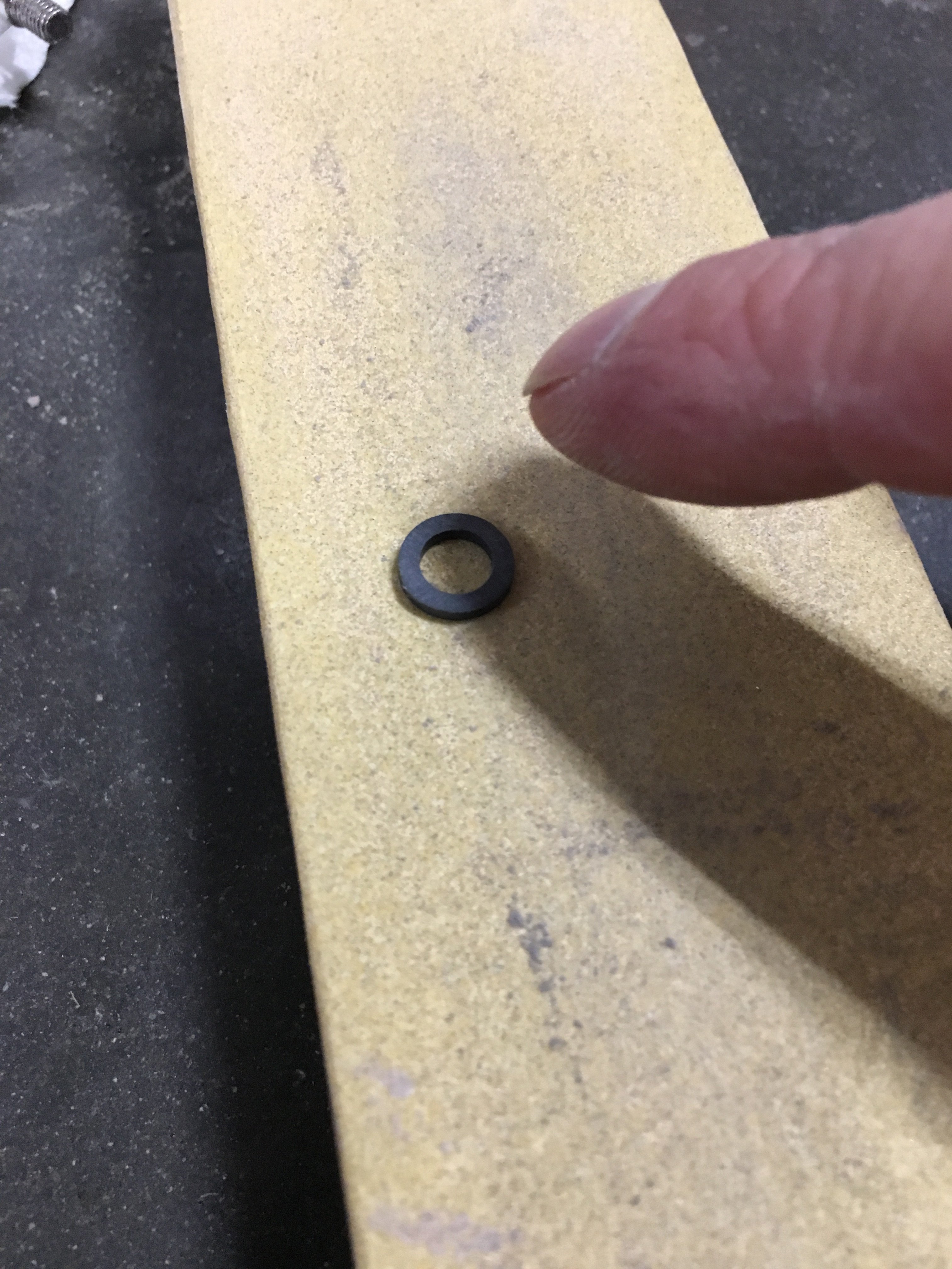

If you’re like me you have prop inserts laying around. They are great for shims! Just sand down the one that fits the shaft size until you don’t have anymore slop.
Shim went on the onboard side.
Nut tightened up the the stepped axel. Wheel turns freely with no slop and a tiny bit of friction to wear into.

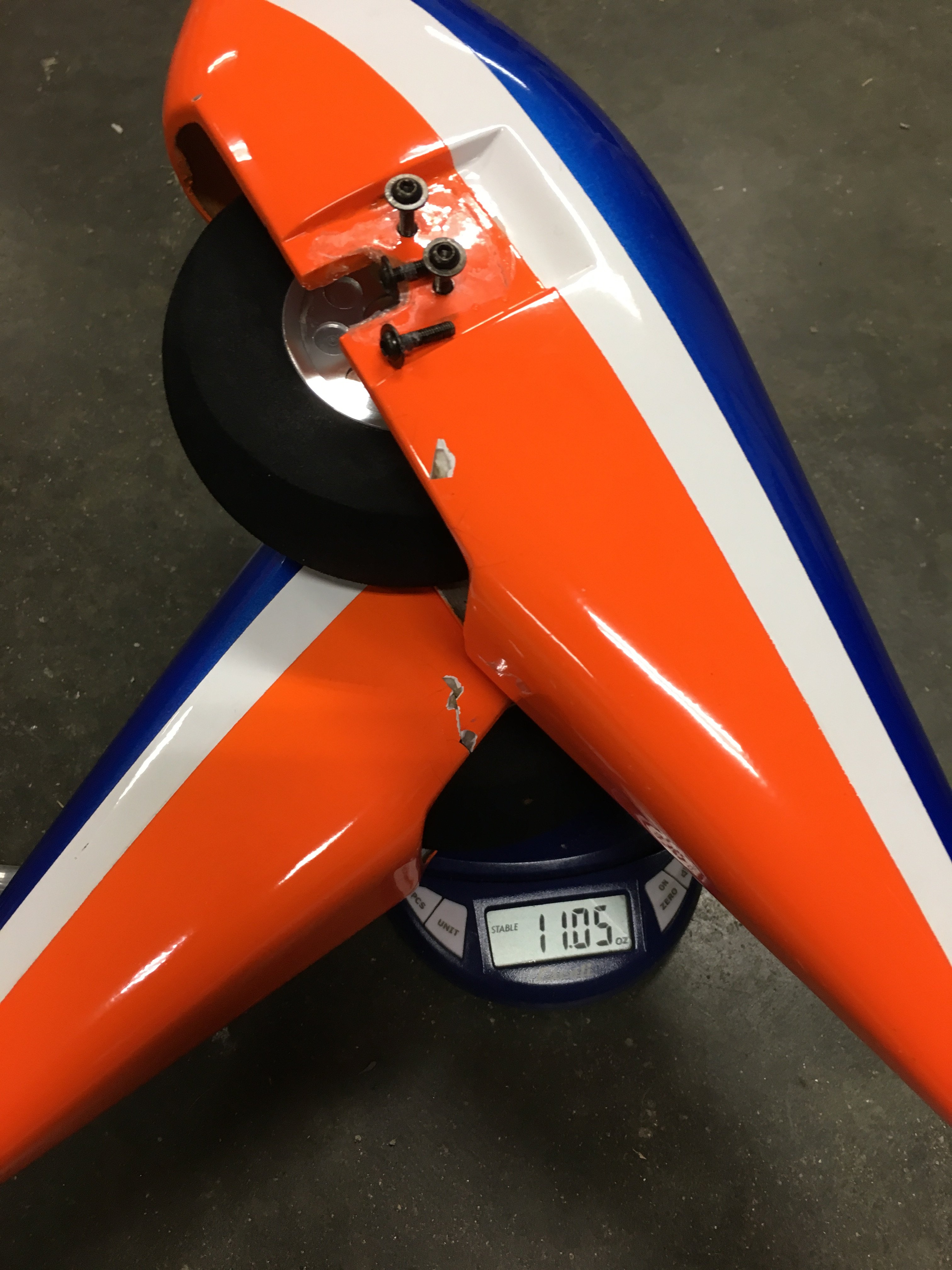

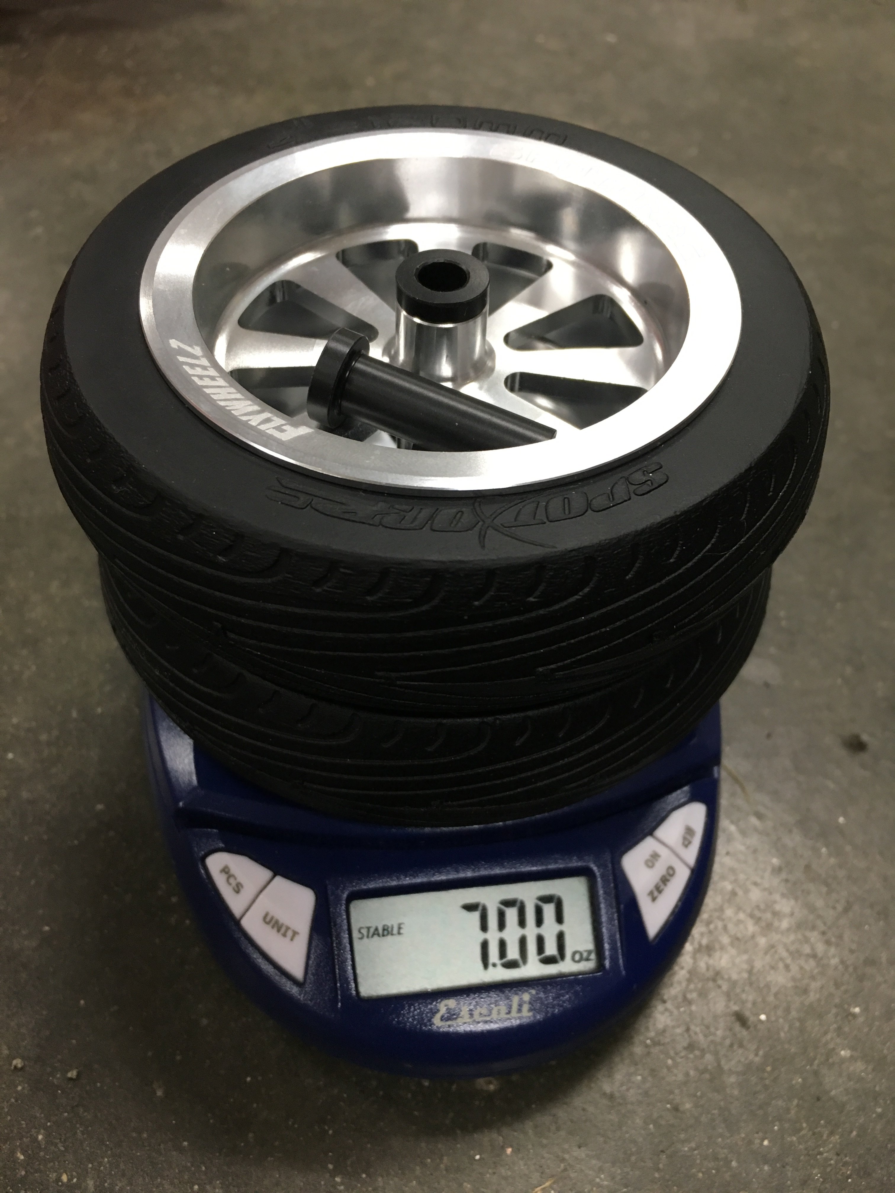

Wheels have a bunch of water in them... so not very accurate. 3oz more with every thing off.
