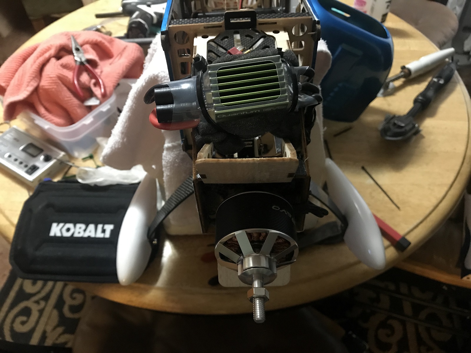

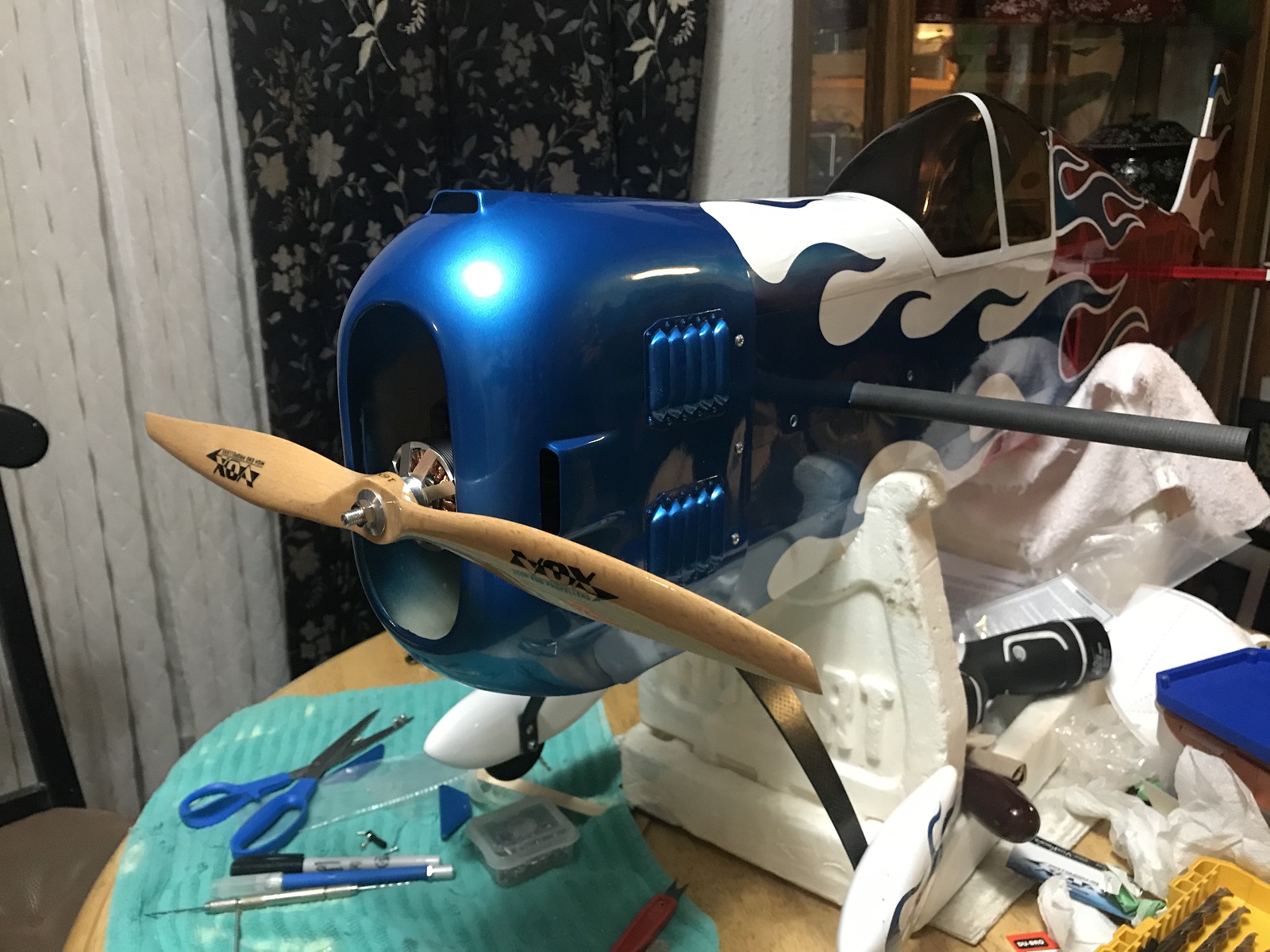

Spent some time and got the cowl fitted. I had to remove some material from the bottom side of the cowl, where it goes over the landing gear. I didn't get the carbon spinner with the order, but I will probably end up ordering it. The cowl does fit a bit tight but will settle in once the vibrations start happening!

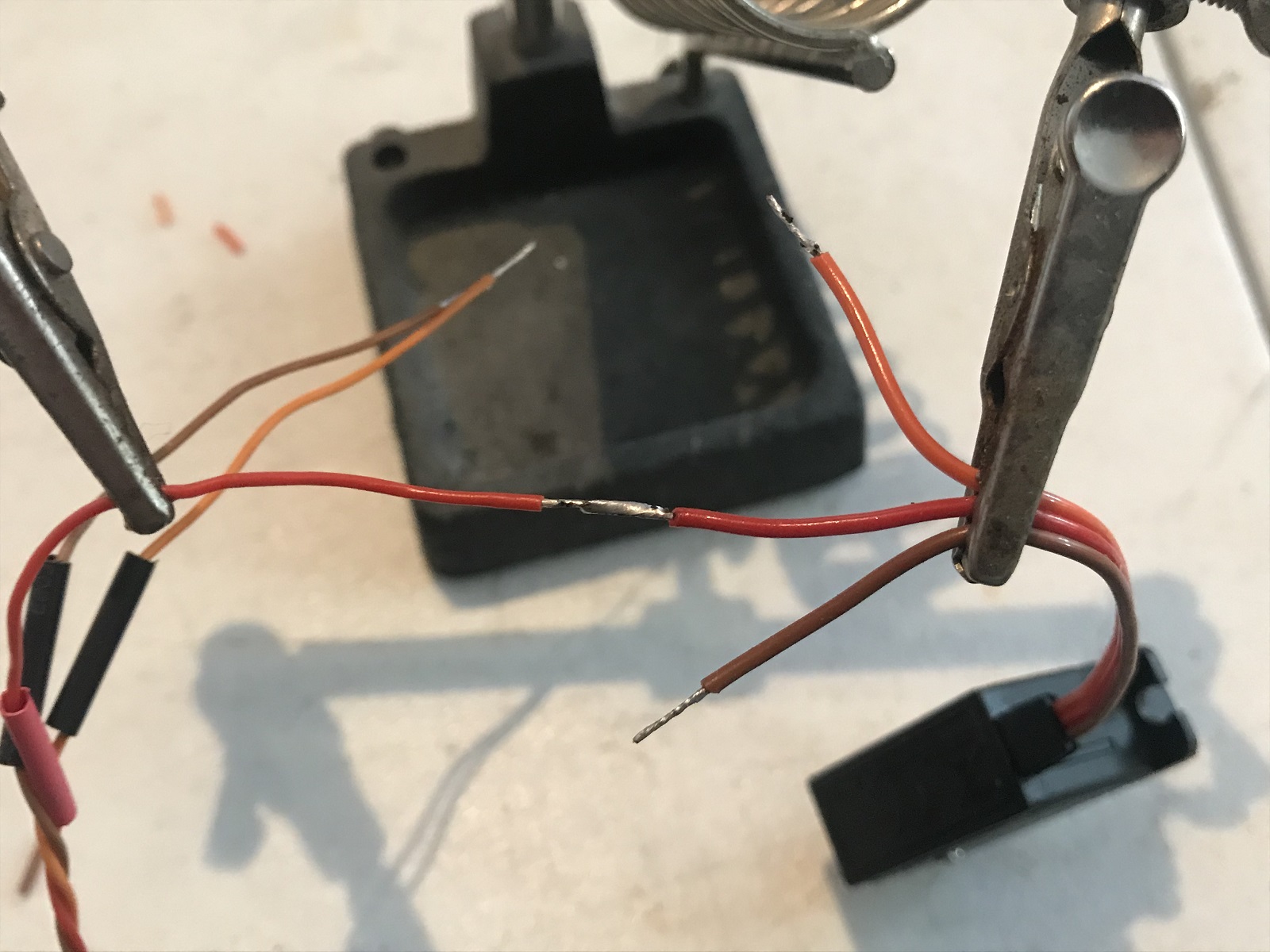

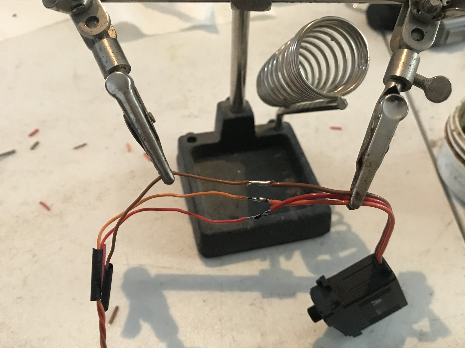

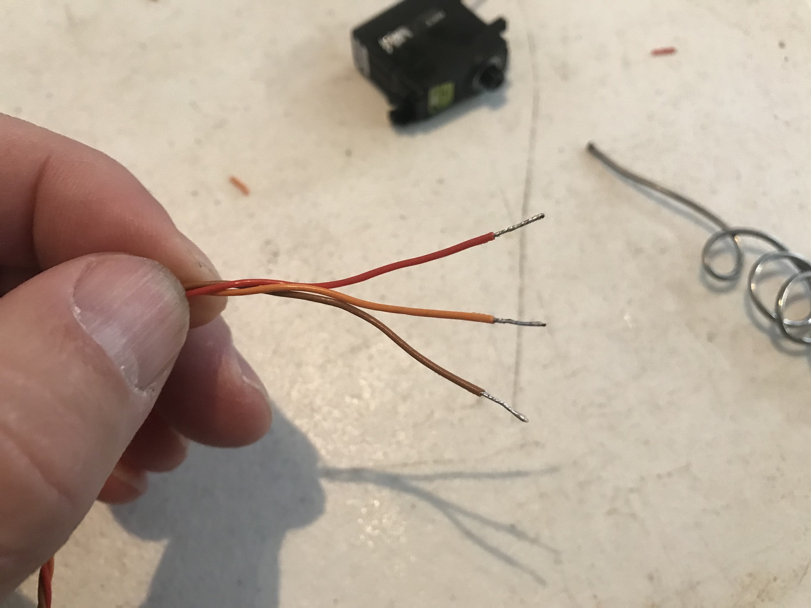

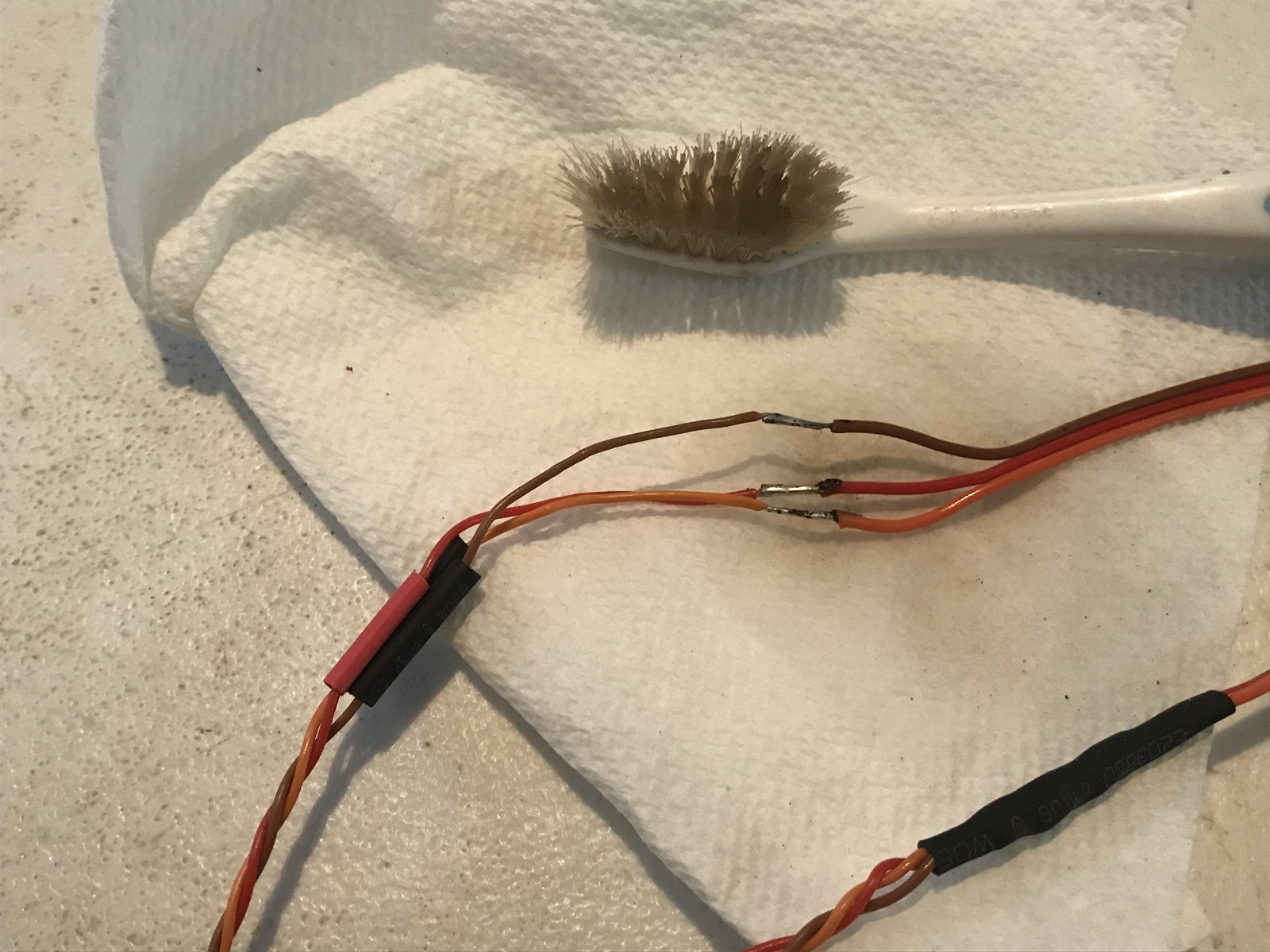

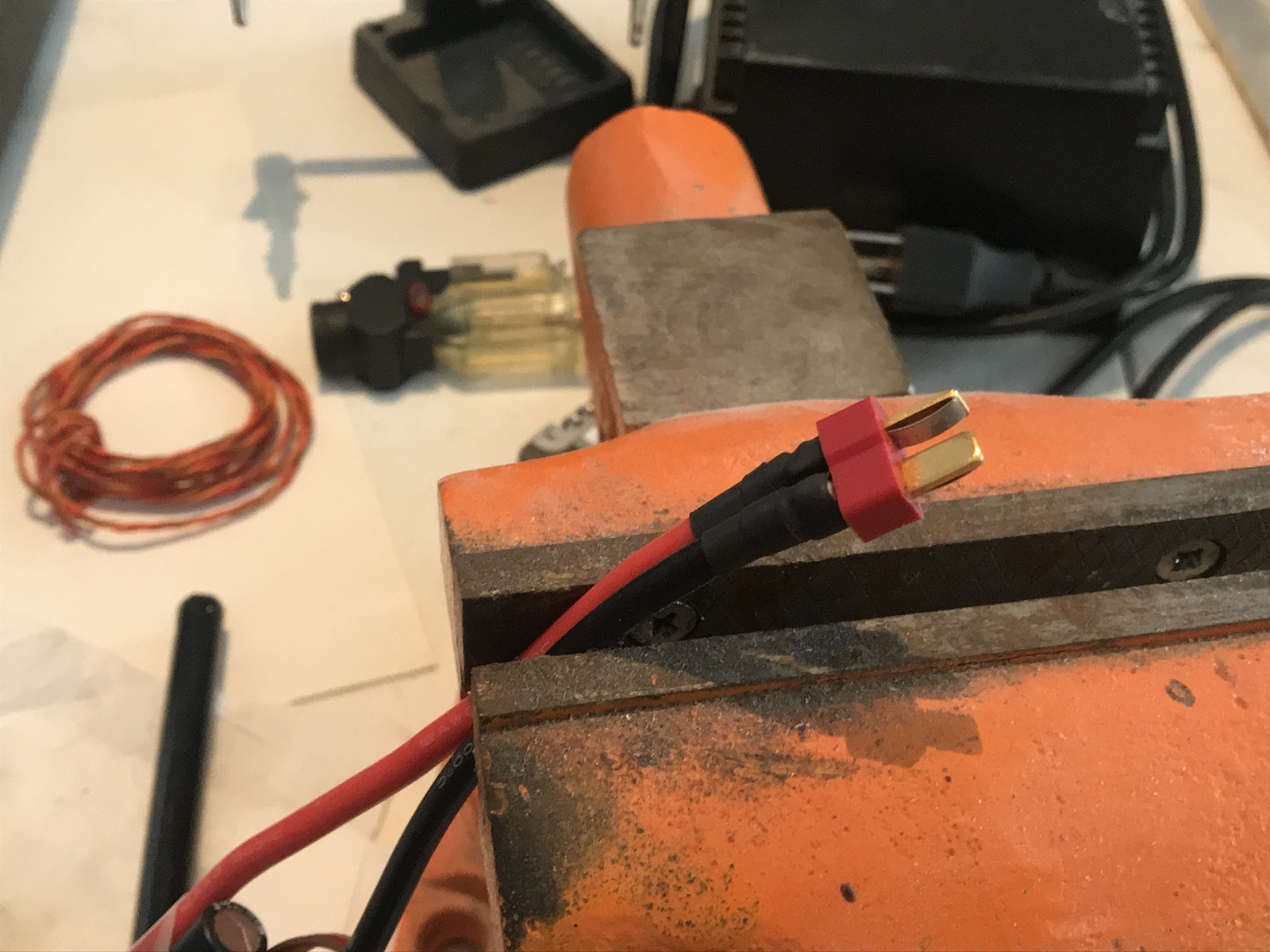

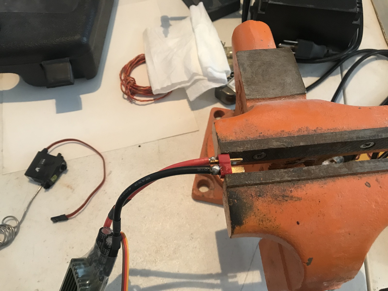

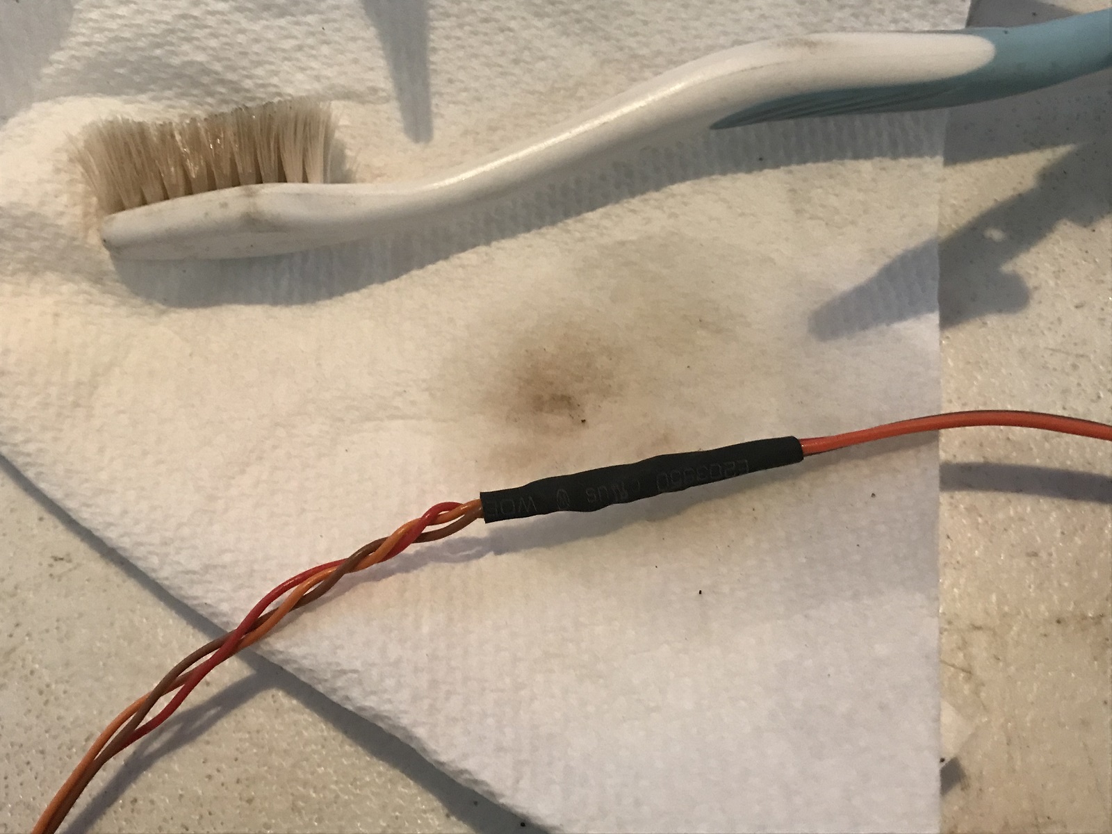

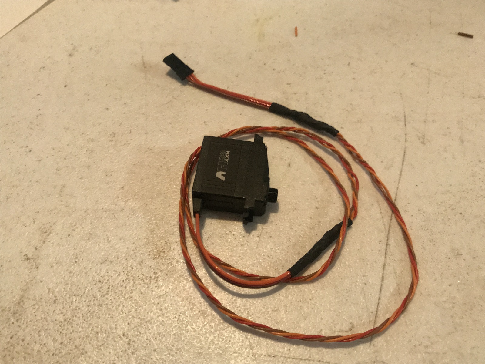

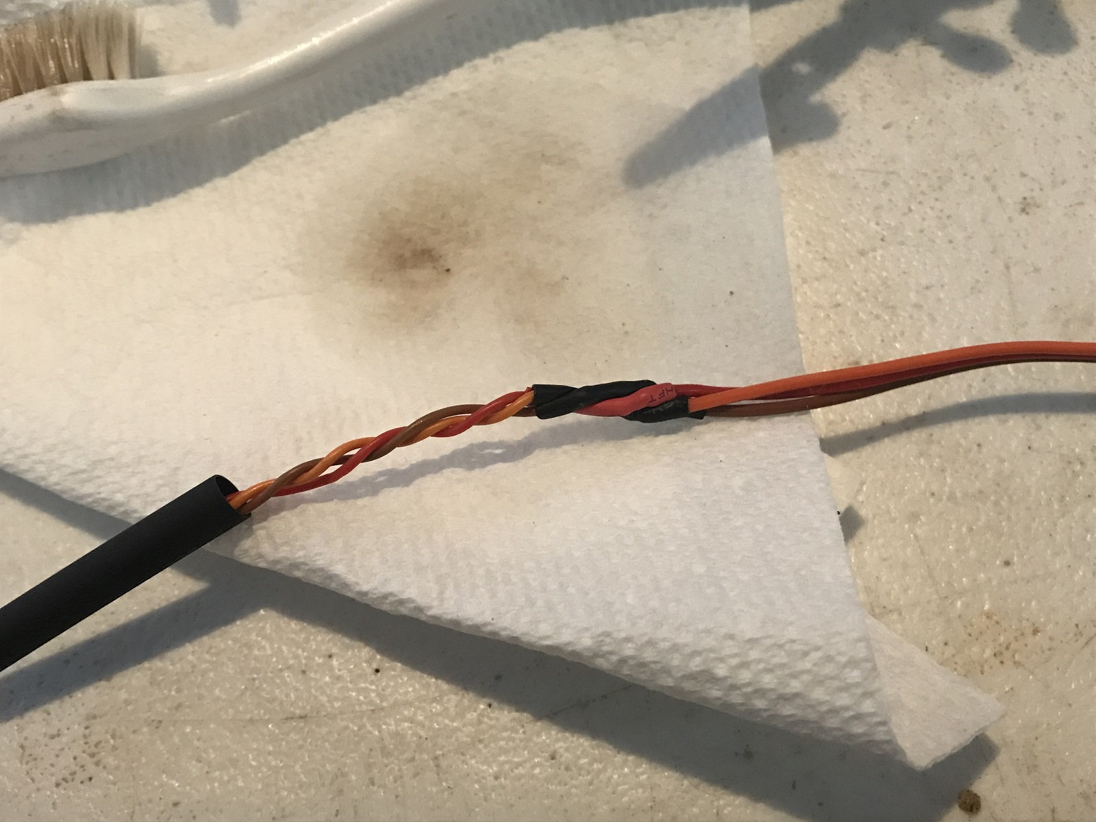

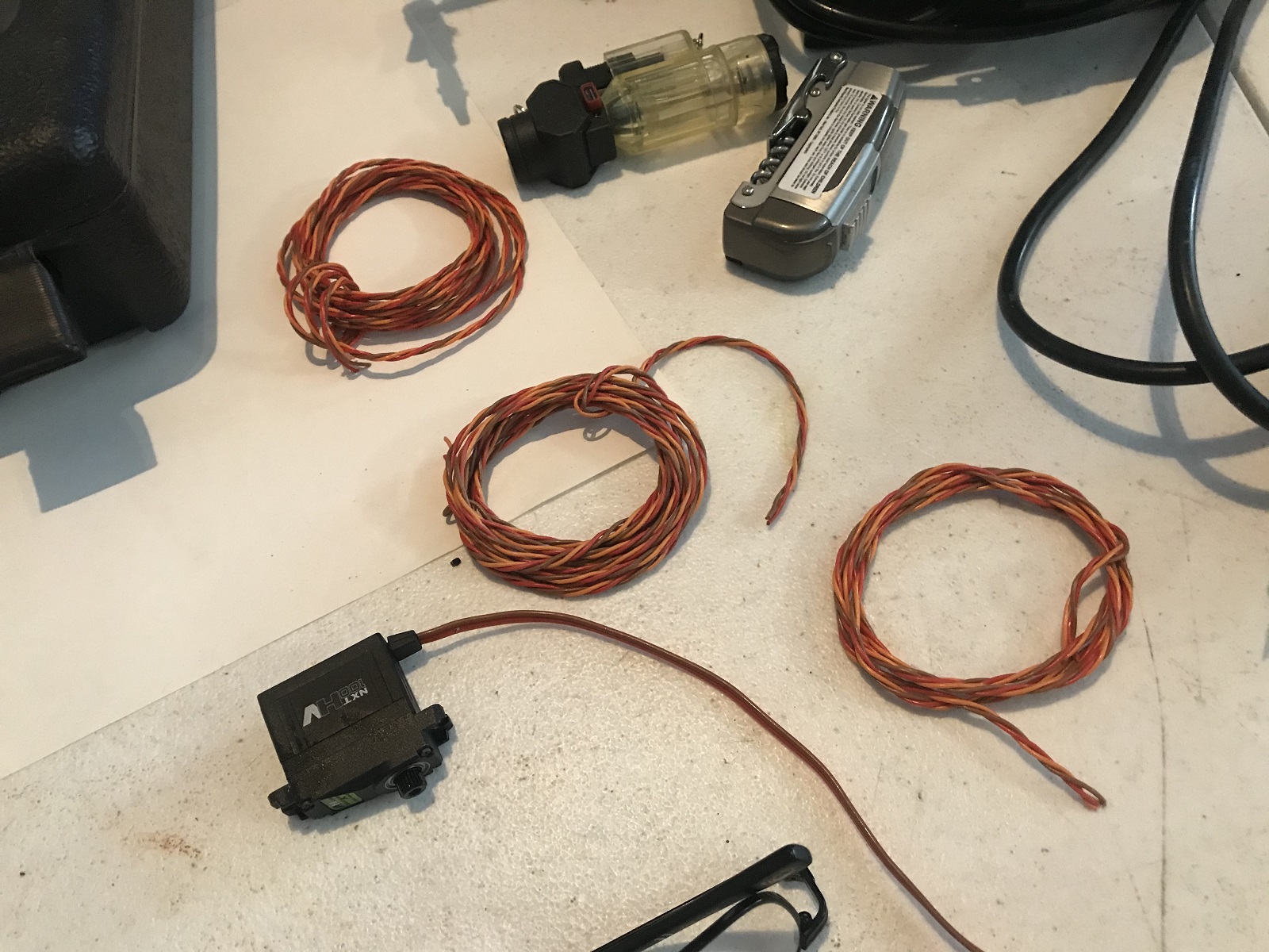

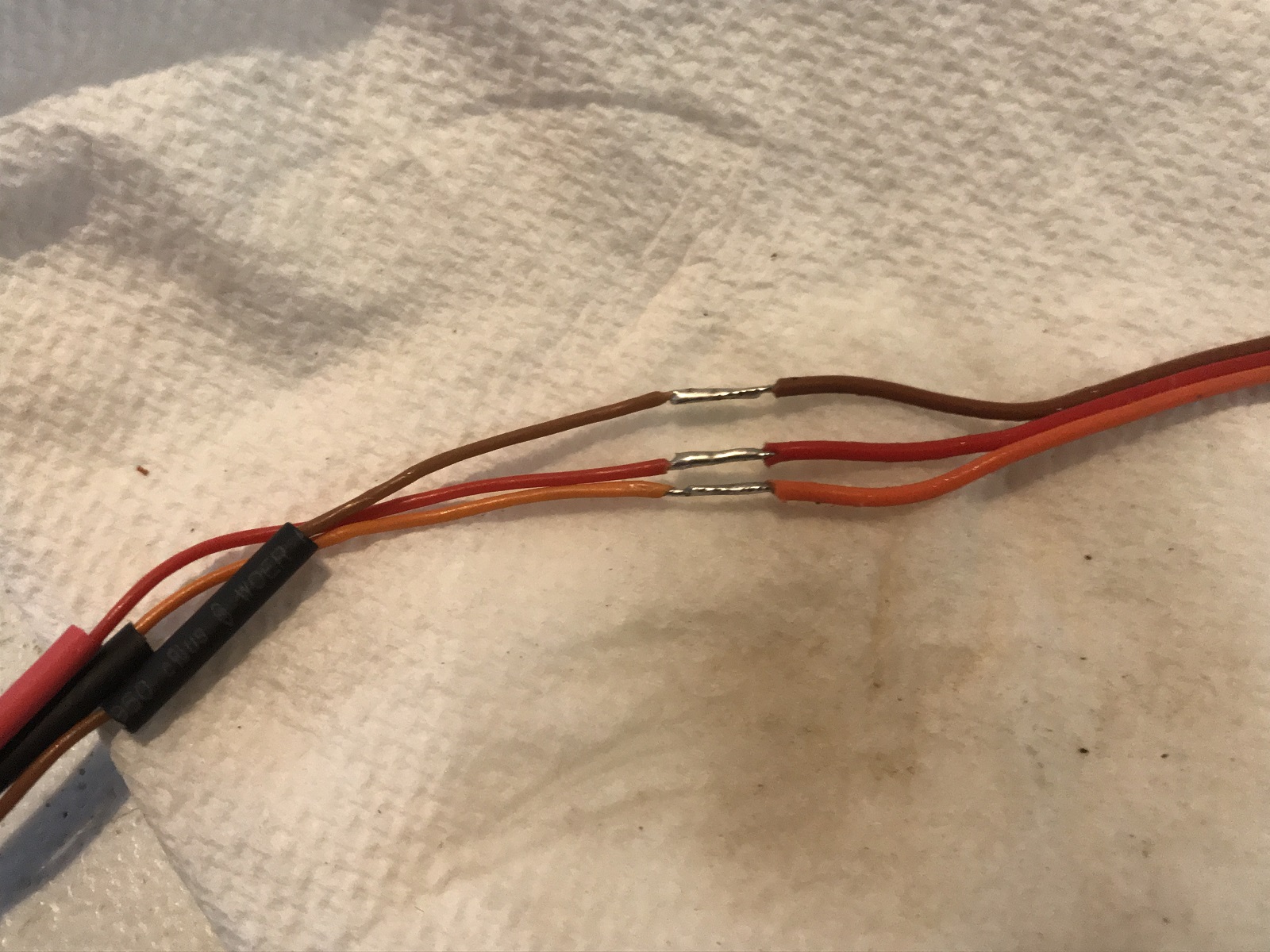

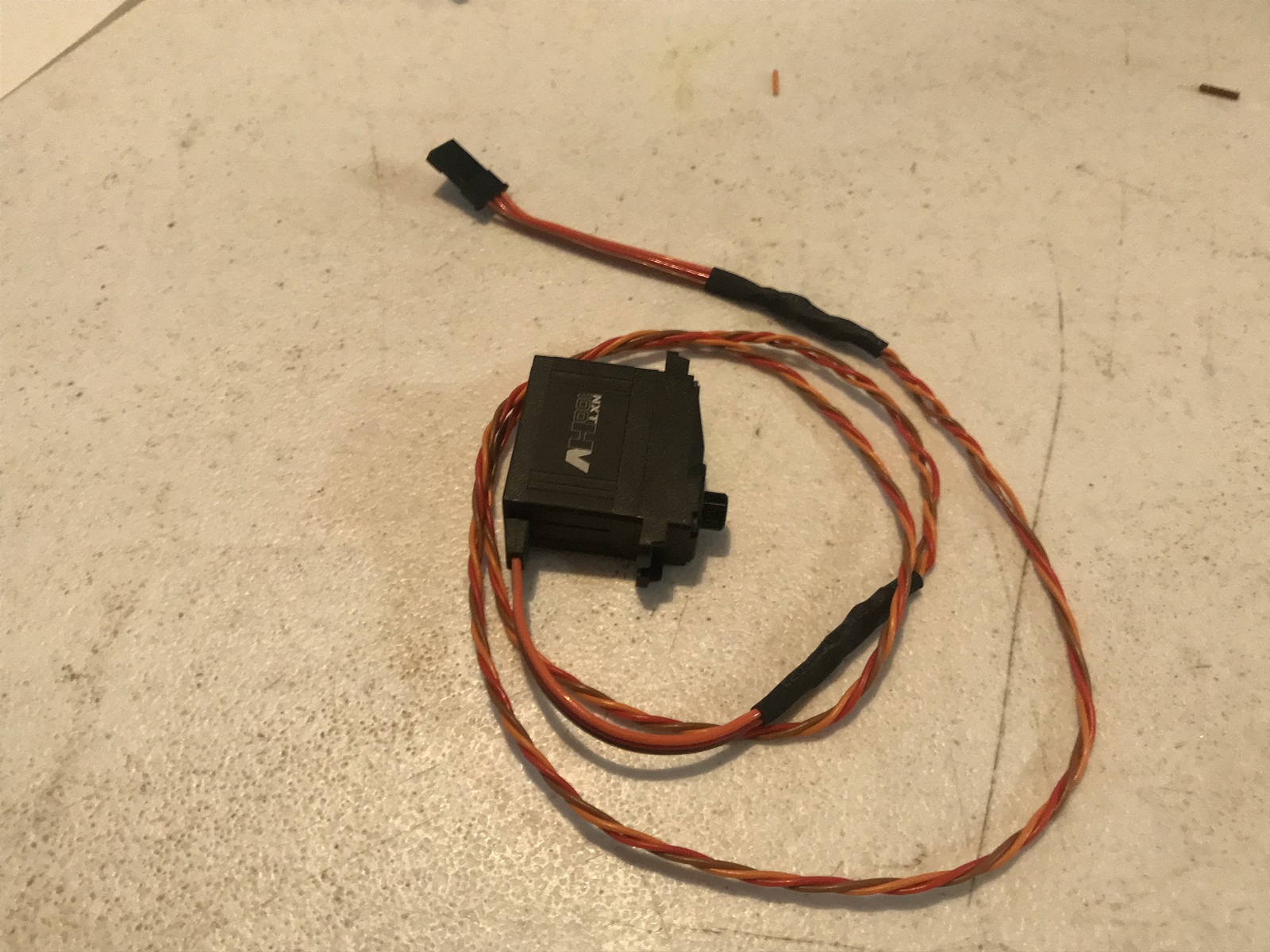

Next I decided to get the soldering part done. I always tint the wires and deans connectors before soldering, then clean the surfaces with alcohol before adding the shrink tubing. I used the deans connector on the ESC and about 22" of extension lead on the elevator servo. The kit does come with the extra servo wire, but I had lots of extra from the other kits, so I used the remainder of the old one. I also used the large gun on the deans, and a soldering iron on the wires.
I had to cut my cowl to clear the gear.

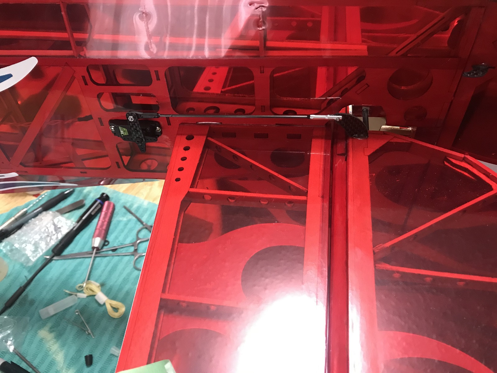

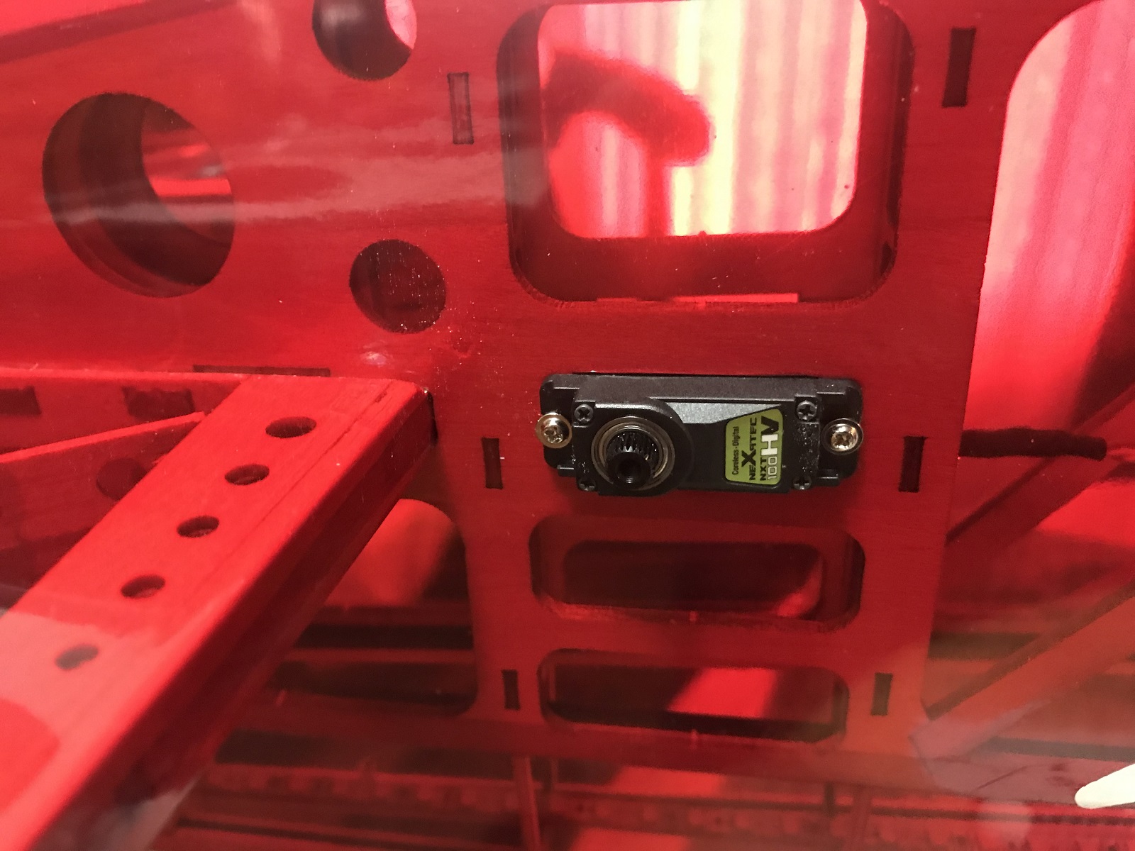

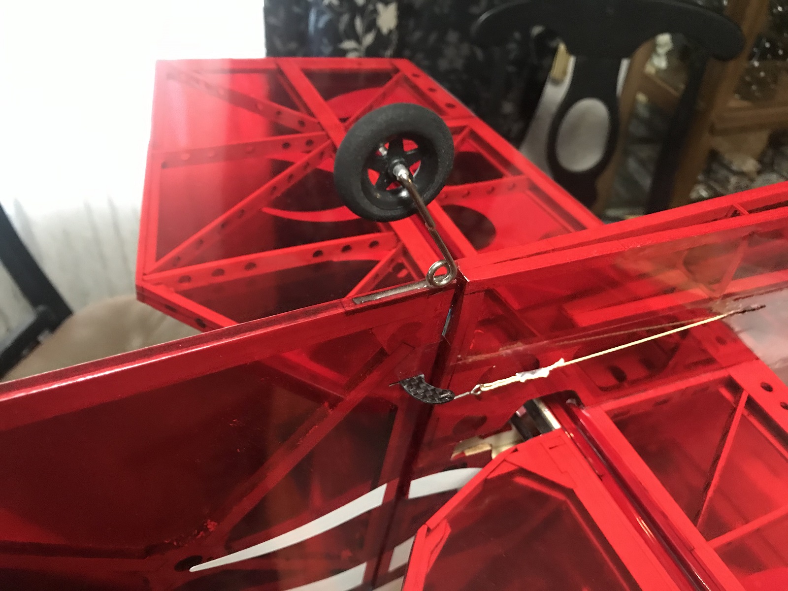

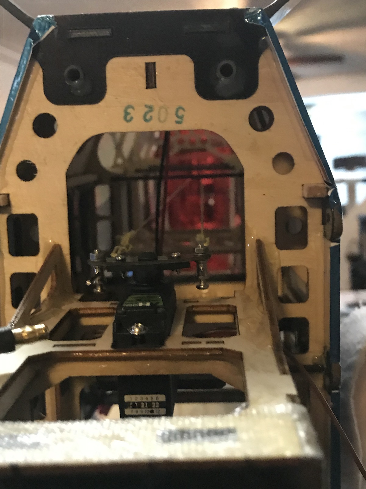

Rudder pull pull is done. I used the forward mount method . Pull pull cables have to be crossed and the exit is doubled with some packing tape, as there is no backing for the exit cables. I used a long strait edge to make the proper marks for the exit holes. I atached the cables to the servo first, then tightened the cables on the rudder side.
