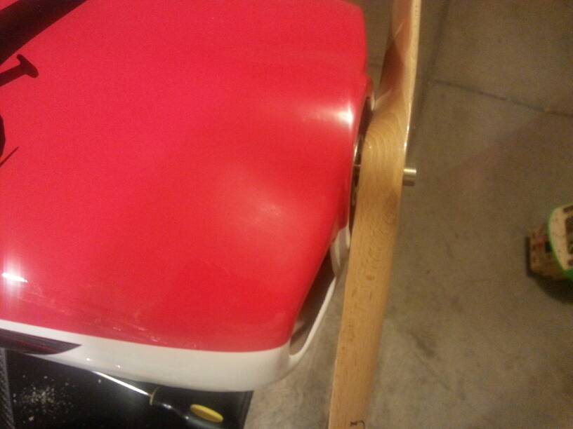

uploadfromtaptalk1394121120338.jpg I had a minor setback last night. It was totally my fault but I ended up with the prop hub not quite making it out of the cowl. I should have checked the fit of the cowl first thing after mounting the engine but I didnt. When I found out it wasnt going to fit I had already finalized my throttle linkage and set up my choke. I was frustrated and took five before deciding to go ahead and shim the motor out with some washers. I didnt measure it but it looked like I moved the motor out about 1/4".
The adventure continued when I did not have a long enough push rod for the new throttle linkage. It was 10 pm and I was determined to make something work. I found a length of all-thread but my ball links just slid over it... dang... didnt fit. Not wanting to give up I cut the length I needed and filled the ball links up with CA. I used two sizes of shrink tube and a liberal amount of CA on the outside of the ball link and the length of the all-thread that the shrink tube would cover. Shrunk the tube with a match. A nice side effect was a little CA catching on fire... always fun for a pyro like me ;). I ended up with a very solid feeling push rod. I can post some pics tonight if anyone is interested.
