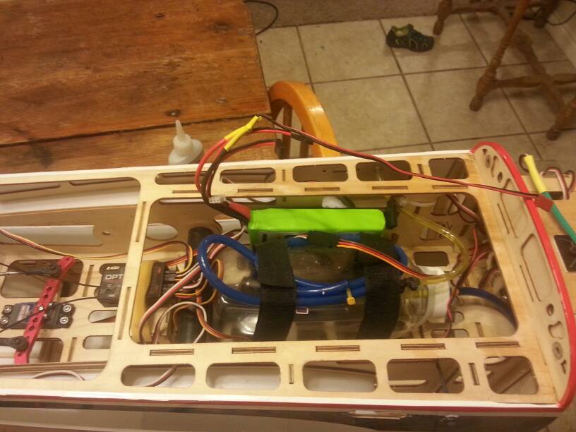

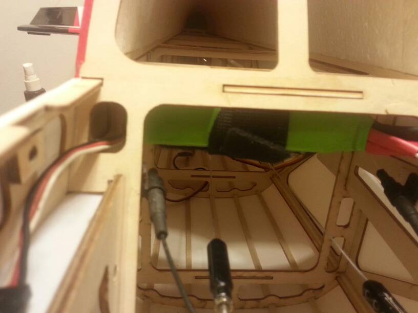

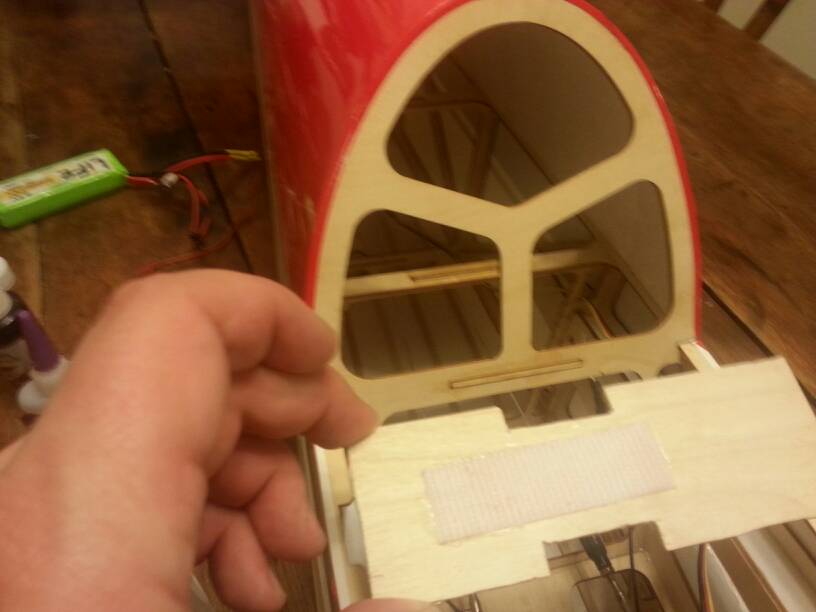

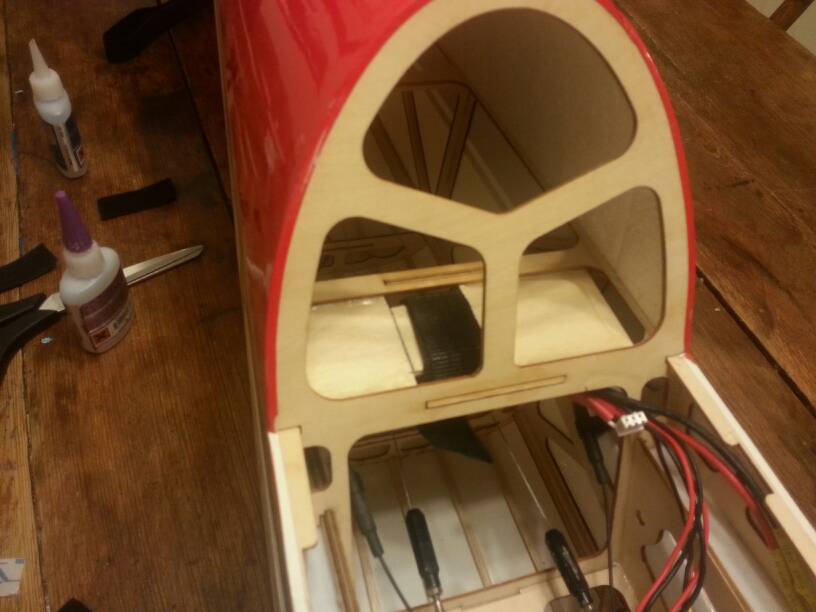

I brought the plane in to work on thinking I would get it back on its feet. That didnt happen... I got sidetracked messing with the CG. I have been wanting to find a way to move it back a little for better pitch authority. Here is what I came up with.
I hope this makes the difference Im hoping for.

Thats really not funny I know how you feel, the battery in the turtle deck should help with pitch authority. I have a couple of airframes that have the battery in that position. Good luck on the next flight!:)
