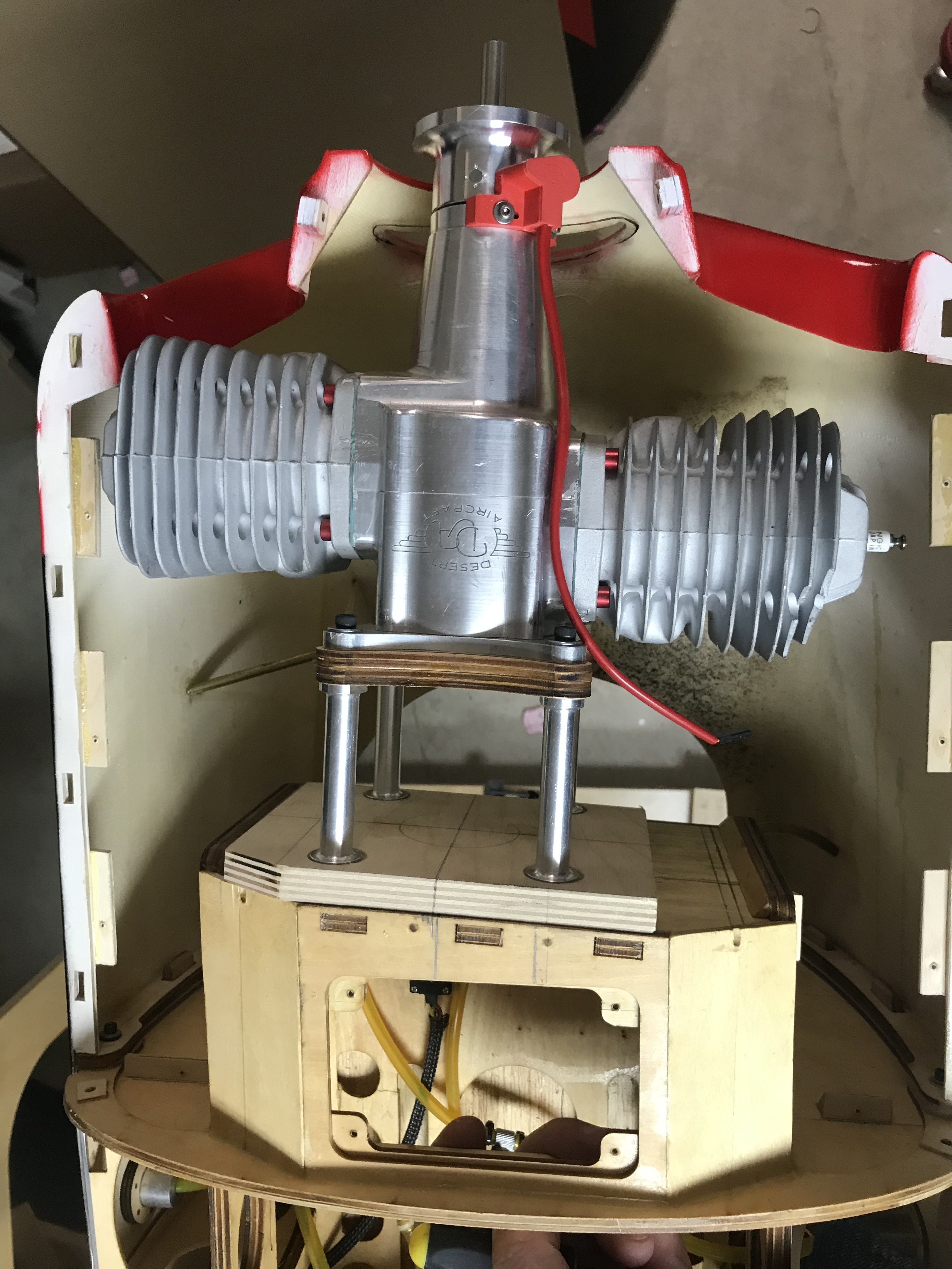

Those look like some really long stand-offs.. Was that mount modified or did it come shorter for the quad?

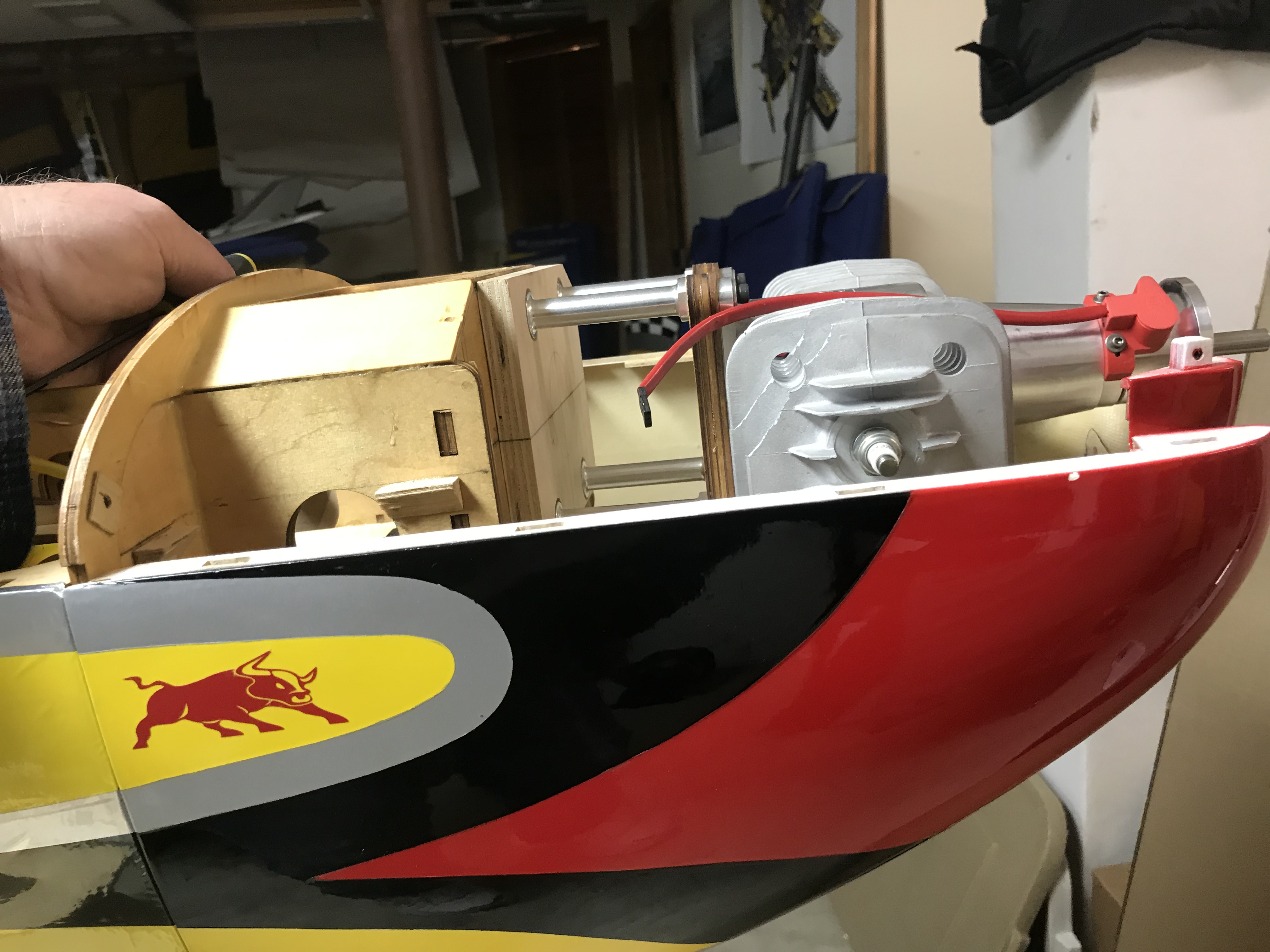

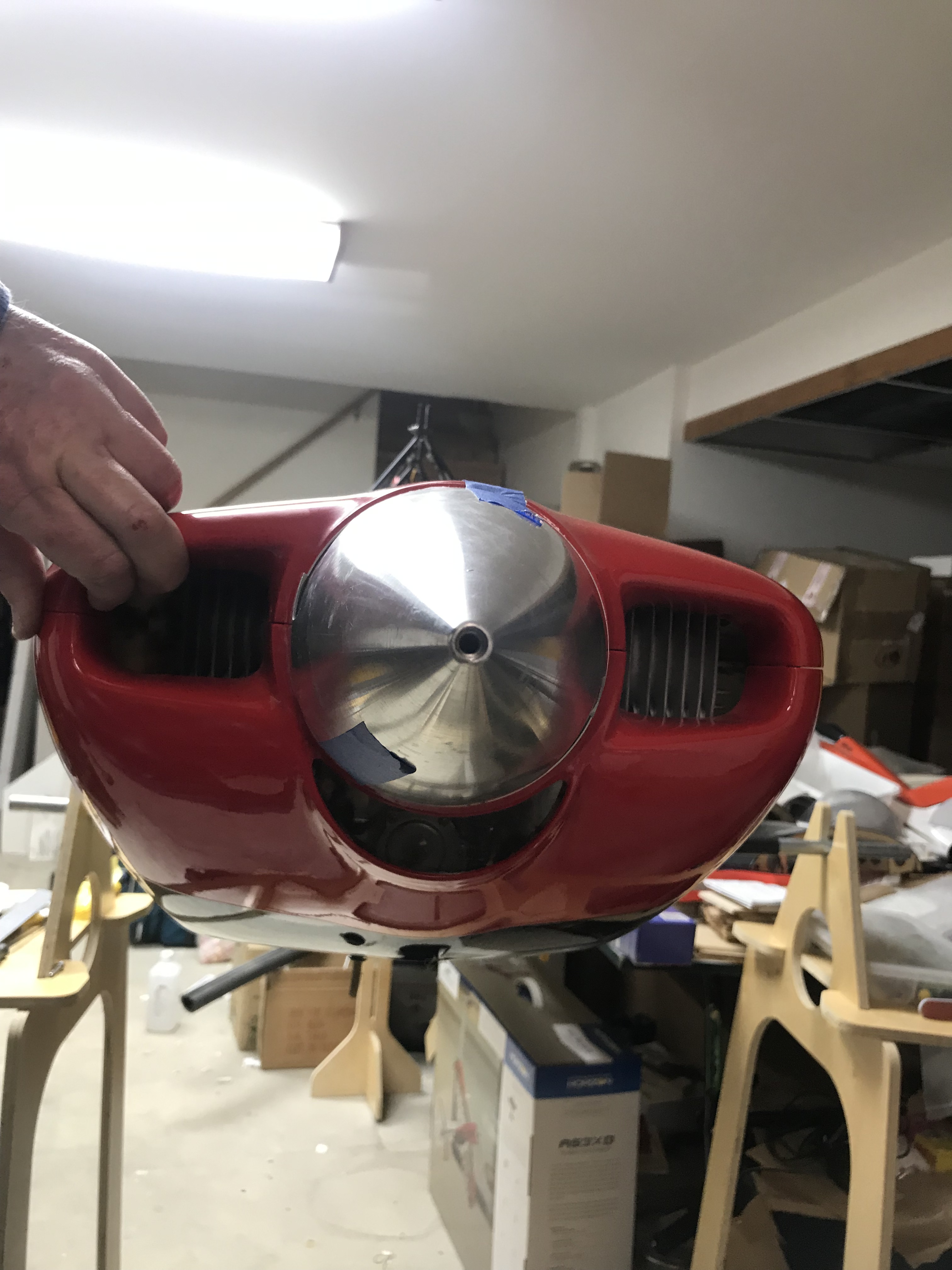

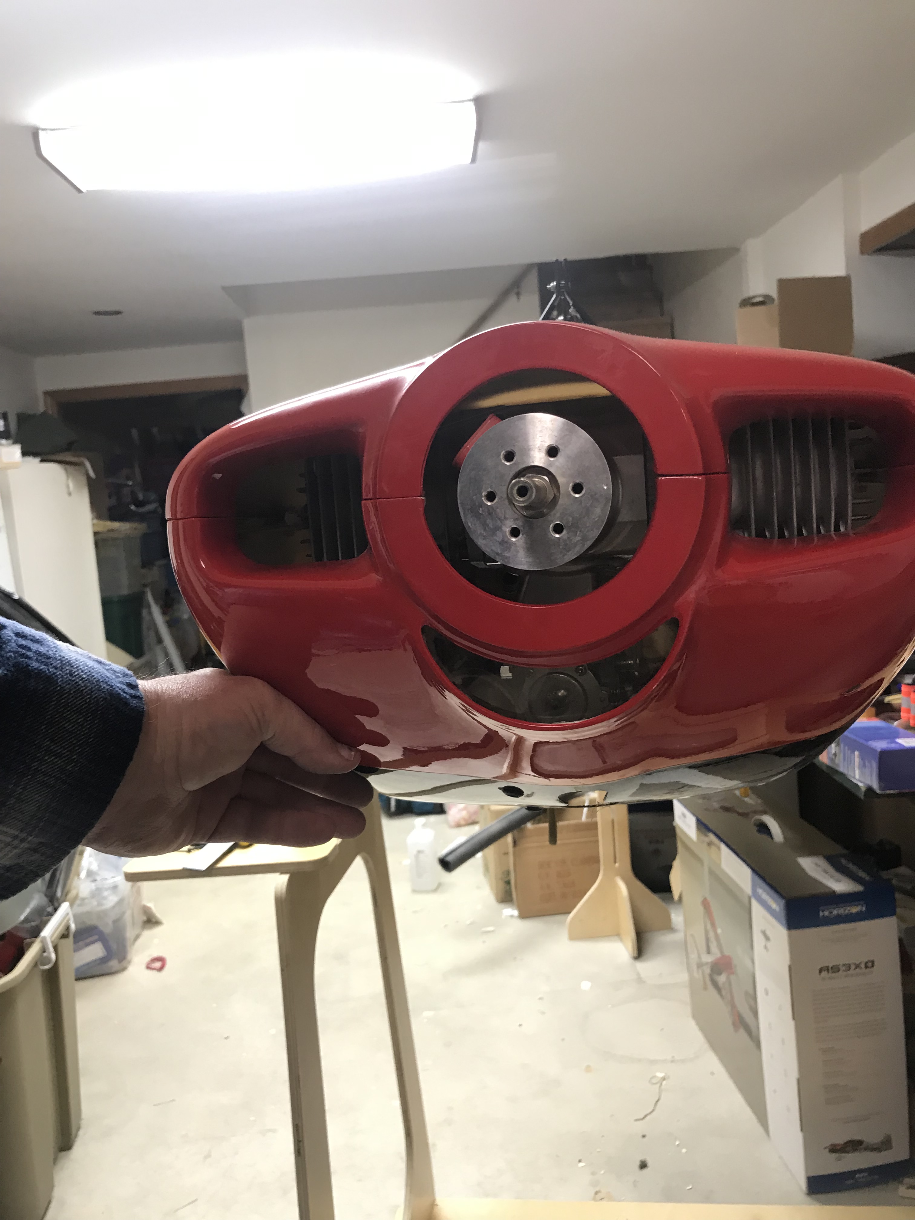

Robert,
Based on how the firewall and everything is locked together I believe that it was made specifically for the quad.....stand-offs are roughly 2 1/4"....plus ~1/2" for each wood mount (front and back).
Not thrilled with the setup but it works.

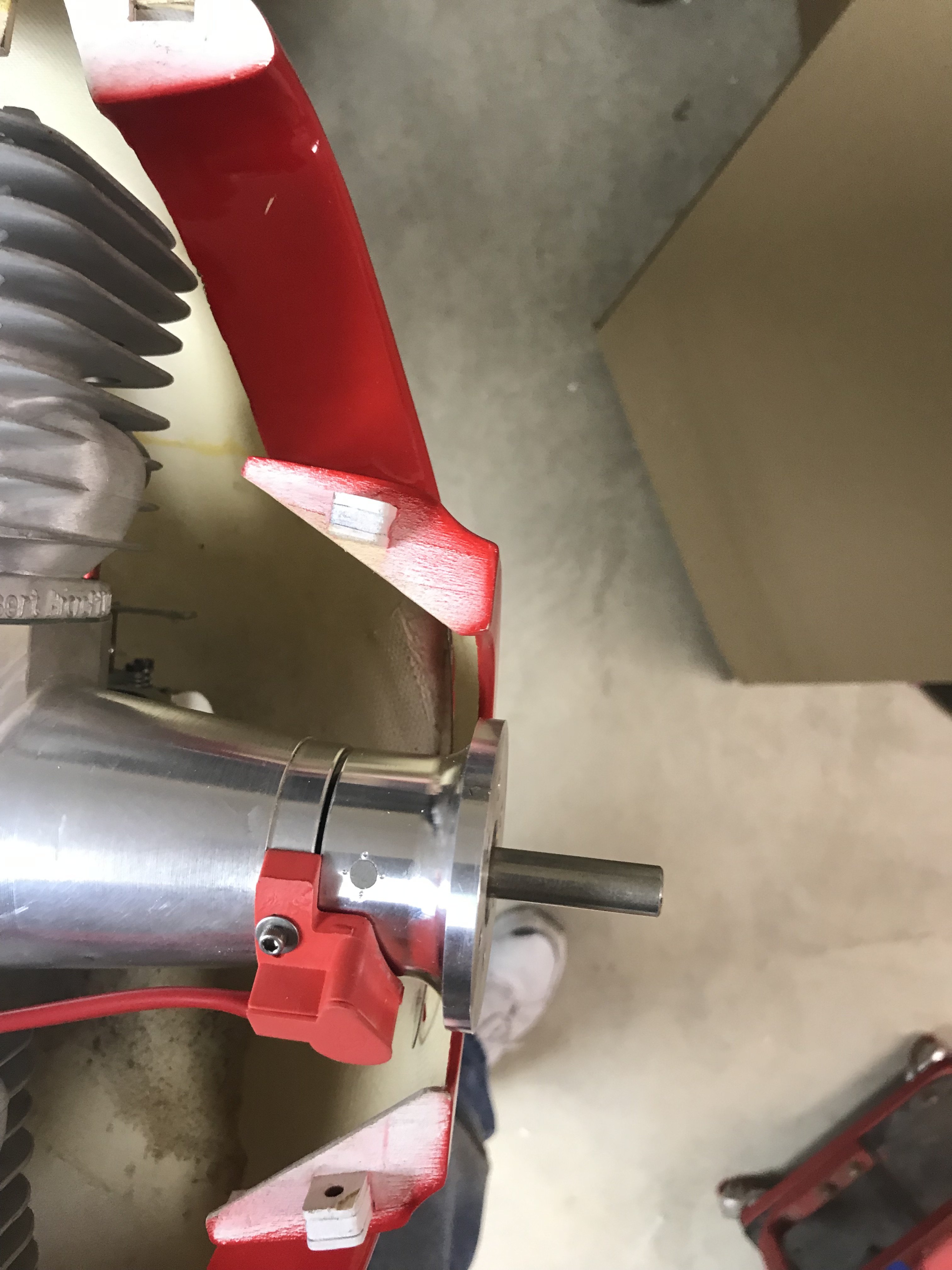

Concern I have now is for the overall width of the motor when the spark plug caps are put on....it appears that some cowl 'mods' will be required.
Any chance you could shoot a photo or two of your engine compartment with the top half of of the cowl removed, as I'd like to see the fit of yours with everything mounted?
Bill

Robert,
Bill
I'll go and get one.
