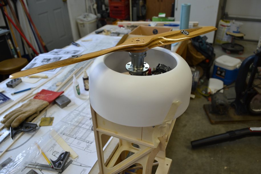

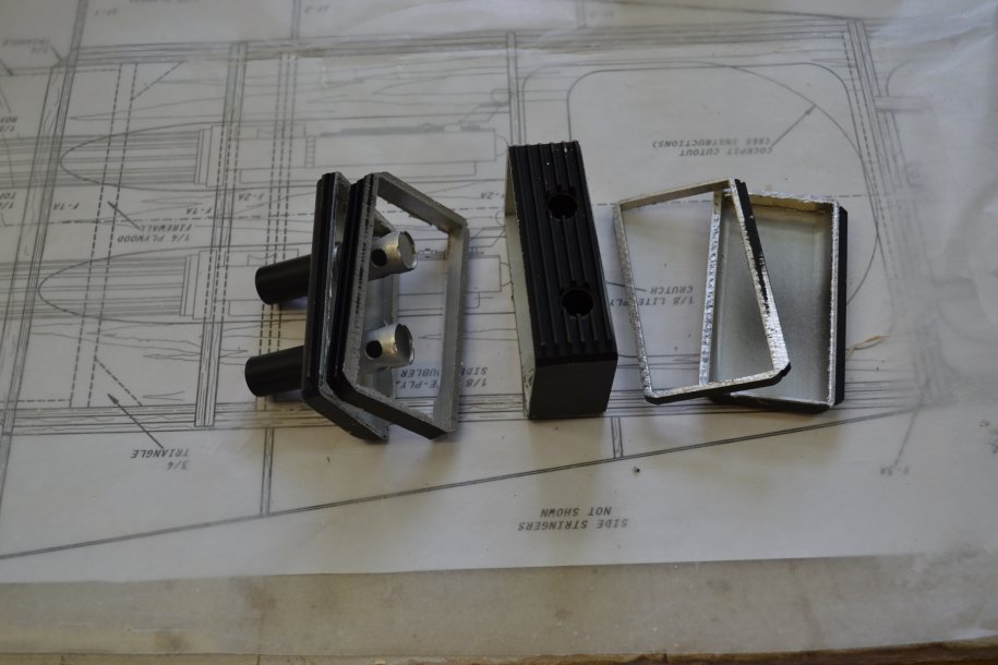

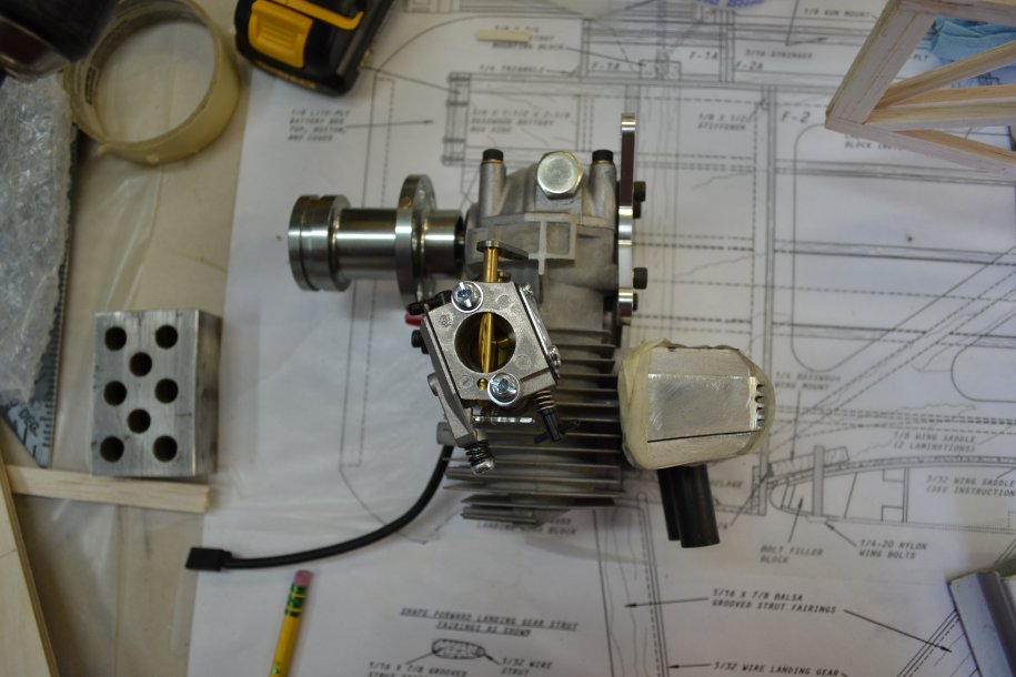

DSC_0053.JPG DSC_0054.JPG The muffler is not cast. Yay! Here is the idea I had. May need a spacer to clear everything and I'll have to modify the firewall but I think it'll work.
I tried welding on the scrap pieces. While I can weld it. It looks nasty. I called a friend and he's going to come over Wednesday evening after work and and weld it up for me.
Tseres

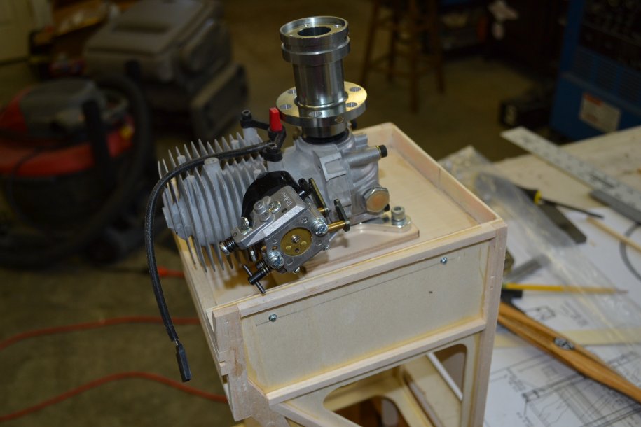

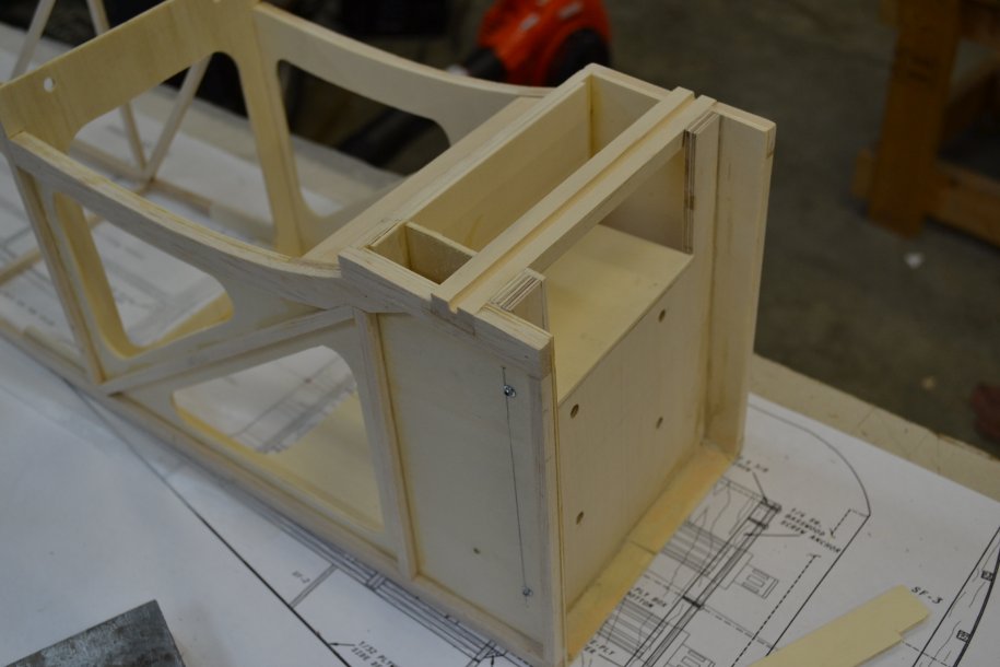

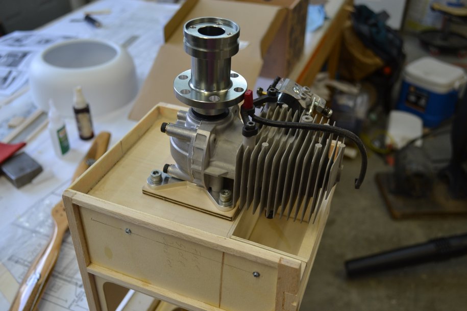

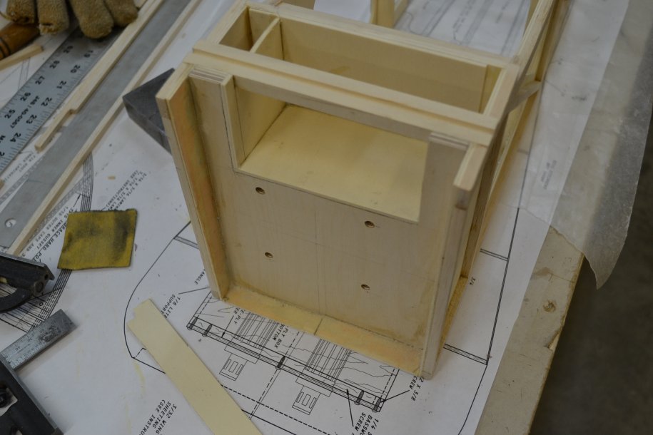

DSC_0001.JPG DSC_0002.JPG DSC_0001.JPG Once I figured out the muffler. I knew what to do with the firewall. The directions tell you to mount the firewall square and shim for thrust angle as needed. I don't subscribe to that theory. I put 2*down and 2* right thrust in it. I'm planning a 22-in. prop and that will have a lot of torc on the plane. That same thrust angle works great on my Fokker. I'll use that as my starting point.
This is whats nice about building a kit. You can build it your way. Of course if it don't work, I have no one to blame but myself. It'll work. :way_to_go:

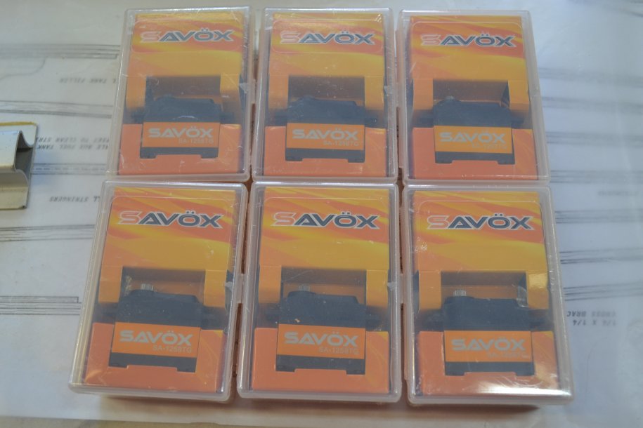

DSC_0005.JPG DSC_0006.JPG Yup... Today feels like Christmas. Package arrived from Brian at Code 3 Innovations. Talked with him on the phone for a while and decided to get a little more servo then I needed. I can use these servos in a 30cc Aerobat with no problems. Weather I keep the Camel or go to another plane these servos will work in either case. Got 5 1256-TG for the flying surfs and 1 1257 for the throttle. You can bet that I'll be slowing them down in this application. :)

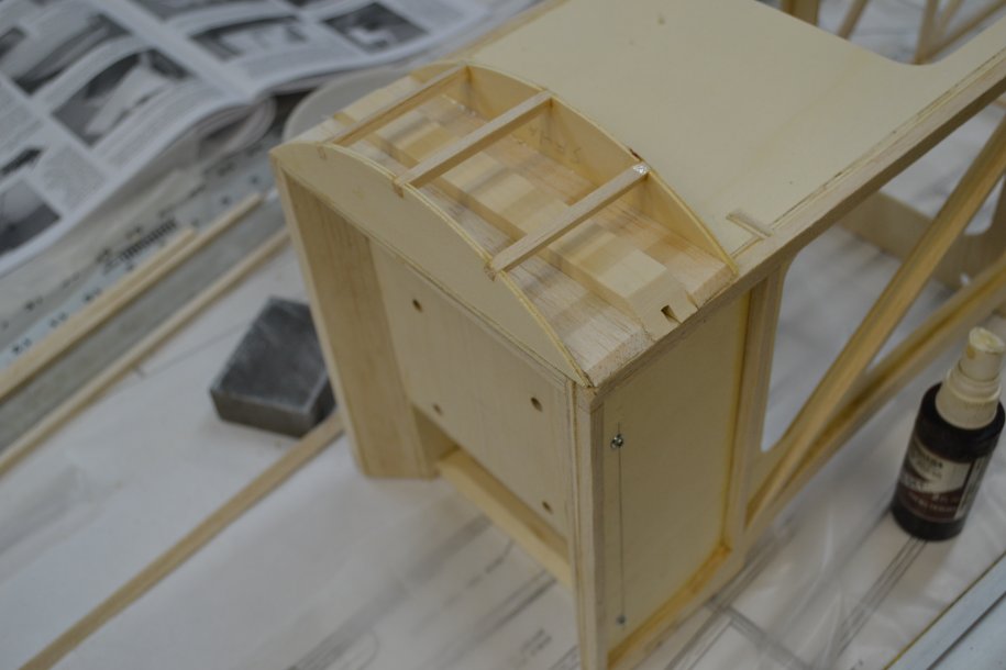

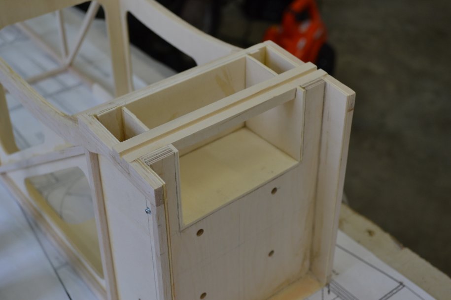

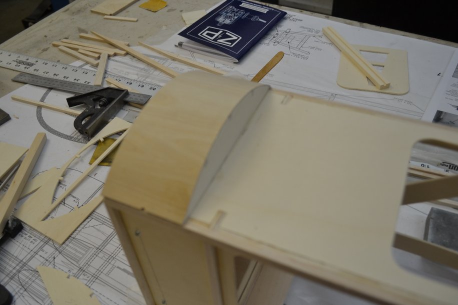

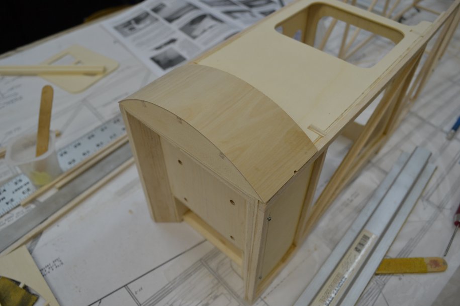

I finished the muffler tunnel and the firewall. Also finished the front deck on top.
