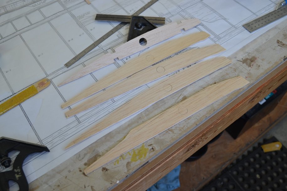

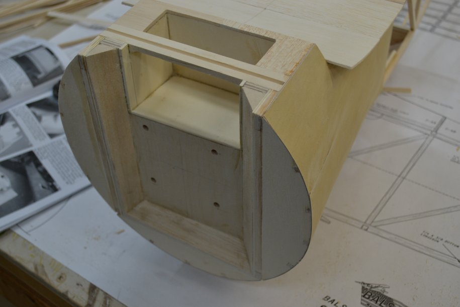

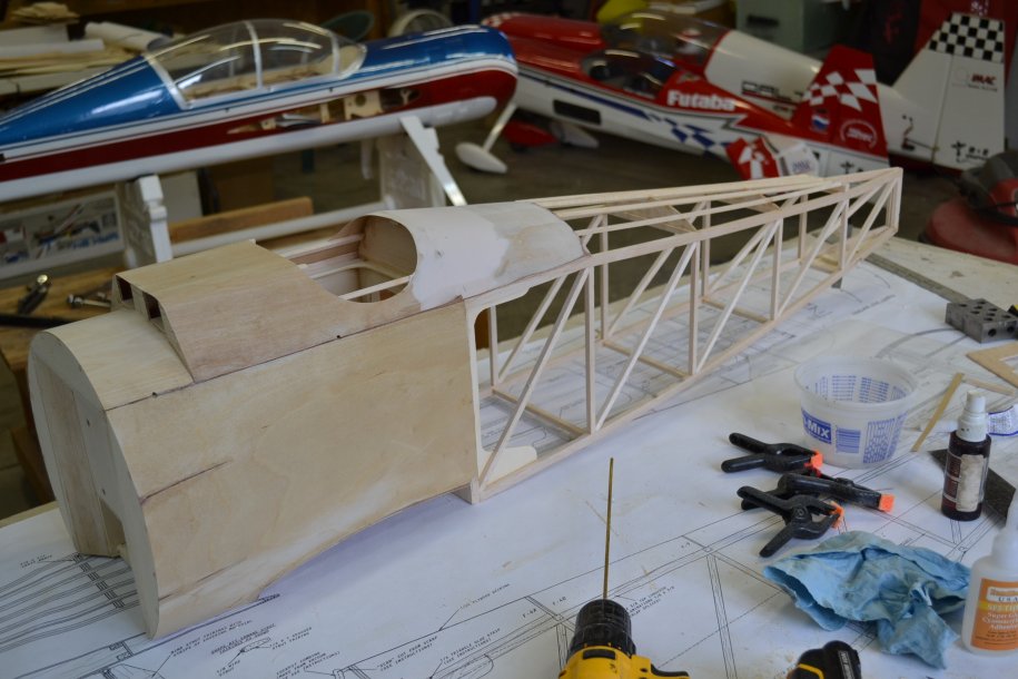

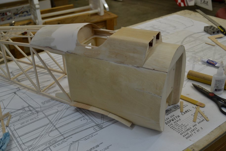

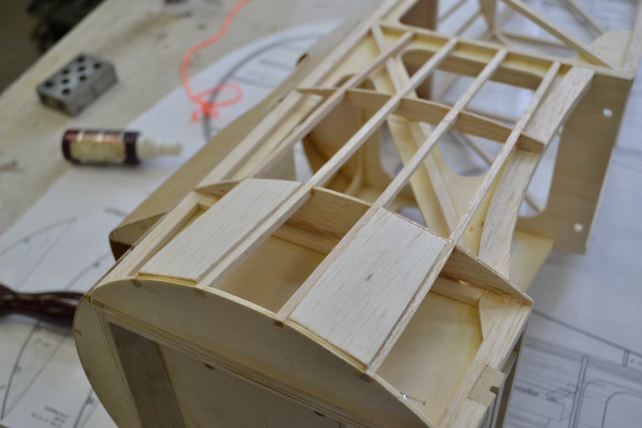

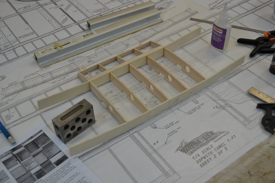

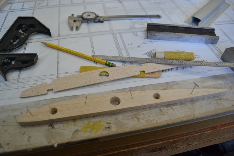

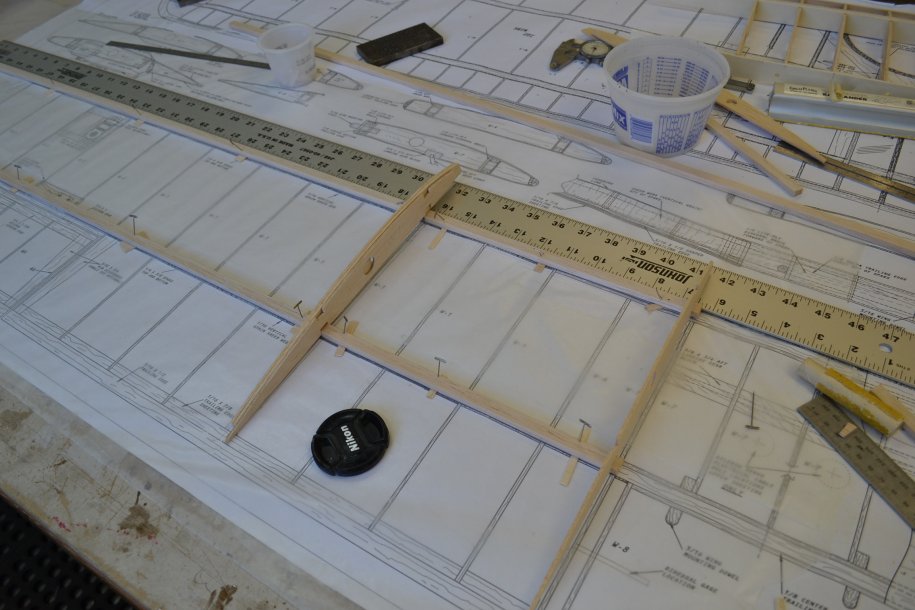

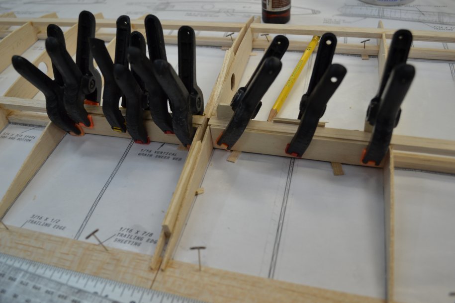

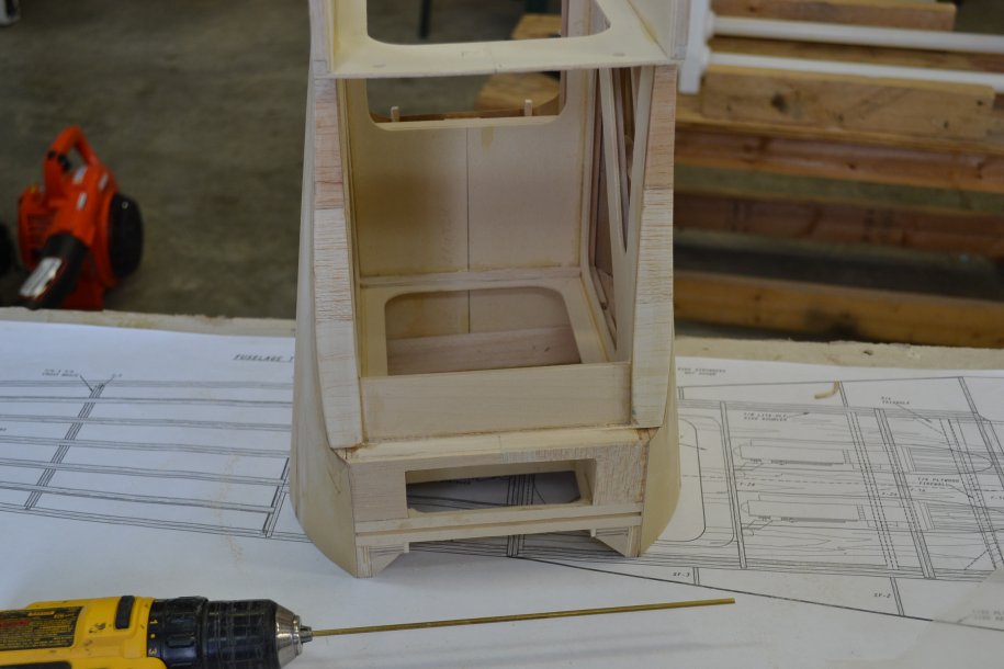

Starting to look like a Camel. I cut some 3/16 stringer out of some 1/4 in sheeting I had so I could finish the sides. I have a slitter that I forgot about till this morning.

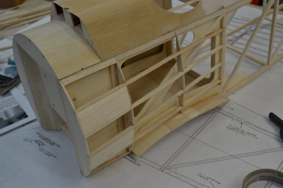

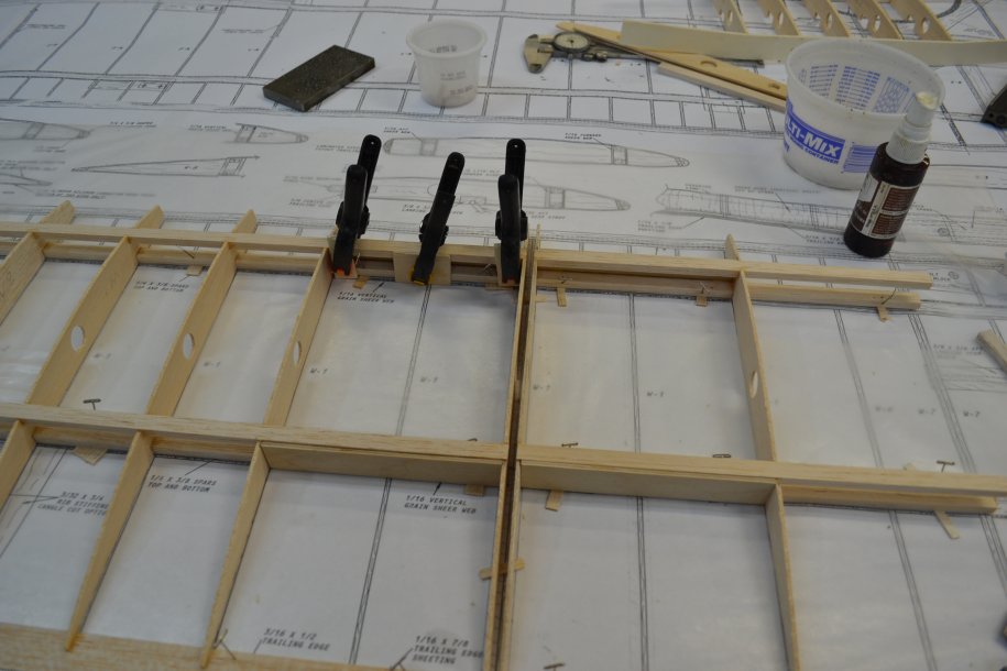

Directions said to use some Gel CA. Just so happen to have a few tubes. This is great where you don't want the glue to run and you need slower curing time... It is a little slower then thick CA.
That's all I had time for today but I like the way it looks.
