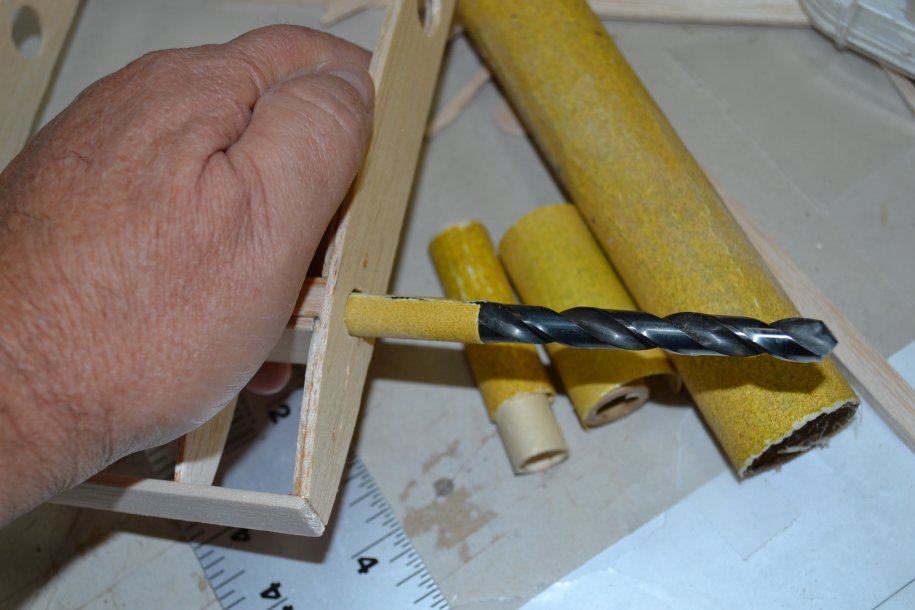

I'm going to start today with a tip on Tools.

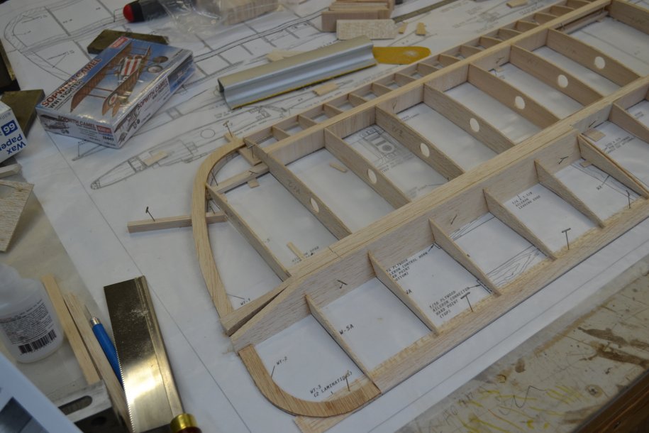

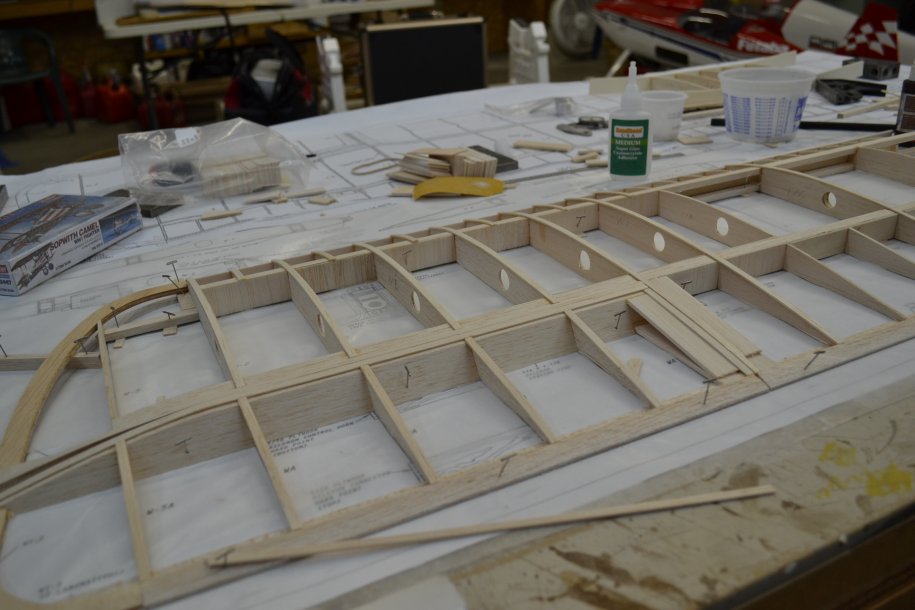

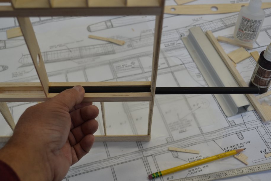

I found that I like the rolls of sticky back sand paper that you would use on your sanding blocks. I use 2 different roughness. 80grit and 180grit. I have several sizes of paper tube sanding blocks for sanding the inside of radii or circles. The hole size will be 0.440. That is real close to 7/16 of an inch. I pre drilled a 7/16 hole in the cap rib. Then I had to open up a hole in the ribs provided in the kit. After gluing on the cap rib I cut the hole in the inner rib with an Exacto blade and finished sanding it to match the original predrilled holes with the sanding tool that I made out of a drill bit. Worked out great.

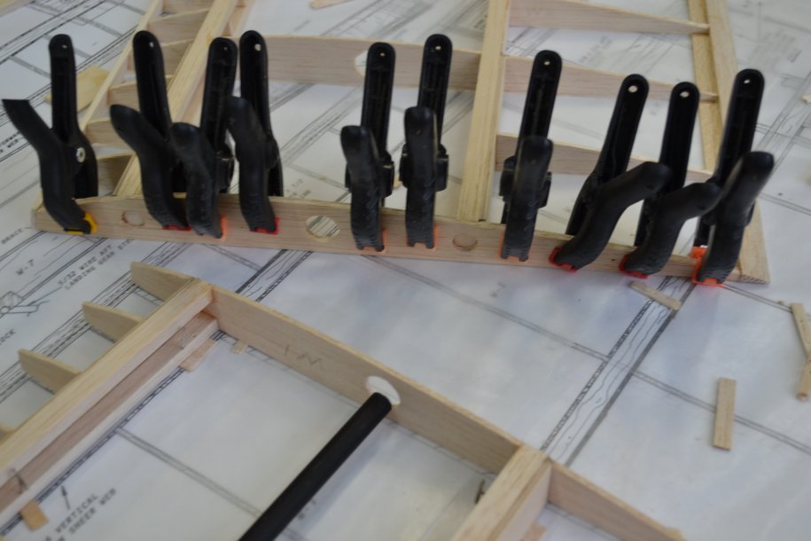

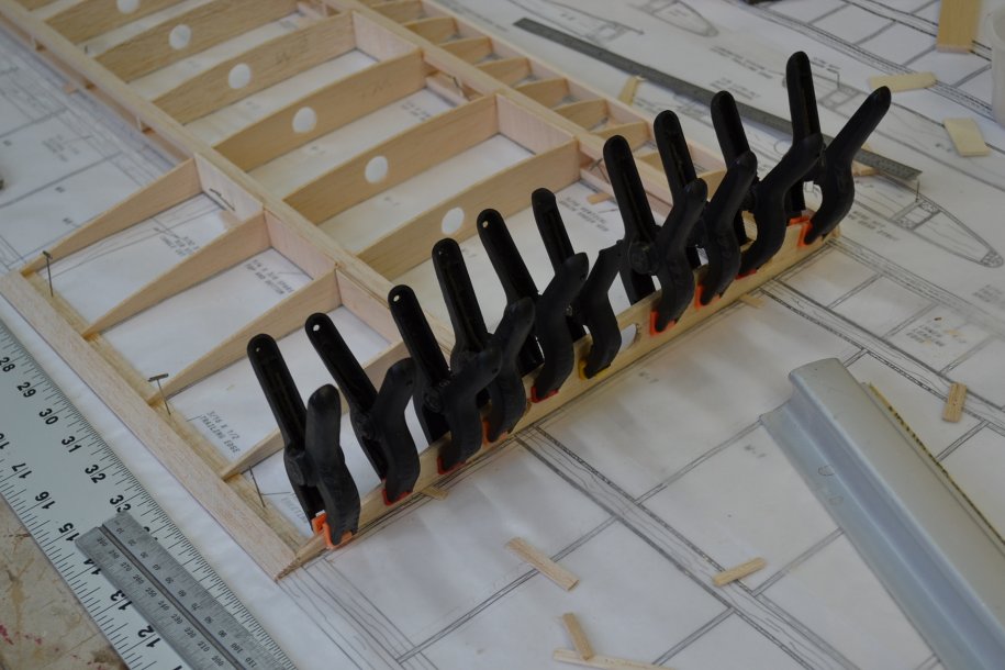

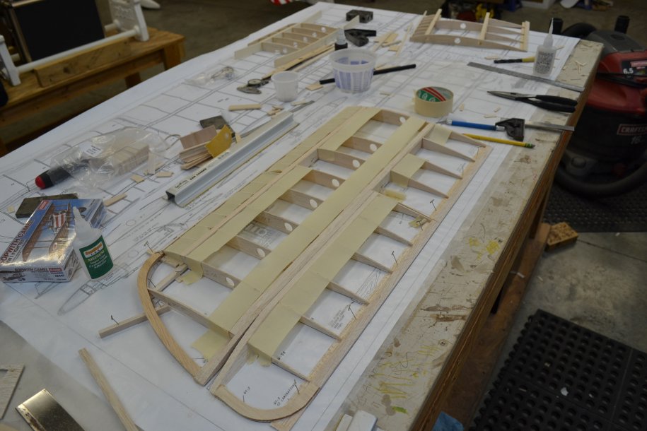

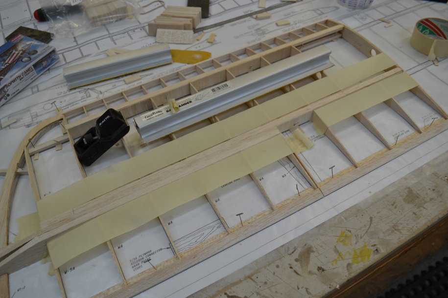

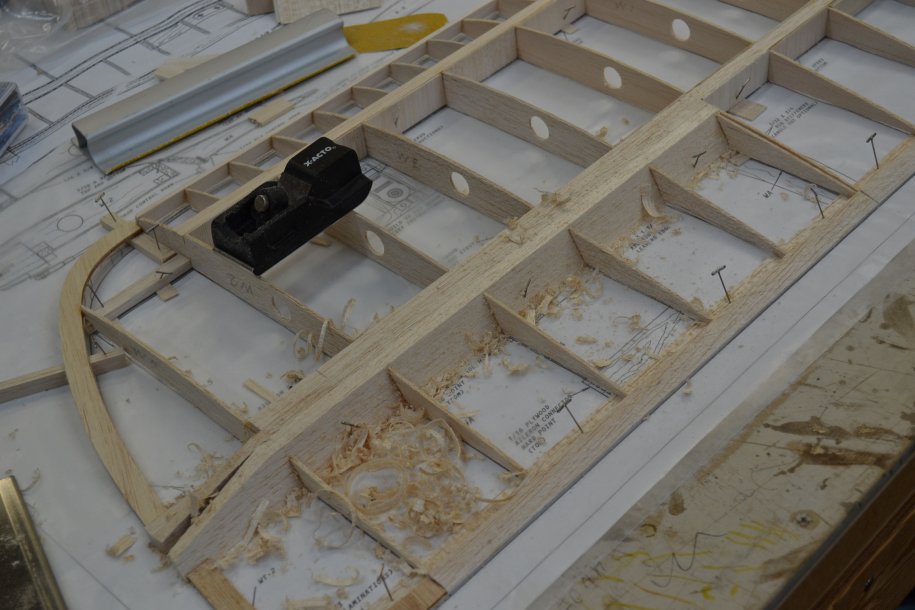

I'm going to finish as much of the outer part of the wing as I can before un pinning it. I put on the cap strips where ever I could. I'll unpin it tomorrow and sand the bottom.
DSC_0070.JPGDSC_0071.JPGDSC_0072.JPGDSC_0073.JPGDSC_0074.JPGDSC_0075.JPGDSC_0076.JPGDSC_0077.JPG

Nice build tips Tom. Sticky backed sandpaper? What will they think of next? Lol.
I usually wrap sandpaper around a "fat" exacto handle. Boy am I old school.

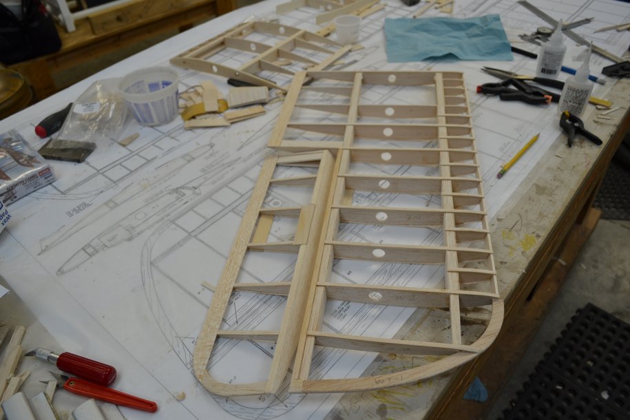

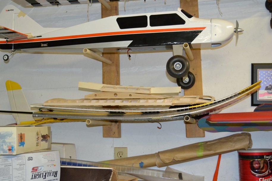

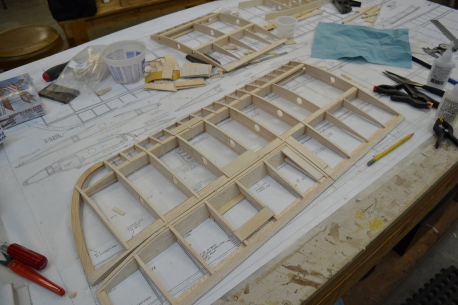

I finished up what I could. Mounted the hard points, the cap strips and hinged the aileron. Then put it up on the shelf.DSC_0078.JPGDSC_0079.JPGDSC_0080.JPG
