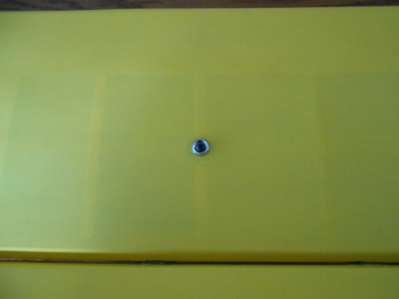

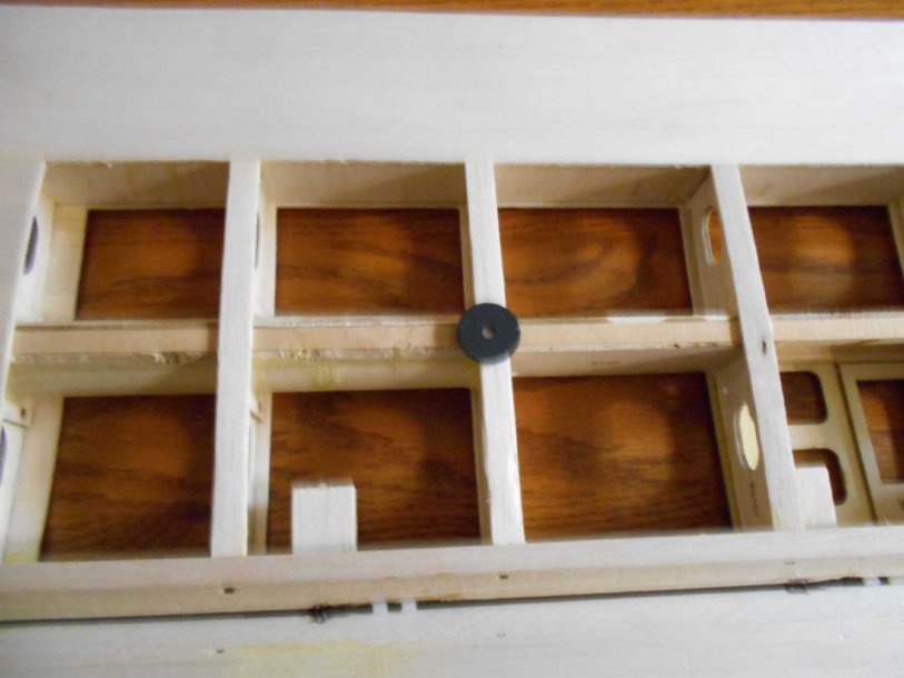

So I went with a simpler approach that has been done on many planes that I have owned. I am just using a simple bolt thru the wing into the wing tube.

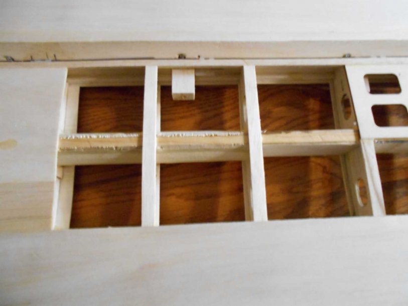

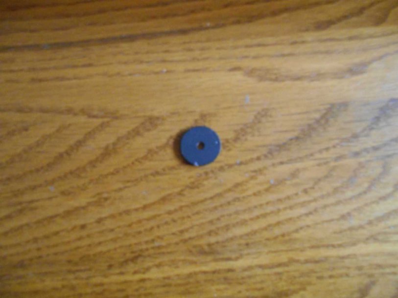

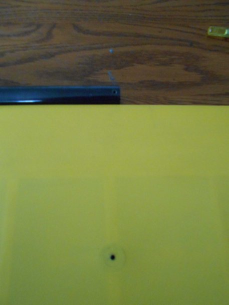

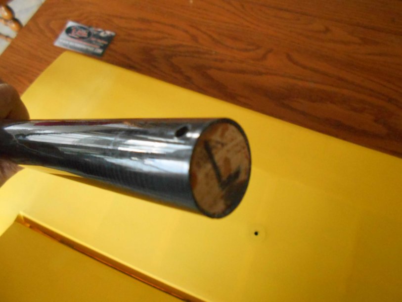

But first I put in place a "Crush Washer" that would spread the load from the screw head over a wide area. I then inserted a 1 inch long wooden plug just inside the end of the wing tube. Once I had it installed I assembled the wing (temporarily using the supplied wing bolts) and drilled thru the center of the Crush Washer and into the plugged wing tube. I then tapped the hole with a 8-32 tap, soaked it in thin Cyano and then re-tapped the hole. Many planes use just a 4-40 long bolt, but I opted for a more substantial bolt that has more bite into the wood as it is screwed in.
So now instead of 4 bolts to hold the two lower wings on, I only need 2. And these two are MUCH easier to assemble.
