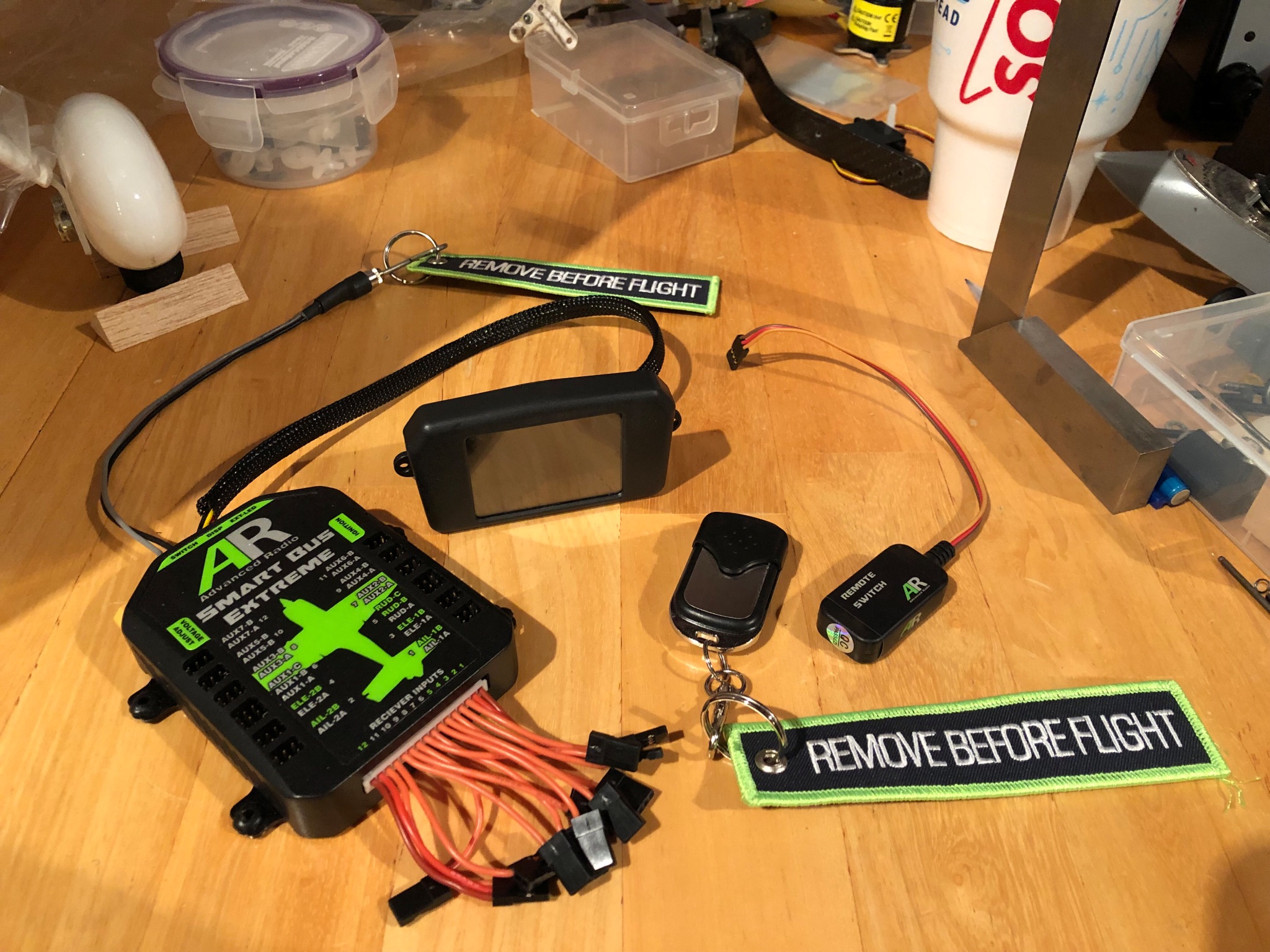

They are great love the unit works well. Did not get the remote but still nice unit great for setting up multiple servos.Picked up a new device a few weeks ago, but haven’t put it in the airplane yet.
With the fancy remote, I’m not sure if I’ll turn on the airplane or unlock the car??!!!

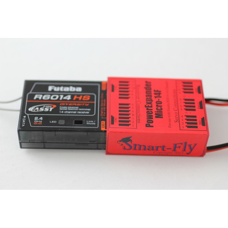

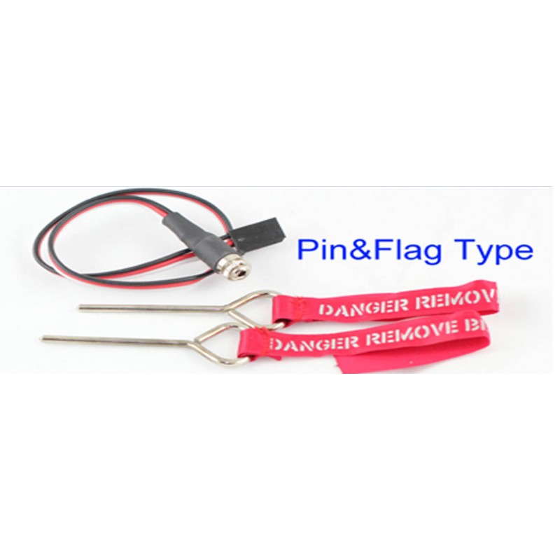

Hey Kelly, I have seen those Smart Fly units and I'd like to try one of them in a plane.Don't know if you want to spend the funds but when I was flying Futaba's 14 channel Rx's I always matched up a Smart-Fly power expander with them. They have a "compact" micro that the Rx plugs into. Has dual battery inputs and is or can be turned on and off with a pin / flag failsafe switch.....

Hey Wade, it probably does both. . . . . . .Picked up a new device a few weeks ago, but haven’t put it in the airplane yet.
Dude, that is some fancy dancy stuff you gotz there. Fill a brother in. I like.... Oh and your avatar is awesome my friend. You have pushed me back to one of my favorites. LOLPicked up a new device a few weeks ago, but haven’t put it in the airplane yet.

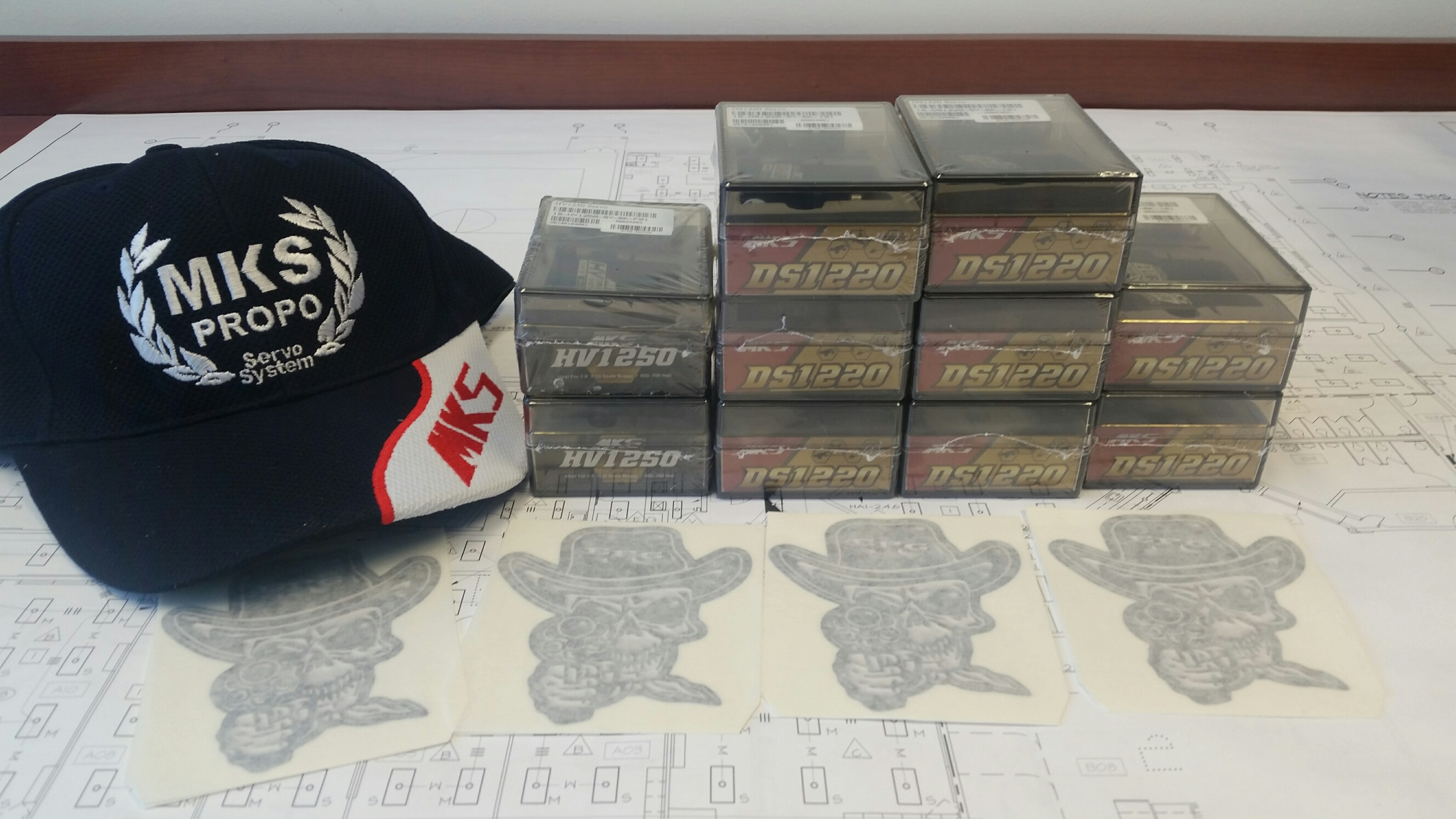

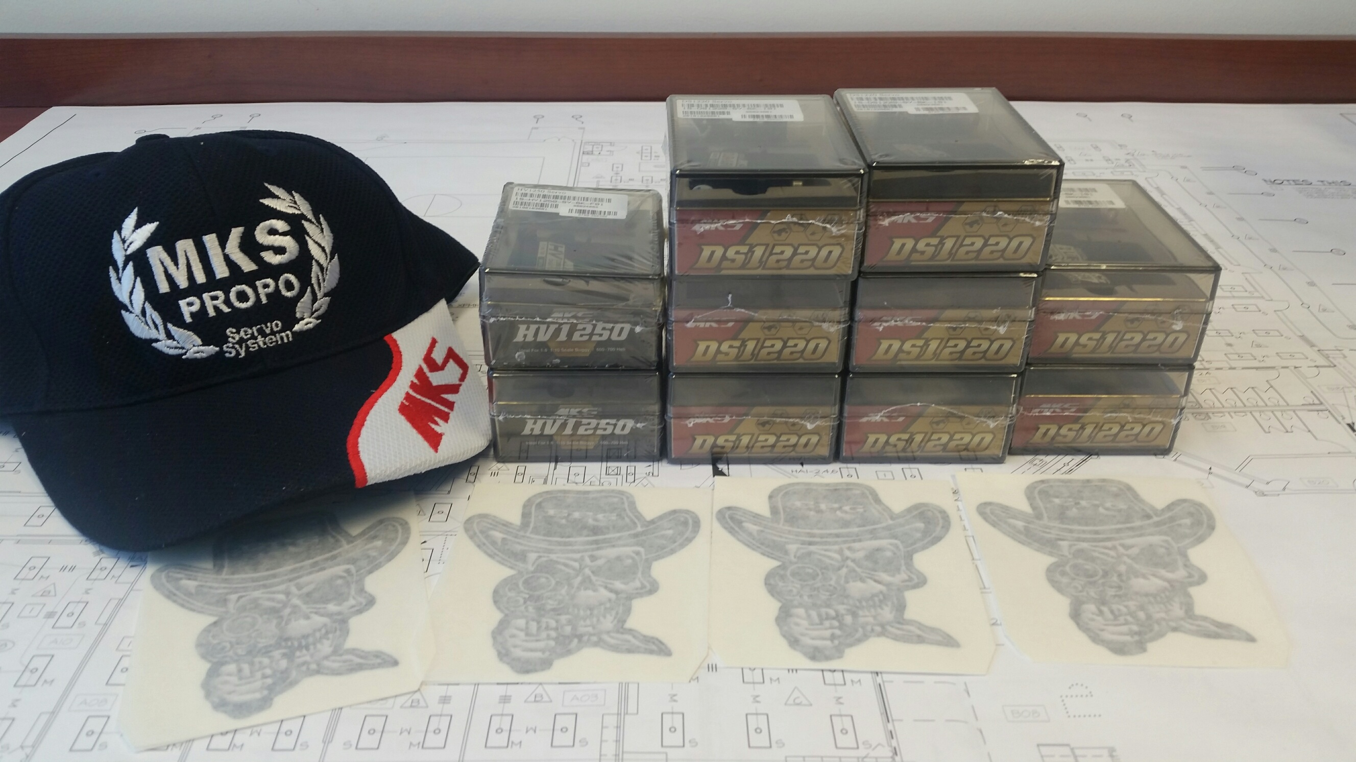

Just popped in for a little Yak 55 update. I ordered my servos Friday afternoon from @pawnshopmike Friday afternoon and look what showed up today. . . . .. The other things I ordered on Friday were the ignition battery and the receiver batteries.
It wasn't long after I opened up the box though, before I realized what a dumb a__ I am. . . . .. Most of you already figure out where I'm going with this. Anyhow, plain as day, the side of the servo case of the DS1220's it says Li-FE 6.6V (and I think it says "2 cell" too). These should be PLENTY strong for the control surfaces of my Yak, no problems, right? Wrong. . . . . . .
. Later on last Friday evening, my dumb a__ ordered three 2900mAh 2 cell Li-Ion batteries that we all know are rated for 7.4V. . . . . .
. I thought I was doing so well because the Li-Ion's were on sale for like $49.00 each. The only bright side to this entire fiasco is that my battery hadn't been shipped yet, so I was able to exchange the batteries for three 6.6V batteries. Of course, the saga doesn't end here because the Li-Fe batteries were not on sale so they ended up costing me almost twice as much as the Li-On batteries. Sometimes I wonder where my brain is. . . . .
. Now, I know some of you are sitting back and thinking "why didn't you (me) just buy a couple of voltage regulators and be done with it?" Well, IMHO, a voltage regulator is just another possible failure point in the plane that I didn't want to have to worry about.
