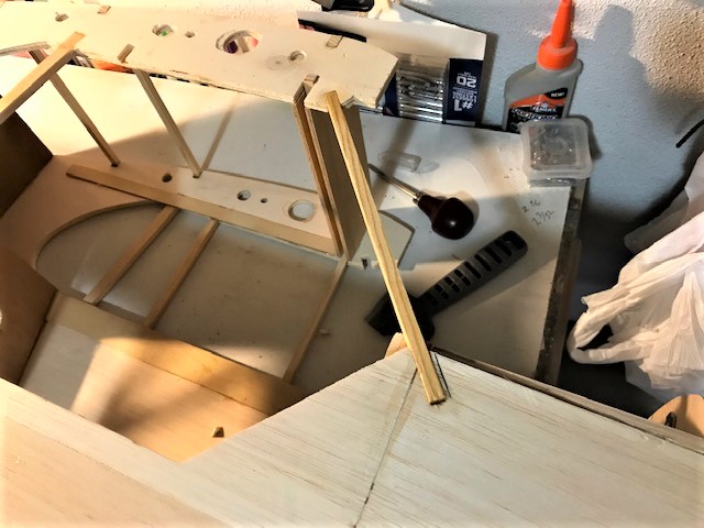

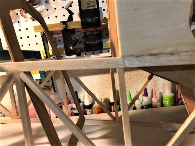

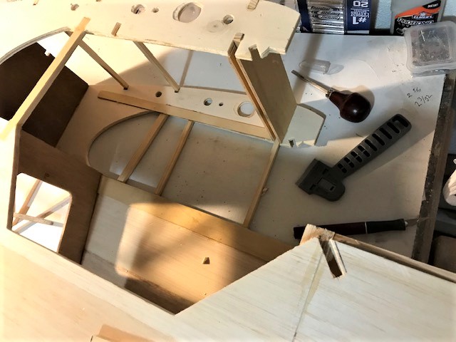

I also need some advise. While setting the rear formers in place, I heard a crack. The mid stringer cracked just infront of F8. How would you guys fix this. I went ahead and cut the other side, so it cracked too. I didn't want a bow on one side and the other side to be flat. So both sides are flat now. I thought about an 1/8" carbon rod inlay, or cover over the top with 1/32 ply maybe. What is the best way to make it solid again?? Thanks

I cannot see the vertical member very well or the back side. But I'd razor saw the vertical member from the cracked joint and add a strip of ply/or G10 that's approx 1/2" long in between the vertical member and the stringer. Then add a "T" or "X" patch on the back side (inside) in similar fashion.
Thanks guys! So If I'm thinking right, I take out the verticle 1/4 x 1/4, then add some ply along the bottom of the cracked stringer, then add a new verticle with gussets?? Thanks agian.
AKNick
Thanks guys! So If I'm thinking right, I take out the vertical 1/4 x 1/4, then add some ply along the bottom of the cracked stringer, then add a new vertical with gussets?? Thanks again.
That's what I would do - but lots of ways to do have the same basic result.
