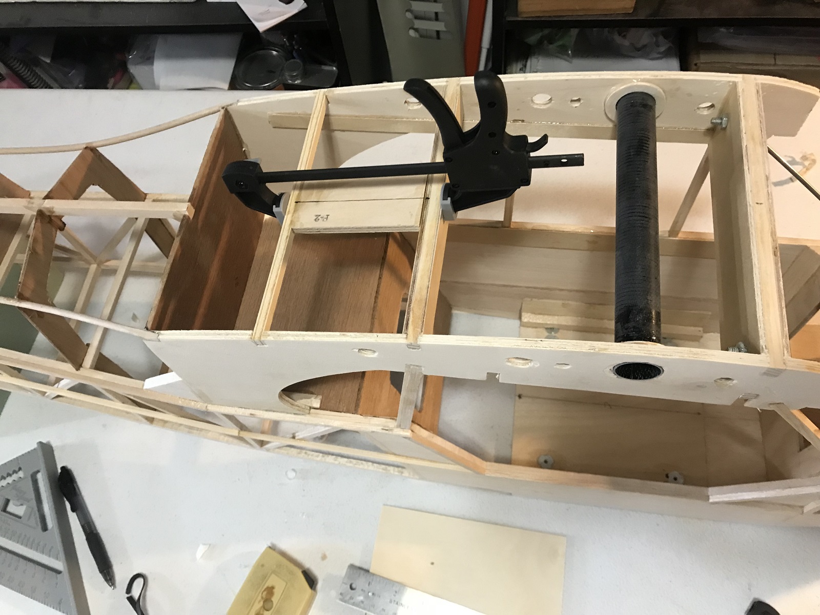

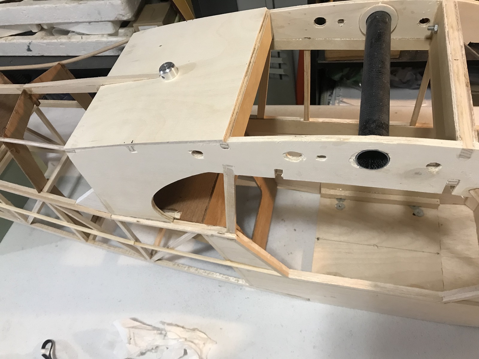

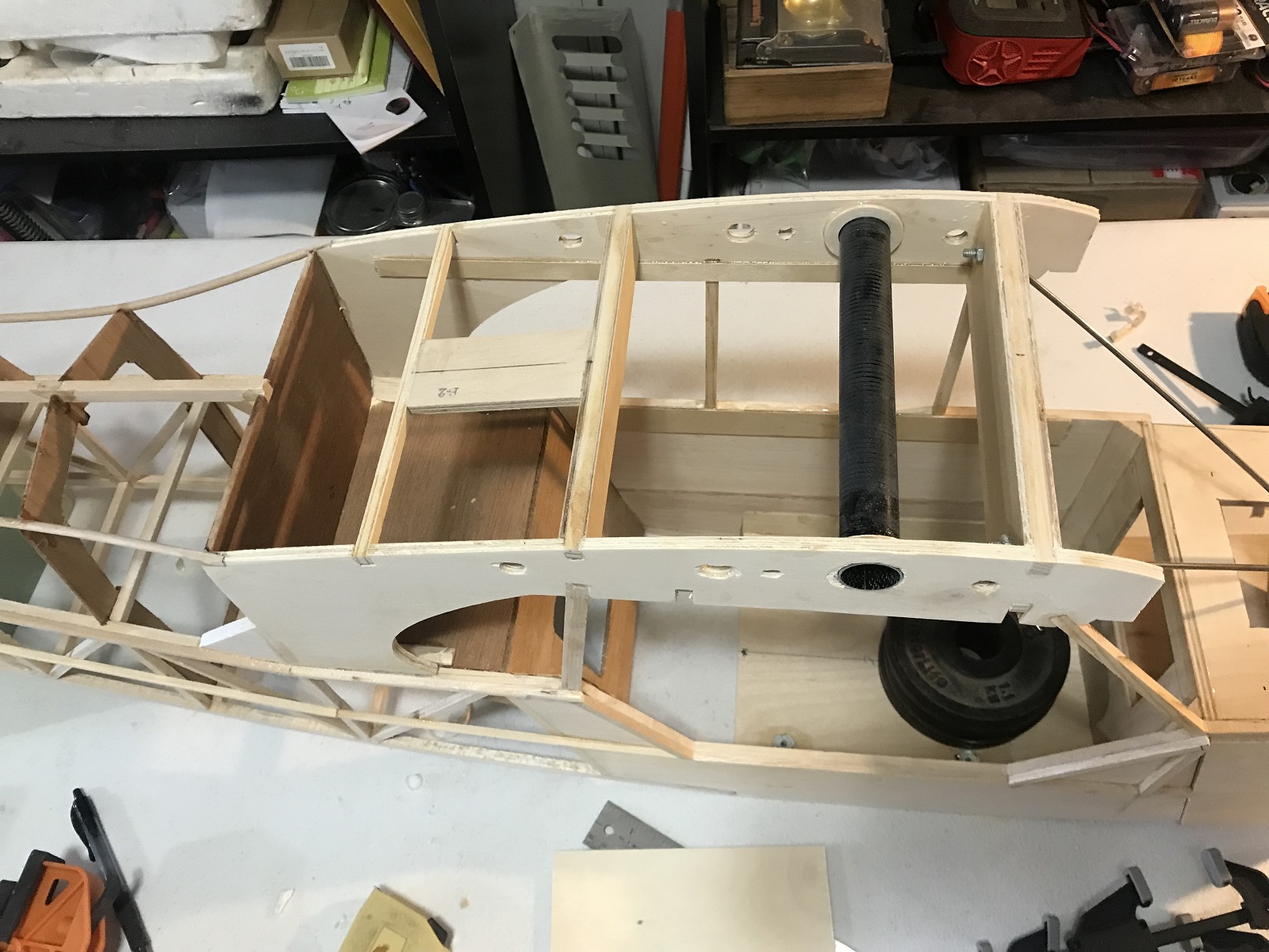

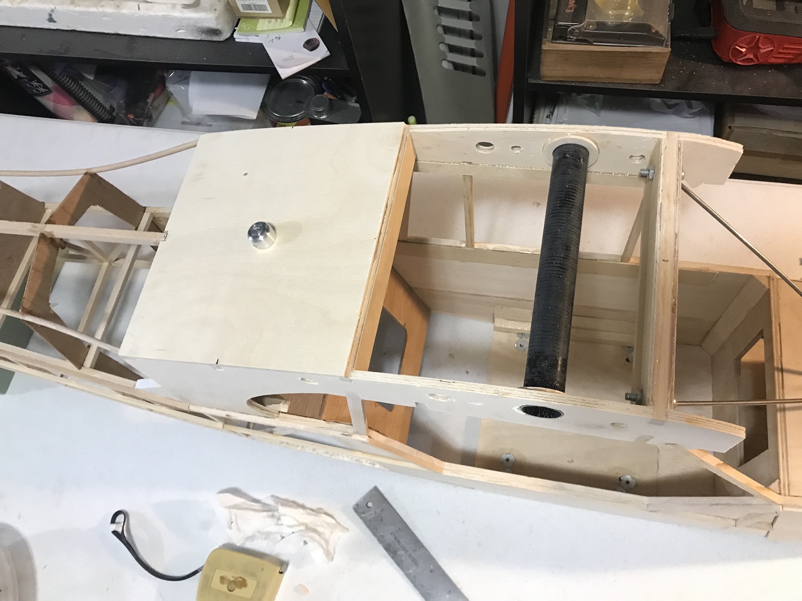

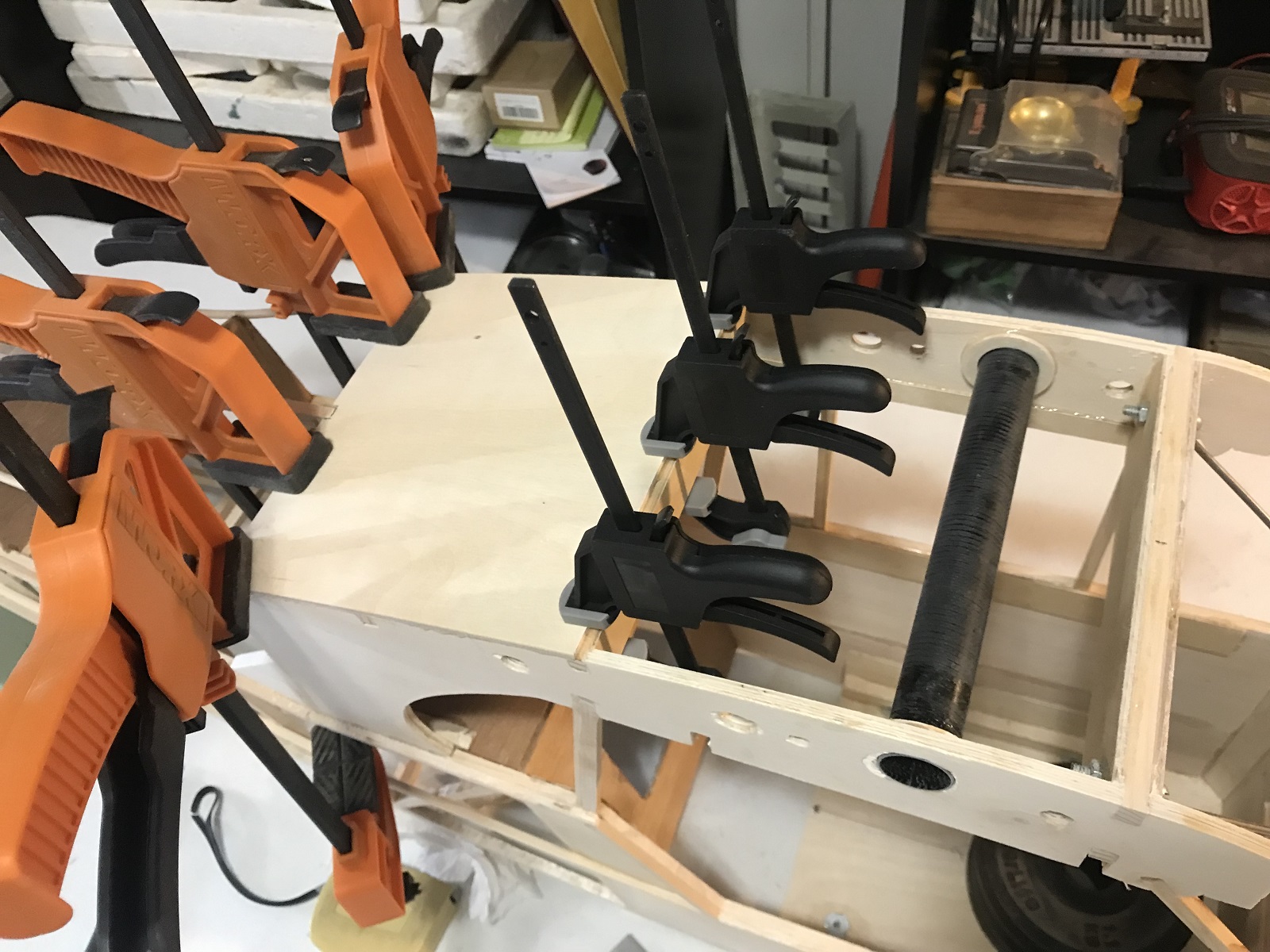

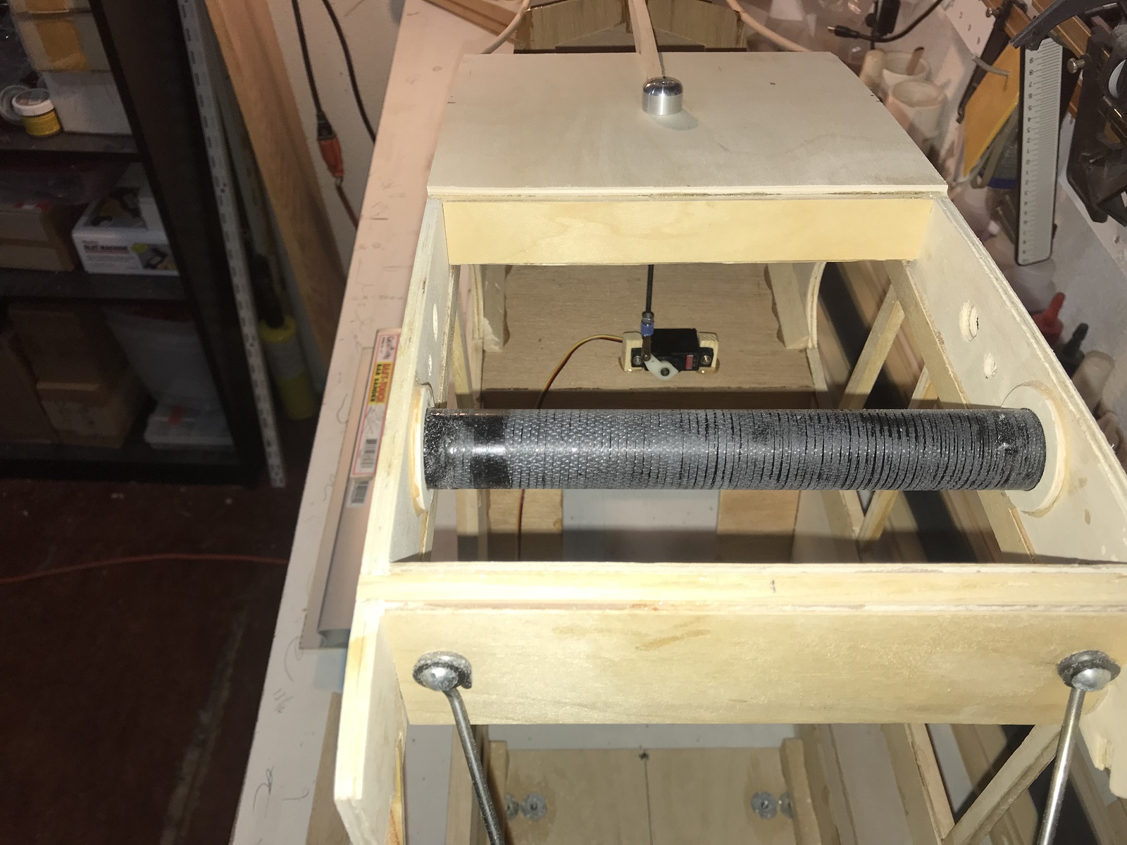

I used some 1/8 ply to cover the rear cabin top. I also used the F2 that came with the kit and not needed, to add a center support for the tow release. I should have moved the tow release another 1/4 inch forward, so the servo was on the face of F6, I thought it would be, but missed. I might have to make up a bag to stick over it.
