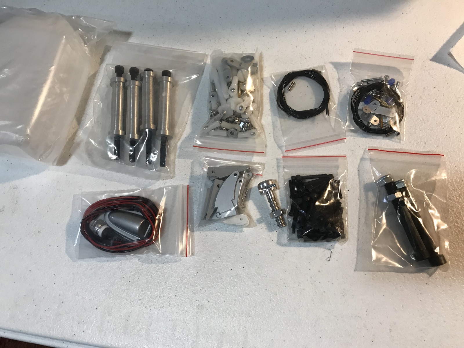

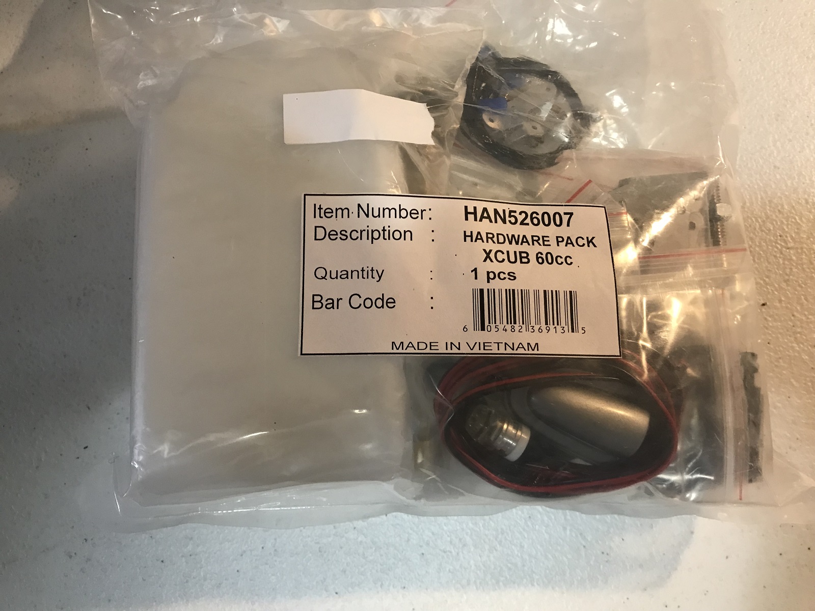

Got a delivery today. I ordered a hardware pack for the X Cub 60 for some of it's contents.

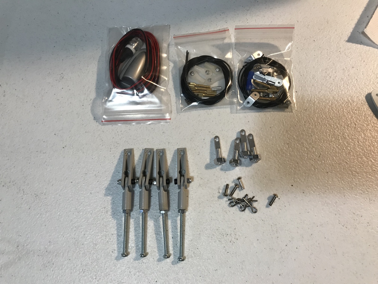

These are the parts I plan on pilfering. The main reason I picked it up was for the wing strut components. But I will also use the tail brace wire kit and probably the pull-pull system it included. I could not find any 6mm blind nuts, so I just picked up some 6mm nuts and I'll counter sink them in a block of wood, then glue it in place. I had a set of strut mounts from a crashed Decathalon that worked out for the Cub. The strut pins in the hanger 9 hardware package will work out for the strut mounts as well.
That’s the rudder light and servo exit fairing’s for the wings that come with the hardware kit! I think the rudder light will be too big for me to use though.
