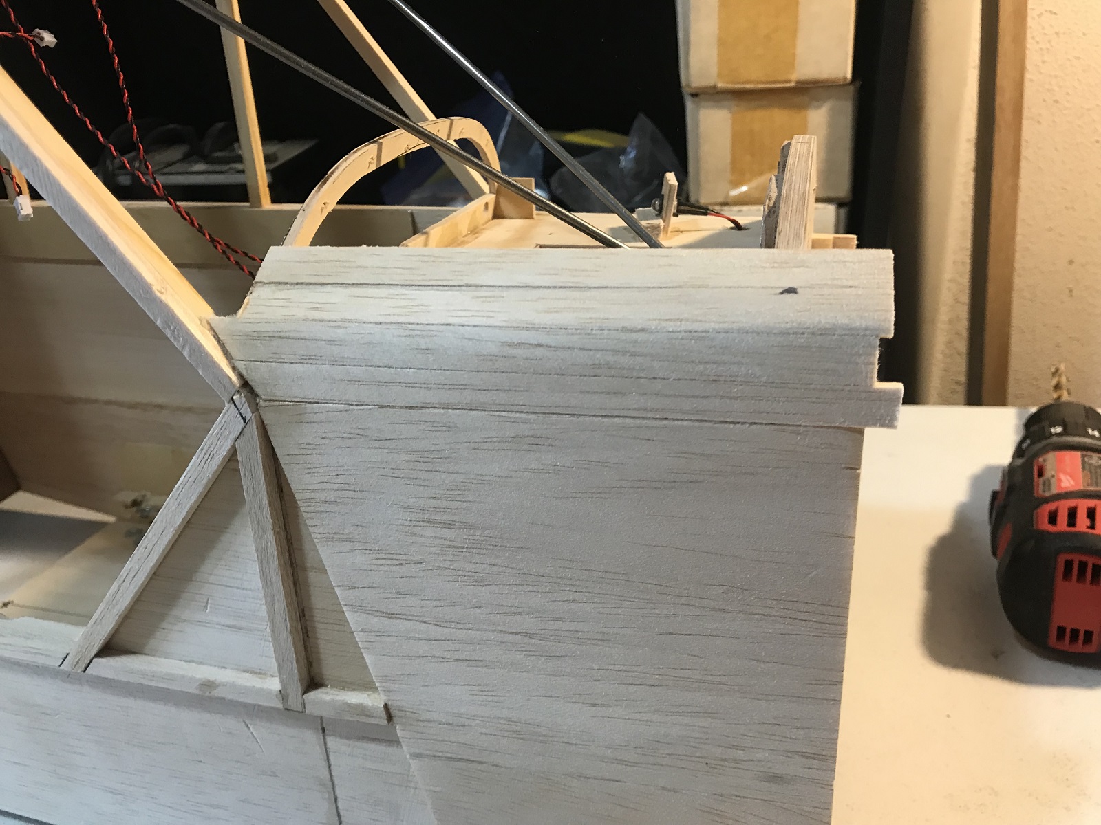

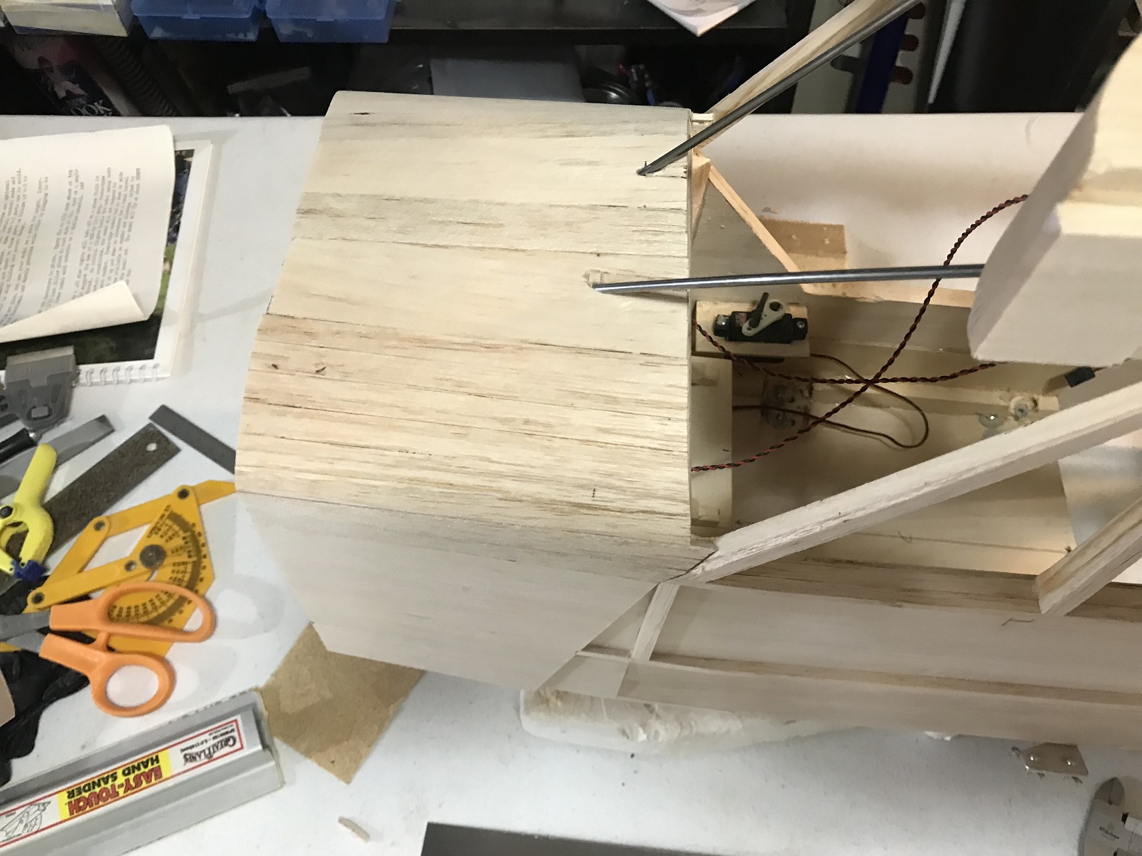

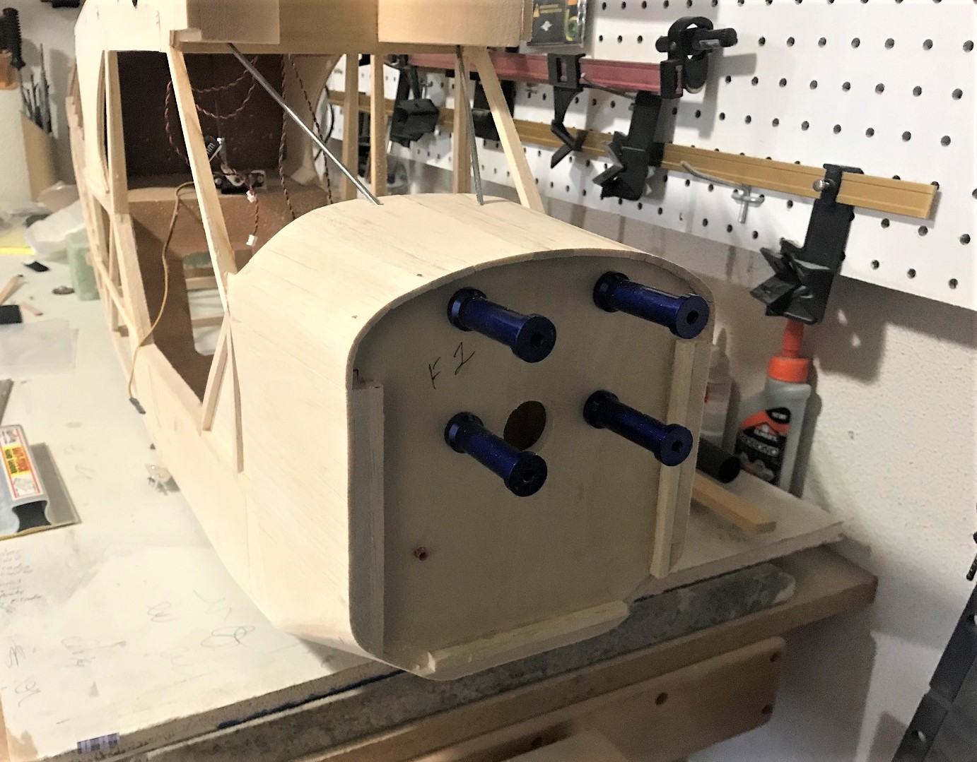

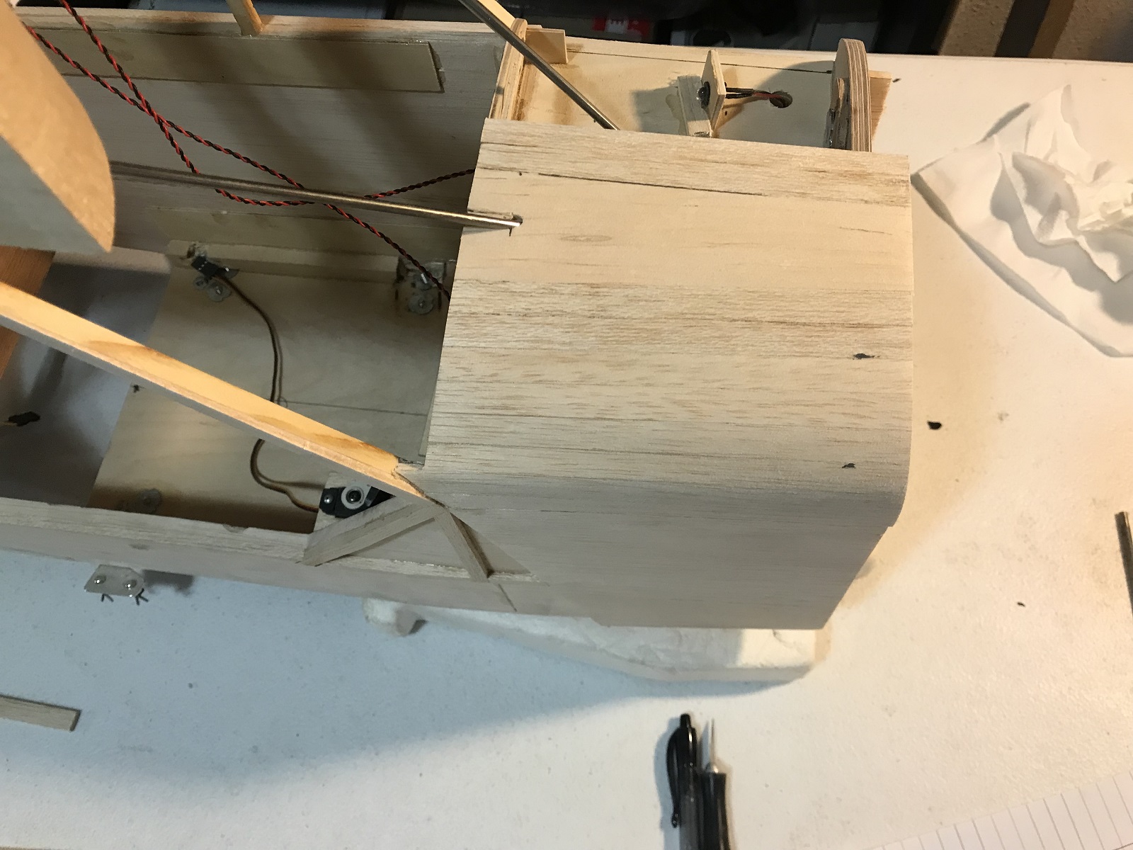

Before I can get too serious with the getting after the door, I needed to finish up a few things. I added the upper fuse strips and got them all sanded down, as well as the forward fuse sheeting. I decided not to wet a large piece of 1/8" balsa sheet, and deal with all the cracking while trying to form it around the curves. I went with a shiplap style of covering forward fuse and it worked out good. I also used a denser grained balsa strips for more strength on this area, as there's no 1/4 x 1/4 stringers underneath.
