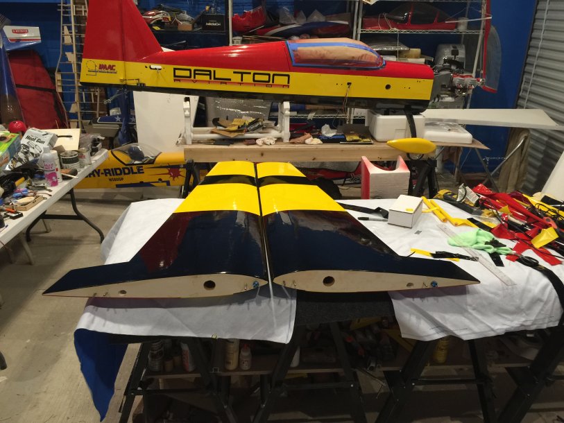

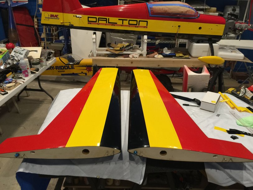

wings are covered. still need to do the ailerons...

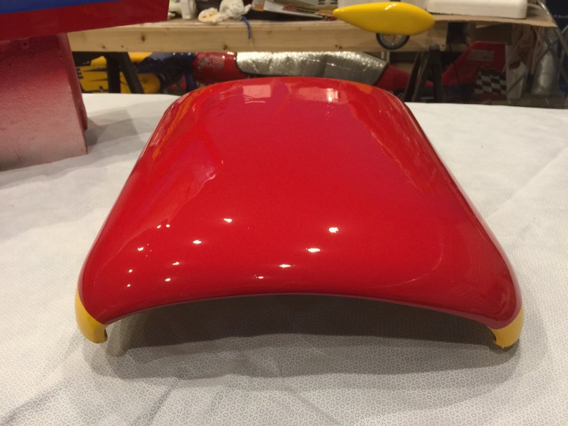

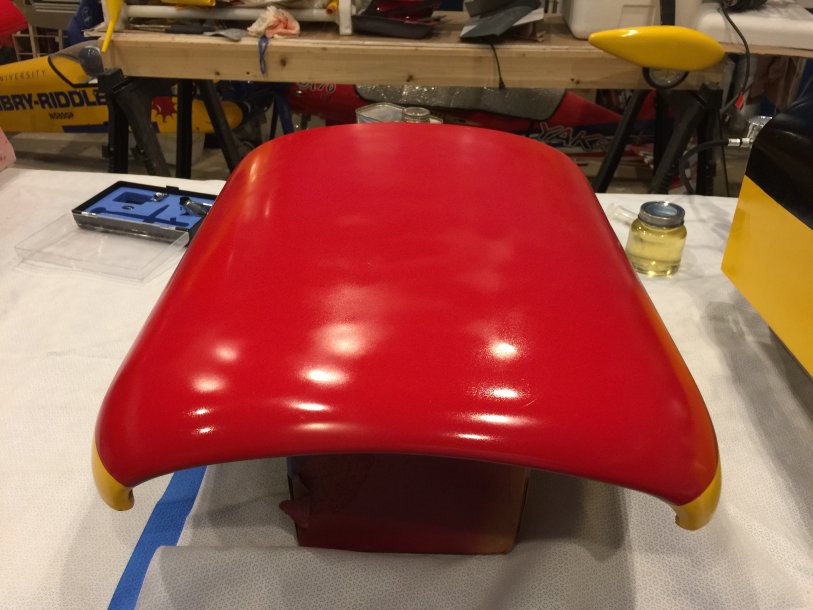

i have hit a snag!! been trying to fix this for past 3 days. i am having some serious issues with the clear coat. when i applied it 1st time, using the HVLP gun, i developed these "solvent pops". Arghhh, what a mess. i then had to sand it down all the way, then i tried brushing the clear coat on, again, better, but still not where i want it. so today, i took it to an automobile painter, and he wants 300 dollars to spray on the clear coat!! Seems to me to be way too much money!! anyone know what i can do?
well, i just finished the last coat of clear, and i realized what i had done wrong. the 1st 4 attempts, i had put too much reducer with the clear coat mix. Now i know, with clear, it is much less reducer (thinner ) required, compared to the colored paints or primer.
