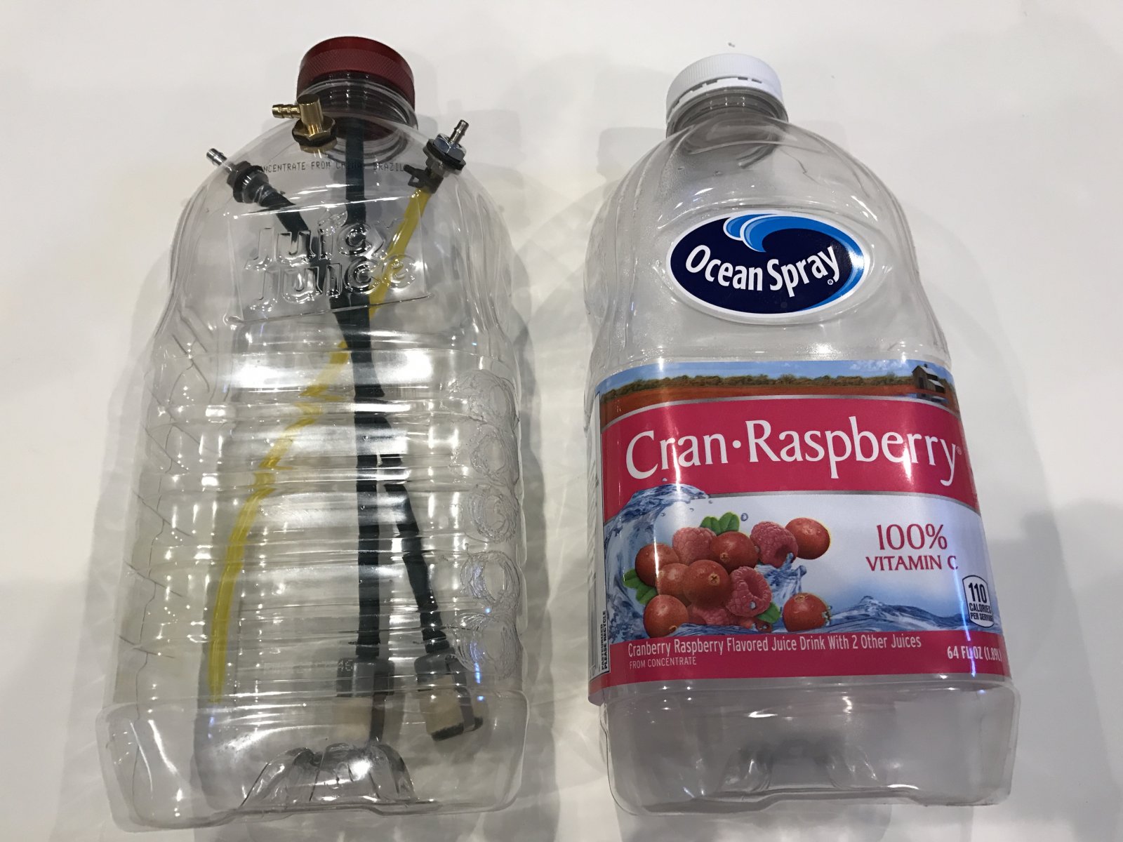

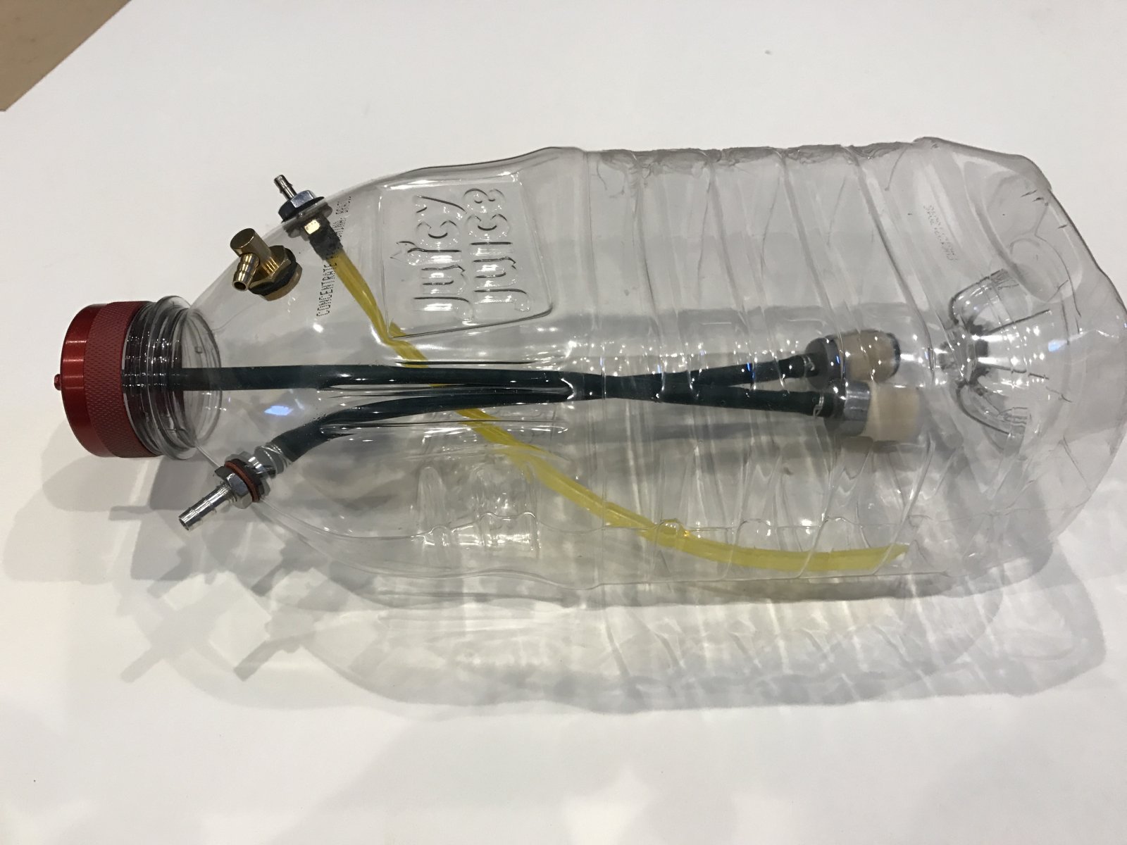

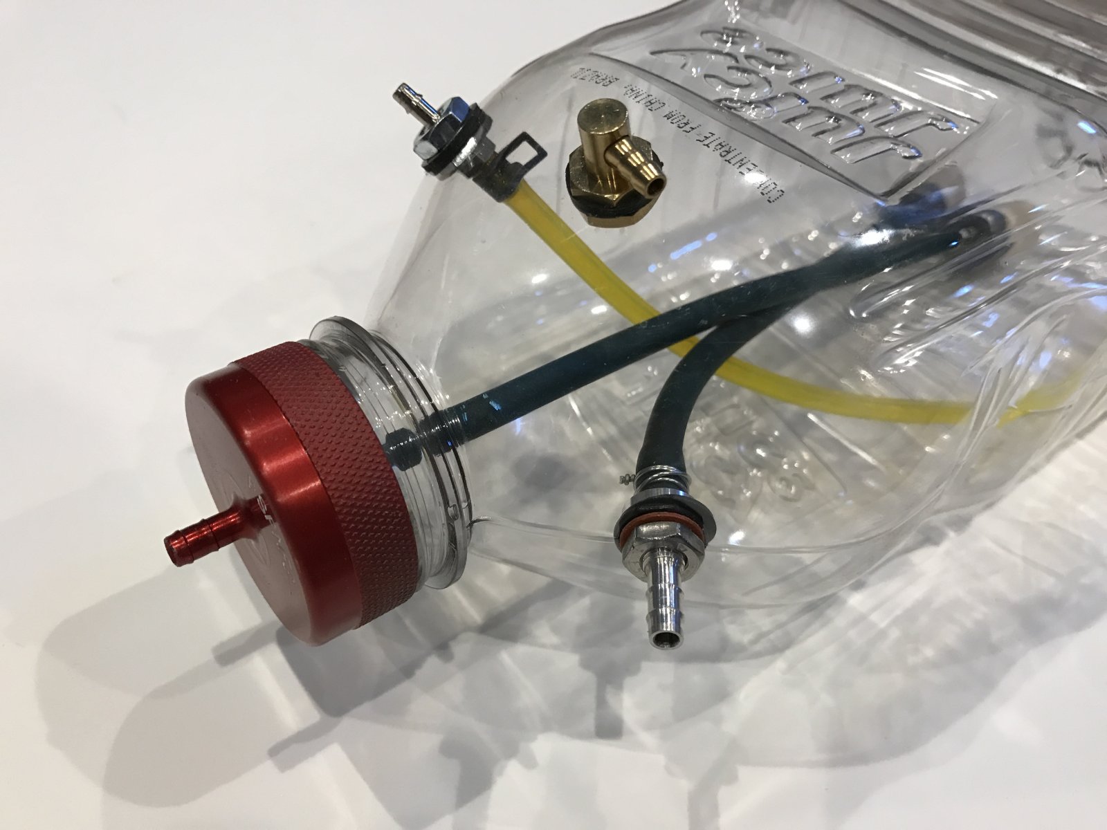

did some more work today on the Cardens.
Got the tank done for the one with the 200.

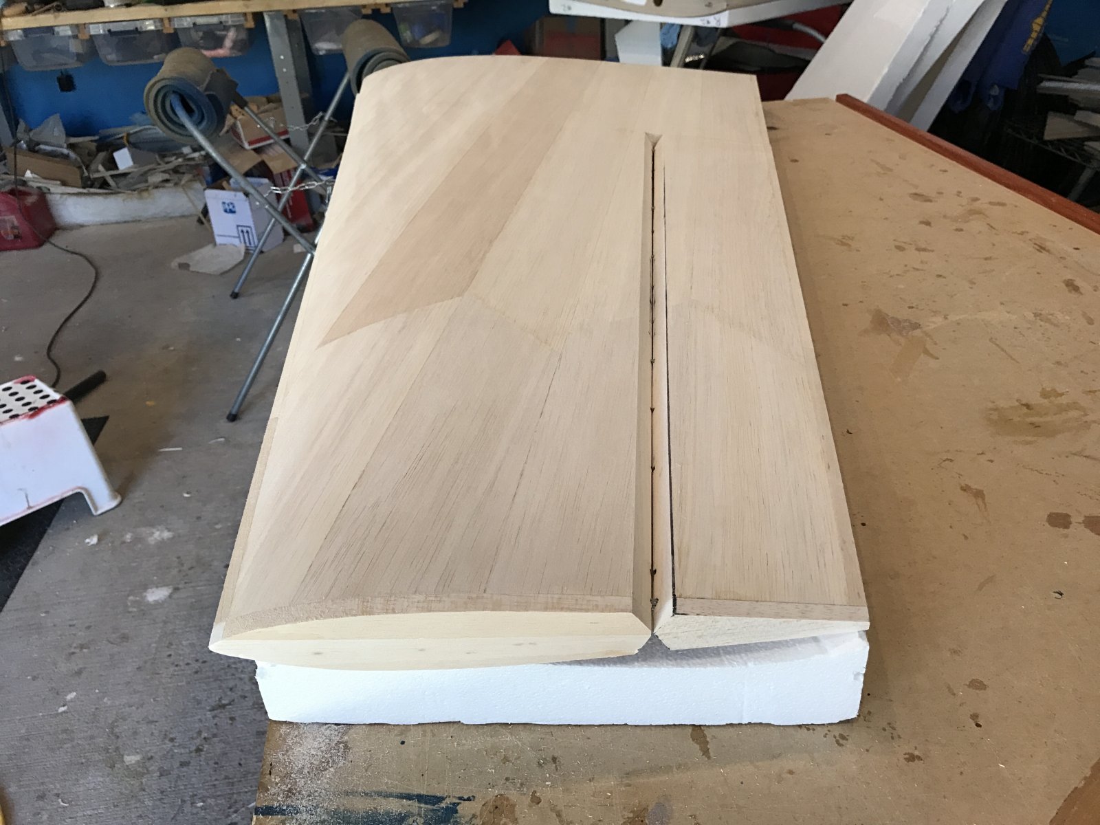

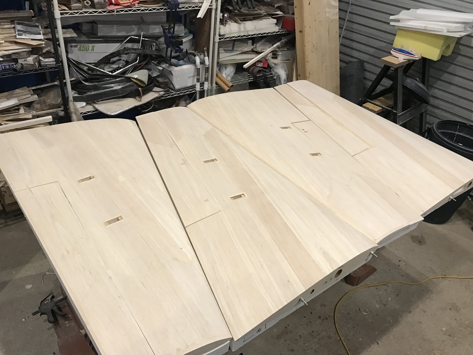

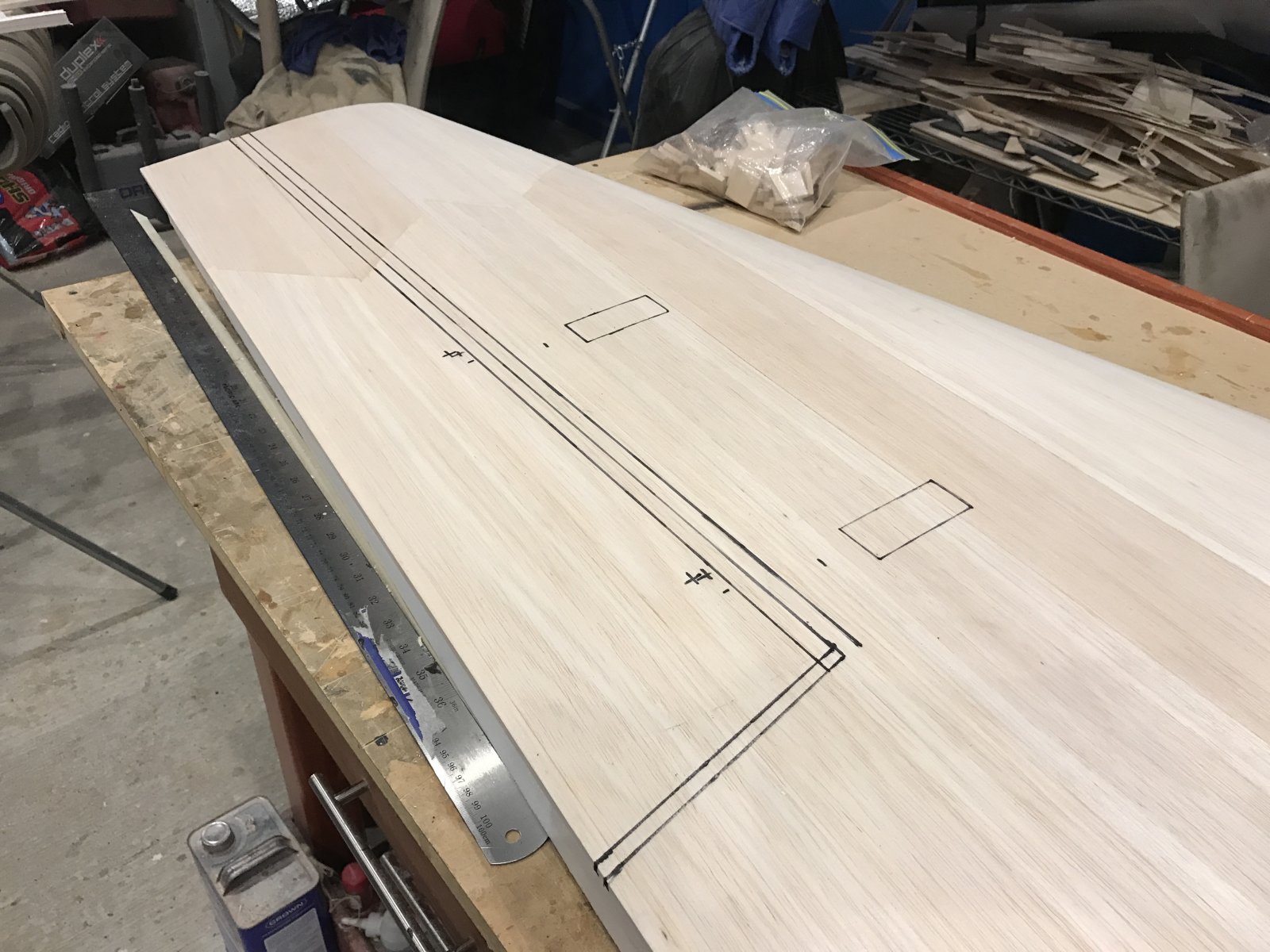

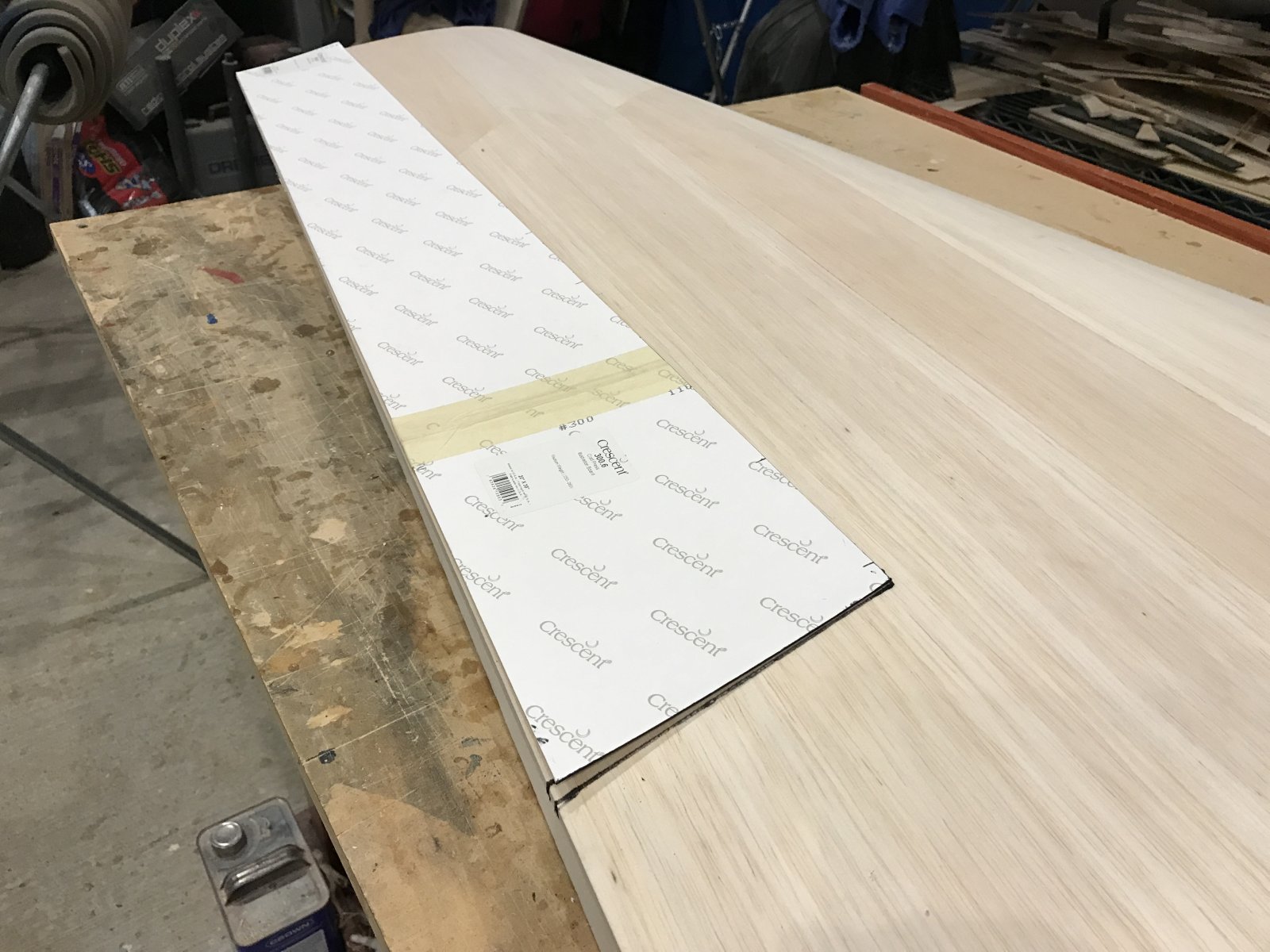

I was able to do the other wings, so now, both sets of wings have the ailerons cut out and hinge line glued in. All i have to do now is drill the holes for the hinge points, and then bevel them, and I guess I am done building!
All that is left is to cover and paint.
pictures to come soon of the wings.
