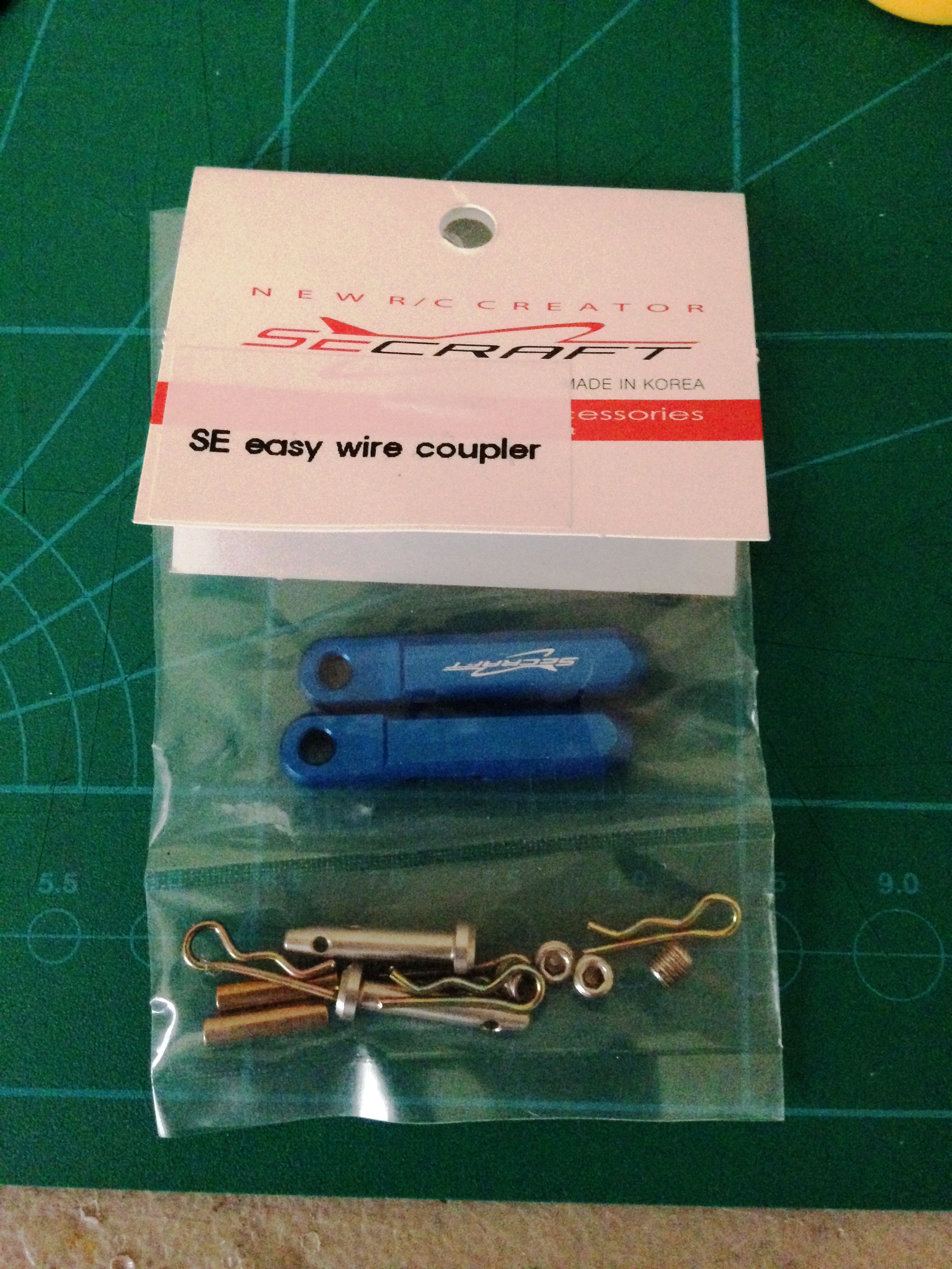

Got my rudder all set up. SWB arm and Secraft tensioners. The instructions are very clear on the Secraft website, I saw a pic of the little tubing pieces inserted in to the end of the tensioner, and I could only assume that they are supposed to crush against the cable via the set screw. First time I have used them, and they are really nice.

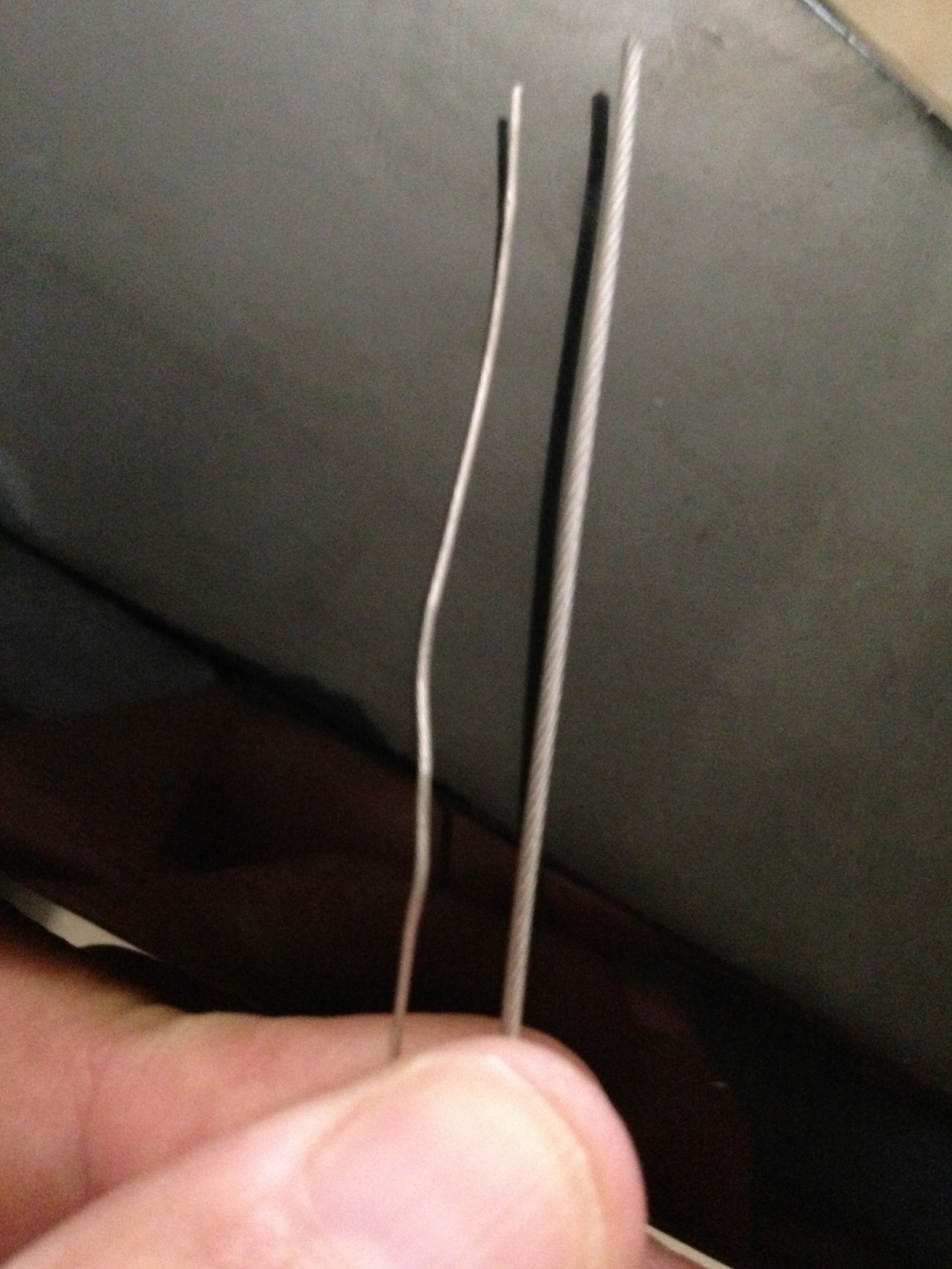

I really like those Secraft tensioners, I might have to get those. Can you install them using the existing cables in the plane? It looks like the added length of the turnbuckle might allow that. My cables have been loosening a little and these would sure make it easier to adjust.
AKfreak
Yeah you can, they do add a little length. If not they sell new 1mm cables for $5 bucks.
Ray, I've used these on about the last 10 planes I've built, once you switch, you'll never switch back :)
As far as using existing cables... I don't think there is enough slack... however if you get the ones for the rudder too, you can replace all the factory hardware and upgrade your cable to the secraft 1mm cable too. The rudder couplers come with pins to use with a removable rudder, however you can just use an m3 bolt instead.
