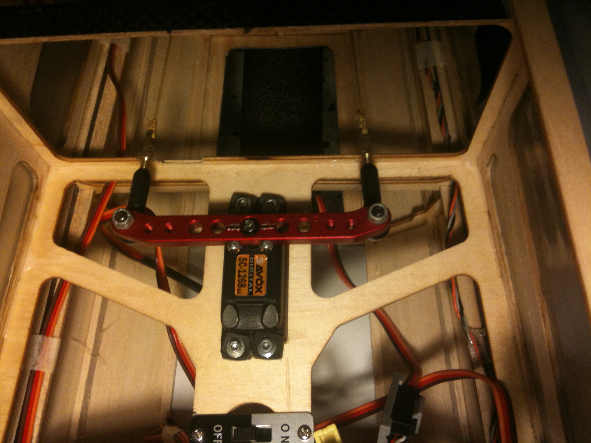

Got my rudder all set up. SWB arm and Secraft tensioners. The instructions are very clear on the Secraft website, I saw a pic of the little tubing pieces inserted in to the end of the tensioner, and I could only assume that they are supposed to crush against the cable via the set screw. First time I have used them, and they are really nice.
The picture on this page helps when trying to figure out which way to turn them http://www.secraft.net/shop/step1.php?number=1152
Here's what mine looks like tied off at the servo and CA'd. I also mount the ball links under the arm to reduce spline torque, in case you are curious, but I see no problem mounting them on the high side.
AK are your ball links just screwed to the SWB arm with no nuts on the bottom? Mine screw on but I do still put on nuts but it's a PITA to remove when adjusting. How about the rest of you guys is screwing to the arm with blue loctite enough?
