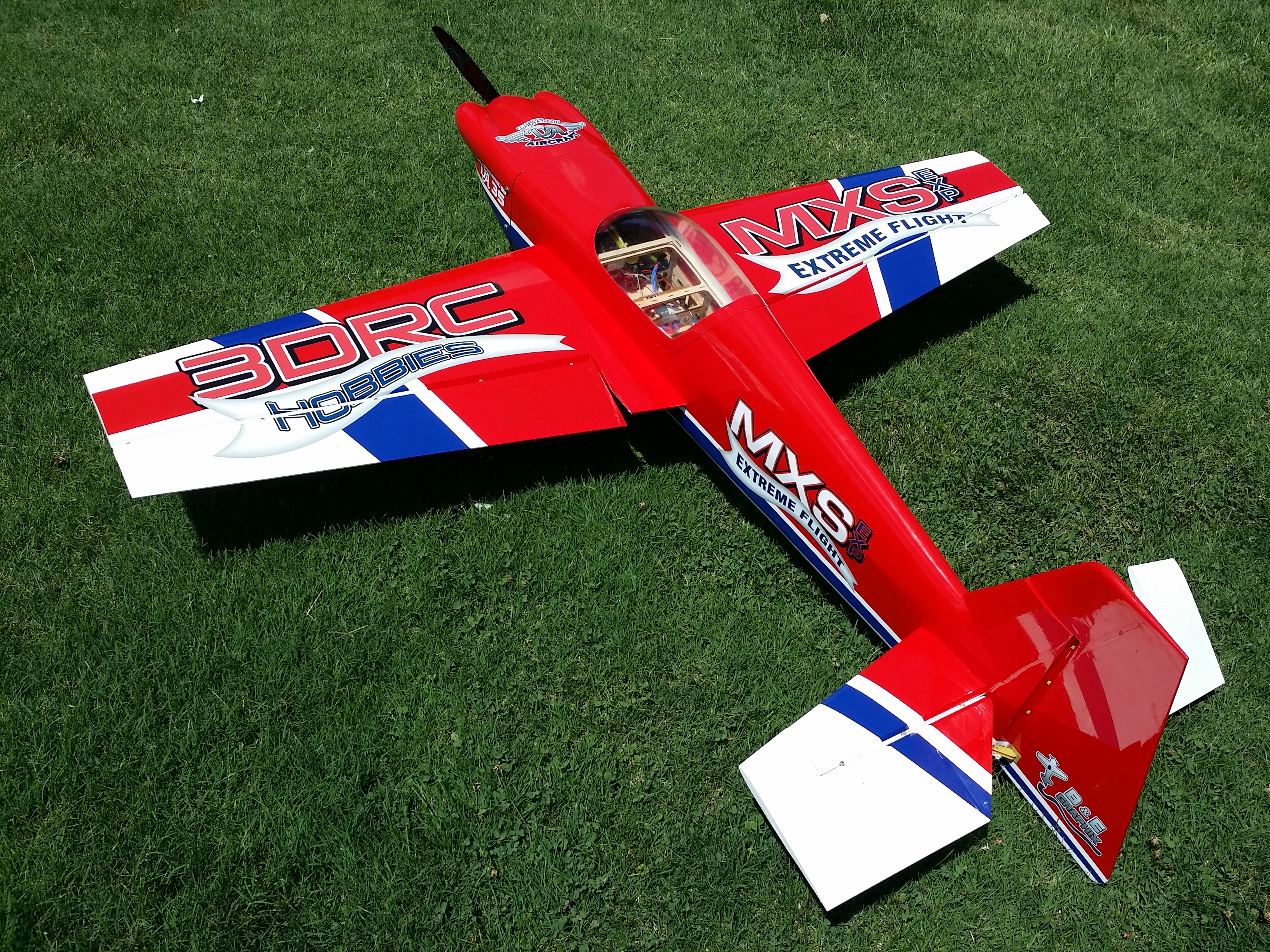

Let us know khow it goes, I like to save weight anywhere I can. Speaking if weight, I weighed mine tonight and with everything except for gas it weights 12.84 lbs. I have a 16 oz tank that I will but 12-13oz in. That would put be just under the magic 14 lb mark. I say that's not to bad with a DA-50 in it. Also Ill pick up a few more .oz's with my graphics package on it.
I left off the landing gear sleeves, but I think this plane needs them. Ill put them on s soon as I get my replacement wheels that still haven't arrived.
I do think its a nice looking plane, but I have a theme in mind and I am still trying to make it work on paper.

Nice... and I like the weight too. You're about 5.6 oz lighter than I would be if our empty airframes were the same. Any specific mods you did to get it to that weight?
AKfreak
Left off the LG covers. I ground down every washer, and turned down socket head cap screws on the motor mount. Turned down the DA stand offs a little. and since I am using the Tech Aero Ibec, I lost a battery (only use two). Also chose nice slim 2S life packs that are light compared to others I own. I was careful to get servo leads that are the exact length. I used spyderwire instead of heat shrink on the servo lead connections as keepers. I built my own Gas tank (super light weight). Basically I was mindful of every aspect of the build to make sure the weight was kept to the minimum. 5 oz that seems like a big difference, but I guess all the little stuff adds up.
