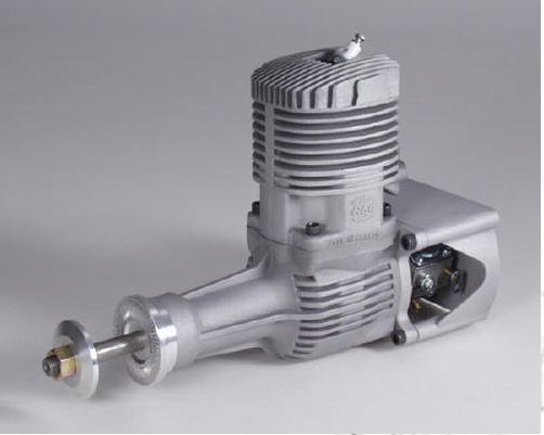

Since the stand offs are part of the engine, and the Pitts specifically related to the engine is also light, the AUW is really lighter than the DA50. Here are the size specs.
The other thing I like about it is that the nose is longer, placing the engine further back in the cowl, so there's a lot less cutting. It's a rear exhaust mount too so everything fits in a nice clean, narrow line, front to back. We ended up running Royal Purple in it and dropped the temp and raised the RPMs on it. Feels like I'm talking myself into another one, but I haven't gotten any emails back from the new US distributor so I may dig out the company contact info I have around here somewhere. Here's a pic...View attachment 31029
