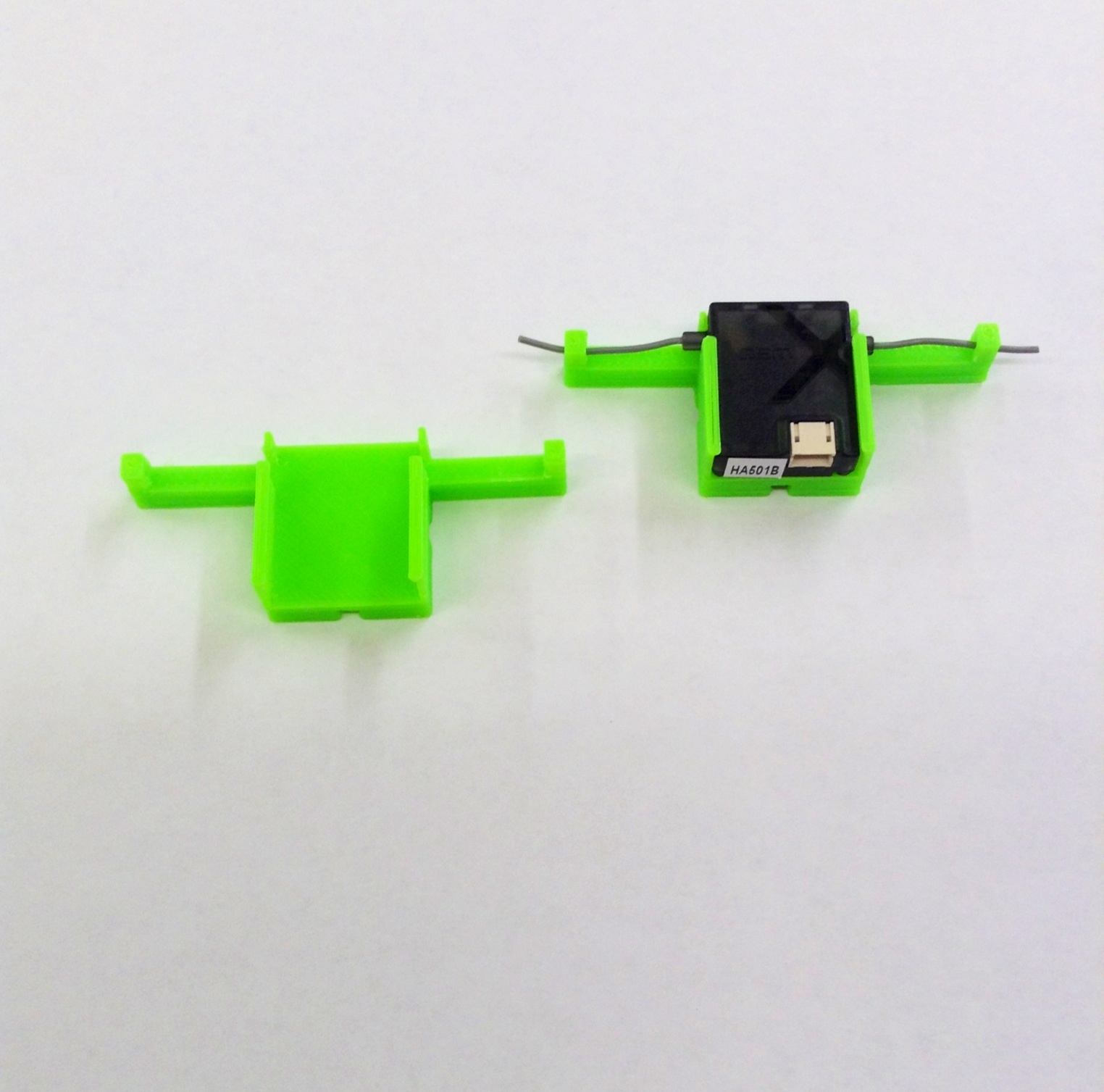

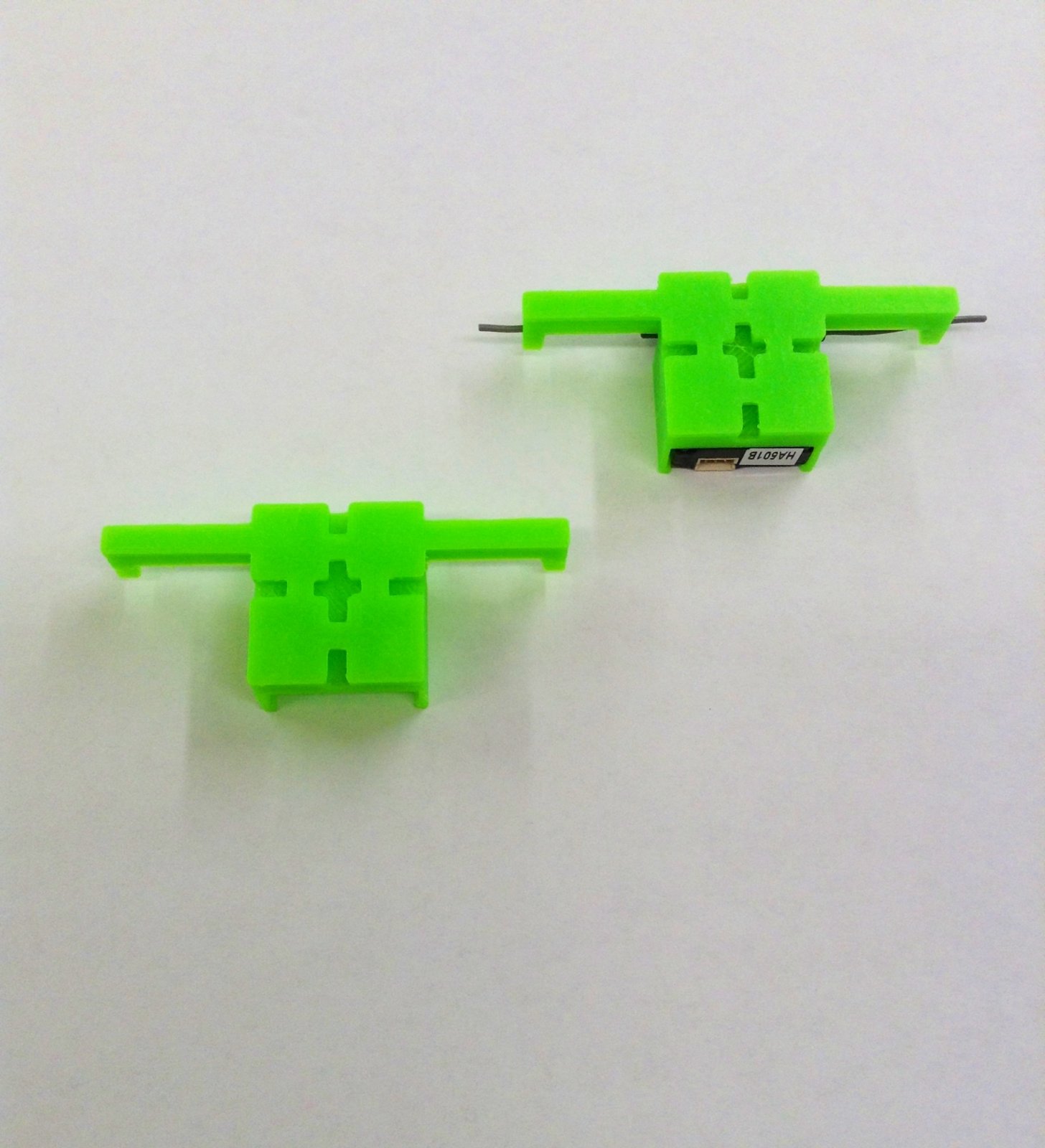

@Decal Dennis hooked me up with some 3-D printed remote receiver mounts.
Alky6
Those are cool!

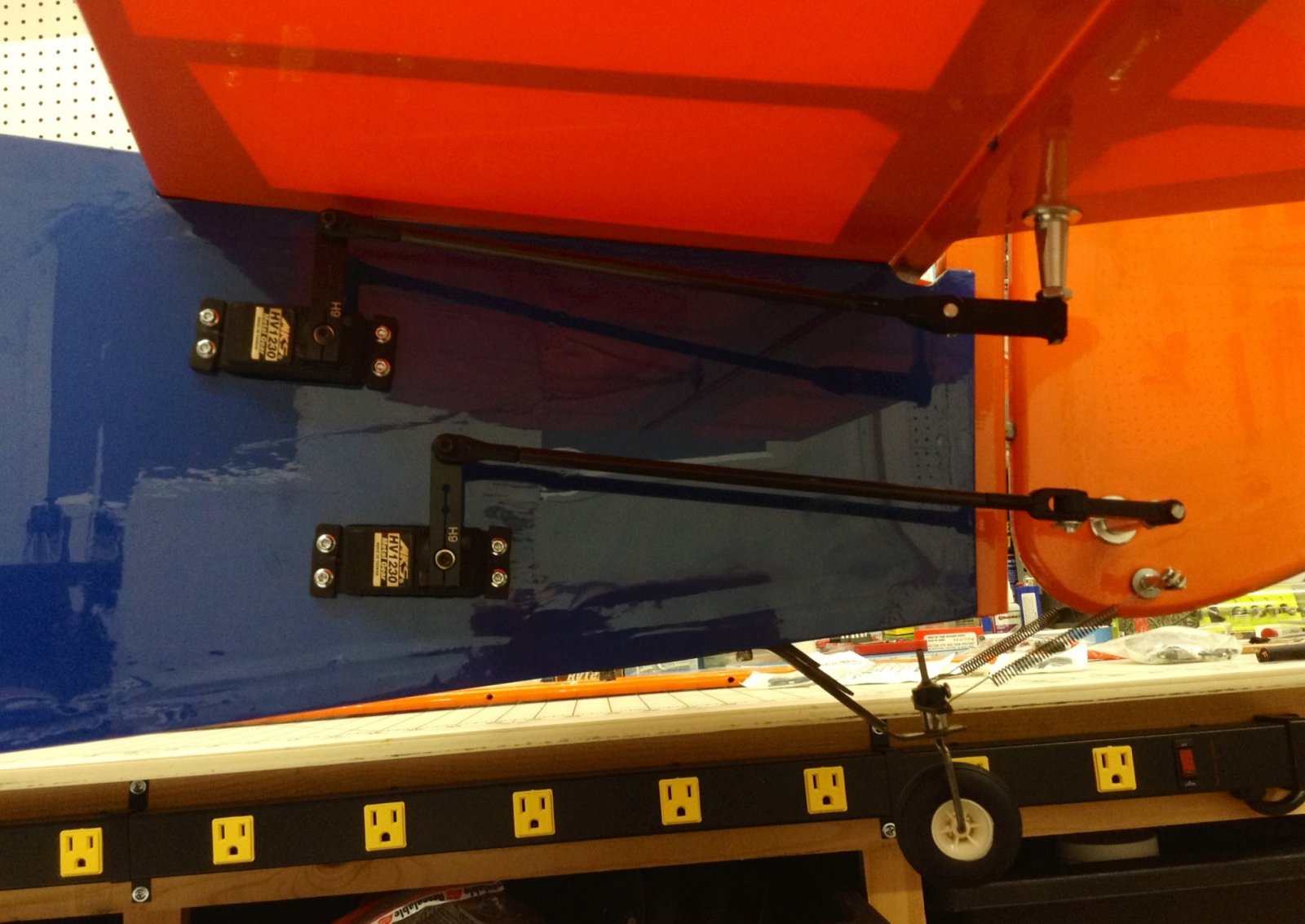

How do you like those dubro control horns? Have you used them before? I have been looking at them, but they just seem like that "long" arm from the horn to the control rod seems like it could bend or move. Thoughts?
This is the second plane I've used them on. So far I love them. Rock solid, adjustable and most of all, Super easy to install! Just drill one hole and you're good to go.
