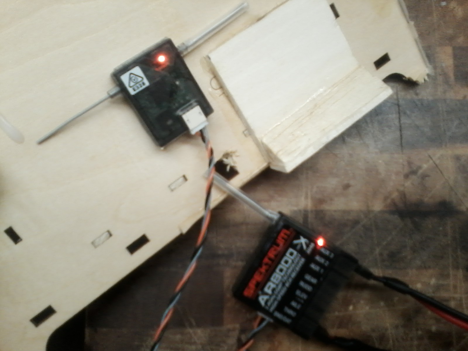

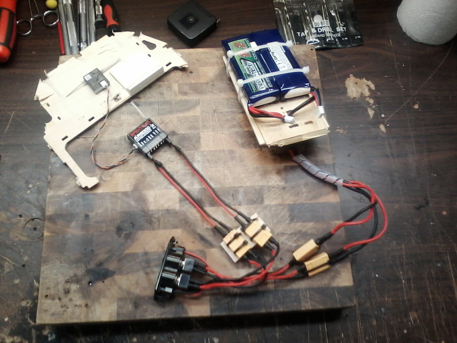

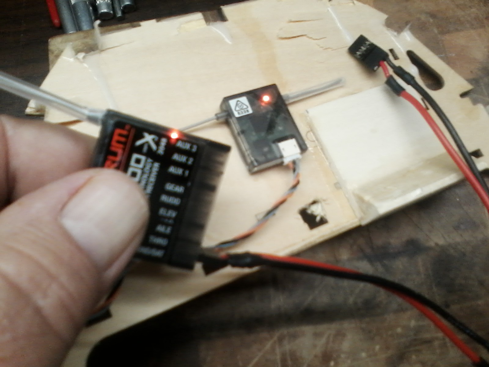

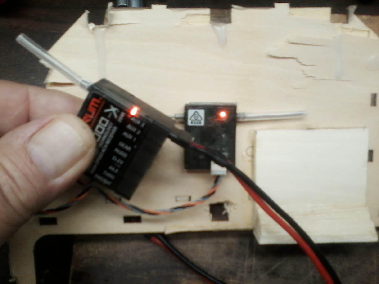

I did not pull apart the receiver yet but did hook up the power harness and satellite just as it was after the crash. The power switches were on so power was applied as soon as the plugs went in to the bind/dat port and aux3 port. No lights on remote or receiver until I turned on the Tx. Both the remote and main Rx's instantly had solid orange led's light up. I pulled out the plug to the bind/dat port and reconnected then the same with the aux3 port and lights did not so much as blink. I think this is a very good sign I did not loose reception or bind.

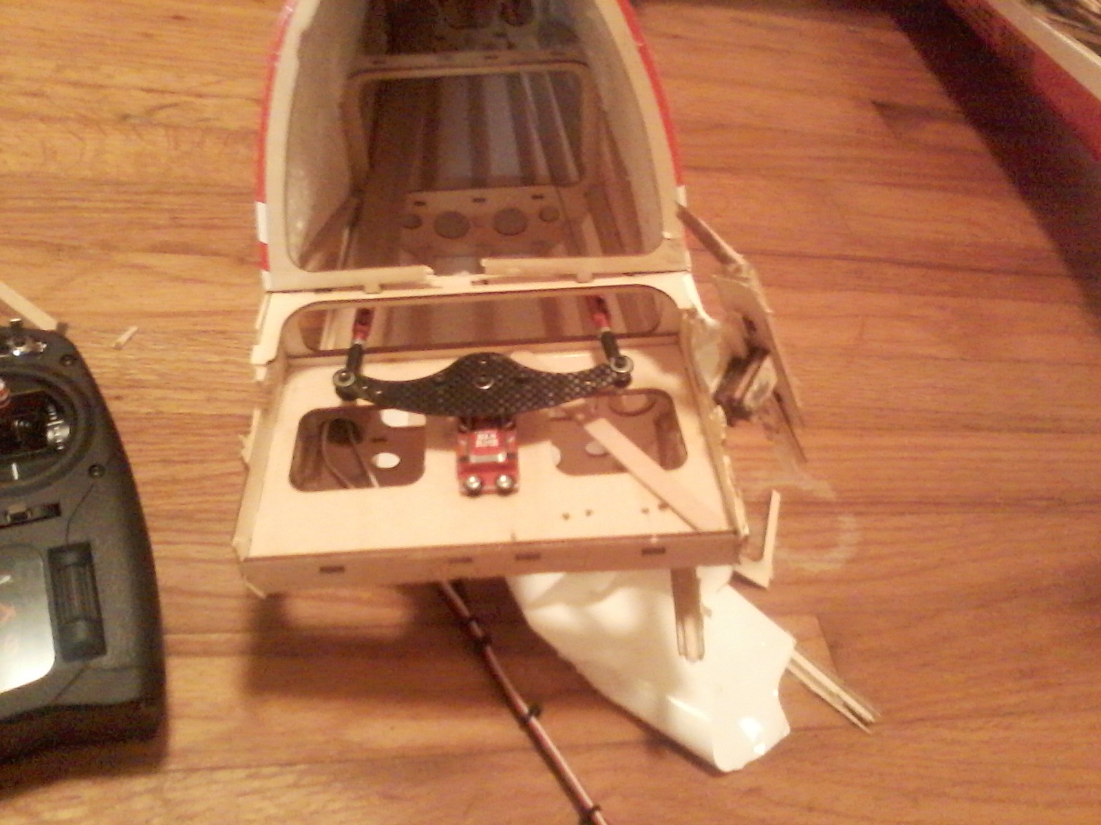

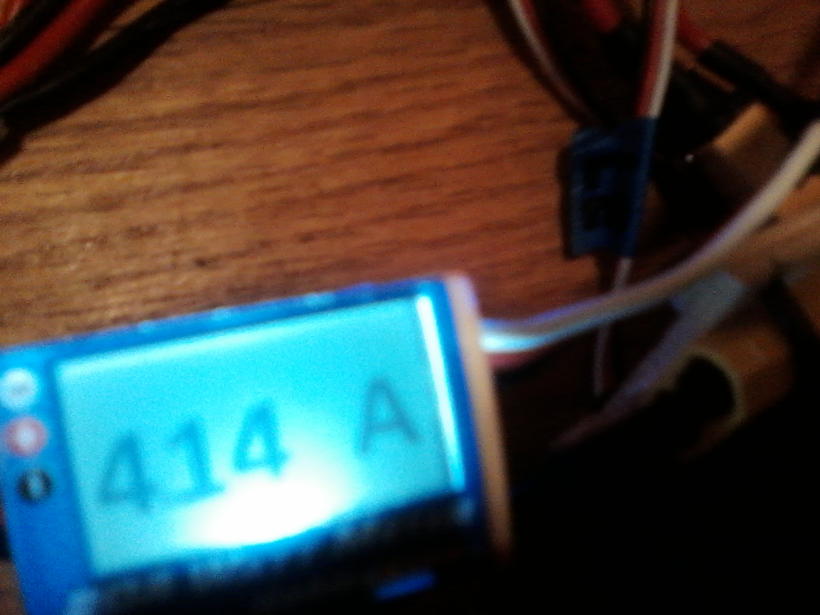

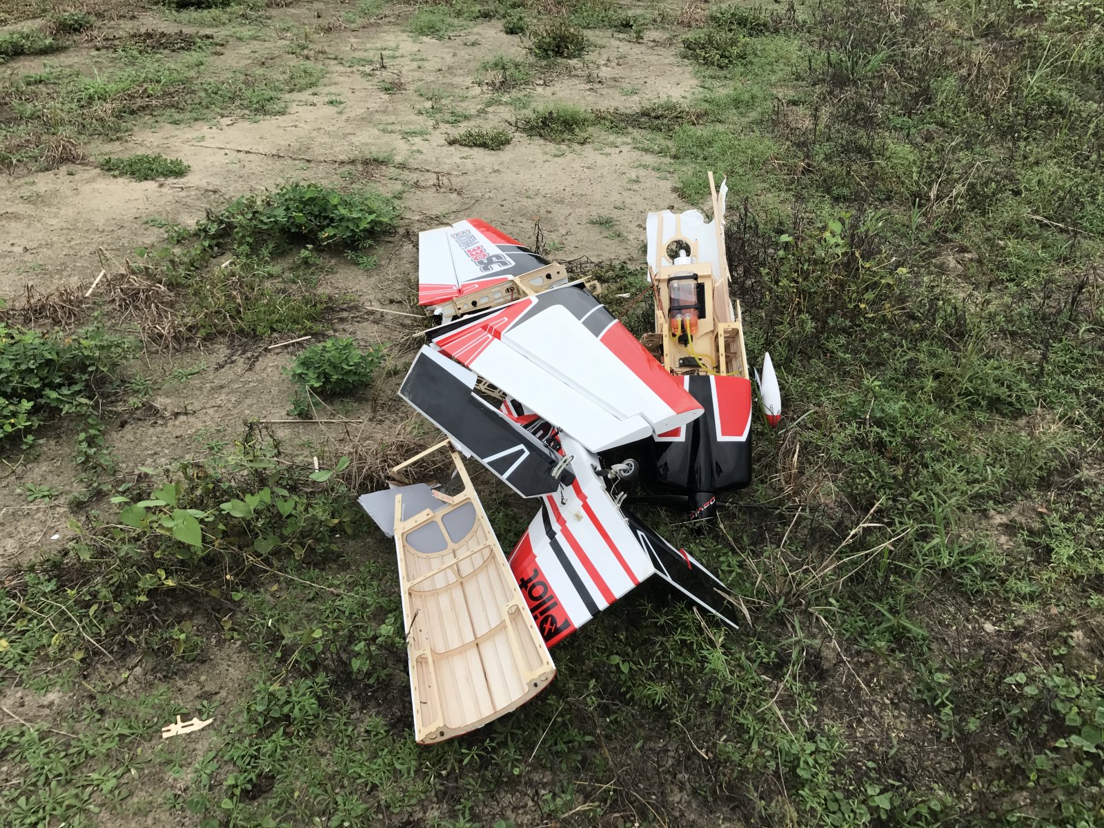

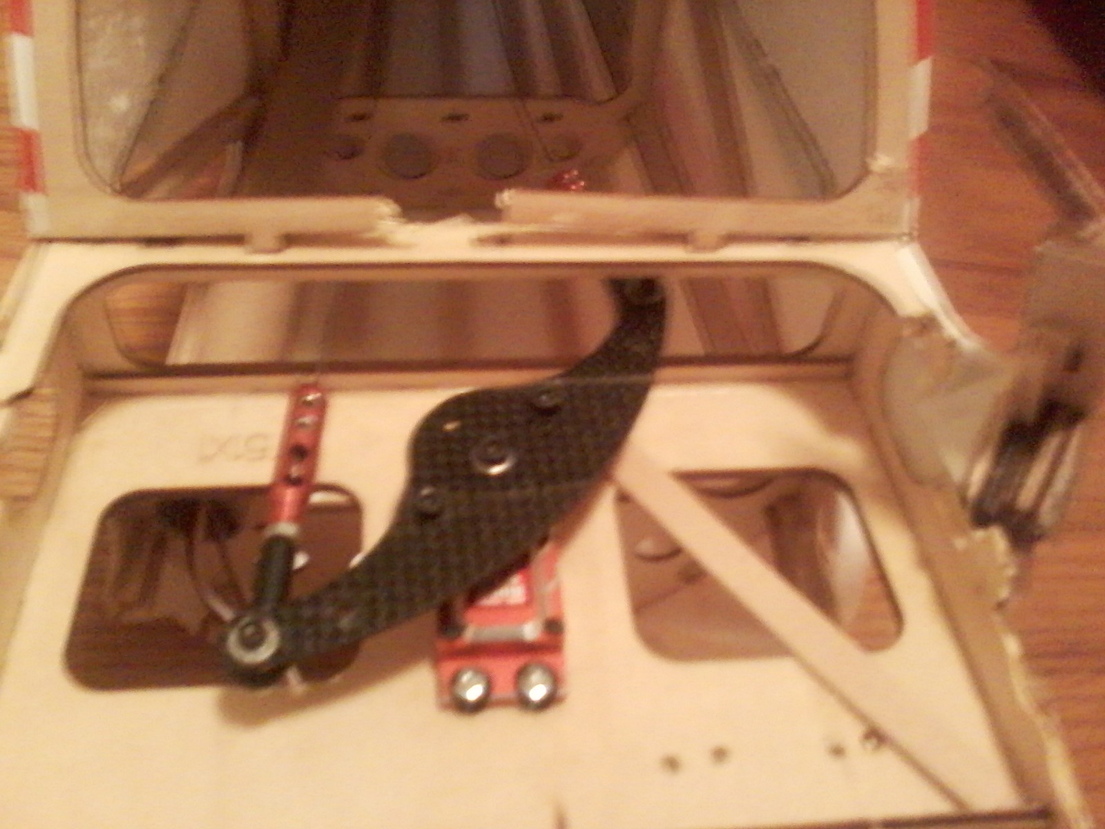

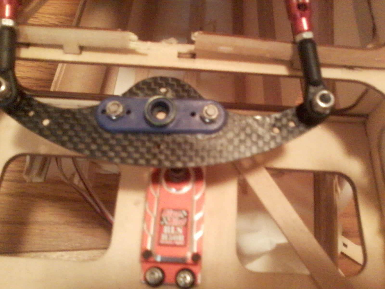

Took it to the tail carnage and hooked up the rudder servo with amp meter. What I found was the rudder servo would barely move the rudder and I saw a high 7.84 amp reading along with a bunch of lower readings of about 5 and 4 amps respectively. The plastic nylon horn with metal ring used to attach the CF pull pull arm had been striped out completely! Again hard to tell if the crash did this or my hard flying stunts in the air? But knowing I got a bigger 50cc engine and batteries with added 10oz(about 20oz total) of weight and the failure point of the air frame almost right in the middle of these to heavier masses I think I did break the fuse and strip the rudder servo horn in the air and that is what possibly caused the brown out. There was so little other damage and that it was all heaped nice and tidy affirms these findings IMO.
