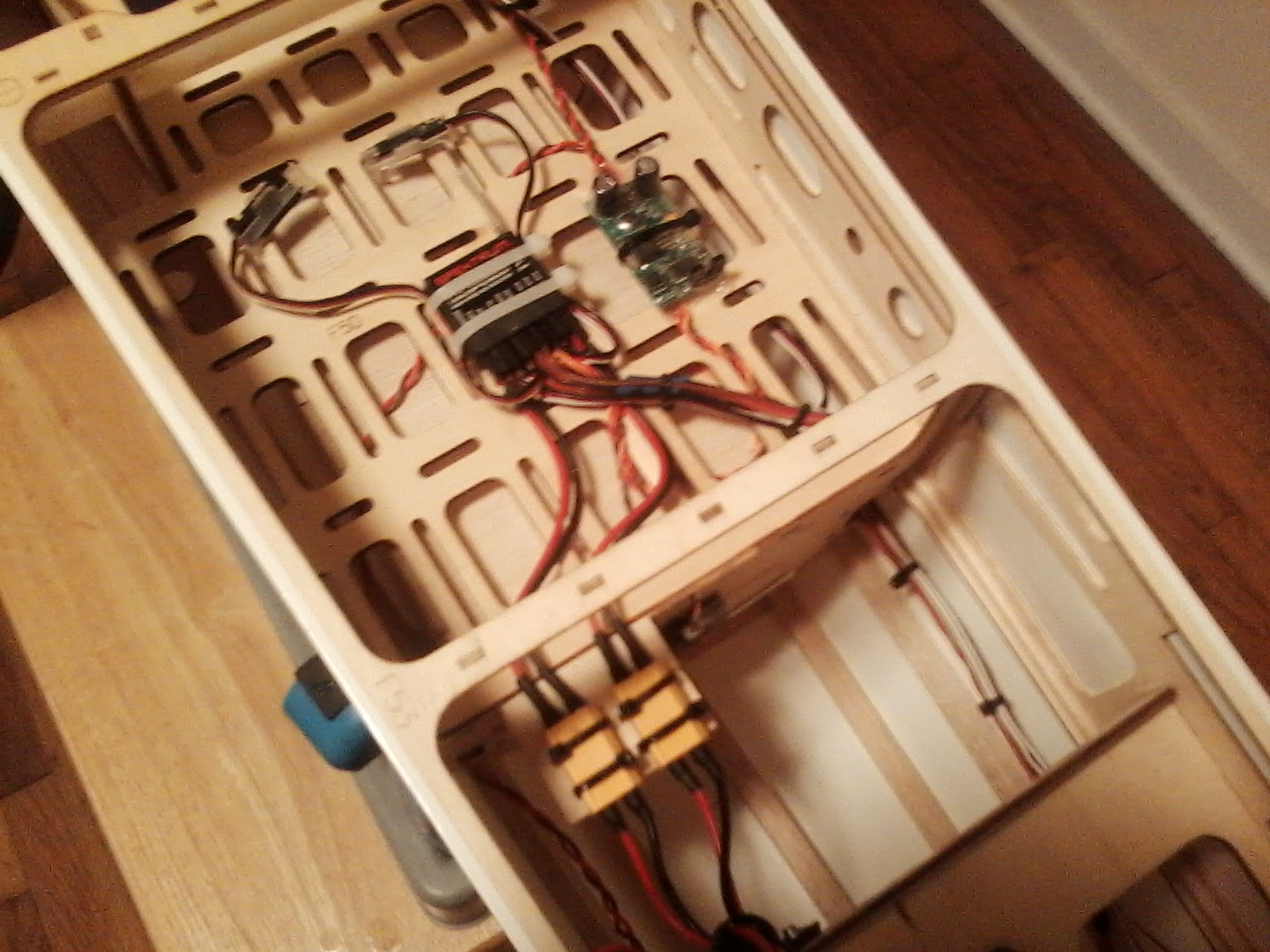

Curiosity -- it's killed the cat. How many power inputs did you have to the receiver and how were they wired? Maybe you have already addressed this somewhere and I missed it.
I had two separate batteries (25c 2250mah 2s lipos) feeding the AR8000 via heavy wire gage and connectors (18awg / XT60) running through a moded miracle dual switch (replaced the supplied 3 amp DPDT switches with 6 amp DPDT switches). One battery was plugged into the bind / DAT (which I thought was bind / battery port) and the other battery plugged into the open aux3 port. Being new to spektrum have I messed up here? When I was doing my buddies Edge build he had the 9010 receiver that had two rows of ports. I mistakenly plugged stuff in the second row the same as the top row which is incorrect as I found out. It also has a specific battery port and a bind button instead of a bind port. I know spektrum is opposite on the way things plug in from Futaba except that blasted 2 row receiver. Spektrum: -+s which - is on top. Futaba: s+- which s is on top.
