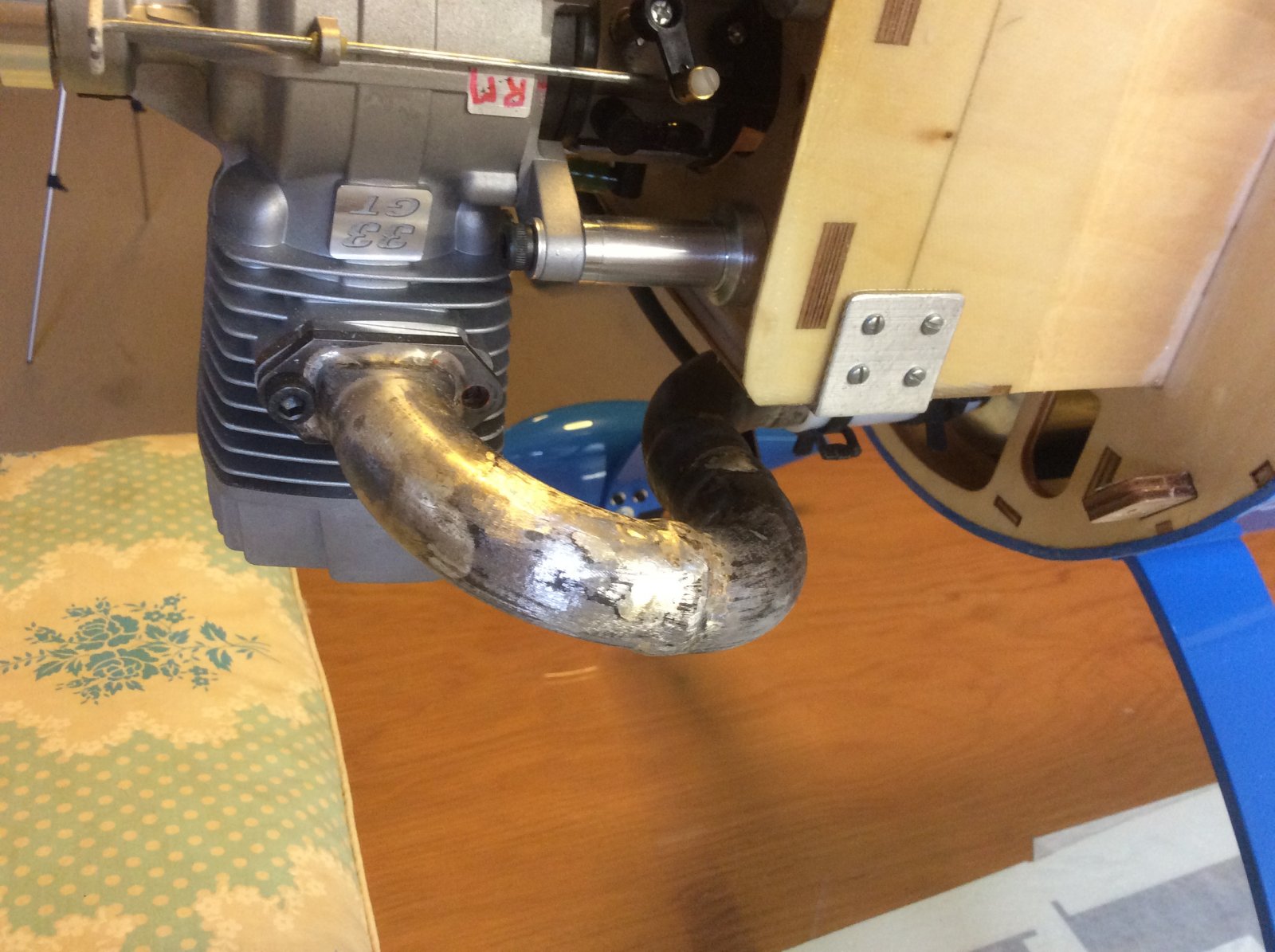

I have silver soldered, or more appropriately, brazed the header on a couple Valach exhaust, they are a combination of stainless flex and standard header. The brazing silver I get at Ace hardware ($20) and the torch came from Home Depot ($80).
Thanks that was helpful I have the torches but not the silver solder. Bib have one stick which is used up but would like some more. Looking up silver solder sticks they were listing for 35 dollars a stick and more. That is why I was asking if somebody was using silver solder and what,at 20 dollars that is reasonable, thanks.

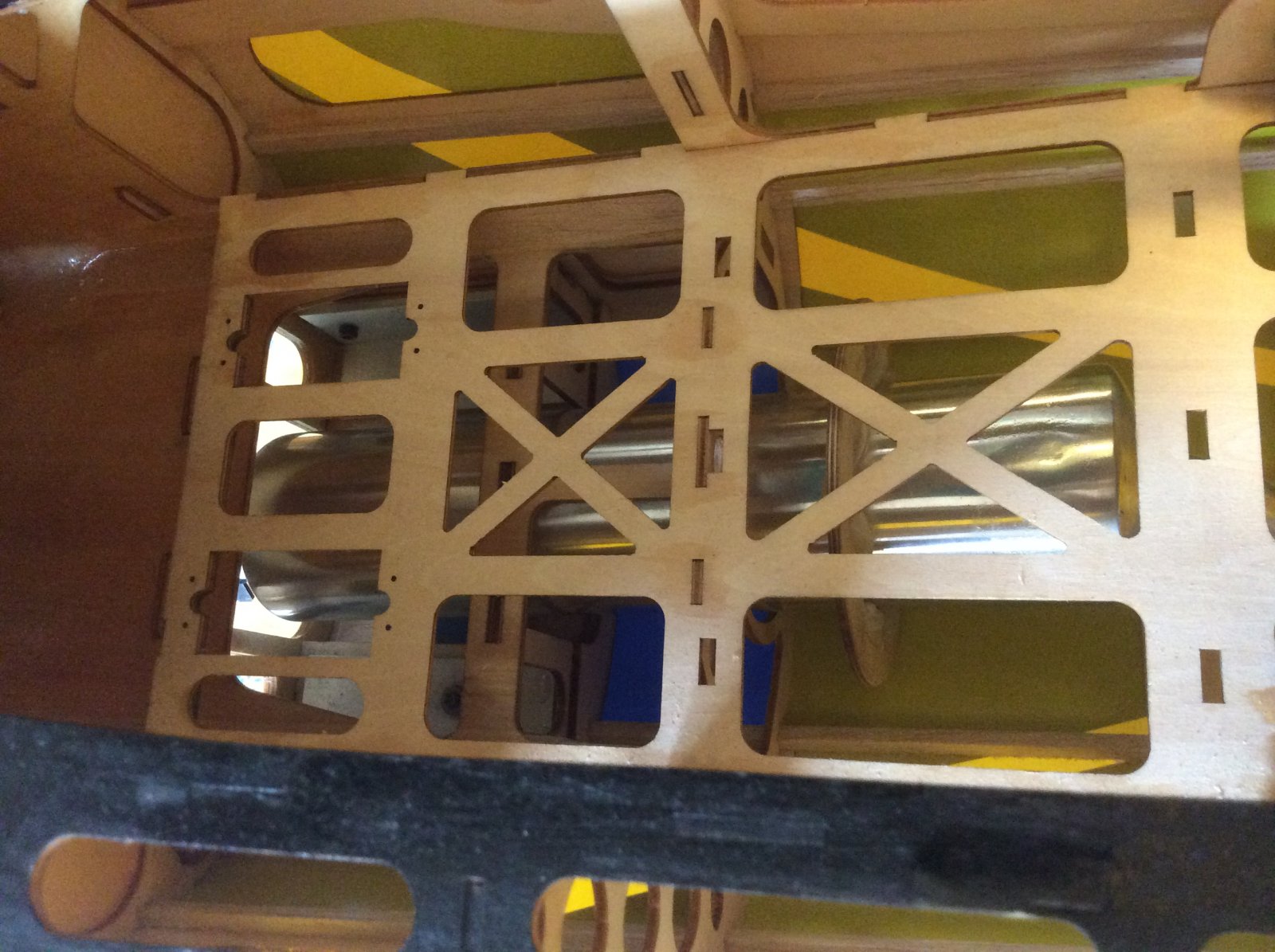

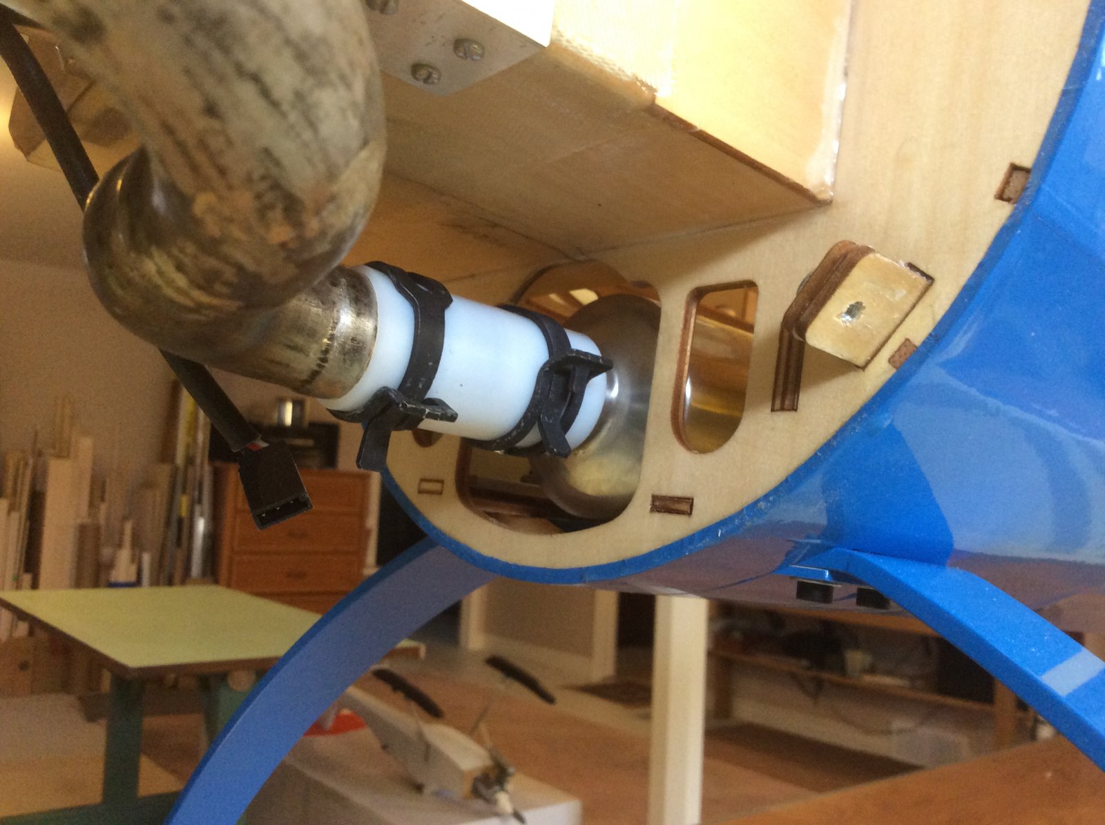

Well the canister is in, it had better give me a huge power increase and be dead quite for all the work and difficulties to get in the plane. The only conclusion I have so far if the plane was not meant to have a canister do not try to put one in unless you are gluten for punishment.
It is all done except for three small braces to be glued in and one to be bolted in that should happen some today or tomorrow. Next job on the list is to fit the cowl and cut all the necessary holes and cooling for the motor.
Almost got the cowl done just need to add some baffling in for the motor. The only thing that still needs to be done is some guide tubes from the carburetor to the cowl surface. If anyone has some pictures of how they have done it would be appreciated. That is all coming alone now. Just have to figured out how I want to vent the fuselage off all the heat the canister is going to be putting in the fuselage. Will take some pictures of the cowl later.
Thanks from for that yes that is what I used to locate the holes on the cowl . But because of the design of the cowl and the carburetor on back you cannot see the carburetor from any angle to get the screwdriver onto the needles. Got the holes on the cowl in the correct location but I need to install 2 tubes from the carb to the 2 holes in the cowl but not touching the cowl and glue them in place. Gluing them in place is the problem.

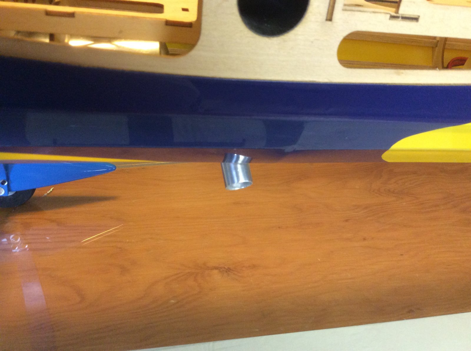

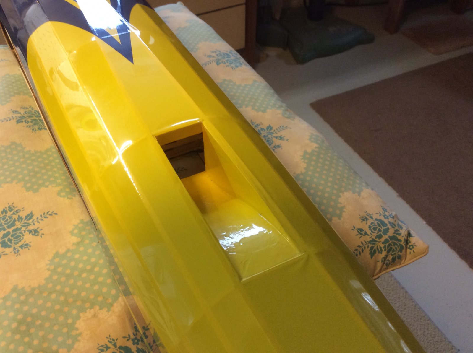

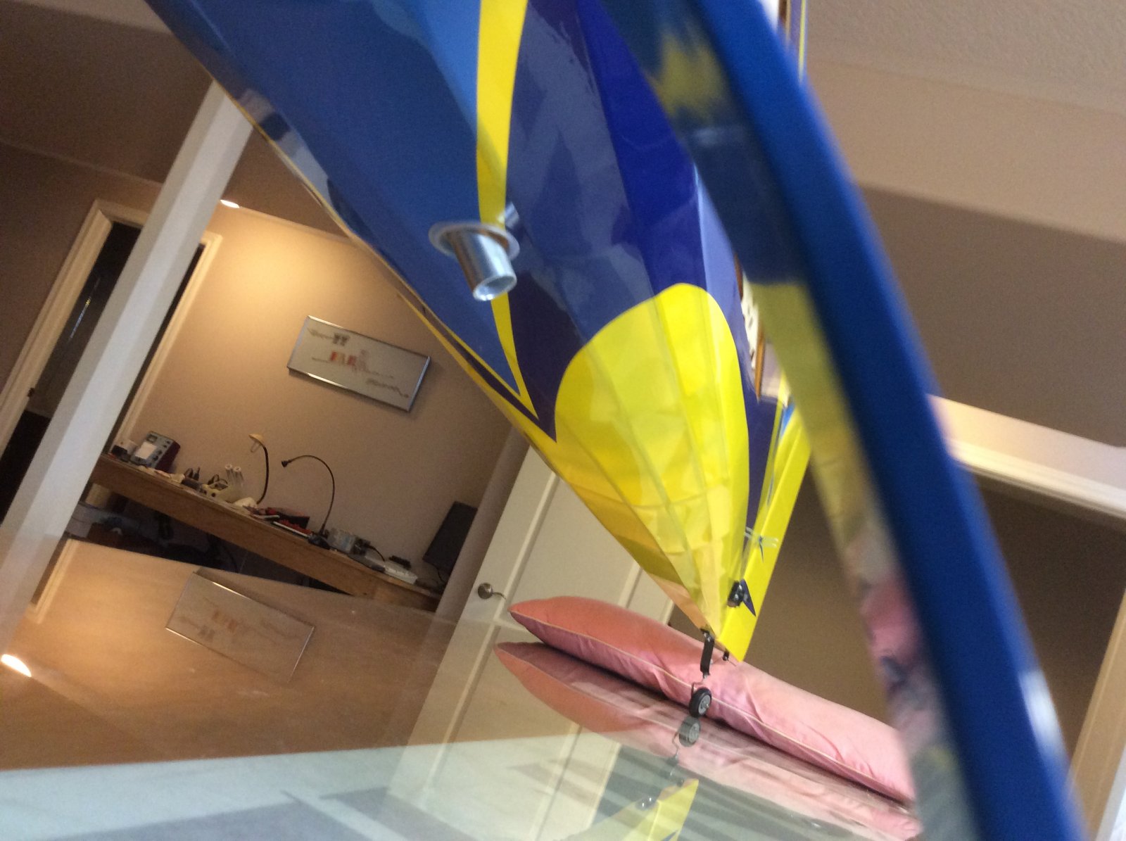

Well figured out I would like to vent the fuselage and I have taken a picture. As they say a picture is worth a thousand words. This what I have ended up with I an not a van of just a bunch of slots across the bottom of the fuselage. As I have learnt in my pass history that slots will actually draw air in to the fuselage, air will only exist the fuselage if the pressure inside is higher than outside and it has to over come the turbulence from the slots.
