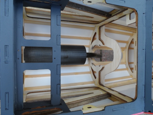

Thanks for the reply. This one looks like it is going to be difficult. Something is going to be cut to get it in. Been looking at the stringers, no solution yet. If the people that design these aeroplanes would have to assemble them once in a while things would be different. If they had left the canister supports separate then life would have been easy but the canister supported are part of the bulkheads. Oh well one way or another it will have to work, hope I do not have to buy another muffler if I do it will be a wraparound.
The picture shows a shot from the front down the fuselage.

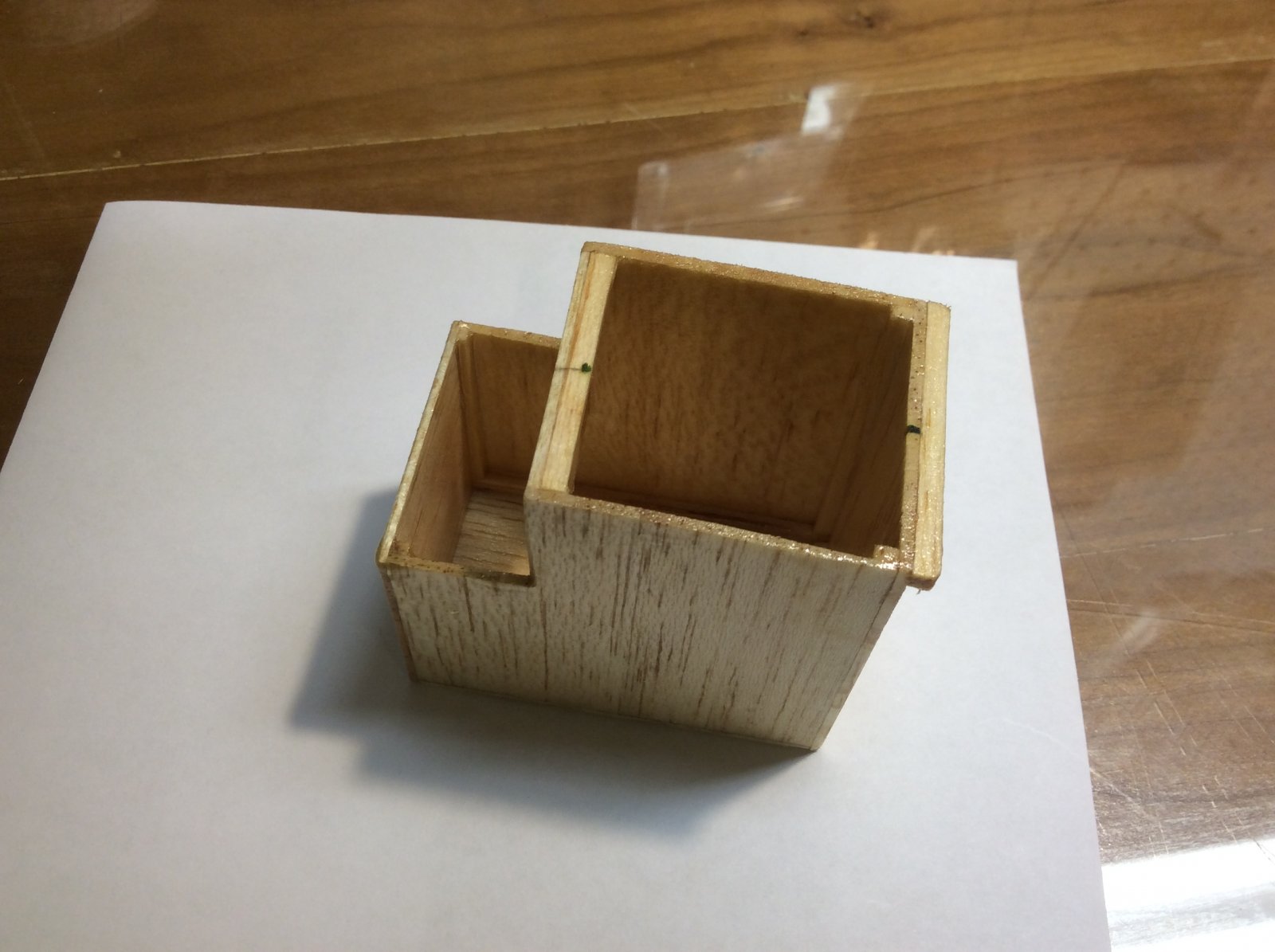

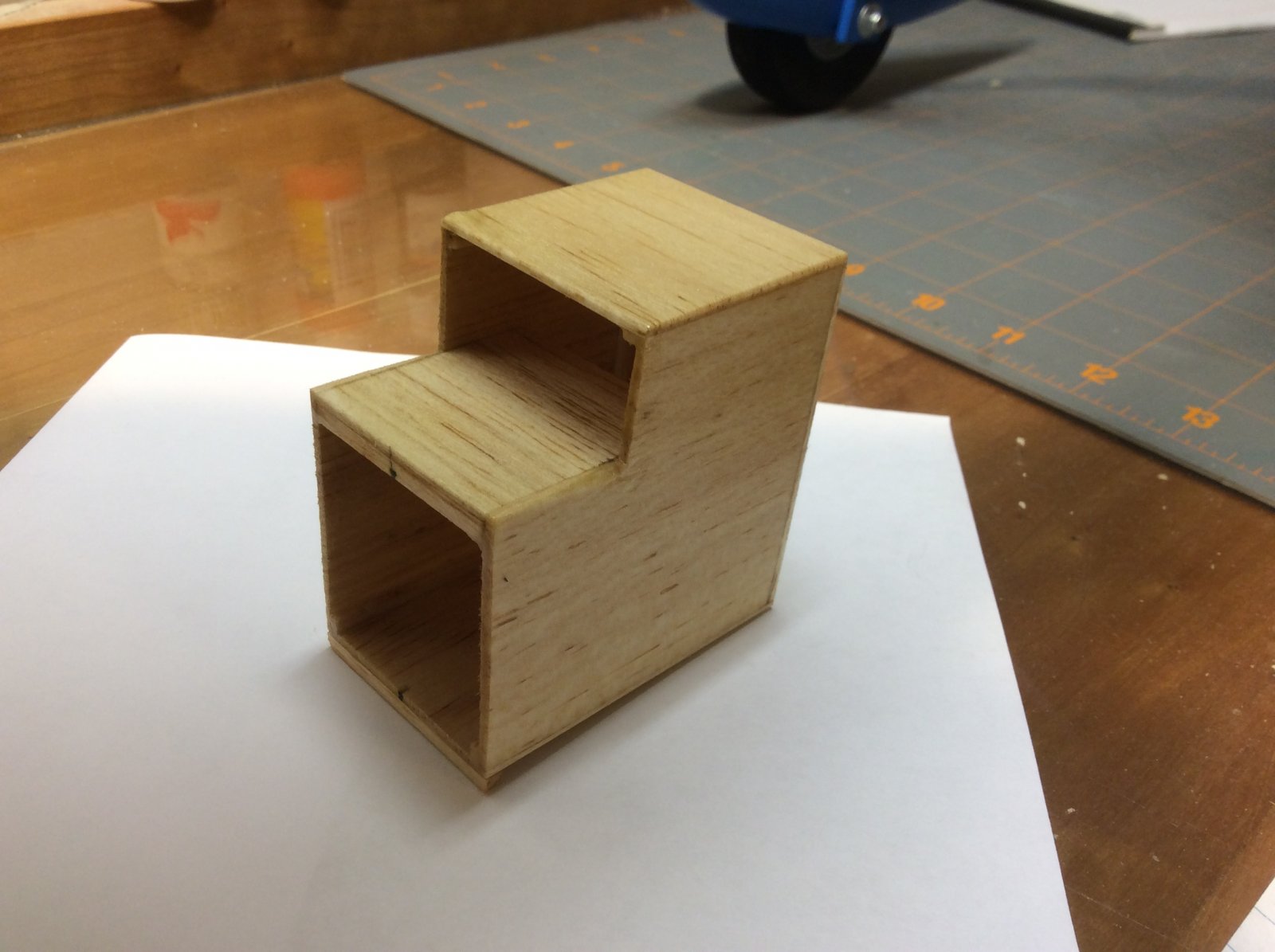

Just a picture of the motor box made today. Just waiting for the thinned epoxy to dry and it will be installed to the back of the firewall. Made from 1/16 balsa wood.

Three round holes, wow that would suck for a rear exit can.

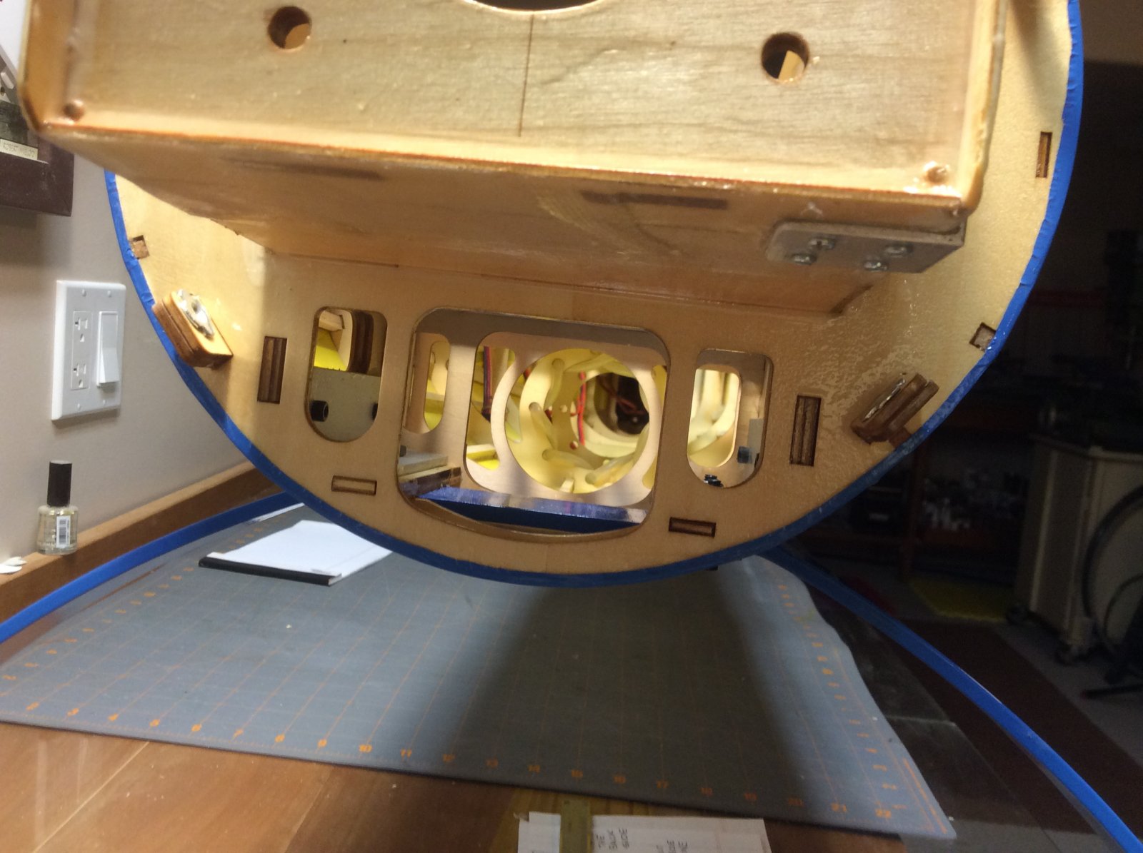

Well after removing some bulkheads I managed to push the canister in from the back. While pushing it into place from the back I ran into the landing gear it is about 5/16 high in the way of the canister never noticed this before to busy looking at wooden bulkheads try to get the canister with stinger into the correct location. Unless I see away around this the canister is not going to be installed in the plane. That to bad a lot of money for nothing. If you look back at the pictures it is pretty clear that the landing gear is in the way, feel pretty stupid. Can not believe somebody would design a plane for a 2 inch diameter canister and then have the landing gear in the way.
I found a thread elsewhere with a pipe installed in the Inverza 62. Looks like the gear is bent on the 62 to clear the pipe. Not sure why the same approach wasn't taken for the 33.

You 100% correct if my gear had that small radius bend in it, it would all fit in. Even if I try to do that the holes for the gear will be in wrong location and I would end up trying to bend up a hole new one whichever is not easily done. Full radius leg and that smal radius at the center.
