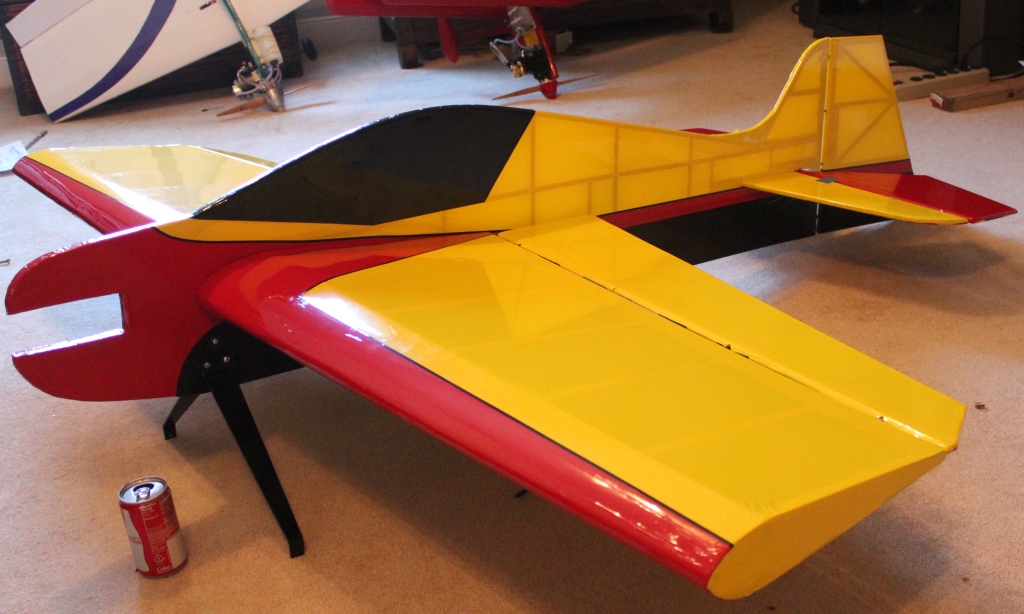

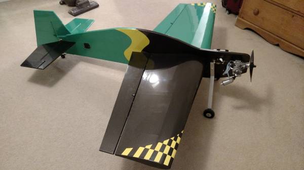

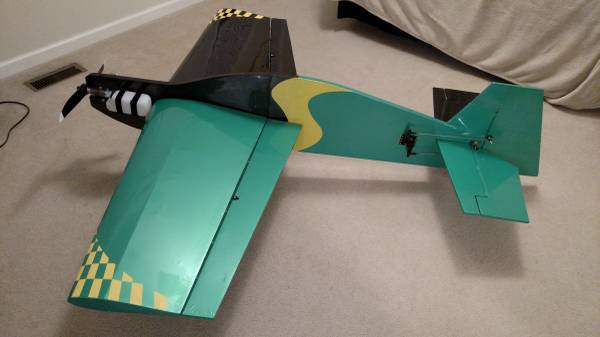

I bought my current Mojo 65 built but never flown. It originally had a Saito motor on it (as pictured). I had to peal back the carbon fiber covering and enlarge the engine cutout. Started out with a DLE20 but it needed more power as it came just over 9 lbs. Now running a GT22 with a ported WWRC muffler swinging a 17x6 carbon falcon fiber prop. Big improvement. Someday I may look to lighten the landing gear and find a carbon fiber wing tube that will work. I think if you can come in under 8.5 lbs you will be happy with the plane so choose your wood and materials carefully. My Sbach 65 (also pictured) is just under 8.5 lbs rtf with DLE 20.View attachment 90183

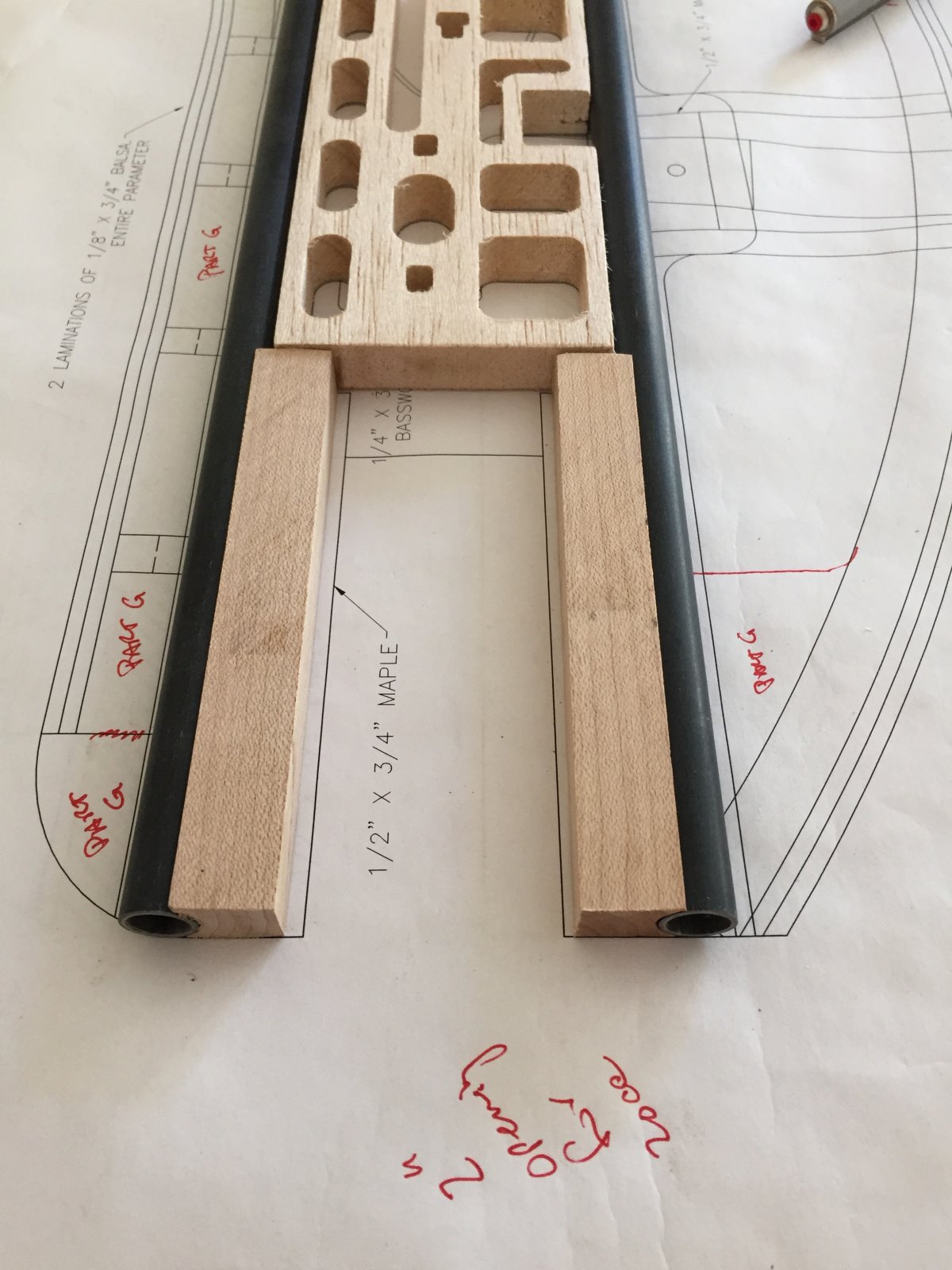

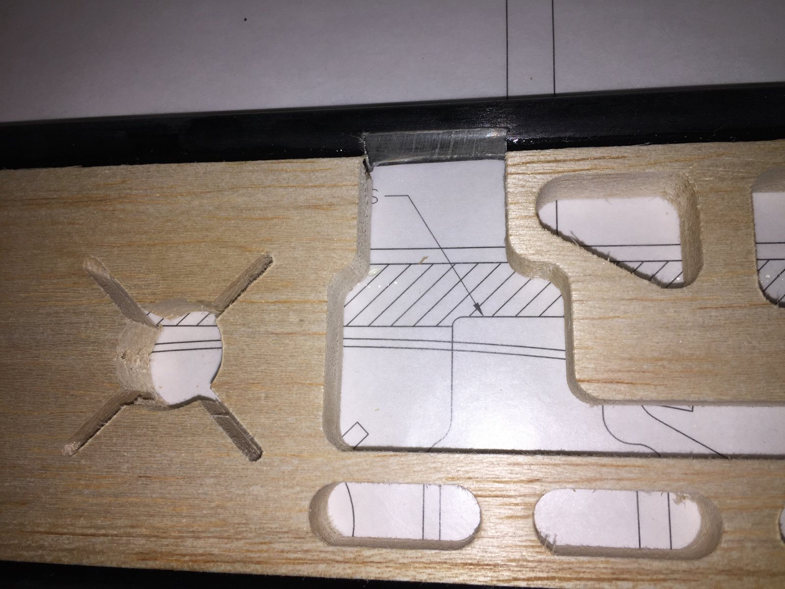

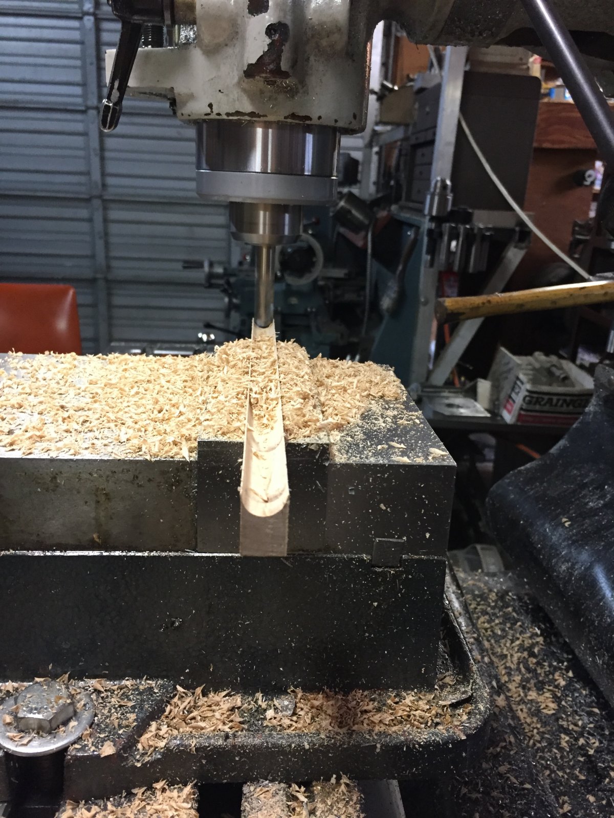

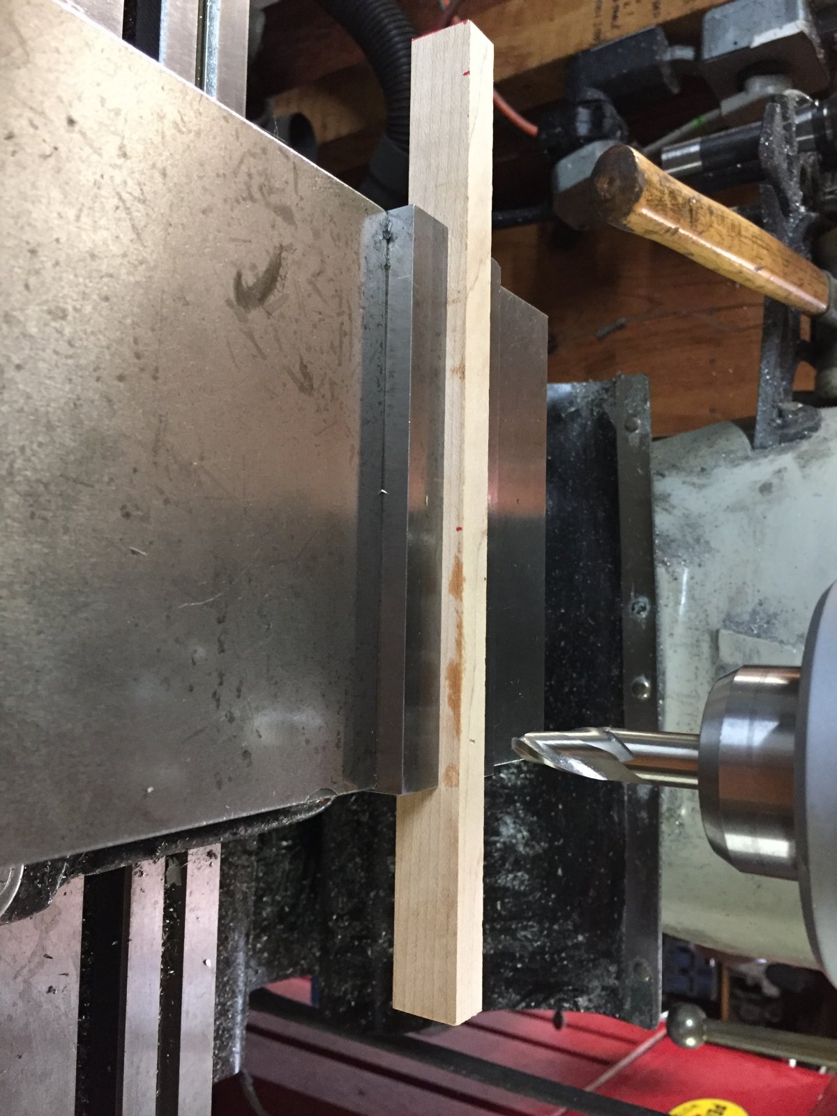

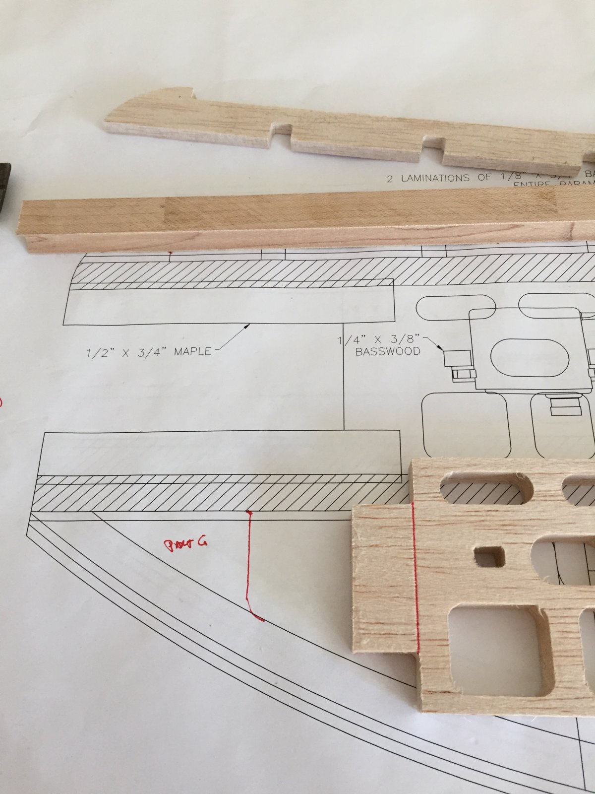

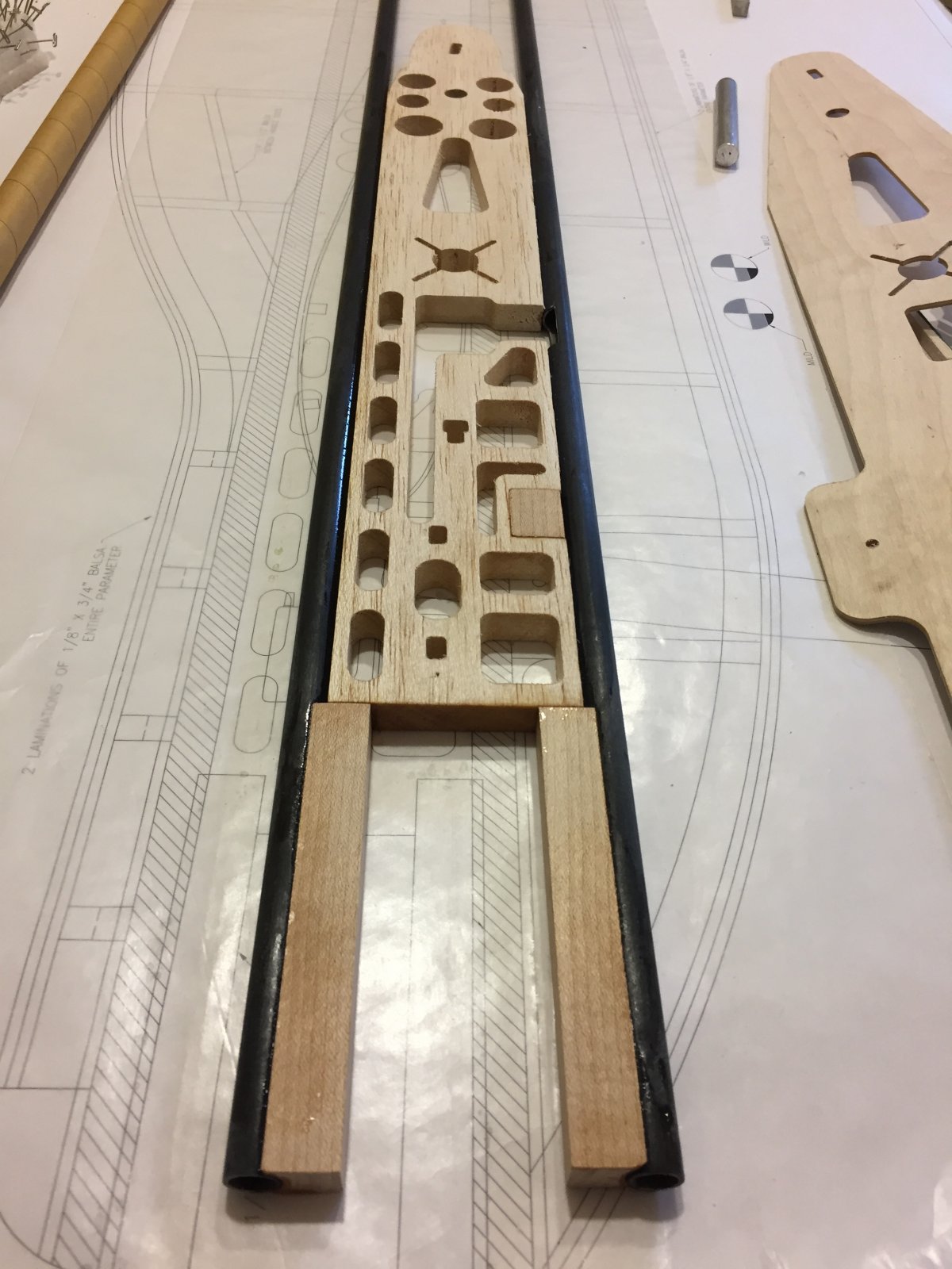

I cut down the .505 tubes to length. Took the 1/2 x 3/4 maple and used a 1/2" ball end mill to cut down for a 2" engine mount opening. Figure shaping the maple will make for a better glue joint and reduce the amount of epoxy necessary. Will try to build it light as recommended by many. To make room for the rear carb, the front portion of the fuse core previously sandwiched between the maple engine beam supports needs to be removed.
View attachment 90441 View attachment 90442 View attachment 90443 View attachment 90445
Looking good nice to have the tools you need to do just the way you want it .

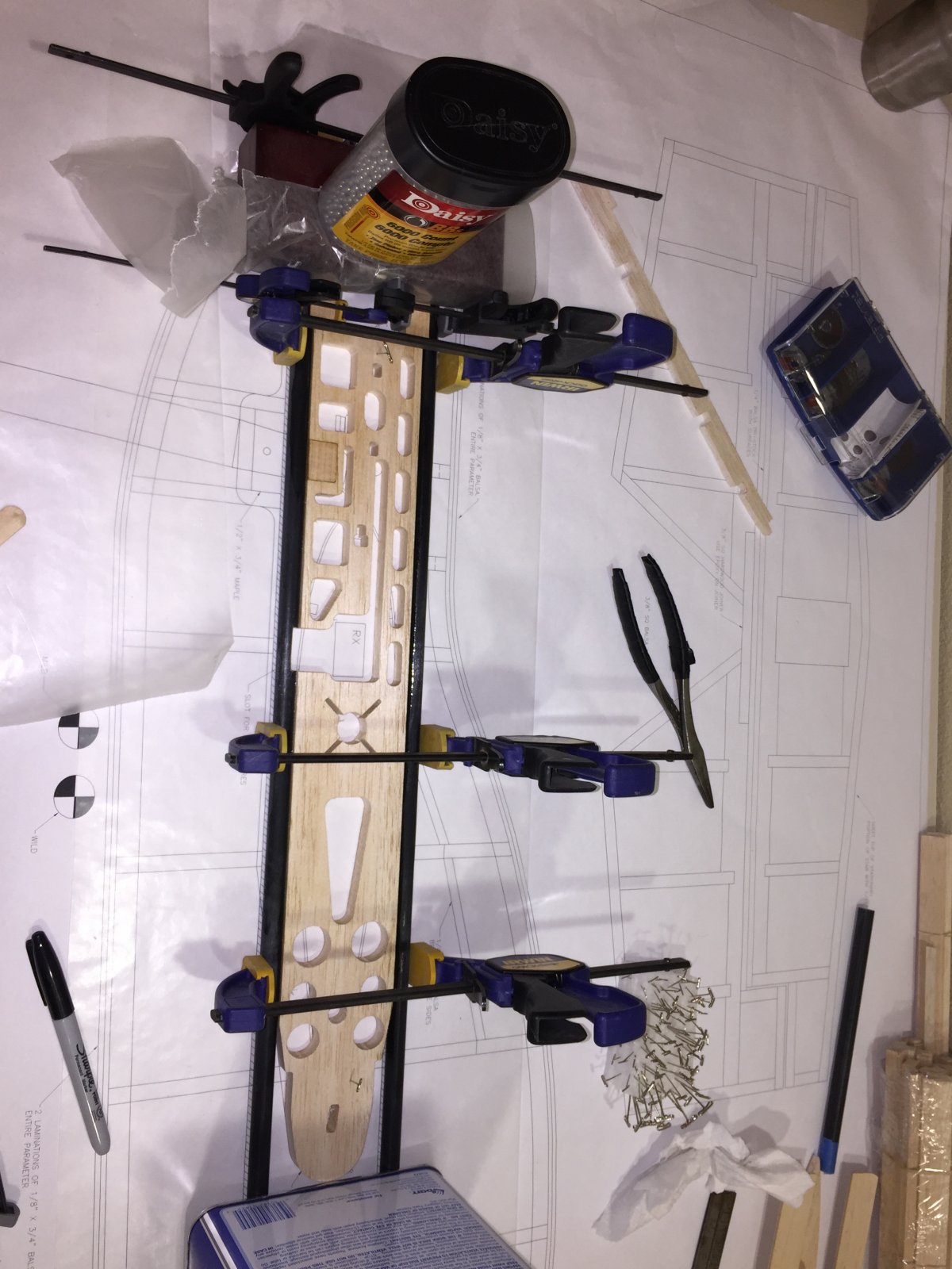

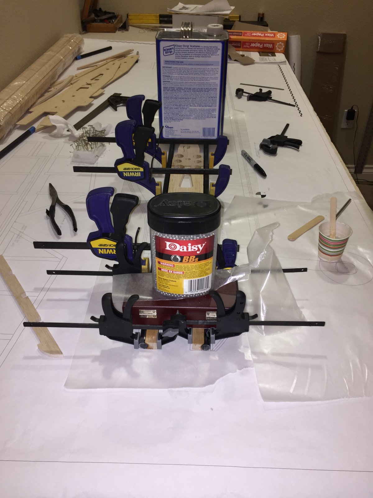

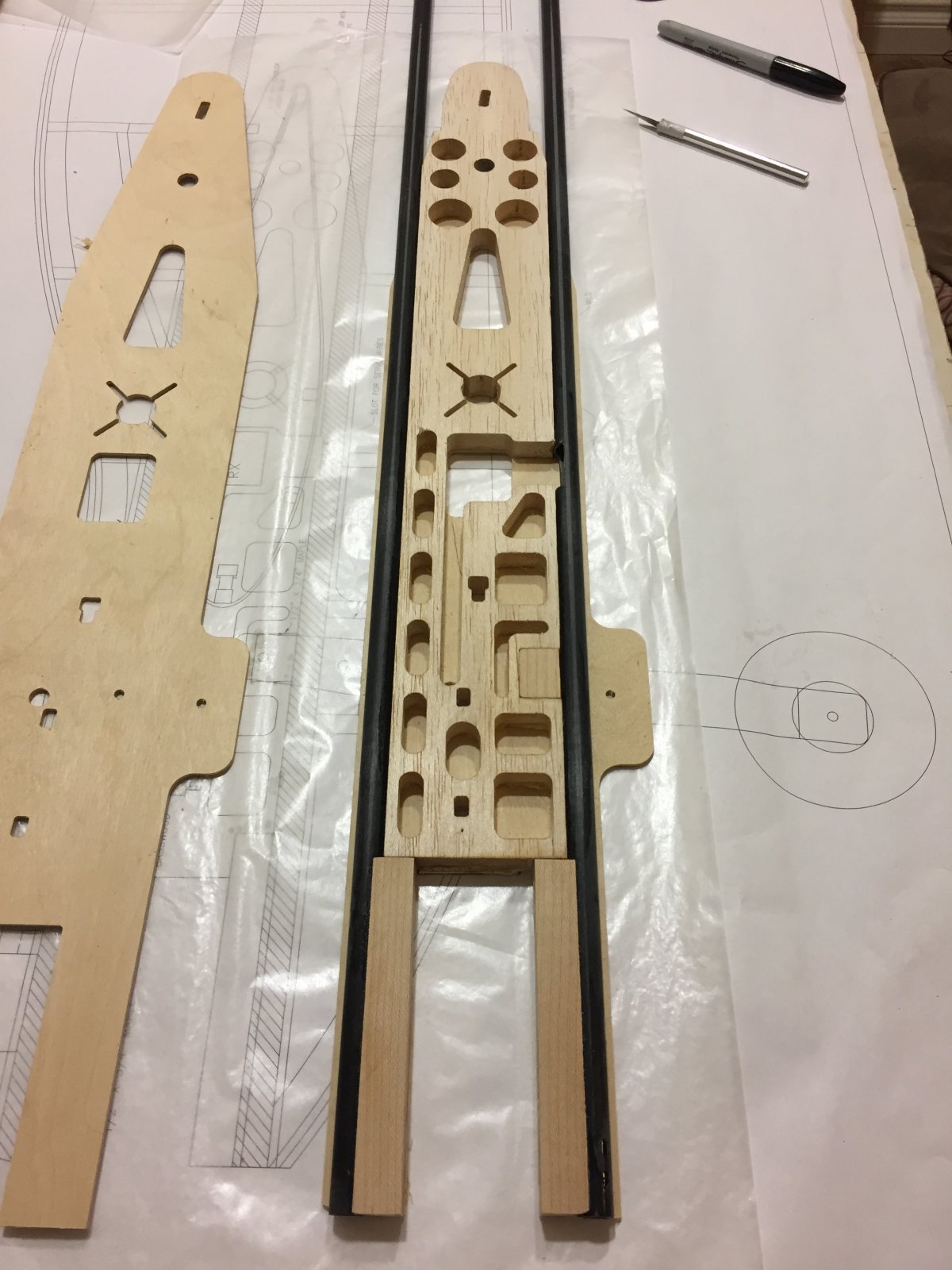

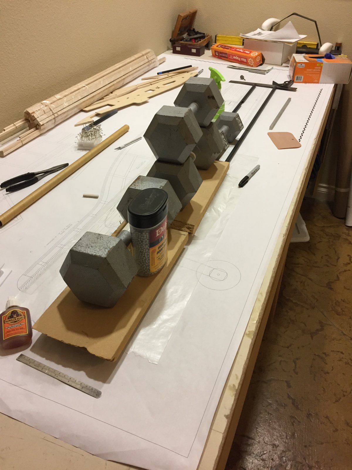

Got the glass tubes glued (epoxy) to the fuse core and maple motor mount supports. Don't forget to cut open a couple slots in the bottom tube to run the servo wires to the tail. Glued one side of the light ply fuse doubler on with poly glue.
What the "H", "E" double tooth picks??? I didn't even know you were doing this. How awesome!! But I do have one eensy weensy questioonie. You just acquire them there dumb bells specifically for this project? Or maybe you use 'em to toss at people that "jack" your build thread? hee hee... build on. Bet it will be very cool when you are done.
Alky6
View attachment 91506 What the "H", "E" double tooth picks??? I didn't even know you were doing this. How awesome!! But I do have one eensy weensy questioonie. You just acquire them there dumb bells specifically for this project? Or maybe you use 'em to toss at people that "jack" your build thread? hee hee... build on. Bet it will be very cool when you are done.
HA! My wife said if I didn't start using my equipment sitting in the corner collecting dust I would be in BIG trouble. So I abliged! :sneaky:
