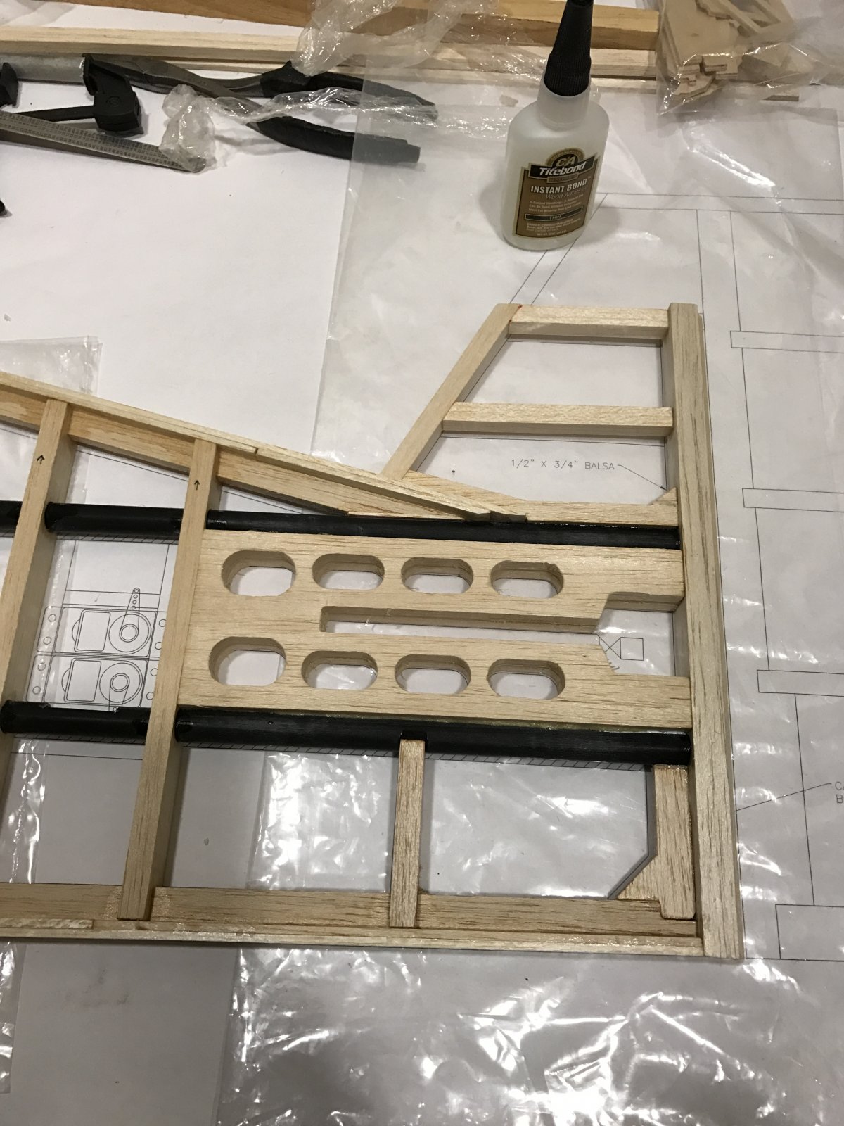

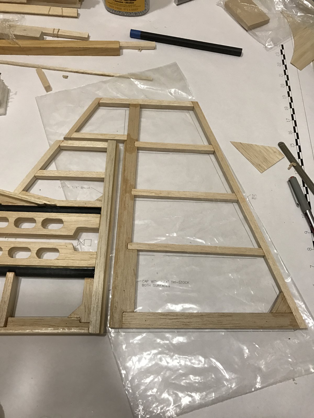

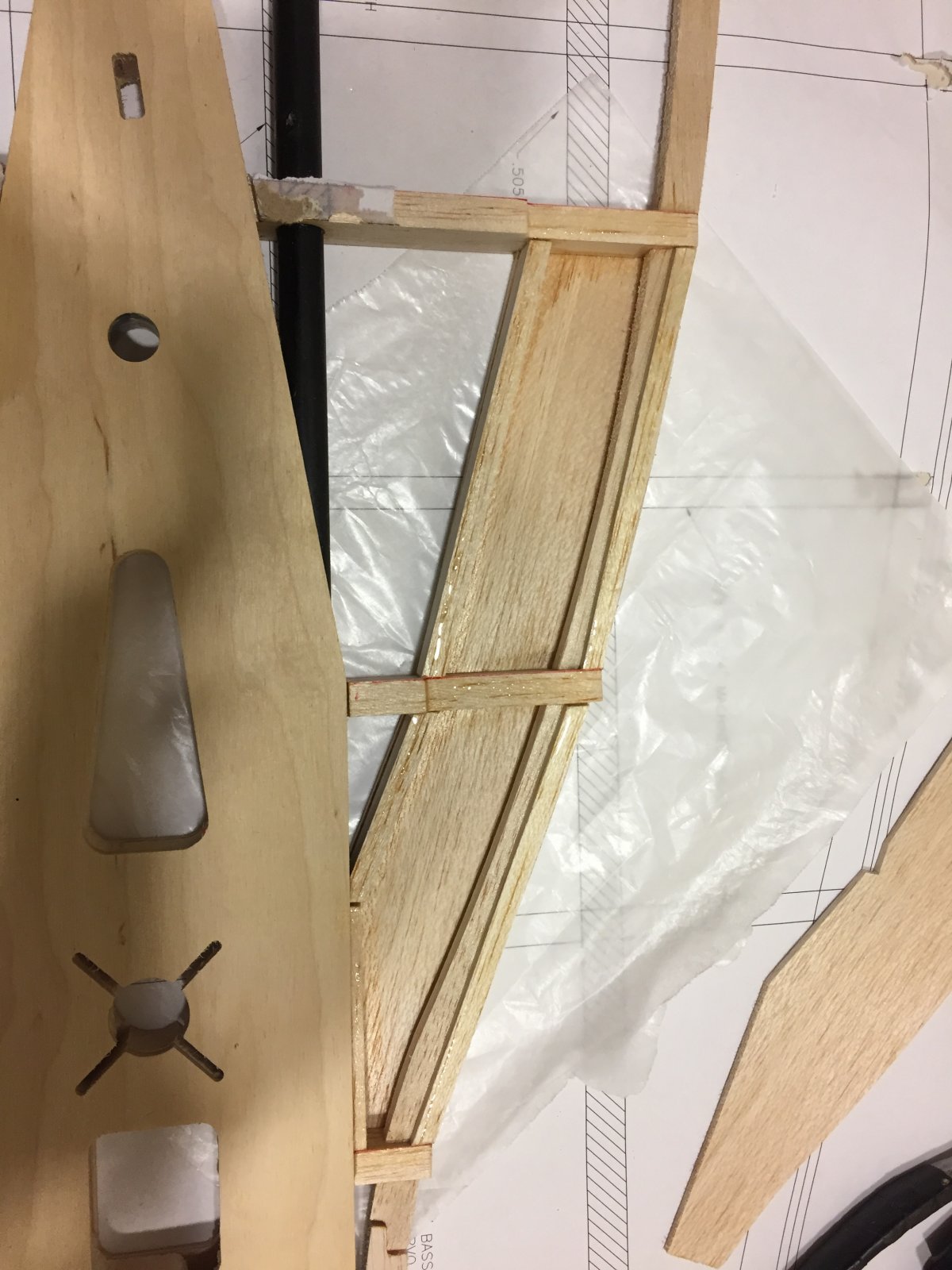

Question for any of you that have built this... @kwj48 , @Balsa dust , @caf2461 , or others, on the horizontal stab - did you sheet both sides or just one side? The instructions imply both sides but the cutout in the fuse looks to only be wide enough to accept sheeting (1/16") on one side. What did you guys do?
Thanks!

I have never built the 65 but I would suggest sheeting both sides and opening the fuse up a little more. It adds a tremendous amount of strength. I had My mojo40 get serious flutter when doing a cash drop one day of the entire stab not just the elevator. Before I could slow down the entire right side elevator and stab flew off never to be seen again. It wasn't sheeted on either side. Kept flying the plane that day but when I got home I cut the old stuff out and built a new one and sheeted both sides of the stab. I still cash drop the hell out of it and have not seen any flutter since
I had the same issue with my mojo 40. Added lift struts on the lower section of the horizontal. Never thought of sheeting the stabs to cure that. But the struts solved the twist I was getting during a roll
