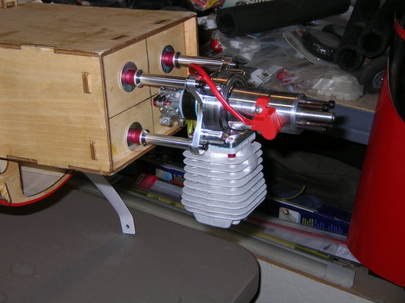

Right now I'm McGivering up the right length standoffs with what's available at the local hardware store on Sunday. Sold out of the right length cap screws it figures. Going to work with DA to get the right length standoffs and get rid of all the aluminum spacers. I learned the hard way DA cases and SWB standoffs don't work well together.
I would make a bunch of plywood standoffs and a good one for the backside to distribute the load, mine is cut like it is because I first thought I would use the EME auto-start but it weighs 1.5lbs and with batteries in the tail the plane was still friggen nose heavy. I got rid of the auto-start and everything balanced nicely. I do like your DA50 motor, it looks pretty darn light. My plane finished came out to 19lbs, PAU recommends 18-20 so I am pretty pleased I am not overweight.
