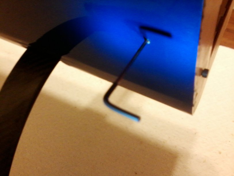

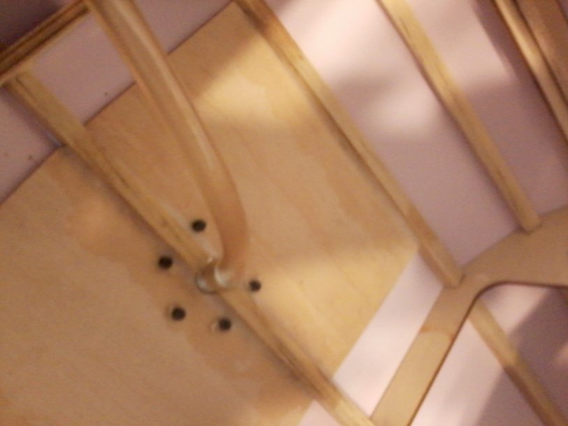

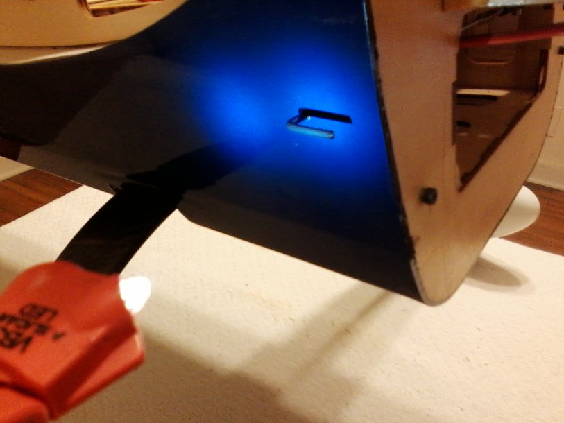

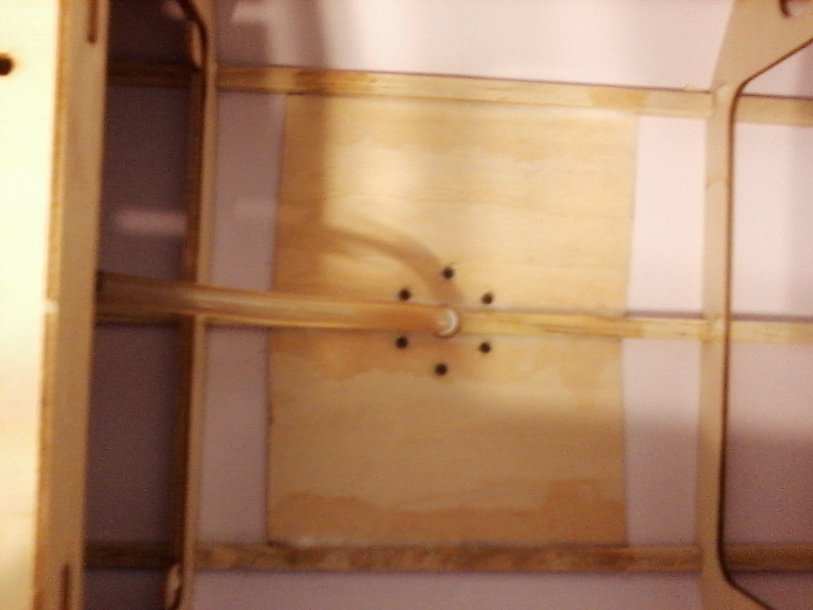

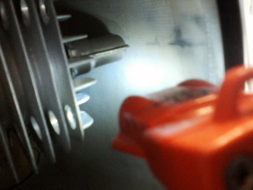

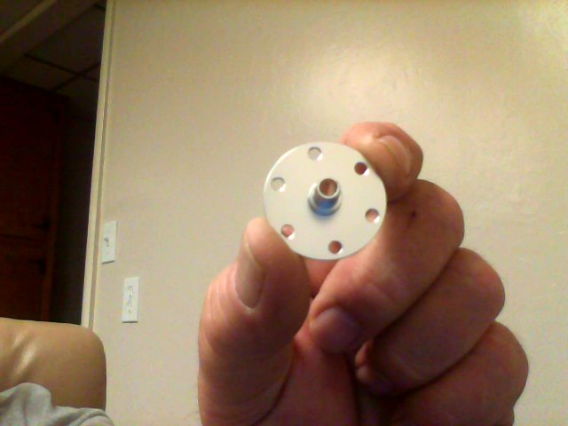

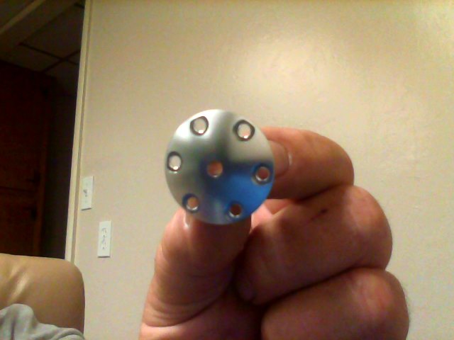

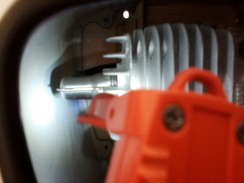

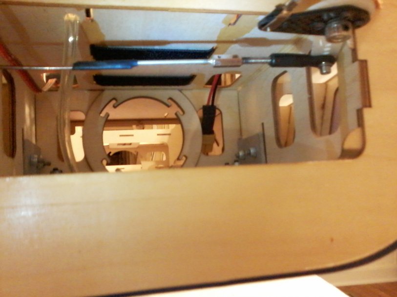

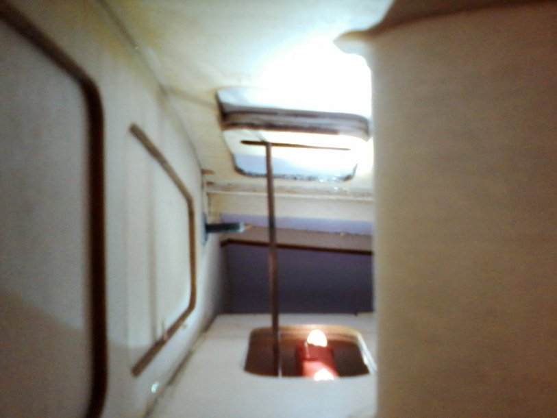

Ok the "remote" choke lever is complete! Works like a charm and is smooth..... no binding. Made the finger hold to "mimic" a petot tube.

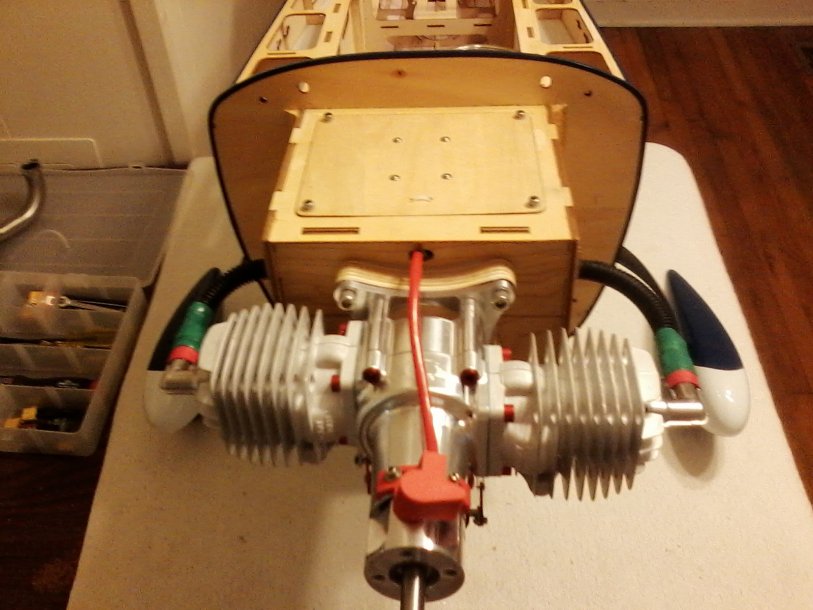

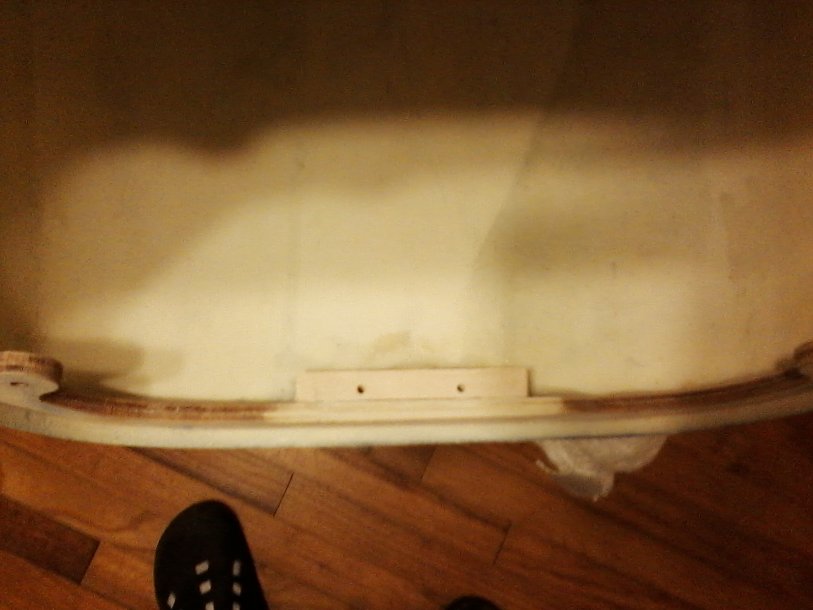

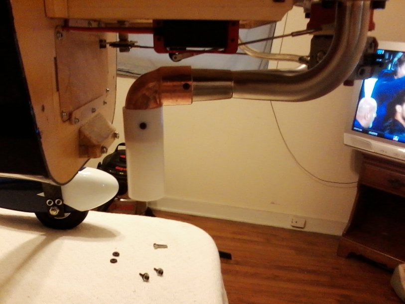

With the exception of the " muffler/mufflers???" everything under the hood is looking good. Will make up some bottom cowl mounting brackets . Pipe tunnel and motor box "closed up" and will start looking at the baffling.

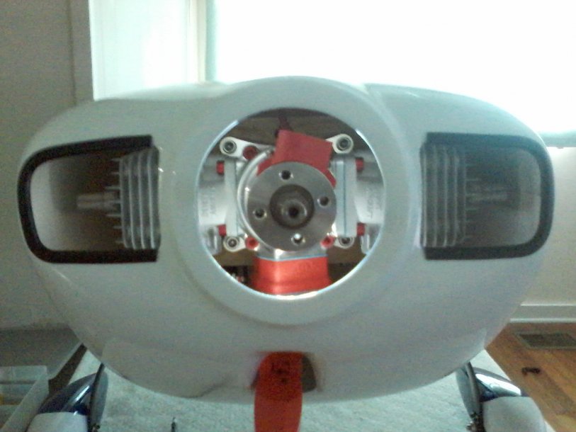

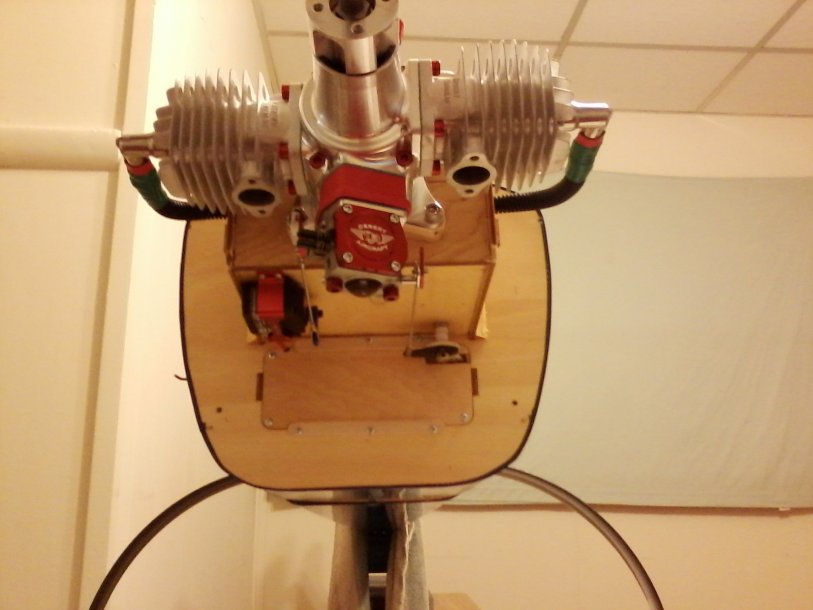

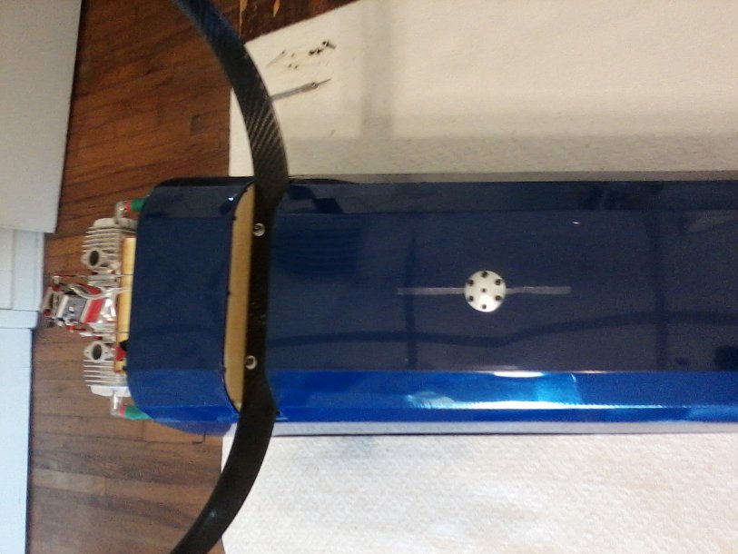

Just a couple of pics with the cowl on to show how much room is inside for the DA70. with the plug caps on the right cylinder has about 5/8" clearance and the left about 1/2"

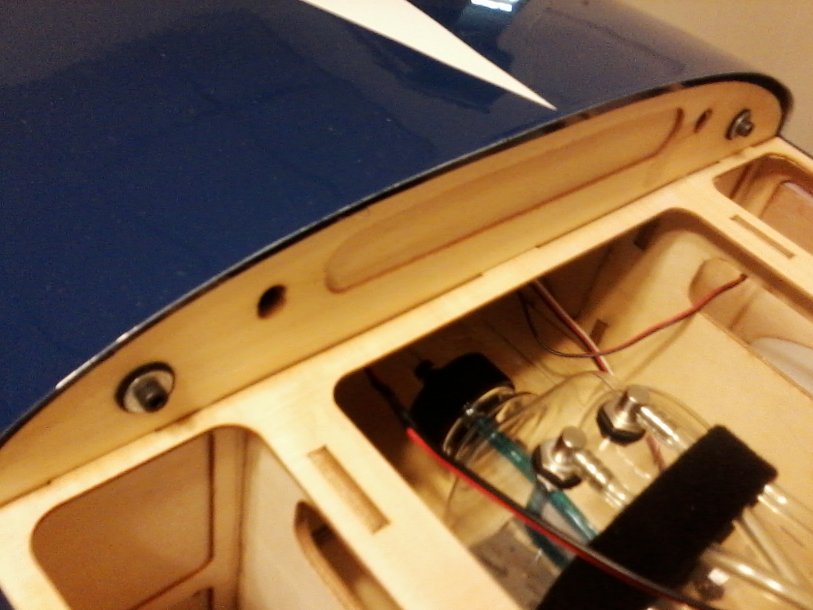

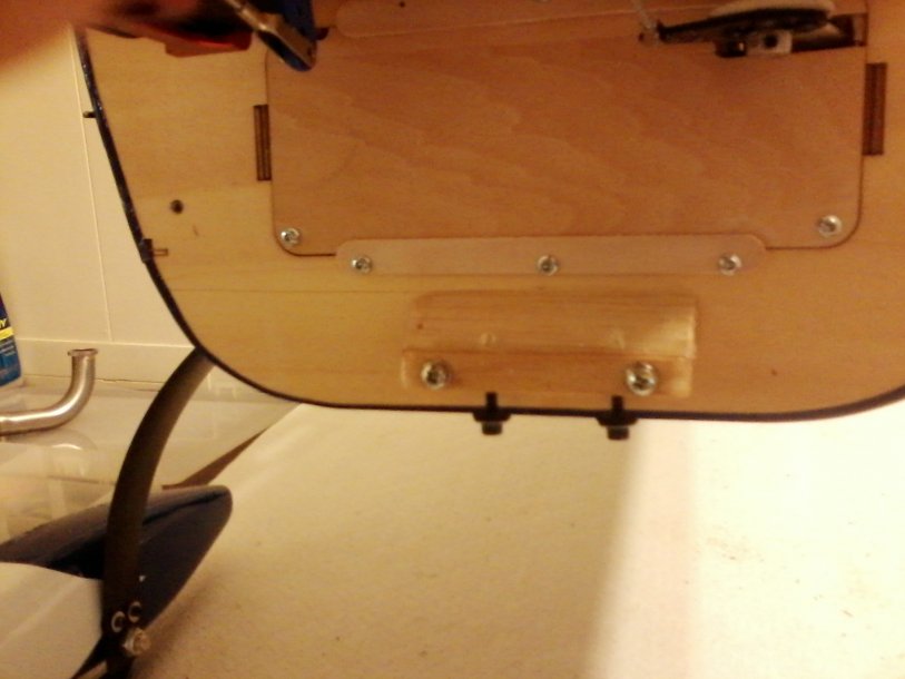

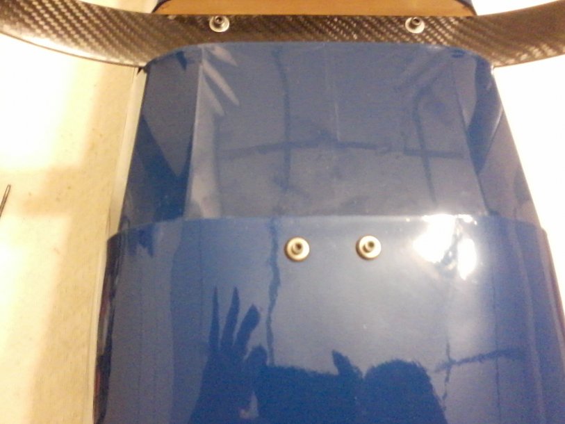

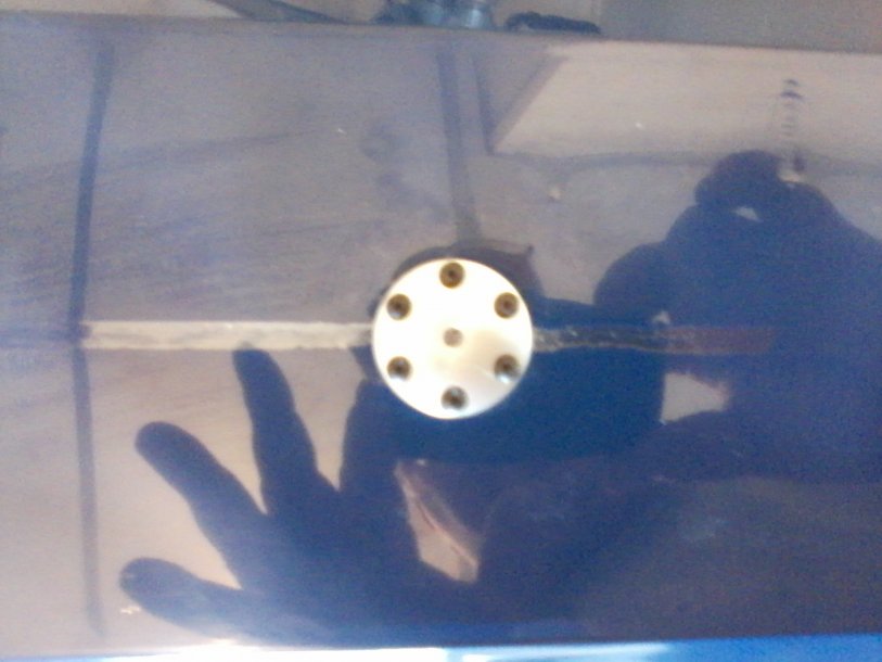

Got the cowl mount "squared" away. Stock 3mm screws at the top 6-32 on the bottomo_O.
