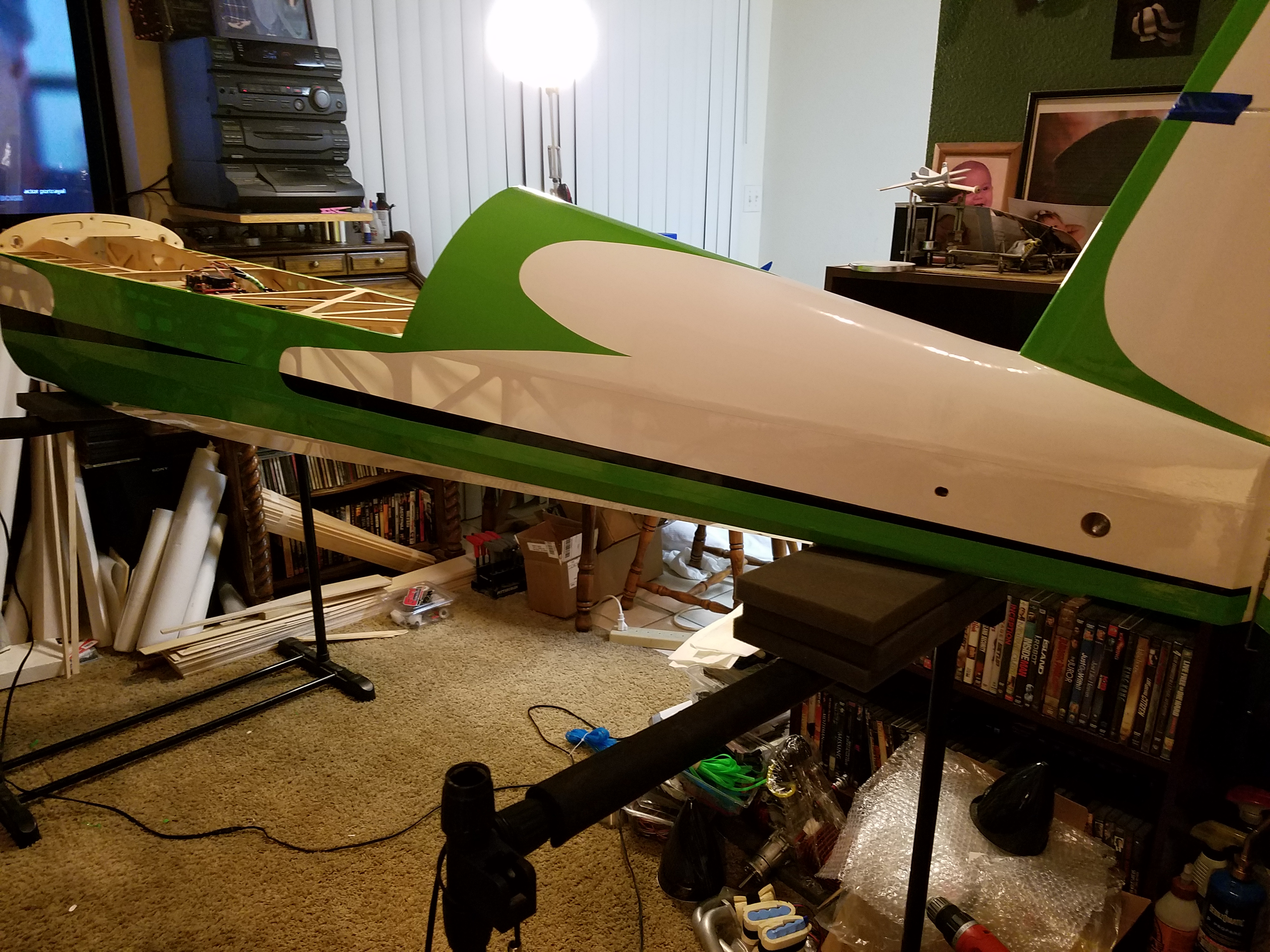

Left side done and basically the fuse is ready for toys. Stay tuned everyone.

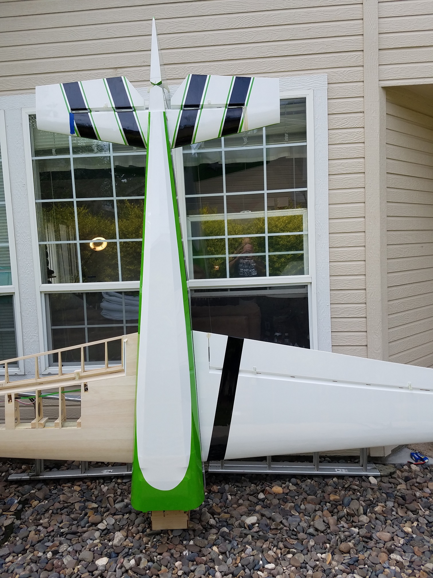

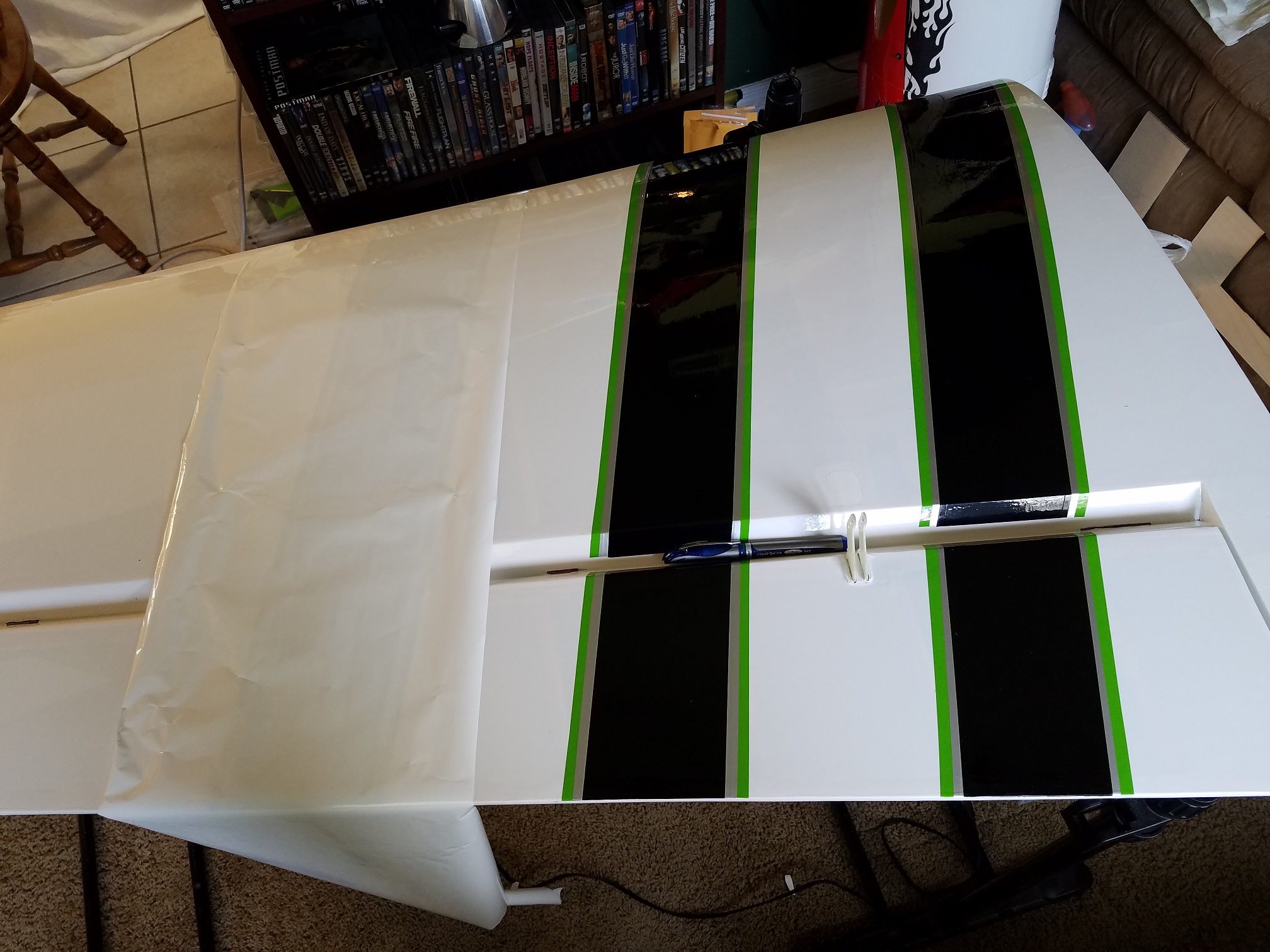

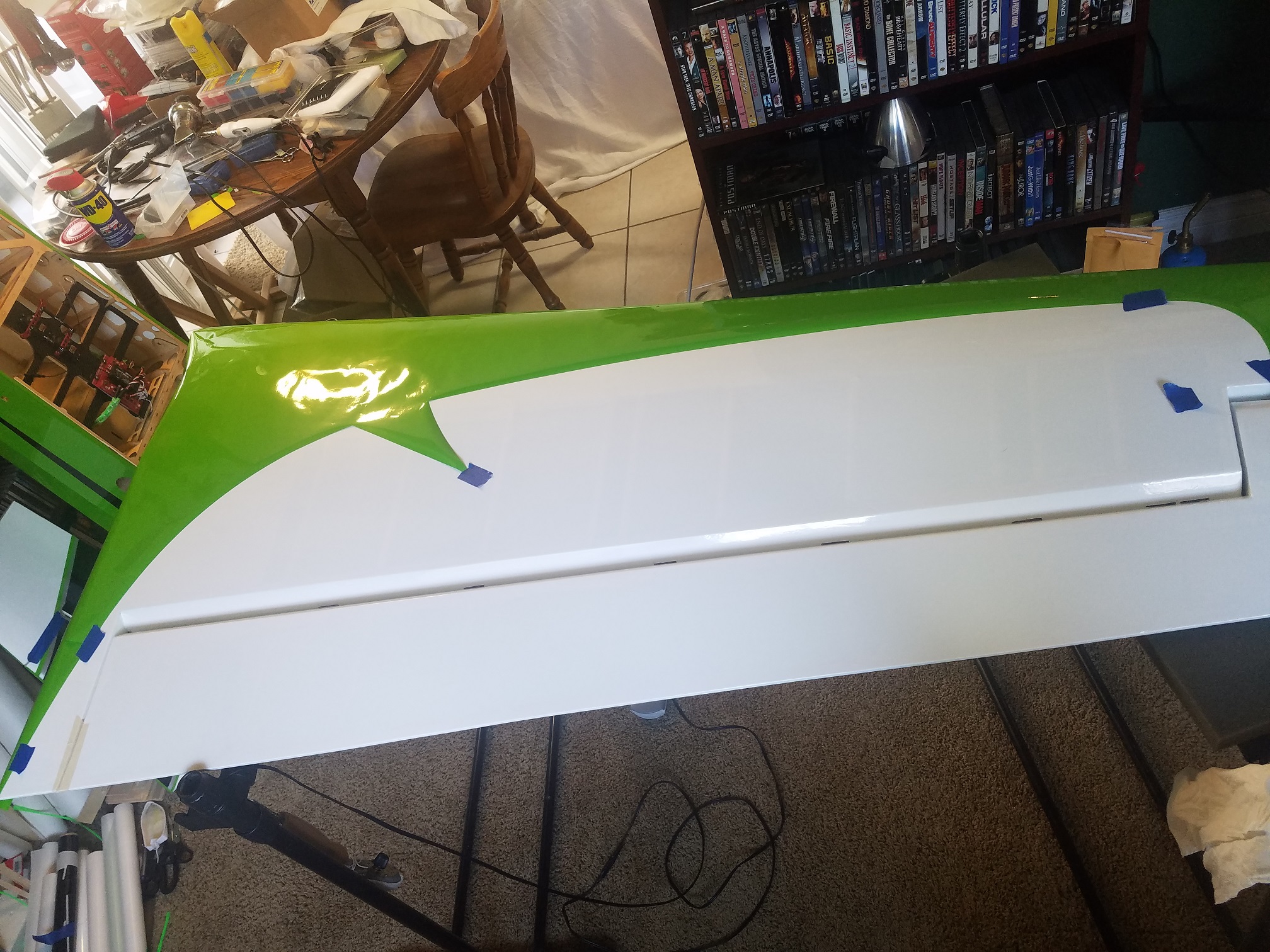

I took the opportunity today to get some covering done on the 330. It has been a while since I had a 3 days off in a row. So this weekend really helped a ton. I did make some progress. Good but not great. Either I am slowing down or losing my touch. I remember being able to cover an entire wing in just a few hours. I actually started with the right wing last night and put about 4 hours into it. Then an all day process to get to the point that I am at now.

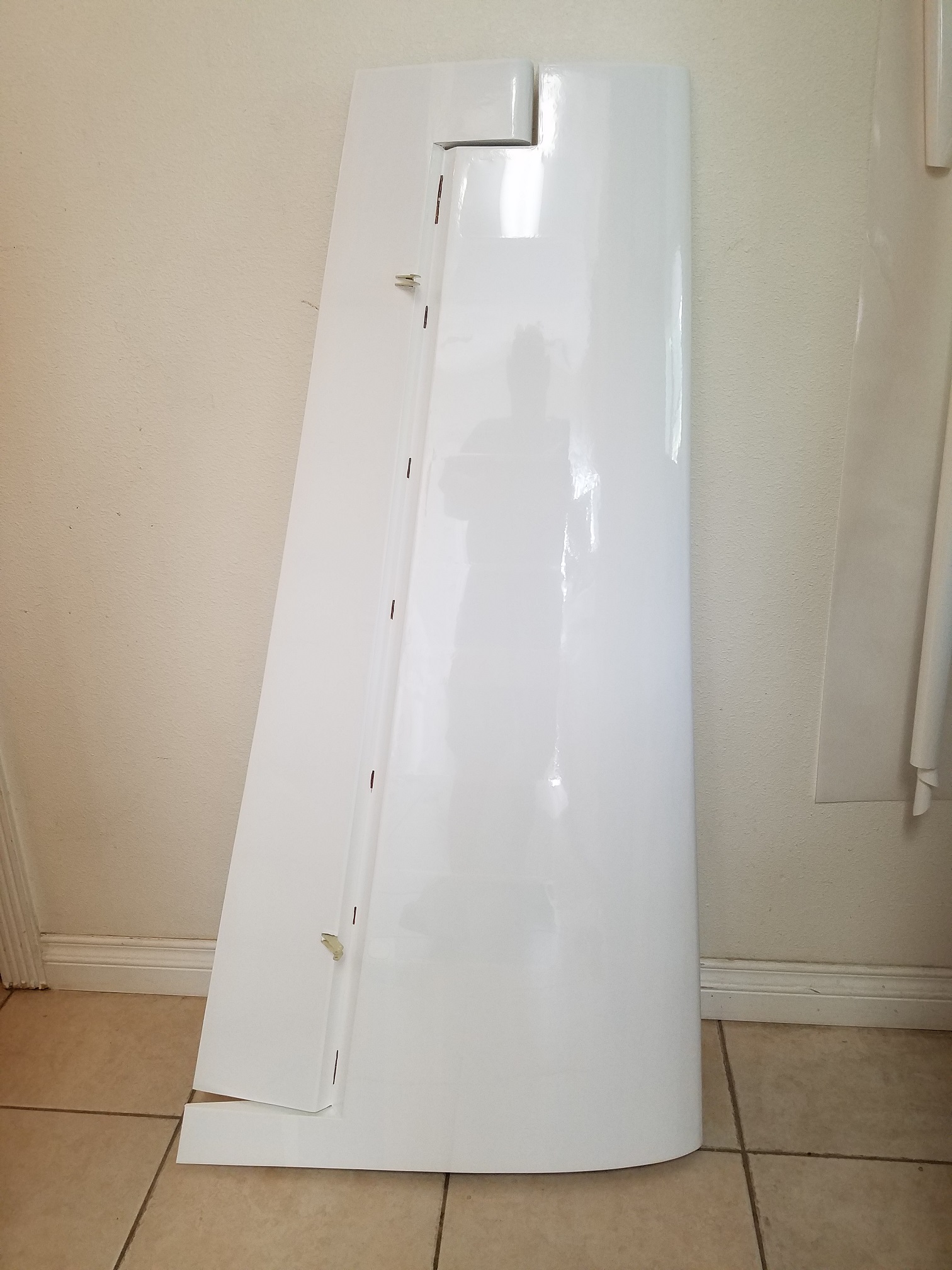

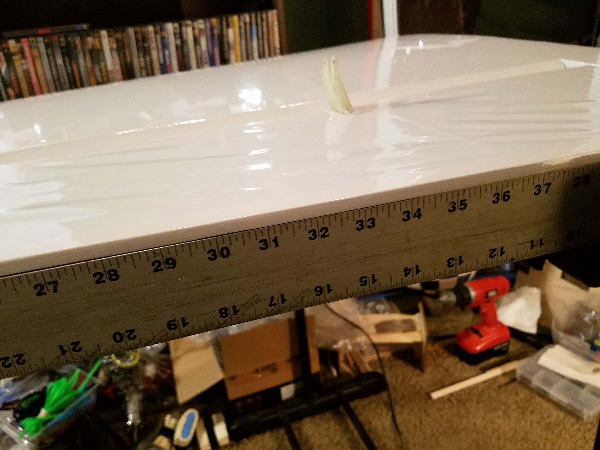

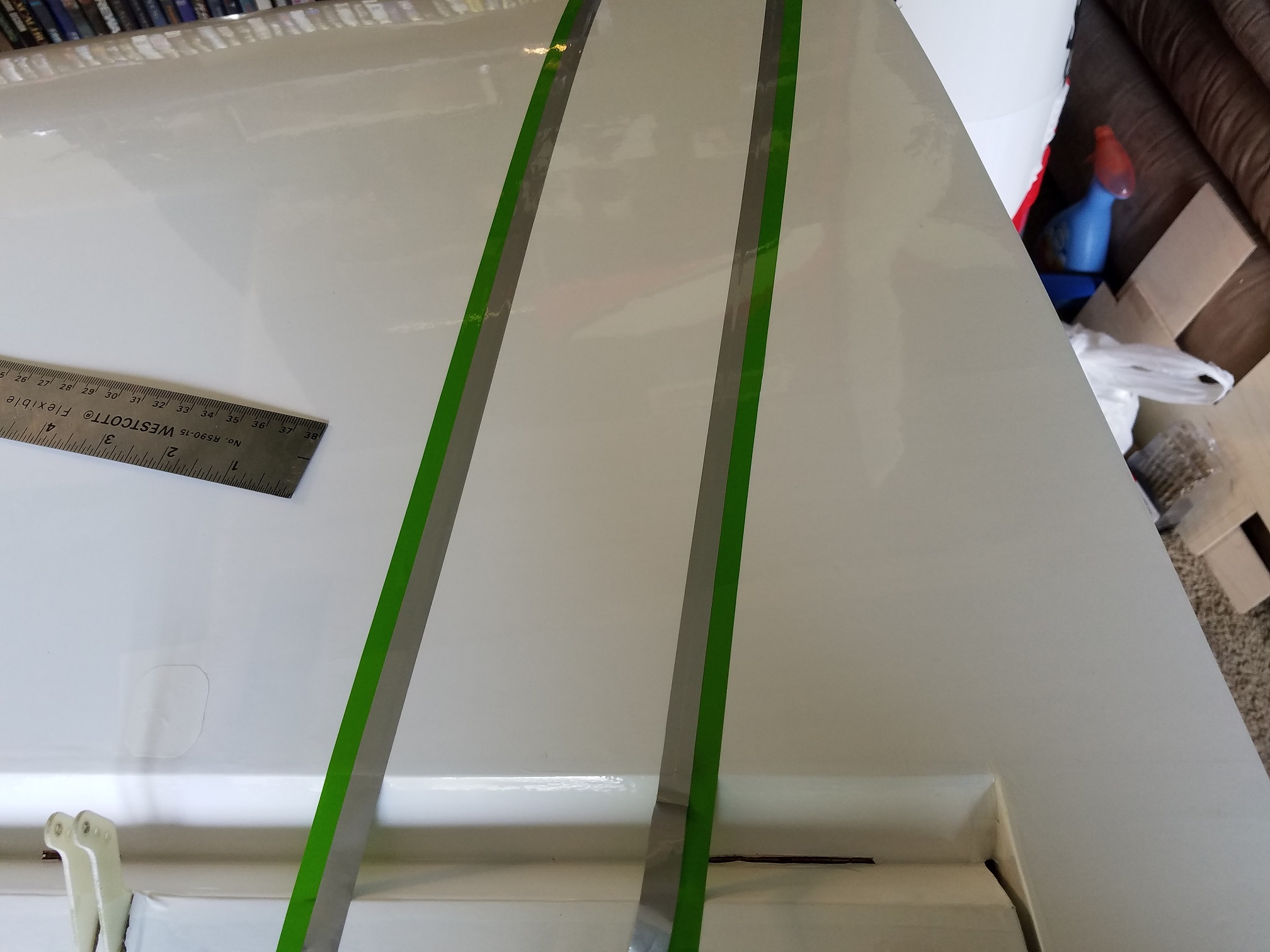

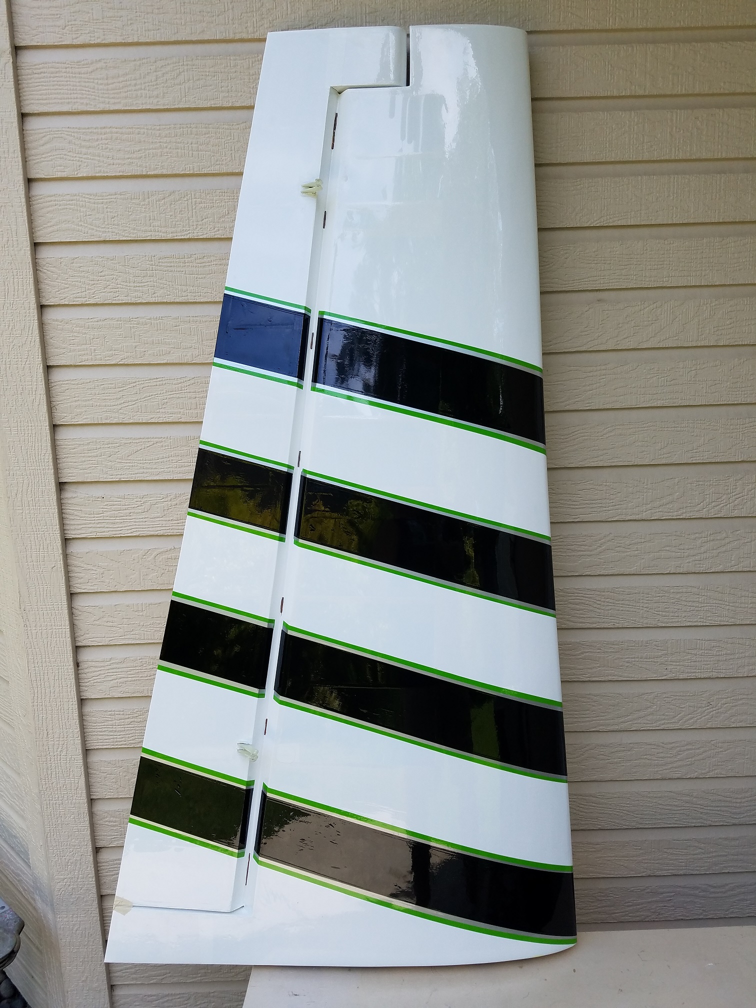

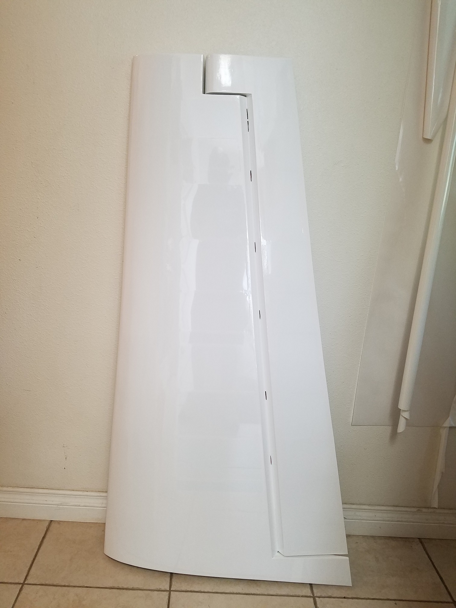

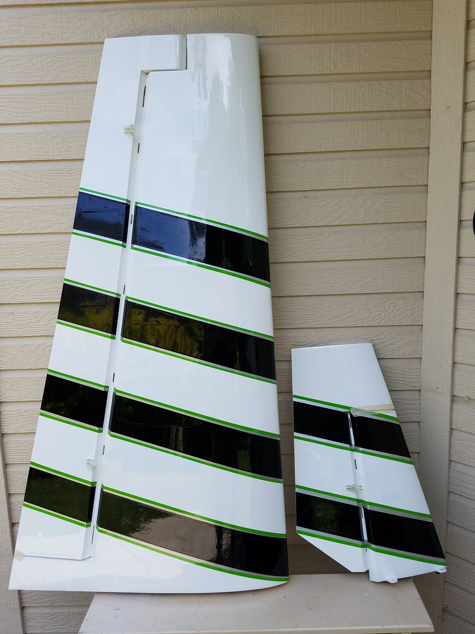

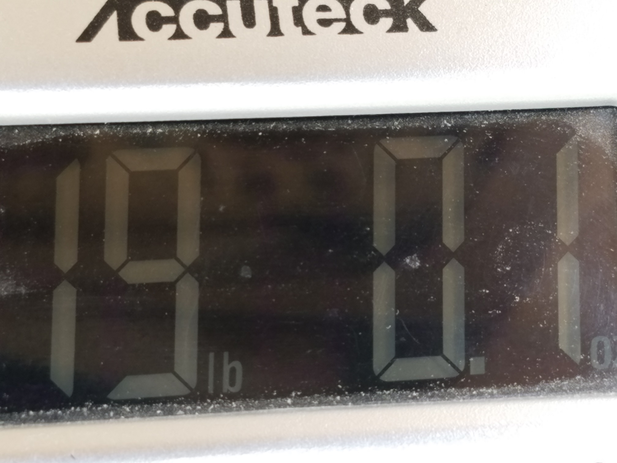

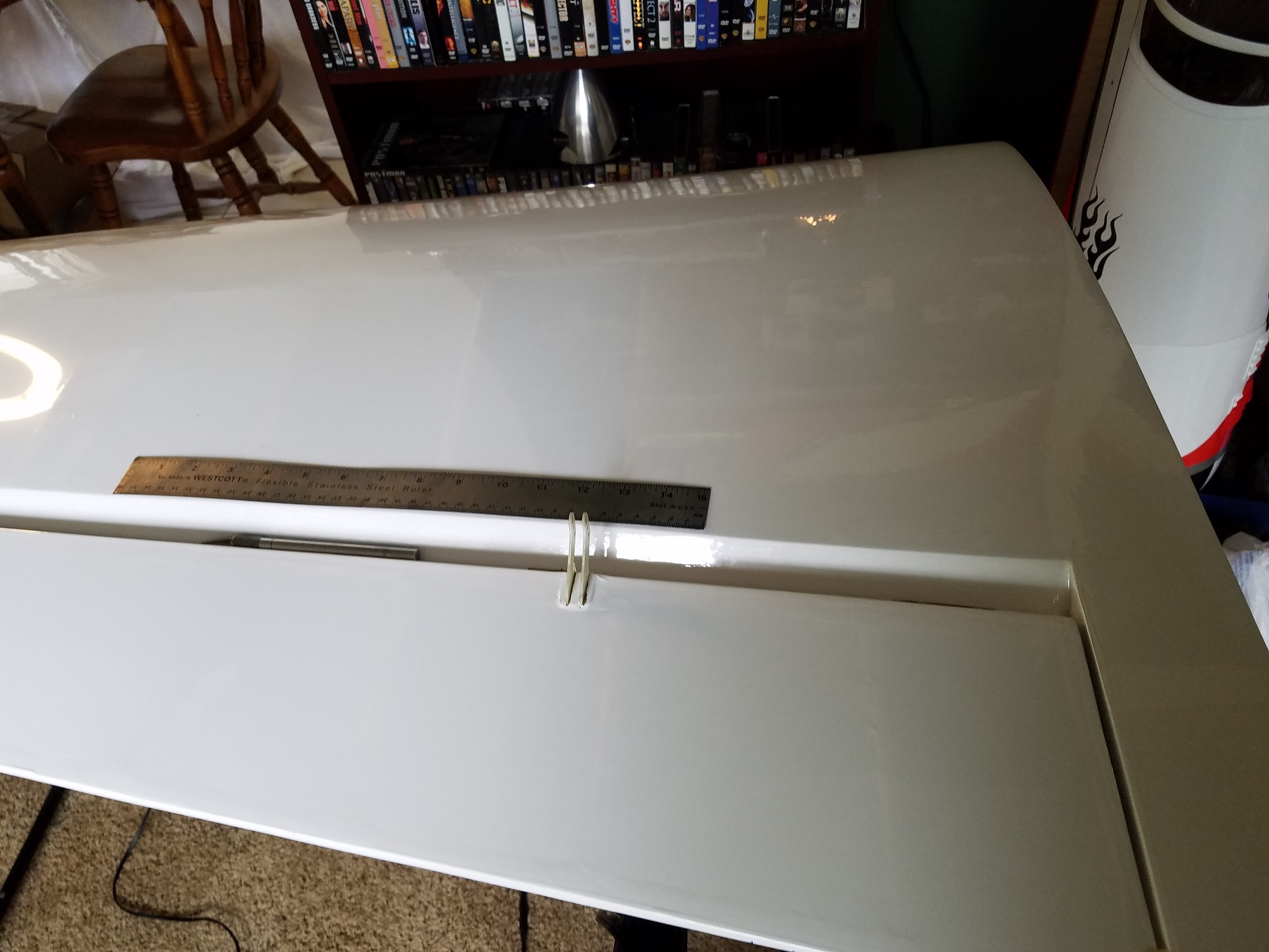

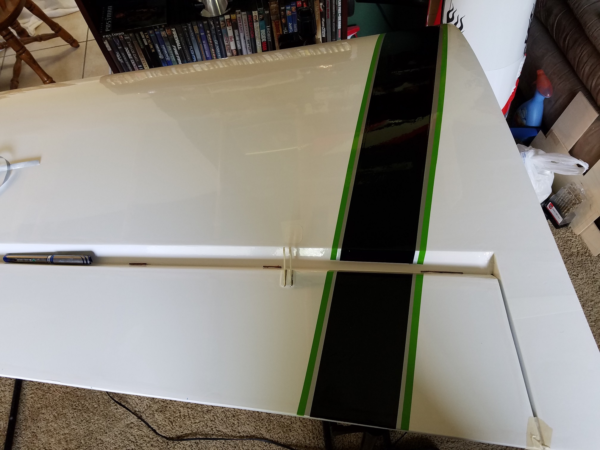

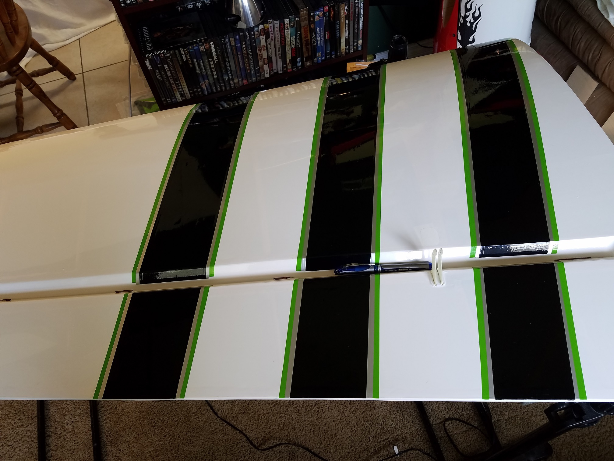

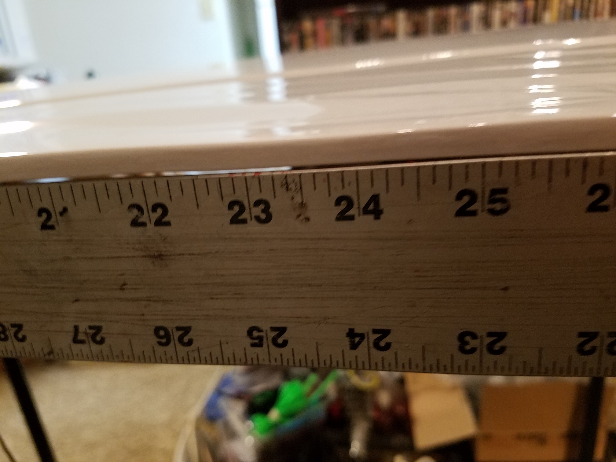

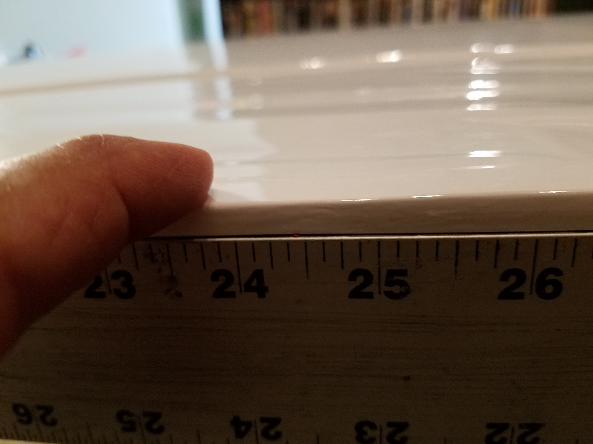

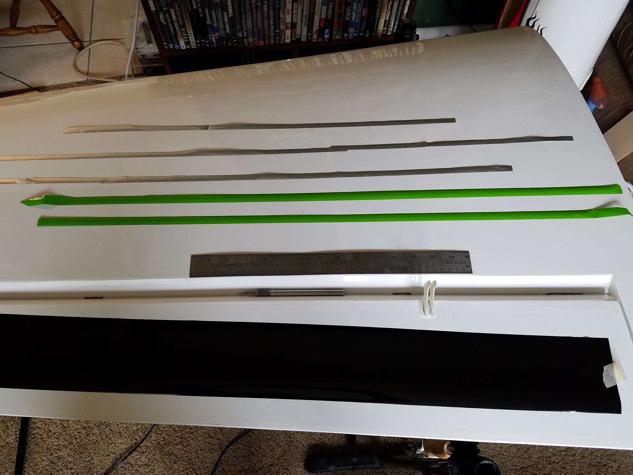

First the base white goes down. Not too difficult right? It is just the size that will get you. I used my 48" straight edge as a rest brace to keep the aileron straight while I shrunk the covering. After all the white was down, I started cutting, (by hand) all the green, silver and black stripes that will make up the bottom scheme of the wings. I chose to use four stripes on the main wings to make the scheme more uniform. After cutting all the stripes I did a quick assembly outside to get the right angle on the wing stripes. I want them to be at the same angle as the stabs/elevators. While outside, I decided to weigh the airframe. At present, it comes in at an even 19 pounds. I really can't remember what the big Yak weighed at this point. But I am hoping that when the 330 is complete, it will come in "way" less than the Hangar 9 Sukhoi, (42 lbs.) and the 260, (41 lbs.) Darn sure it will be less than the Big Yaks. (51'ish lbs.)
Time for some coloring right? First one, then two, then three and lastly four stripes. Have to admit, I will be so so sooooo glad when this one is done. Thankfully, it looks as though it will be quite noticeable on the ground and in the air.
