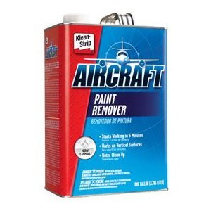

What are you sanding? The paint? Strip it with Citristrip, awesome stuff.
http://www.citristrip.com/
Hmm, well there I go. Was hoping someone or Doug would chime in with a little suggestive help. Ugh, hate sanding old paint off. I have to strip the canopy too. Will this also work for that without damaging it?
I've stripped early 80s painted fiberglass classic pattern planes several times. Let the citristrip sit long enough and it will bubble the paint right off the fiberglass. Sometimes a second attempt is required.
acerc
This stuff will strip any paint quickly, including the gelcoat if left on long.
