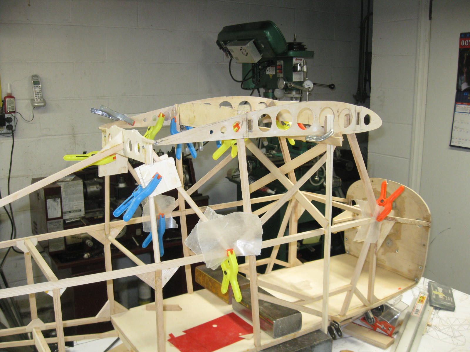

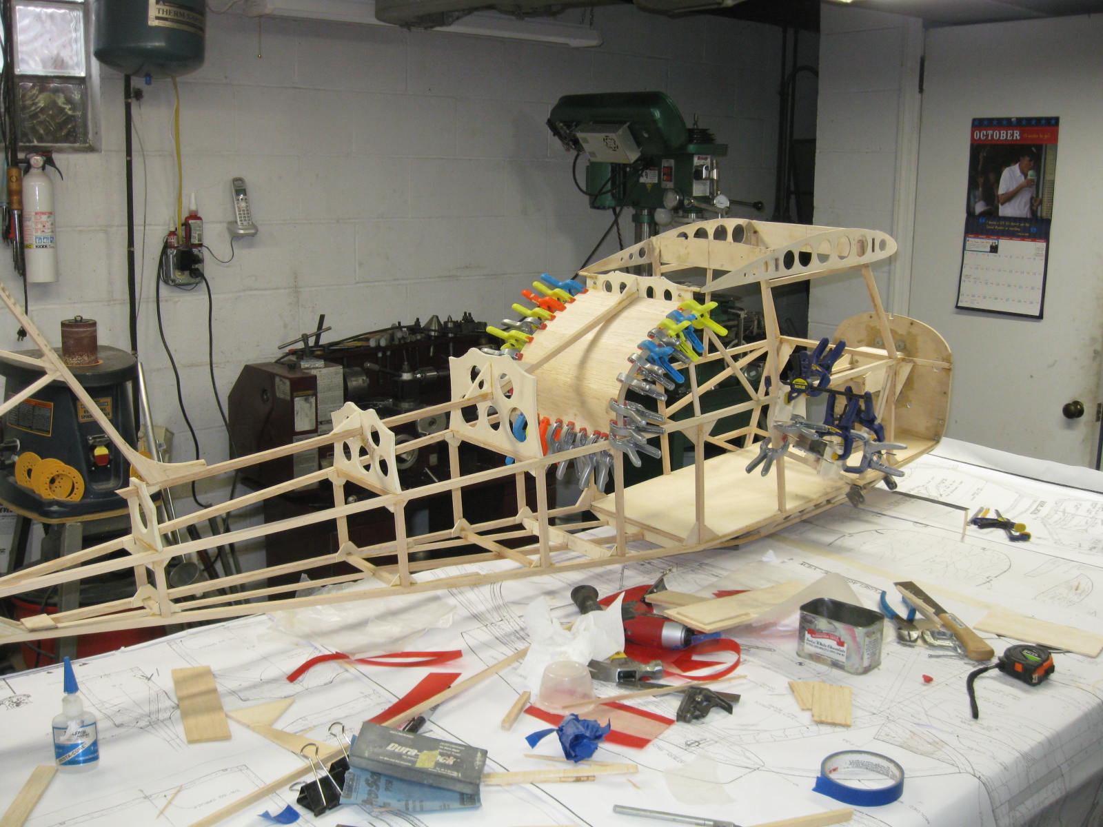

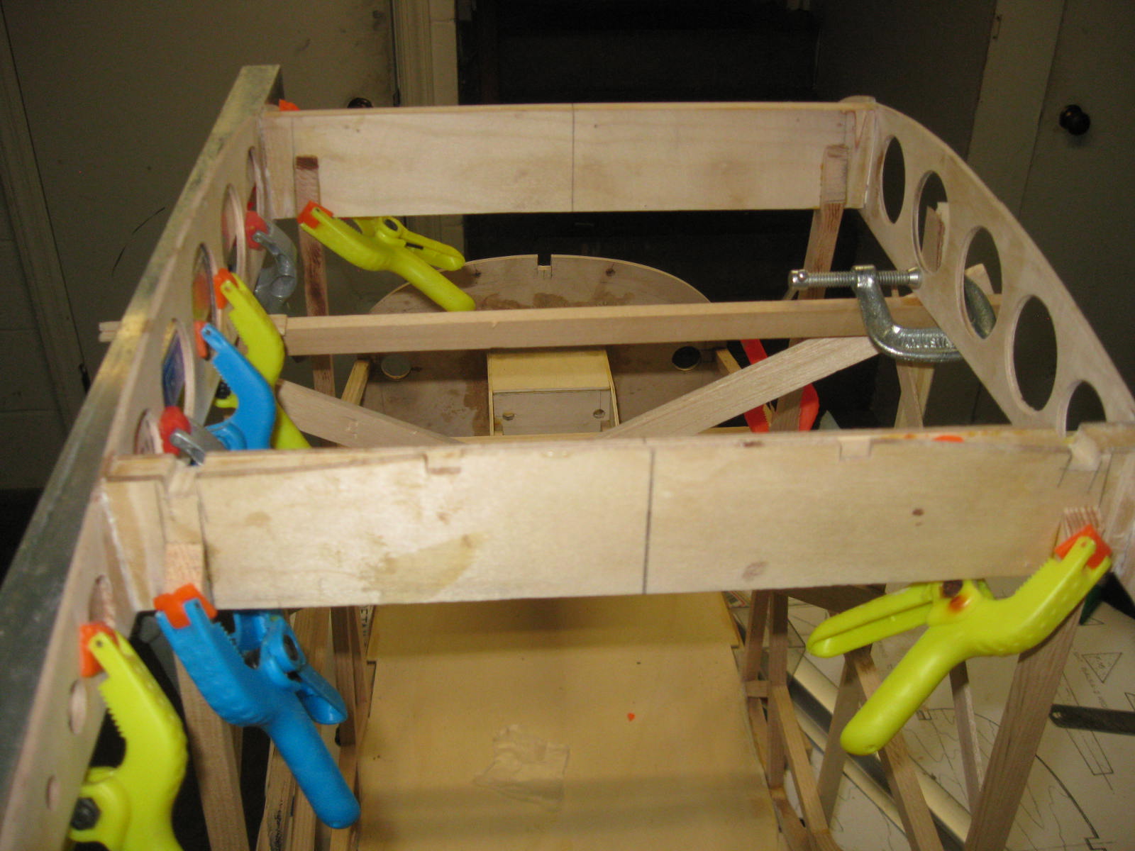

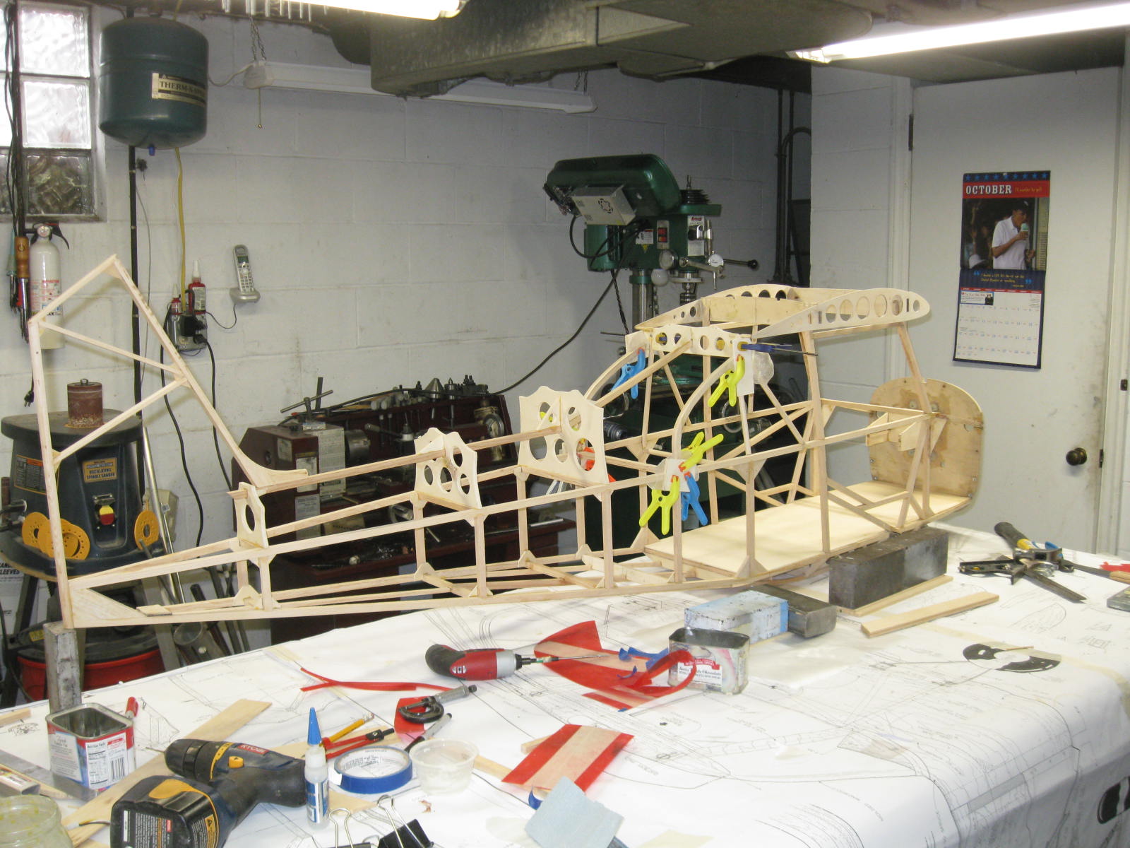

Got the four front posts installed along with the rear diagonal dowels. The post are inset about 9/16" at the top from the rib formers. The post are lapped glued to the spar boxes. Once the glue dries overnight, the craddle will be removed.

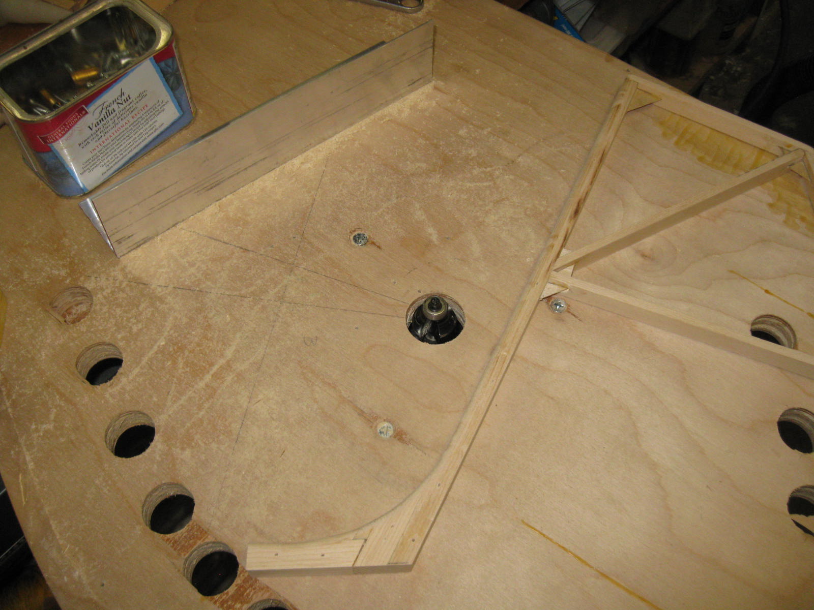

Got out the makeshift router table and put the radius on the rudder edges. The rudder is 1/2" thick, the 1/4" radius bit was just the ticket. I also used the router to put the radius on the front posts in the cabin. The drawing calls out 3/8" x 5/8" half round, I had no idea what in world it was, thought about cutting a 5/8" dowel to 3/8" thick, tried Google. Finally decided to put a radius on the front side 3/8" x 5/8" stick, I think that's what the designer had in mind.

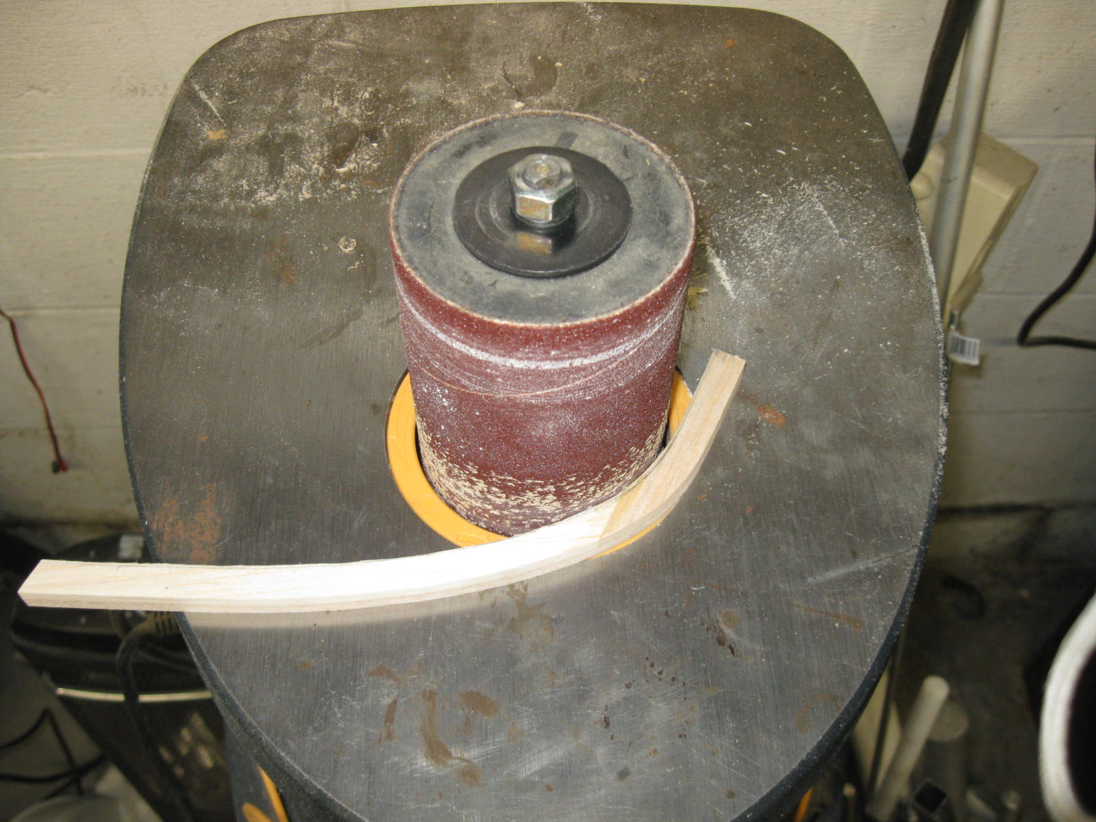

Well Snoops got to use the drum sander to sand the filler pieces for the rear windows, the back wall also glues to these pieces. My scrap balsa drawer is overflowing so I decided to laminate some 3/16" scrap for these pieces. Put the 3" drum on for this operation.

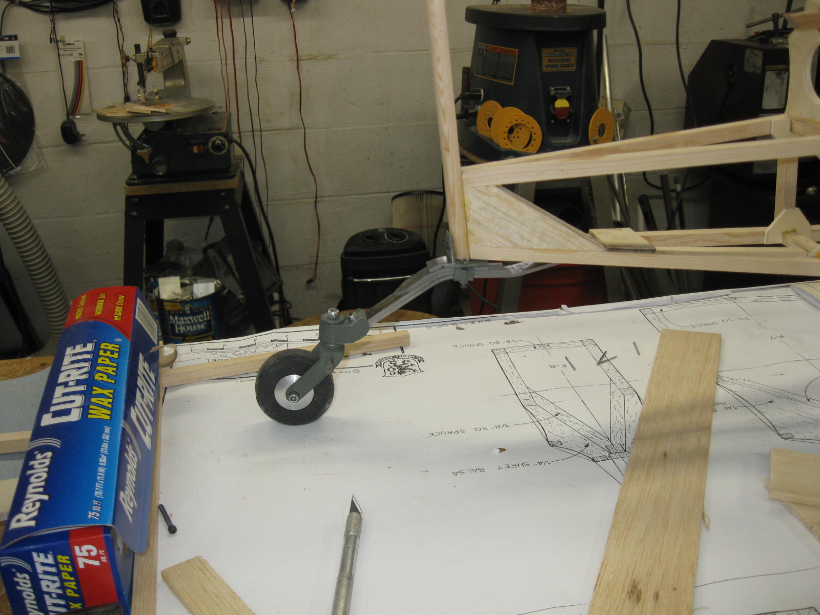

Installed the vertical fin and tail wheel today, also continued to add parts to the cabin area. Still have a few more filler pieces to install before the 1/32" skins are installed. Heading to Toledo in the morning so nothing will get done except parting with some cash.

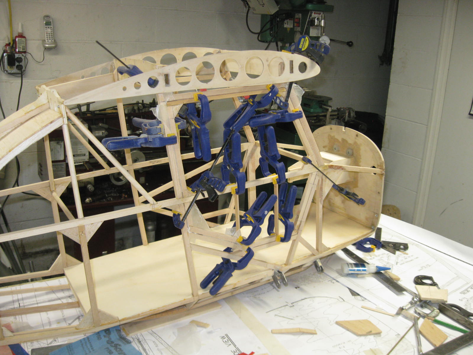

Got the cabin rear wall installed and made the door. Not sure how the designer envisioned making the door but I decided to make the door in the door opening so that I know it will fit. The frame parts were shimmed with 1/16" plywood strips away from from the jam, the top of the door slopes in at a 4 degree angle. The frame is glued to the top longeron which is part of the door and is still in place. The hinge slots were cut in with a multi tool at a 45 degree angle. Tomorrow after the glue dries the door will be cut out and the hinges can be glued in. Using DuBro giant scale hinges so the door can be removed. Once to hinges are installed I plan to shim the door back to the original position while the epoxy cures. The weather is getting nice here in Pittsburgh and I might just start painting the Glasair next week. Will put the Champ on the back burner for a while although I'm really liking this build.
