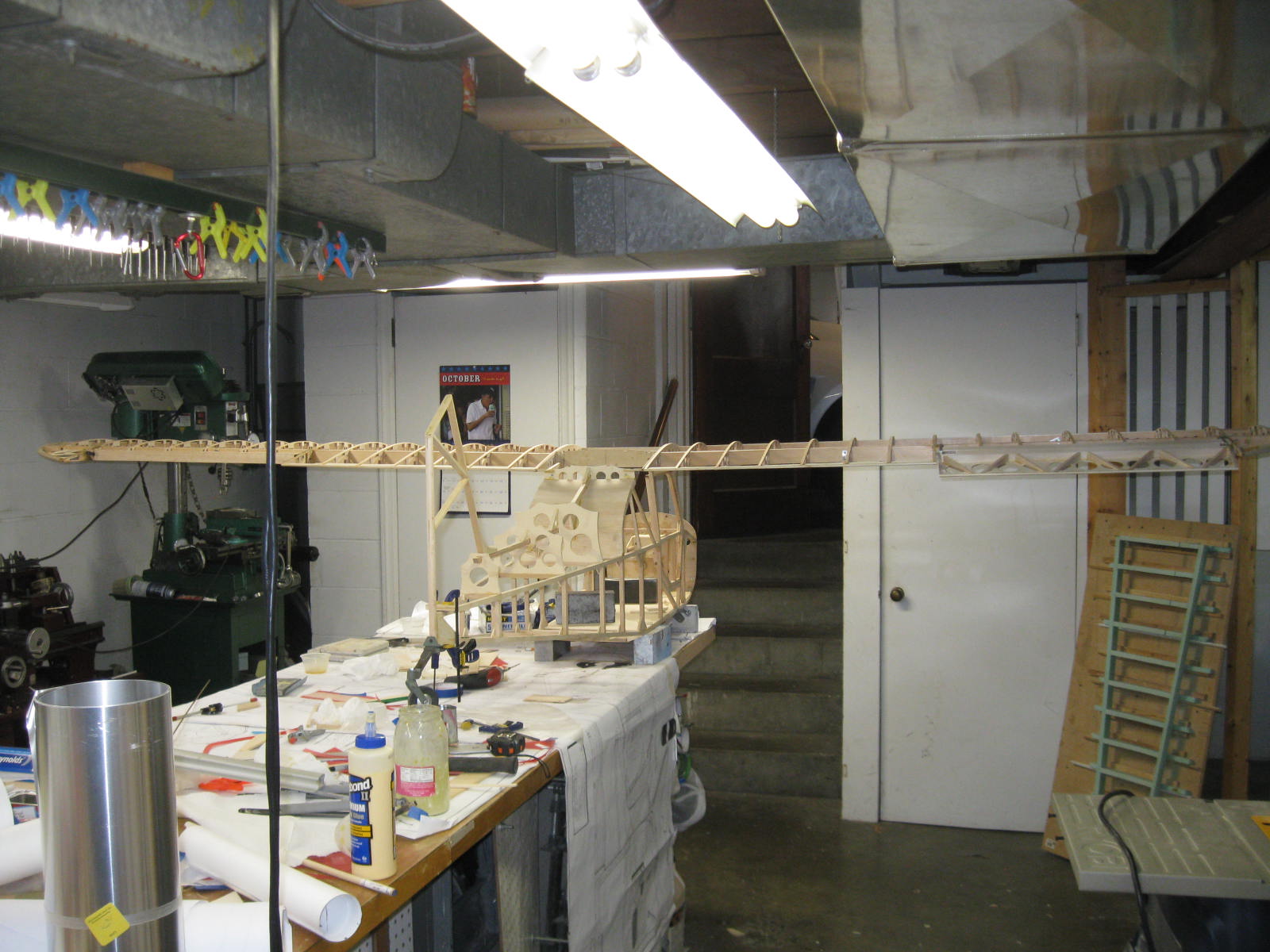

Moment of truth, put the wings on the fuselage today to check alignment, the diagonals were within 3/16" which is close enough, will get it dead nuts with the lift struts, actually the wing tips move quite a bit, had to anchor the measuring tape at the rudder post to get accurate measurement.
Looks like a plane now. Nice going getting closer to finishing the wood work part of the plane, from my perspective in about a month all the wood work should be done.

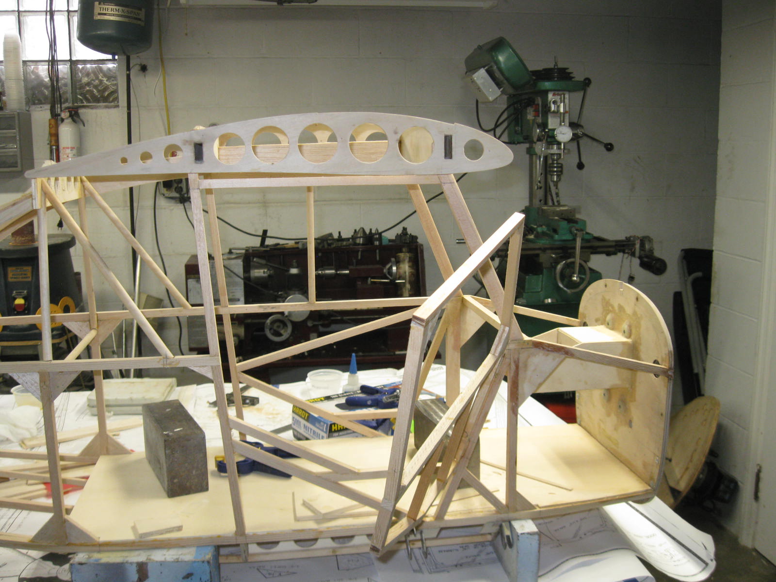

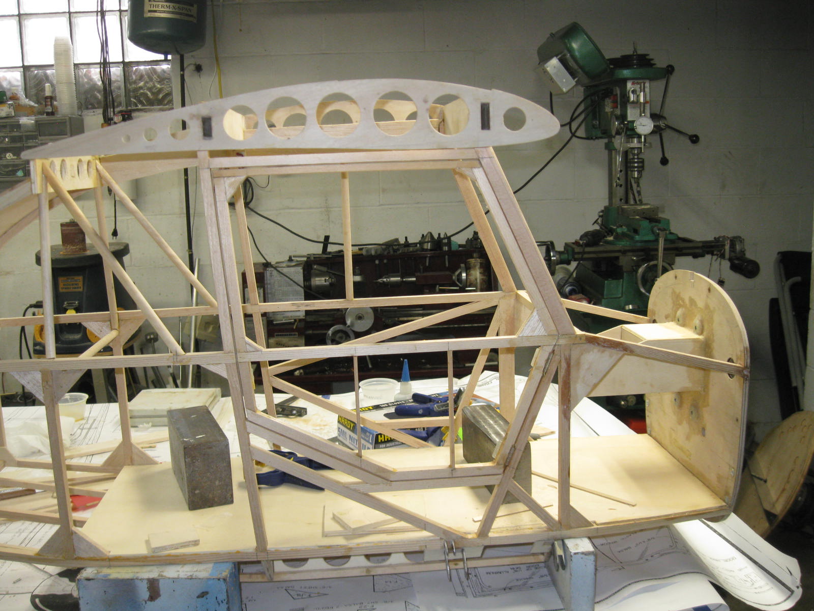

The gap around the door looks pretty good.
Have to ask been looking at it for a while the motor bulkhead on the front needs a lot of wood to make it look like it is connected to the rest of the plane.

Agreed, I plan to sheet inside the sides with 1/8" lite ply, The dash and one stringer will be added to the top and evaluate. It is currently as designed which is hard to believe. The outside will get covered with .012" aluminum sheet attached with #0 screws. I hope to get the interior sheeted with 1/32" plywood before doing anything in the front.

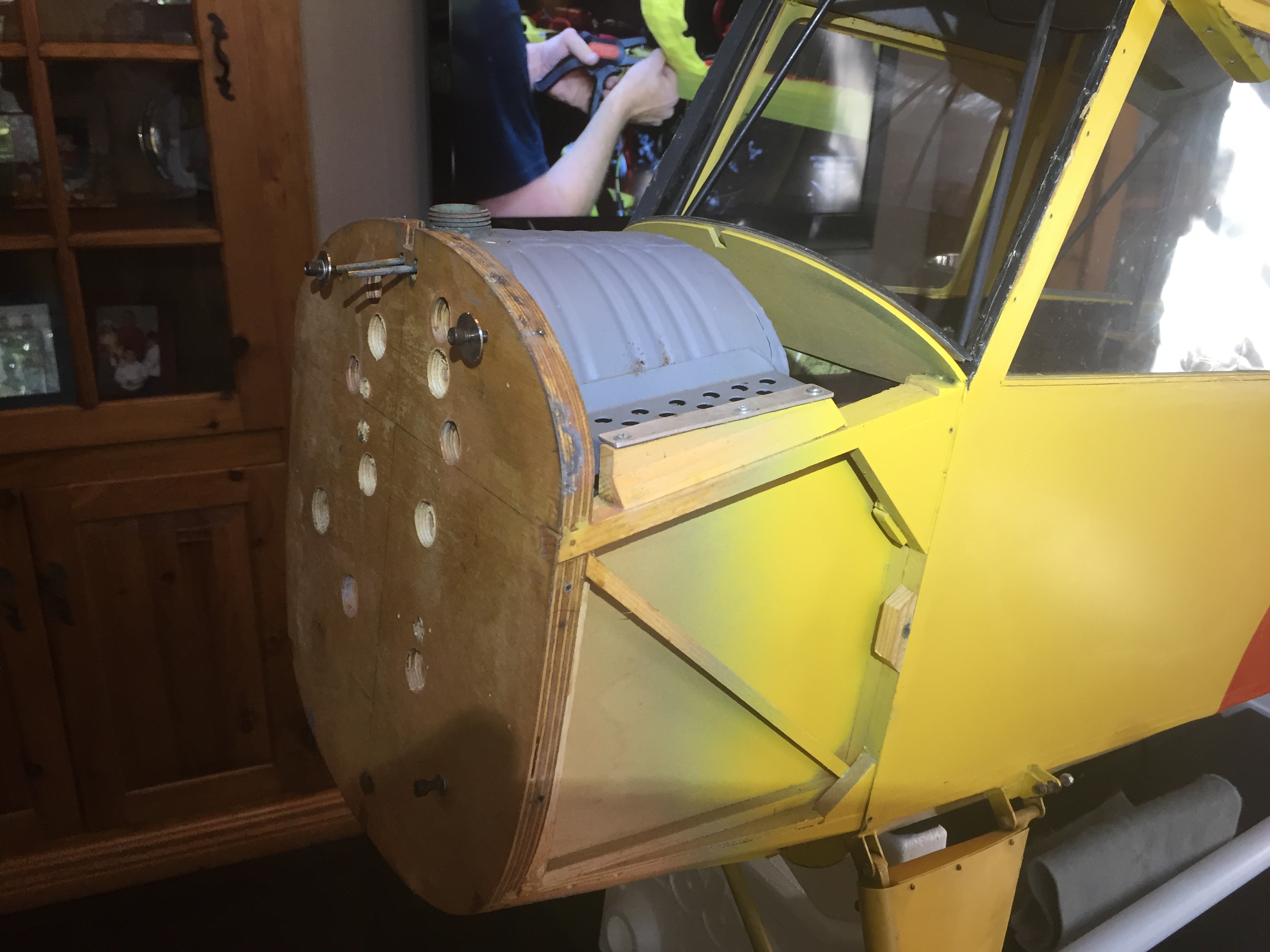

Here's a photo I found online of the model, the side sheet and diagonal brace are not shown on the plans. This is really old school, the firewall is 3/4" thick, I suspect the fuel tank also offer some stability due to it's construction and the way it was installed. I think it is a 3 pound coffee can soldered up into the fuel tank.
