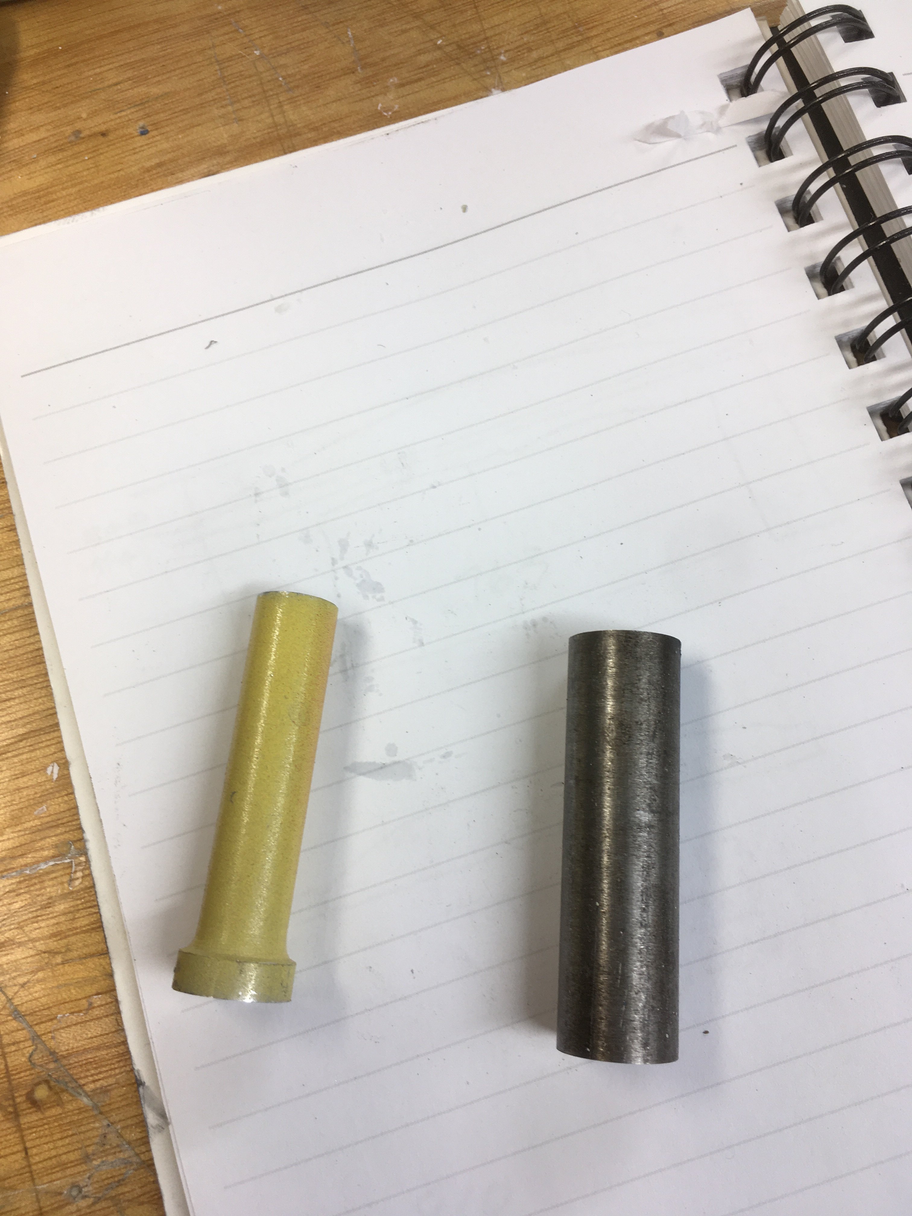

Made new engine standoffs from 5/8" steel round bar, each one is 2 ounces heavier than the aluminum version. Added 12 ounces of shot to the cowl and made two 8 ounce pucks from epoxy and shot formed in a 4 ounce applesauce container. I save the containers as my grandsons eat the applesauce, think I got 6 on Friday. They are really handy and the epoxy pops out after it cures..
