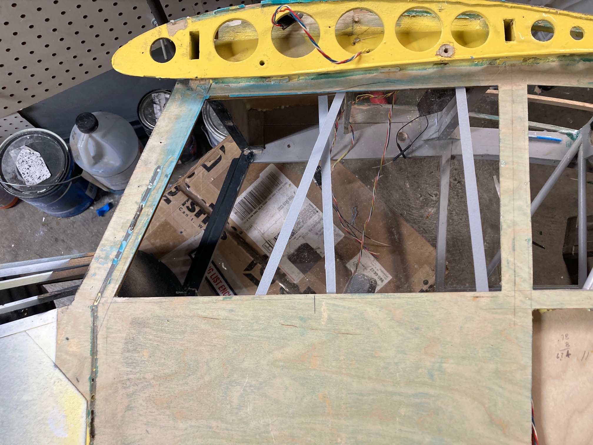

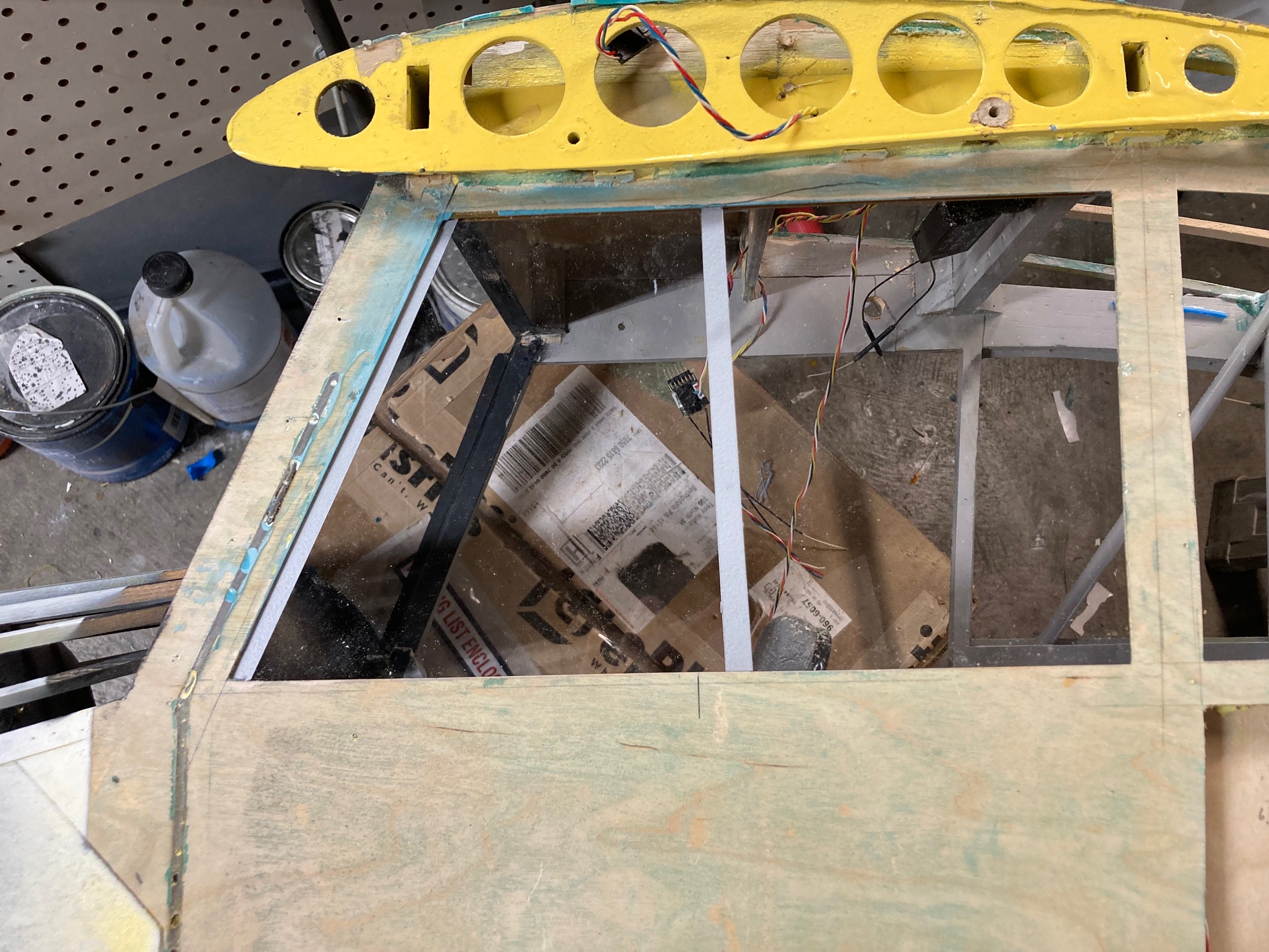

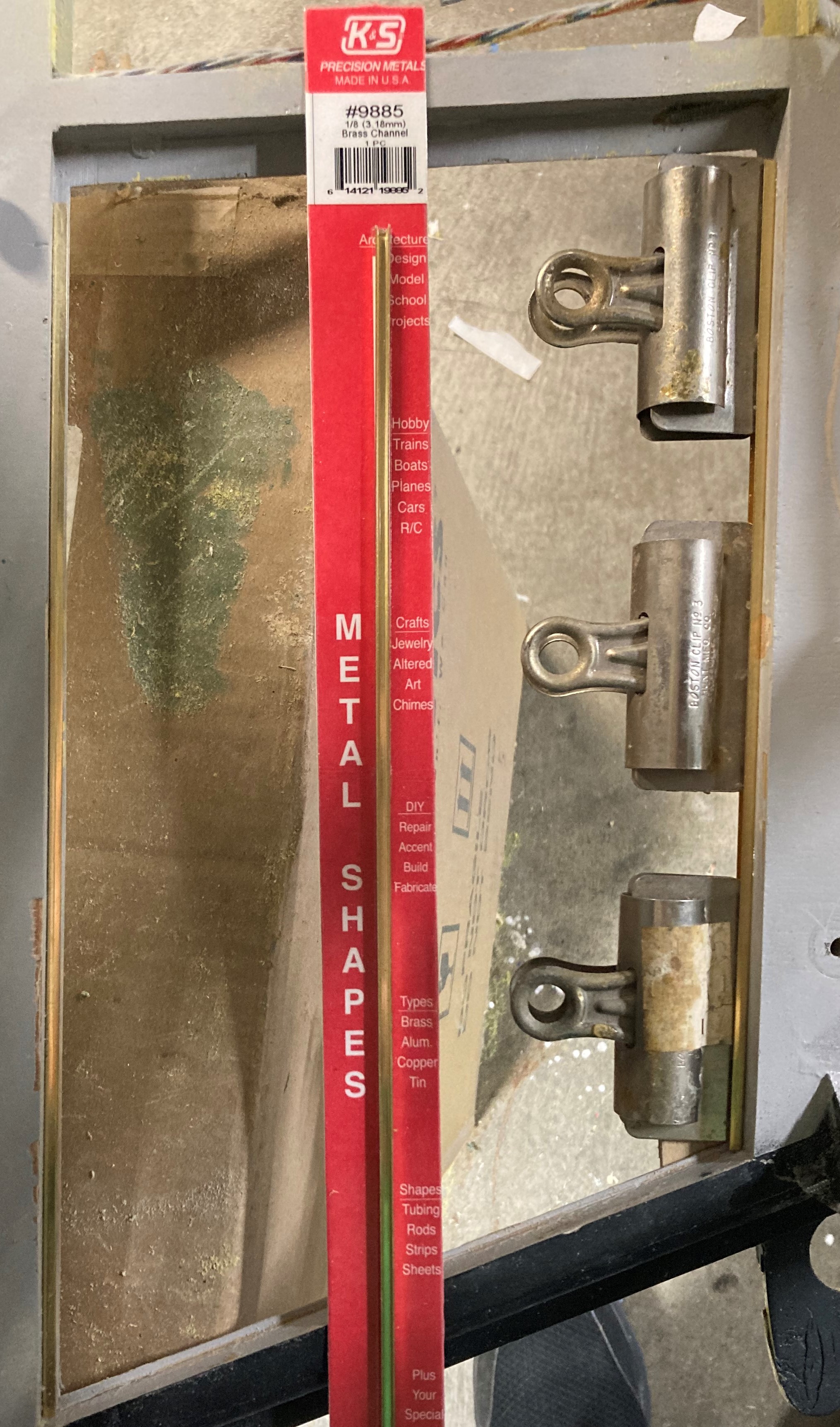

Found a little time last night to work on the Champ. The original plans showed a 3/8" wood dowel at about the midpoint of the left front window. After reviewing several full scale photos it was determined that is actually the frame for the front sliding glass. While going over the plane I decided to make left front window movable. Using KS 1/8" x .017" channel for this. This mod will add about 10 grams net. Haven't decided how I will make the aluminum frame on the windows, thinking paint.

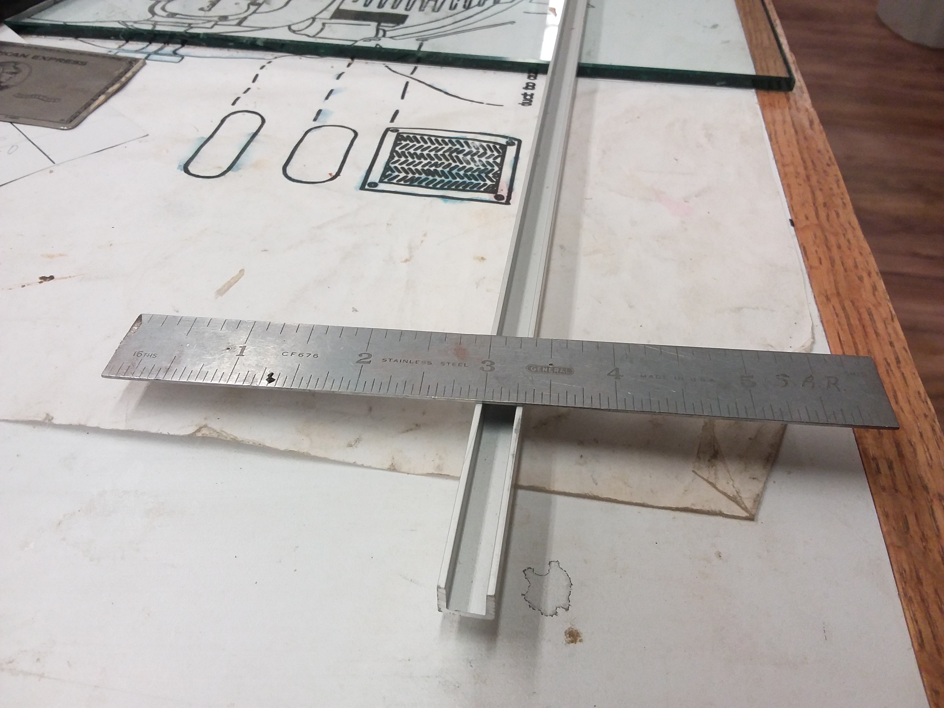

Tony, I have 3/8 aluminum channel if you need any. I ended up with a 6 ft piece from McMaster-Carr.

Thanks but that's way too big. The channel I used is 1/8" square with a .017" wall, I think it's going to work out just fine with .040" thick windows. I have .040" polycarbonate sheet (Lexan) that I had tried to vacuum form a windshield for the Champ, this will be more scratch resistant than PETG used in the past.
I may try to vacuum form the polycarbonate again, I did more research and I'm pretty sure I didn't have the sheet hot enough. I have since added a P&ID controller to the oven I now have temperature feedback, before it was best guess.
