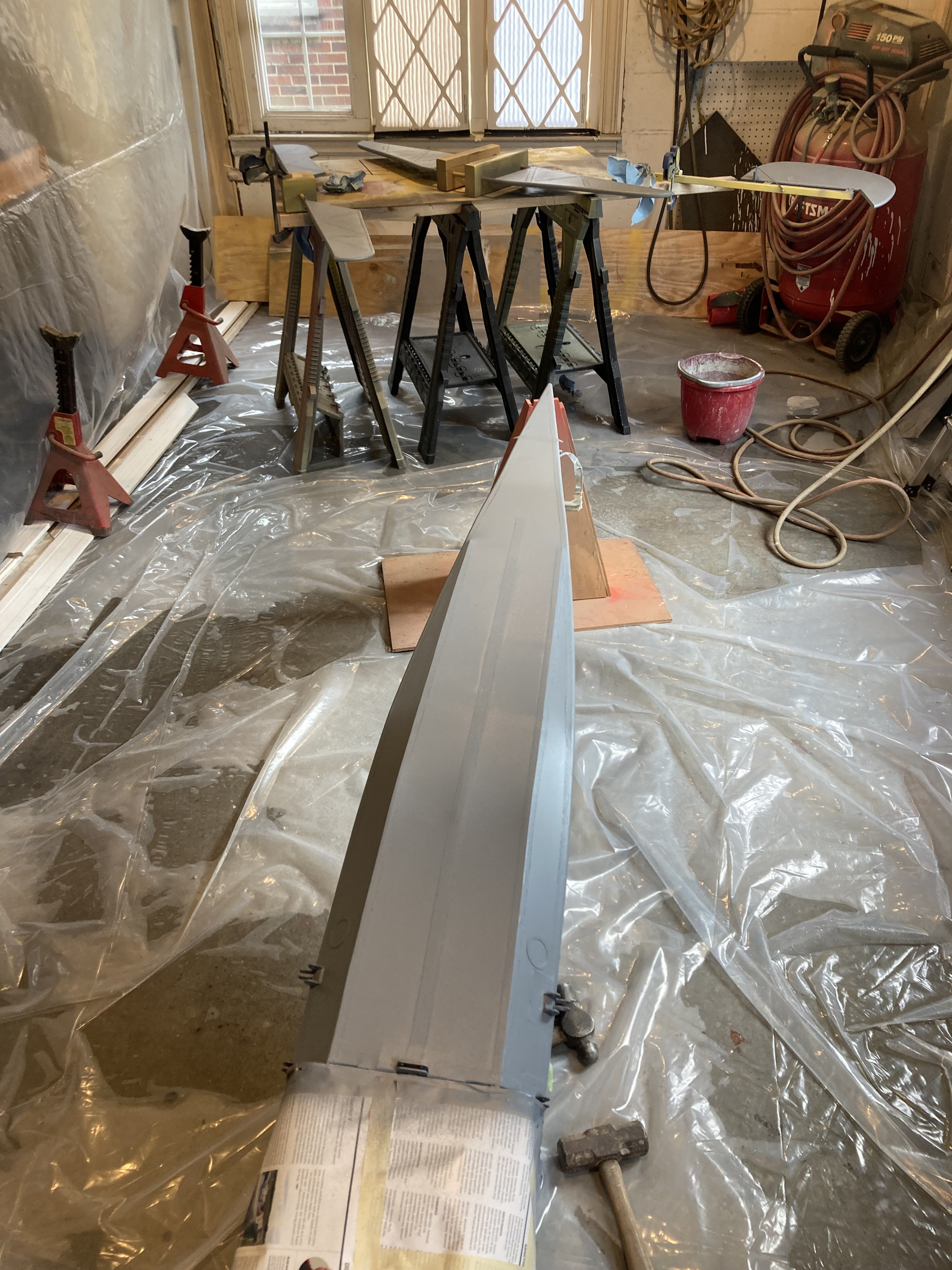

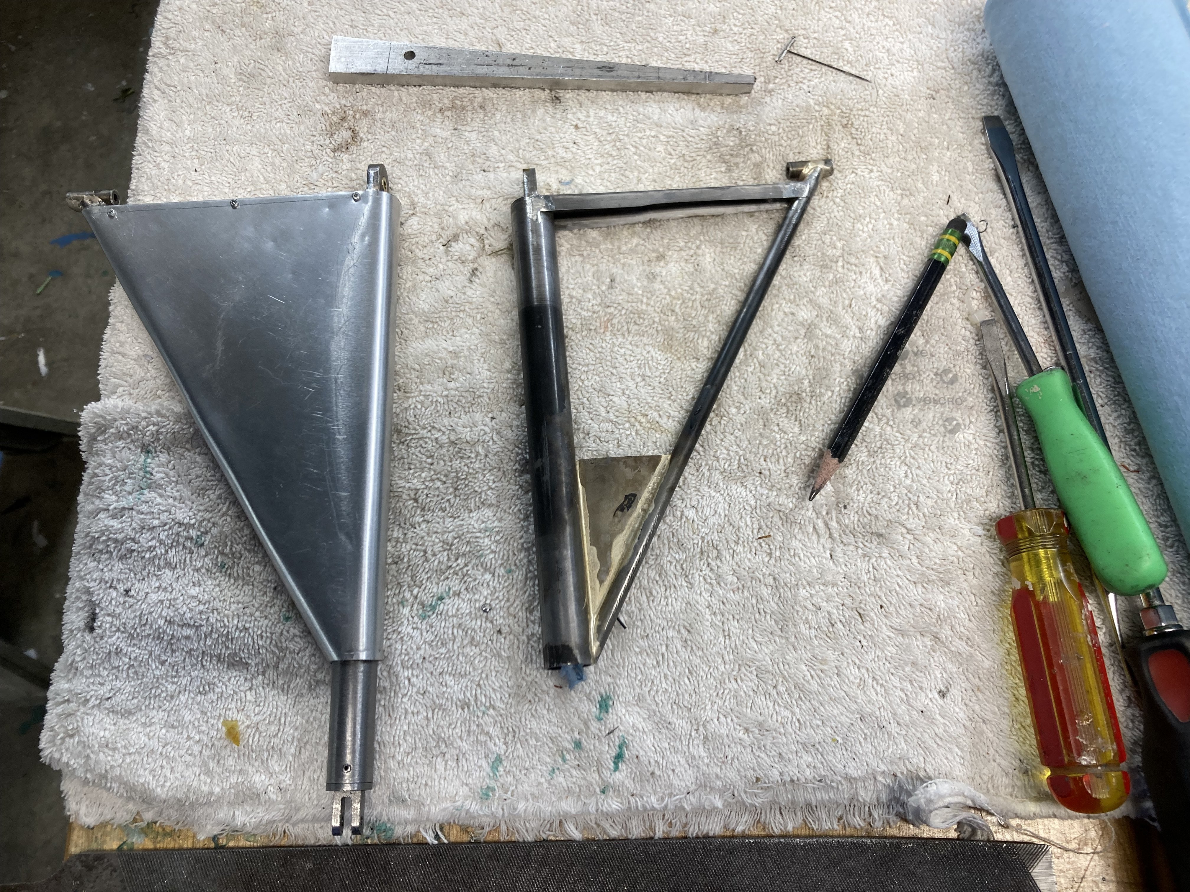

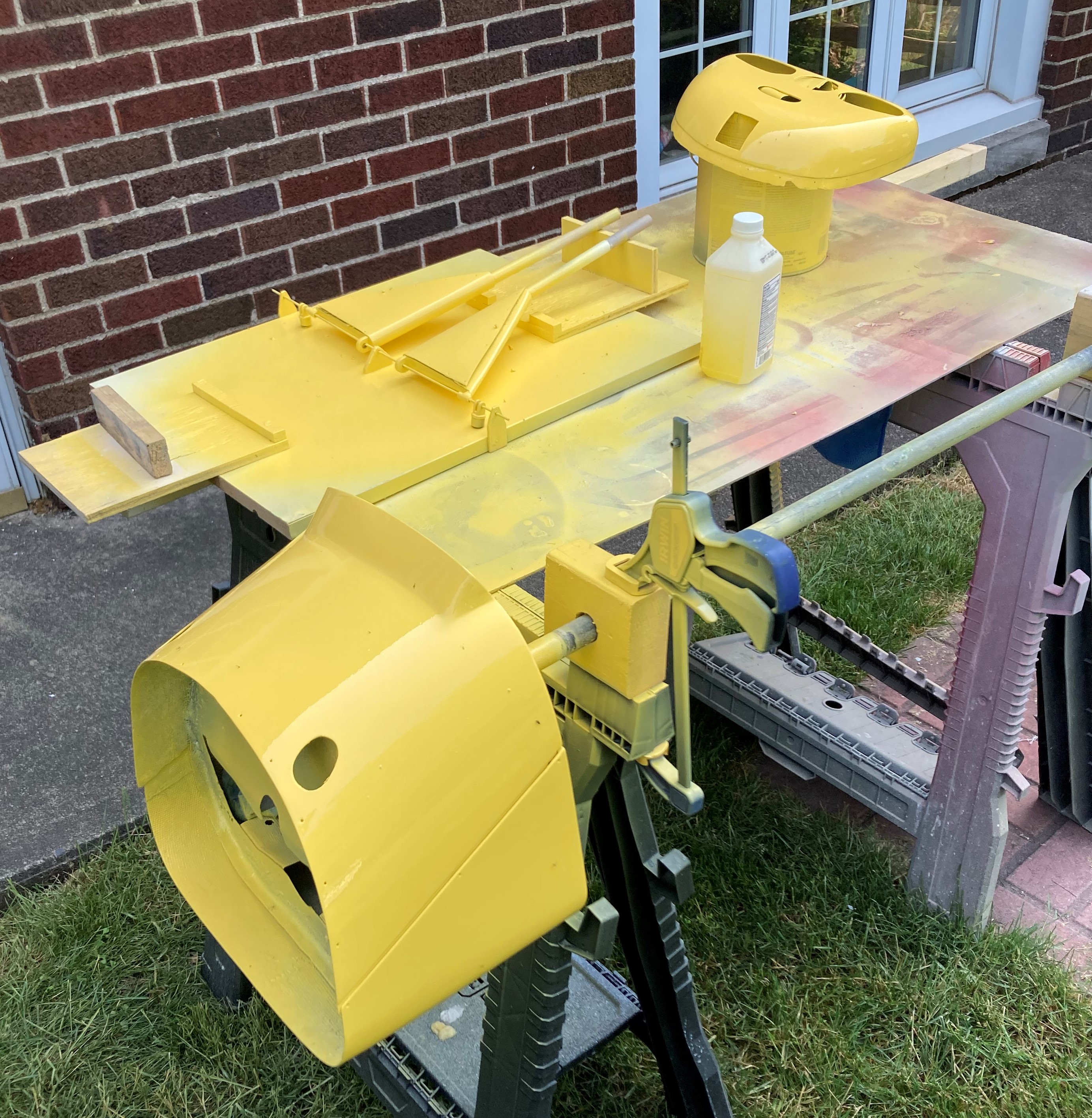

In keeping up with dhal22 decided to work on the landing gear struts. The full scale struts are covered with aluminum sheet. Most of the photos I have looked at show that the covers had one form of ding so I wasn't too careful while I wrapped the aluminum. The top rail was added to attach the top of the cover. I milled an aluminum shoe to form the tin plate rescued from an empty acetone can, it is .012" thick. The rail is soldered on to the strut with Harris Stay Bright silver bearing solder. It took two soldering irons to get everything hot. I used double sided carpet tape to hold the aluminum sheet in place while it was formed around the strut. I have the paint on order and the weather is finally getting to the point where it will be safe to paint. I've been dragging my feet getting this thing done and painted. Keep thinking about building the Cherokee plug.
