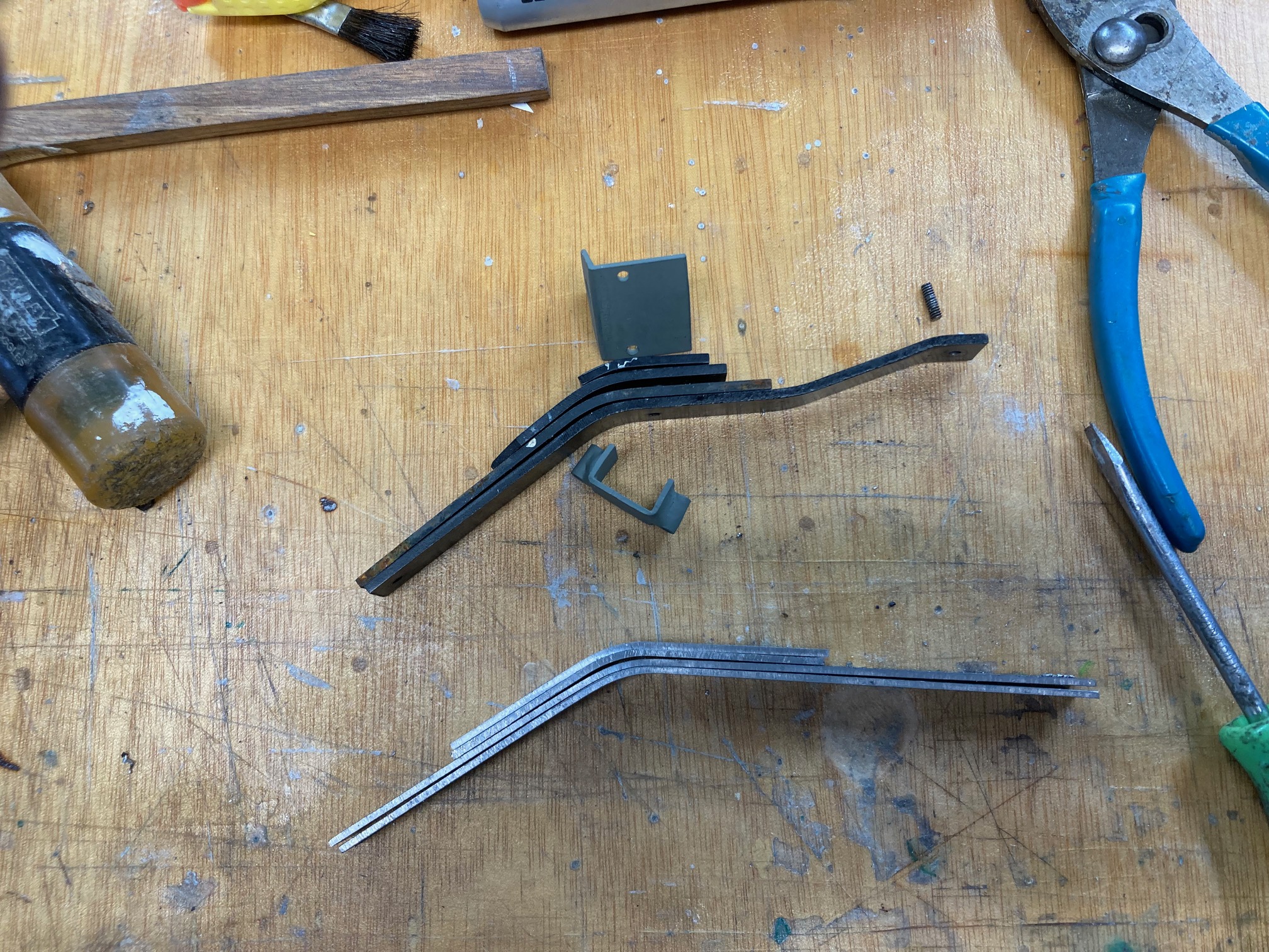

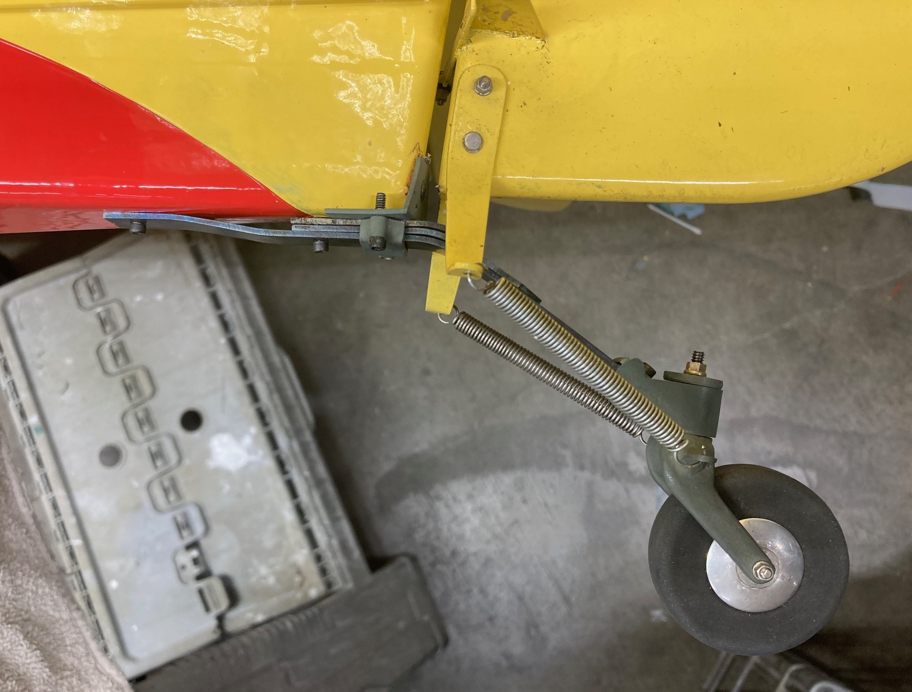

While working on the tailwheel decided to replace the spring as well. The original was made from the plans however the spring was too stiff, no spring action at all. The original springs were made from 3/32" thick 1095 steel, the new spring will be 1/16" thick 1095. The spring will need heat treated after forming and drilling as it is received in the annealed state.

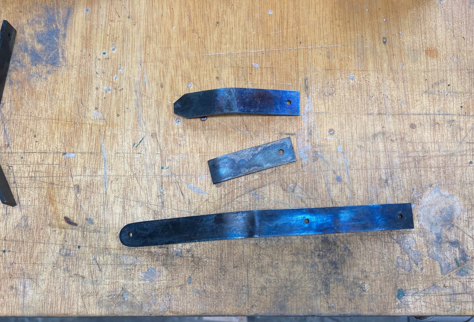

Hardened the leaves with the acetylene torch, heat up to cherry red then quench in water, then temper the leaves to 500F in the kitchen oven for 2 hours. The leaves came out nice and blue. The original had four leaves, one was eliminated and the spring action seems good.

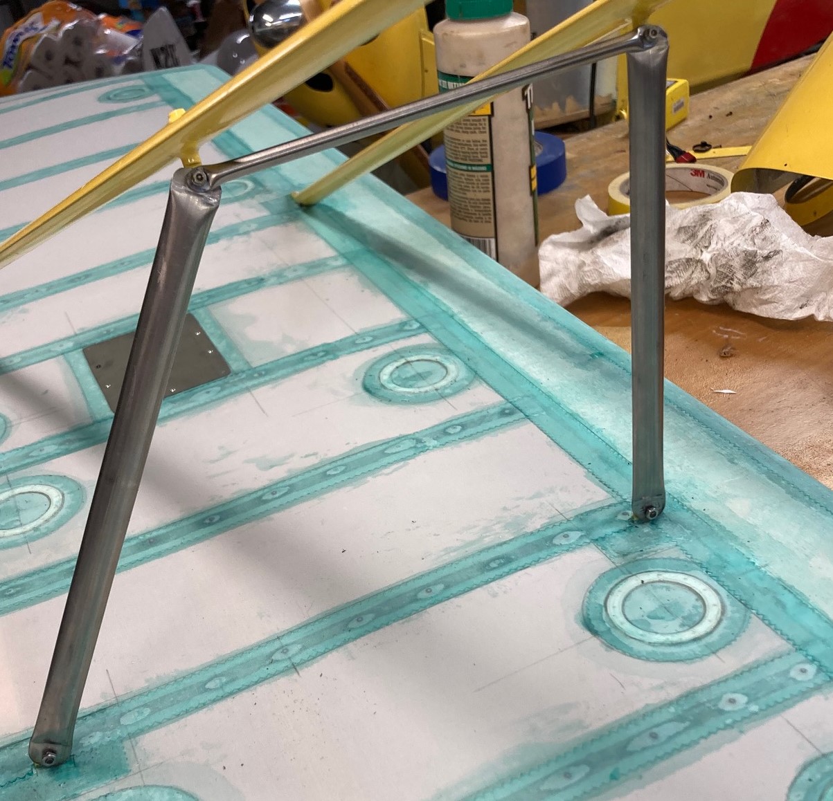

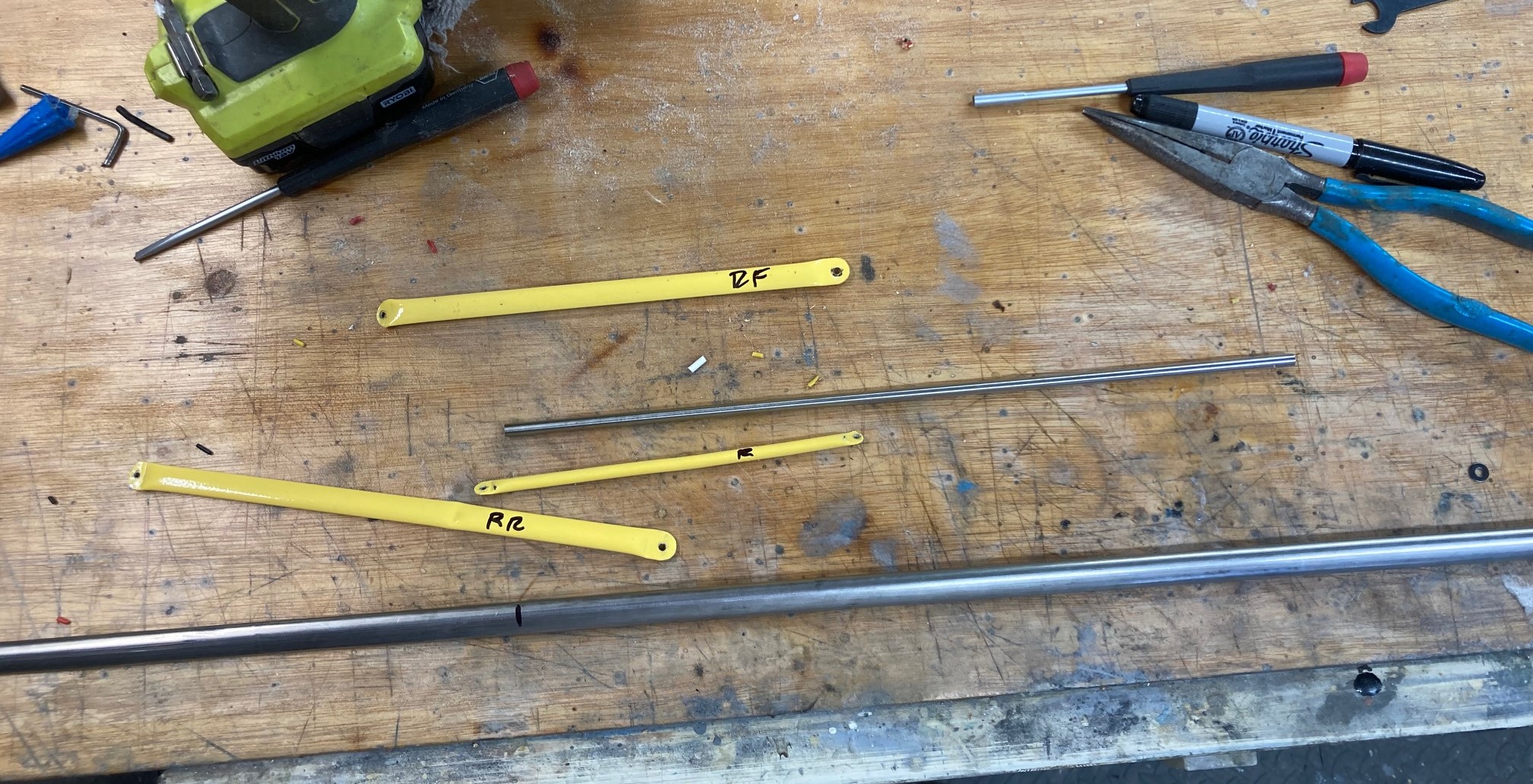

The SS streamline tube arrived from Toni Clark, took about two weeks from Germany. It is slightly larger than the K&S aluminum tube. The aluminum tubes bend very easy, the tube on the bottom has a crease in it. Got enough tube to replace the jury struts on the Super Cub as well. I like it!
