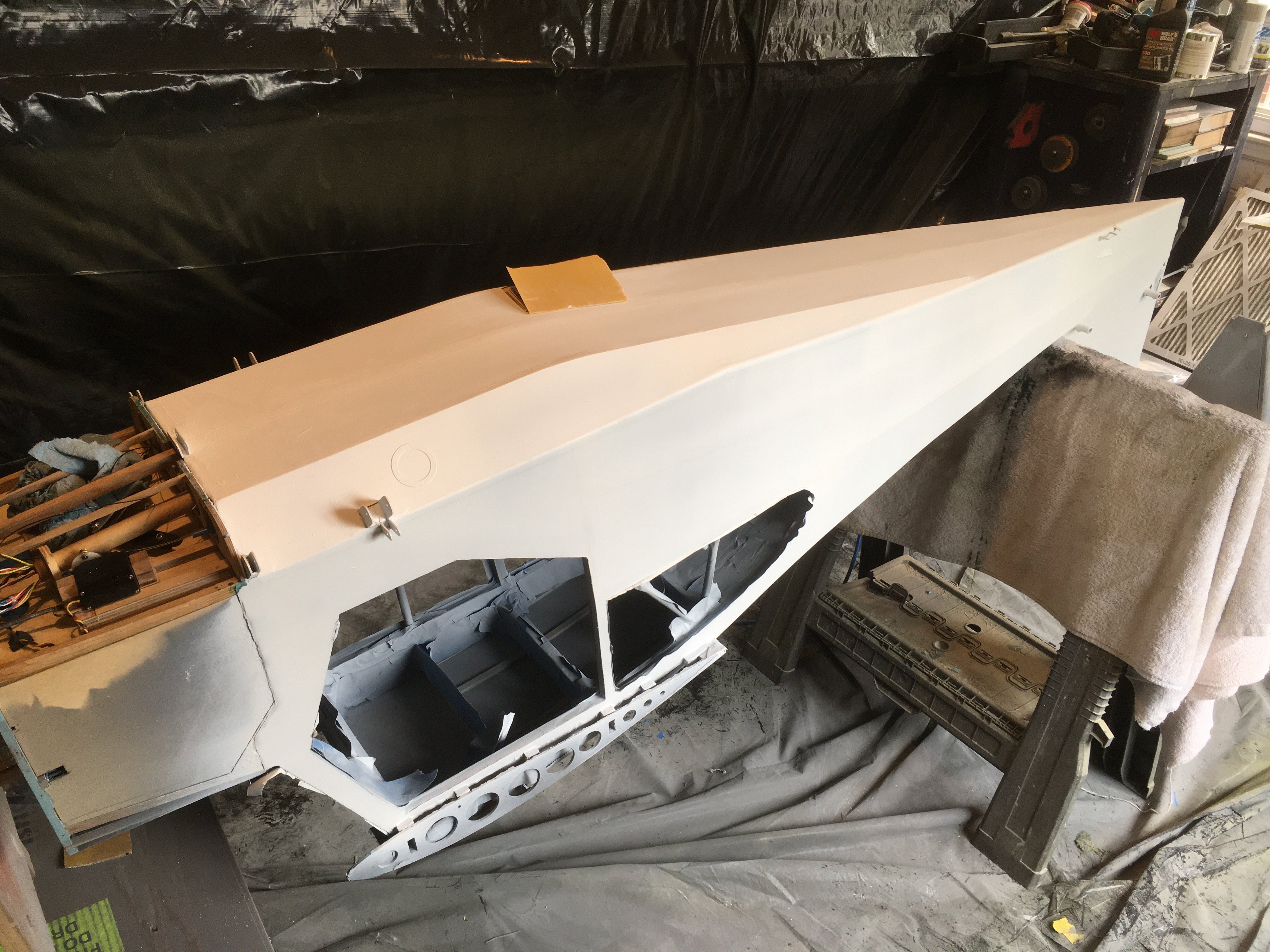

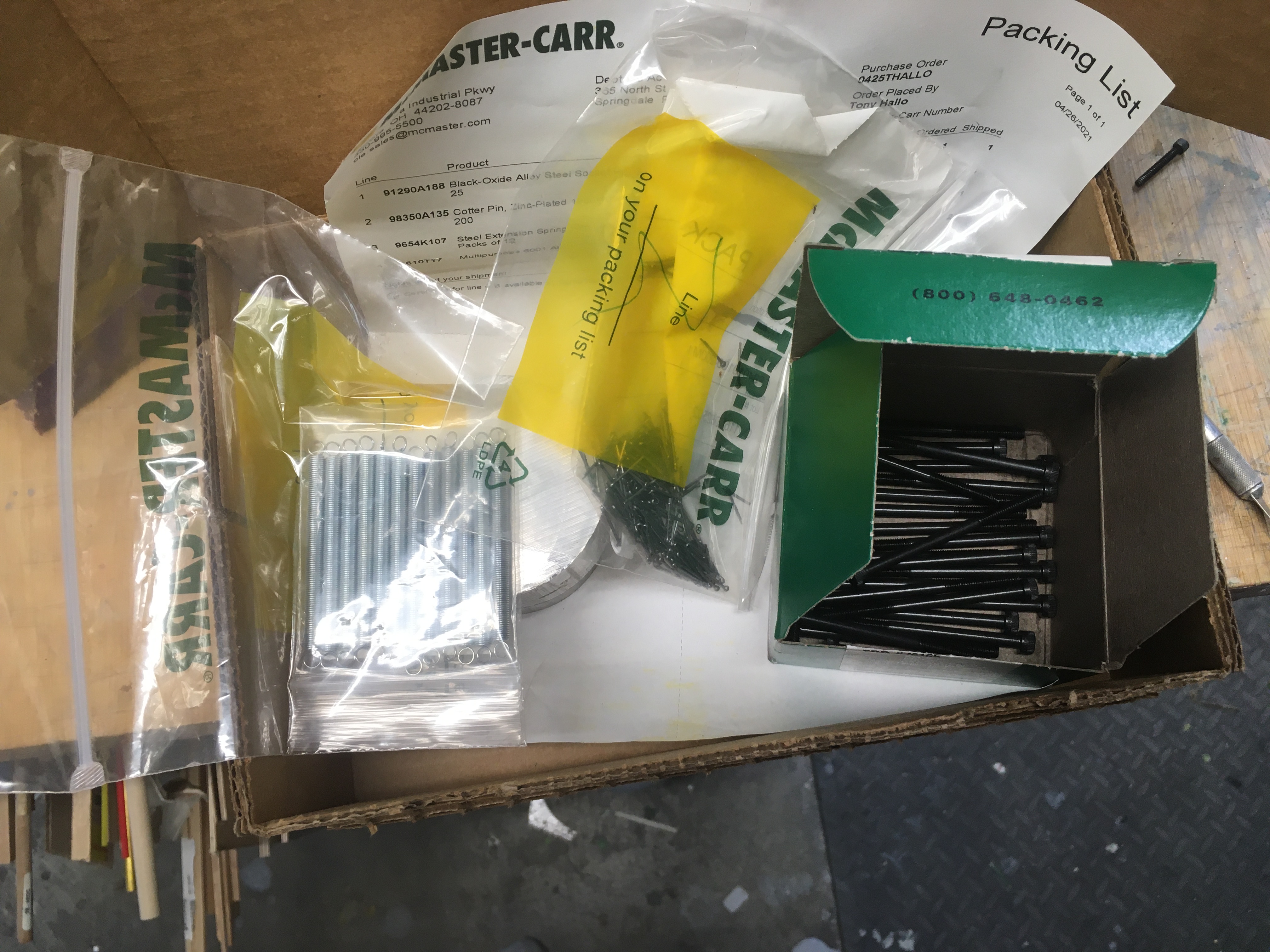

Got a couple of deliveries yesterday, the white Ekoprime arrived and I sprayed a coat this morning, a little sanding with 320 and it will be ready for color. Also received a shipment from McMaster Carr, longer bolts for the prop and heavy hub, 200 1mm cotter pins ( already lost a few for flying wires!), aluminum disc to make the second hub cap, and springs for the tail wheel ( might need a slightly bigger diameter).
I need to put a transaxle in my daughter's car tomorrow so I don't expect to get any painting done so hopefully Friday or Saturday, weather looks better on Saturday. I got enough work to keep busy. I'm starting to feel good about finishing on time, can't wait to run the Roto 85FS.

In between coats, hopefully the next will be the last. Drying a little slow today, on the cooler side. Orange on Tuesday? Need to mask the wing for the N numbers. I had masked off the area where the orange section is at, never done it this way before, always painted the base color then the trim on top, hopefully I can follow the line without showing any white or large hump, we will see. Didn't want to add any more tail weight.
