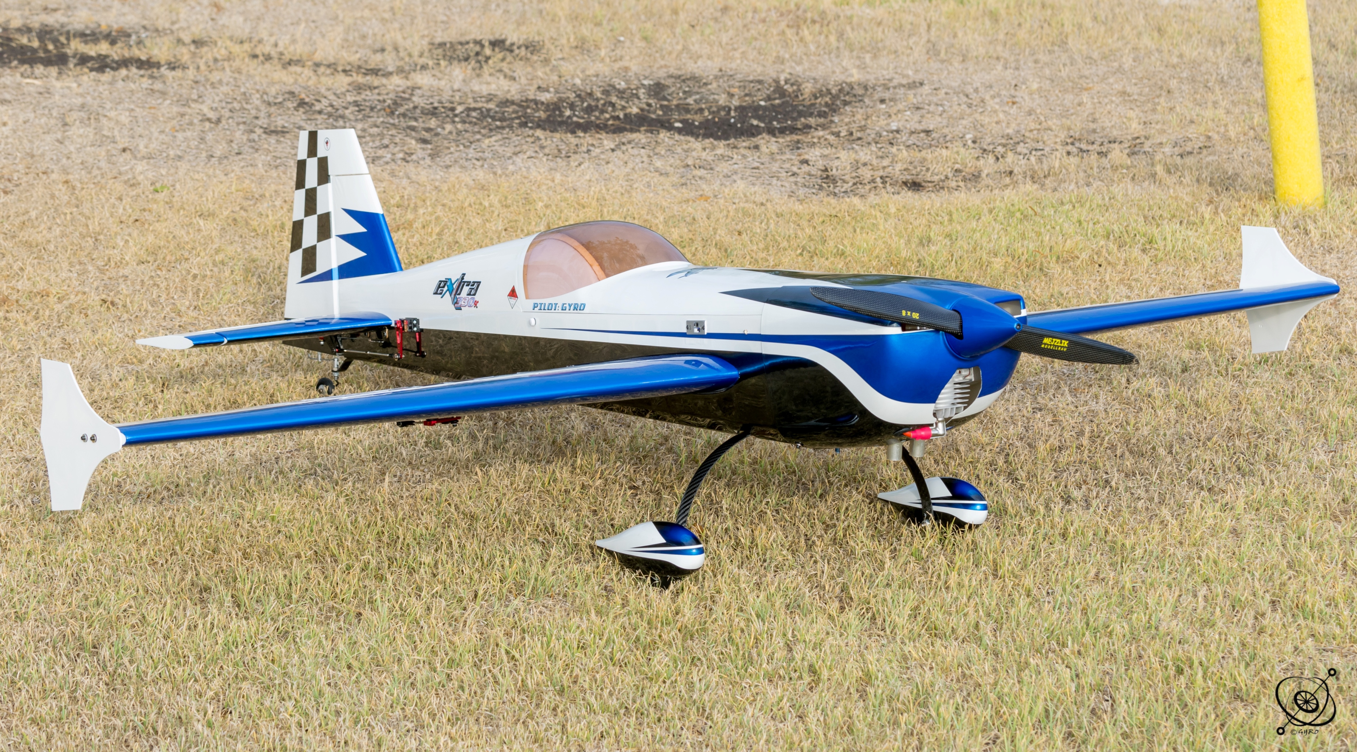

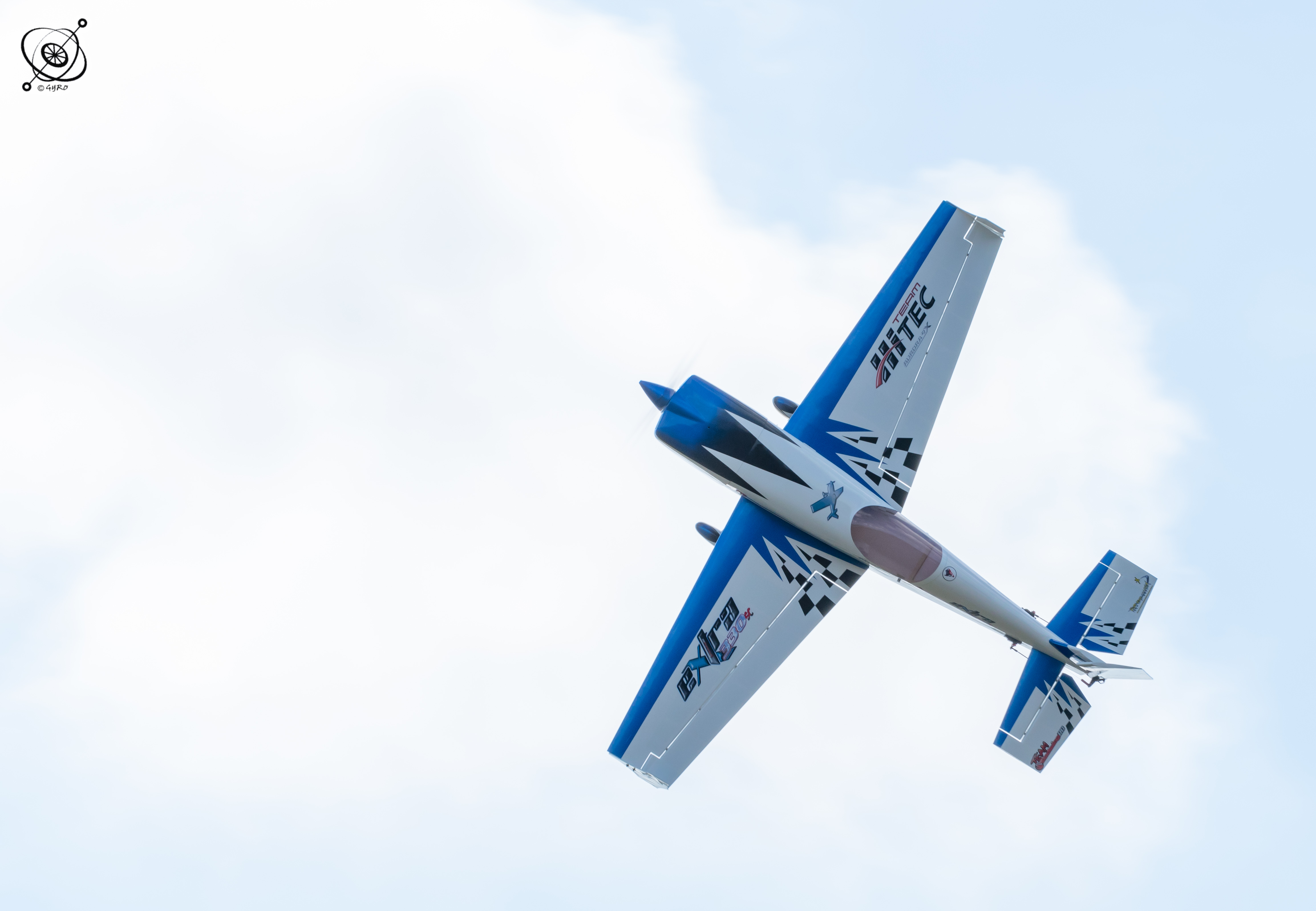

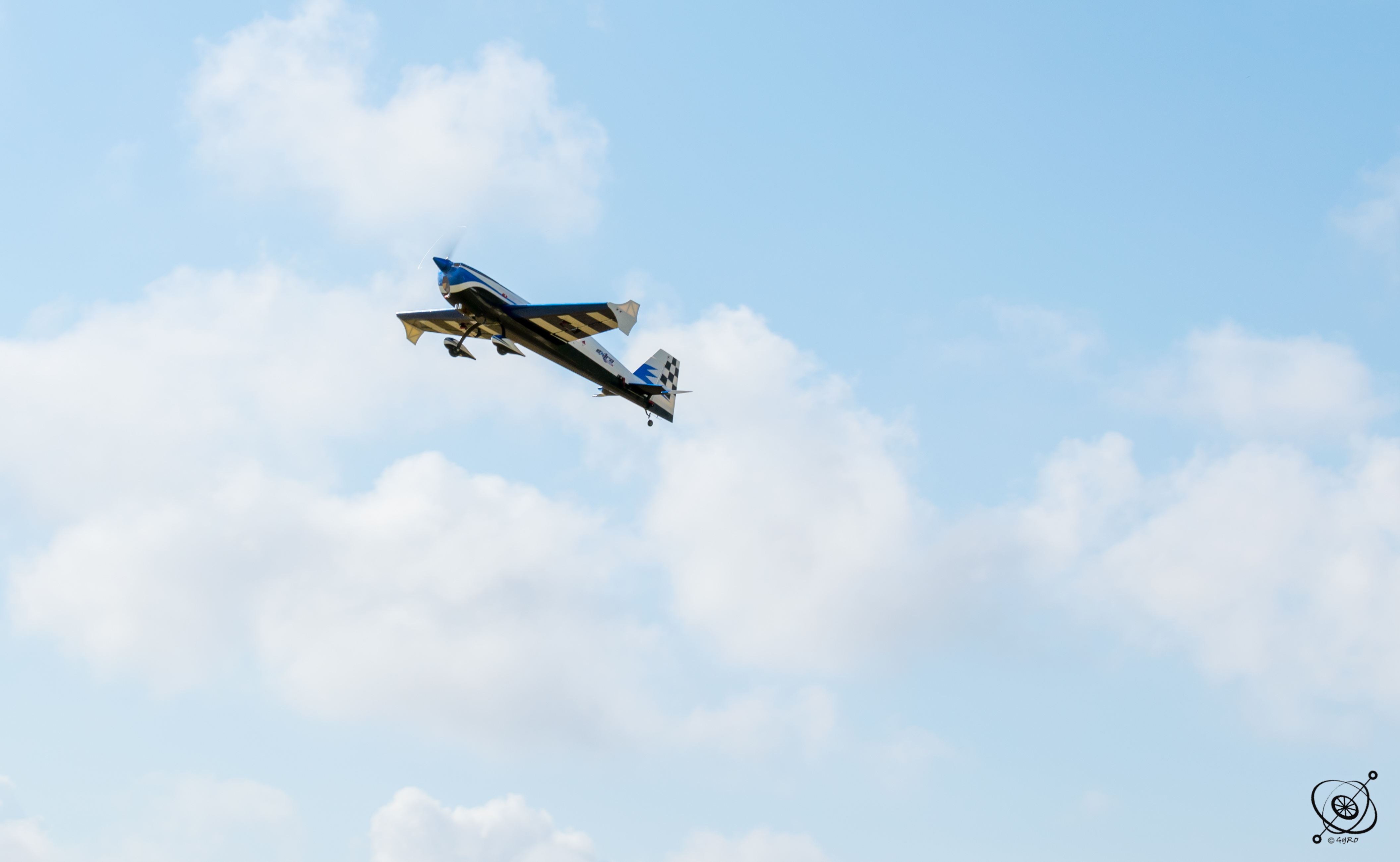

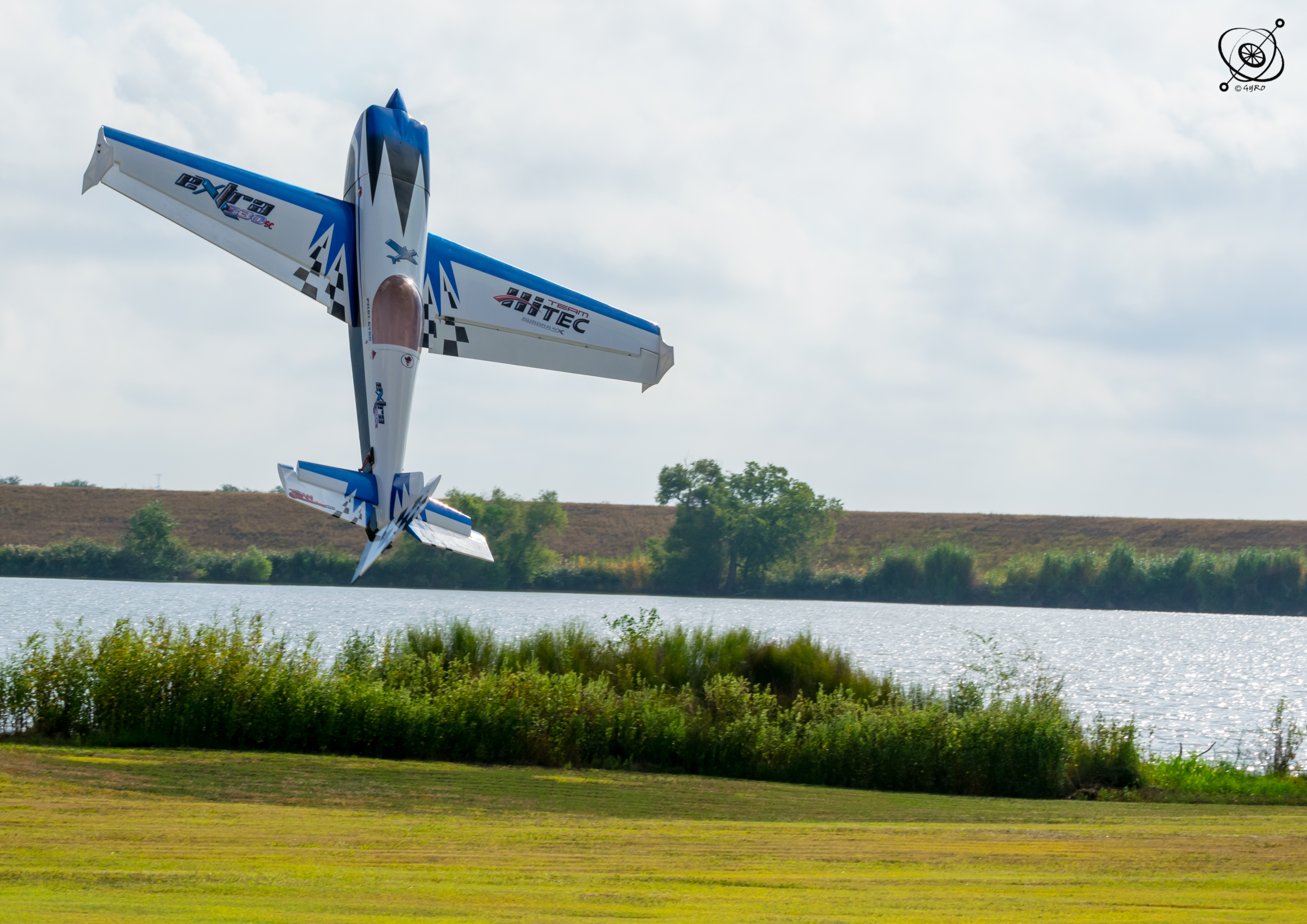

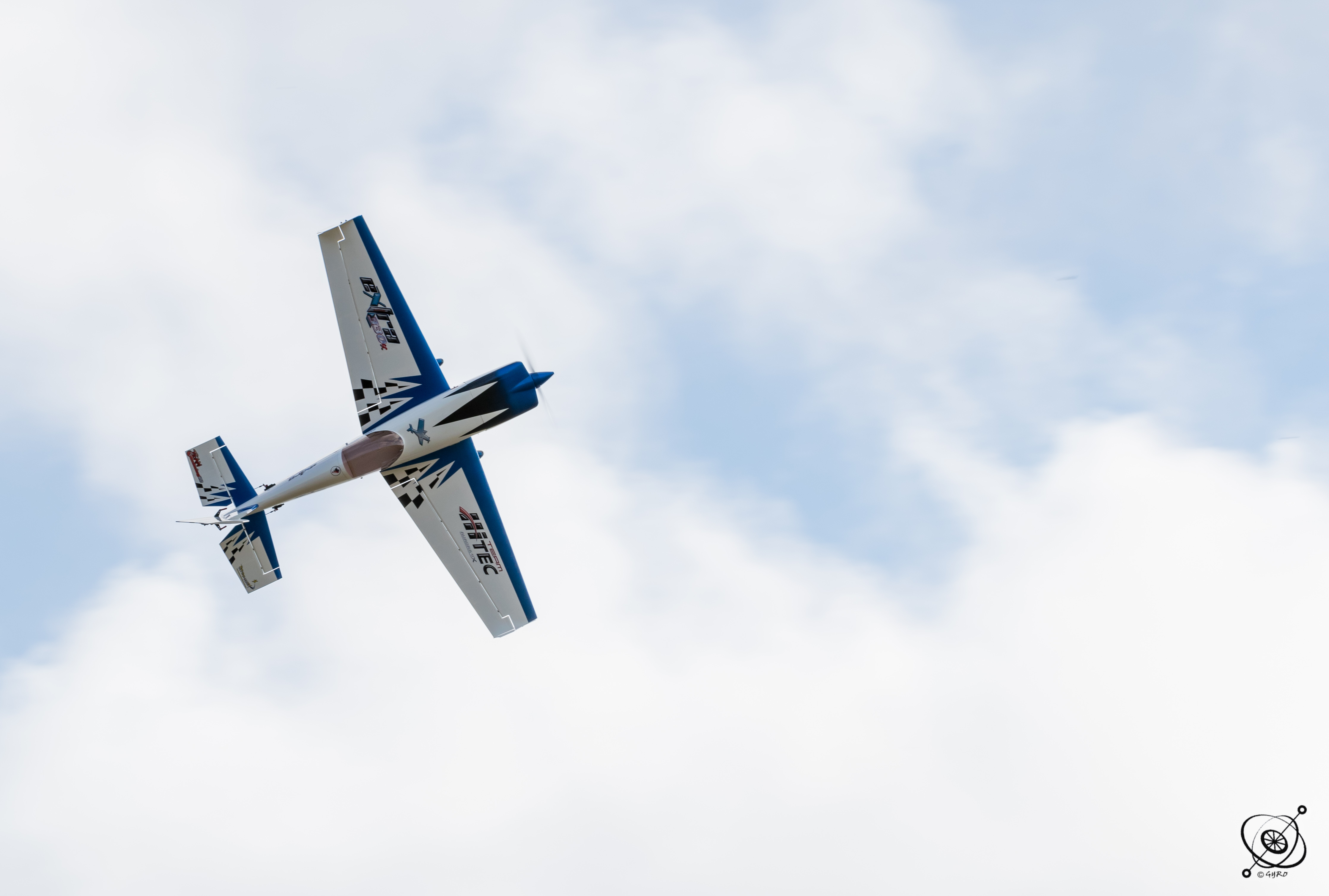

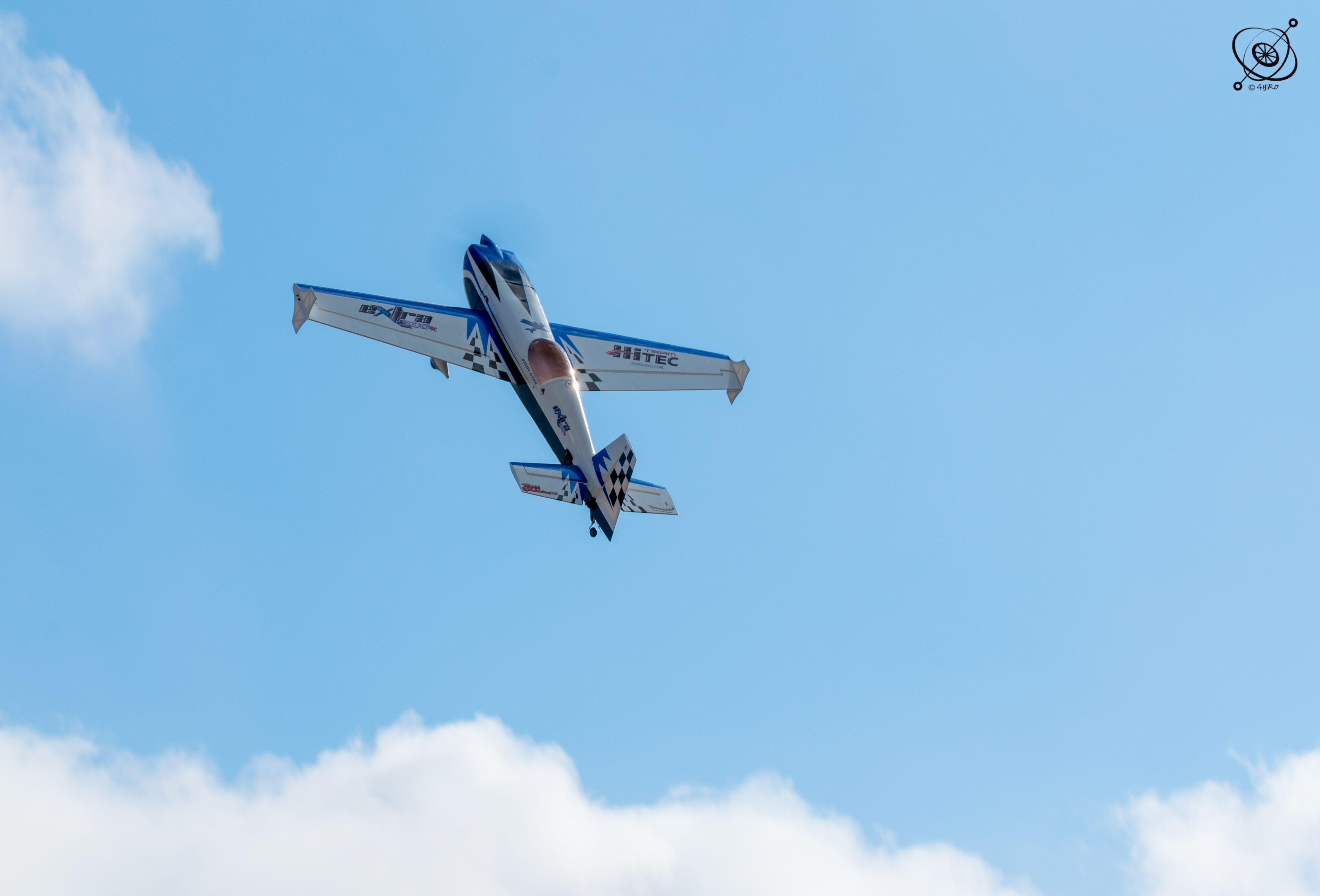

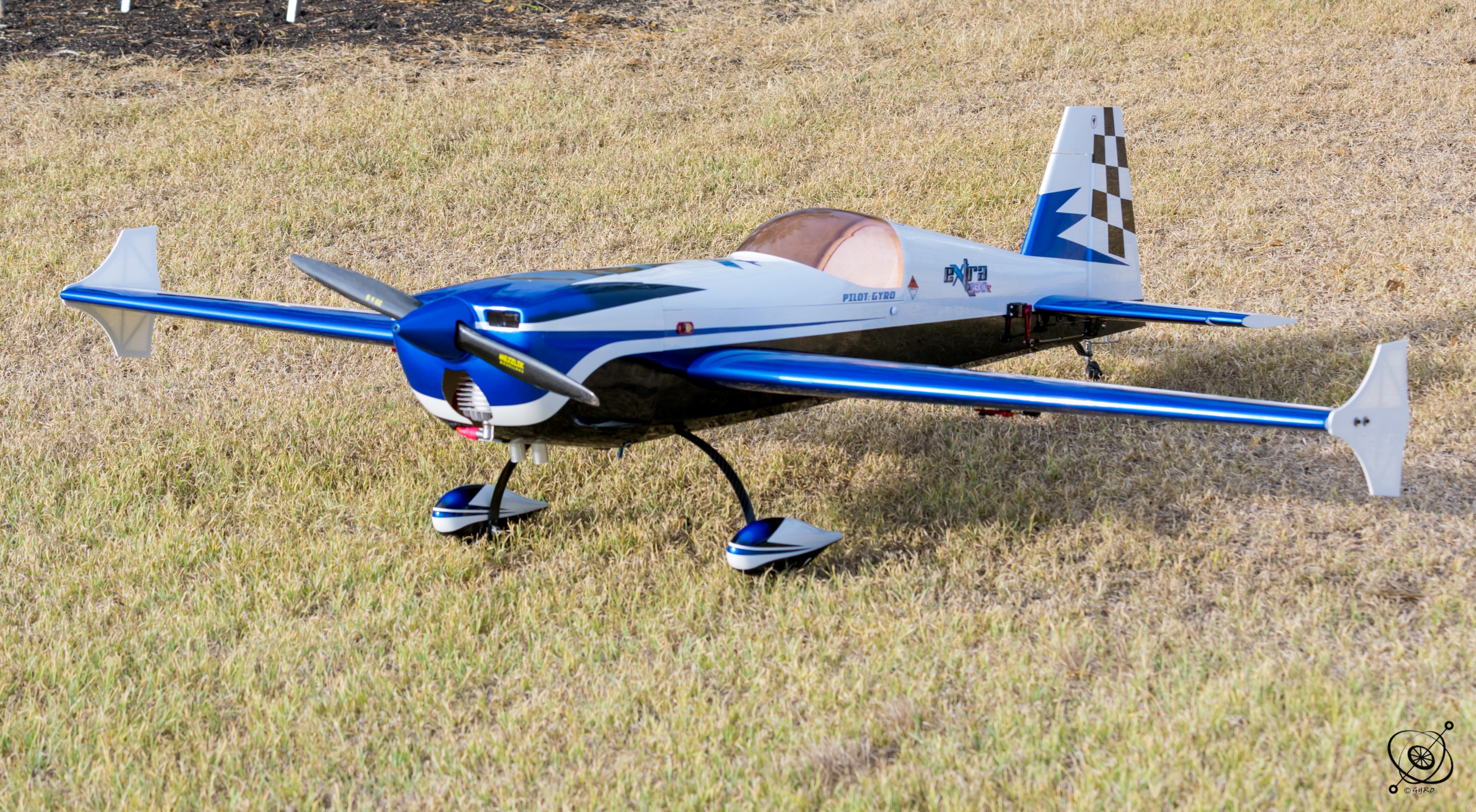

got a few pretty shots of mine today!
Had to adjust the thrust a bit and give it a touch of UP thrust and now it's REALLY smoothed out!!! VERY VERY fun plane! END over END waterfalls at high speed. Does insane knife edge spins
View attachment 29402View attachment 29403View attachment 29404View attachment 29405View attachment 29406View attachment 29407

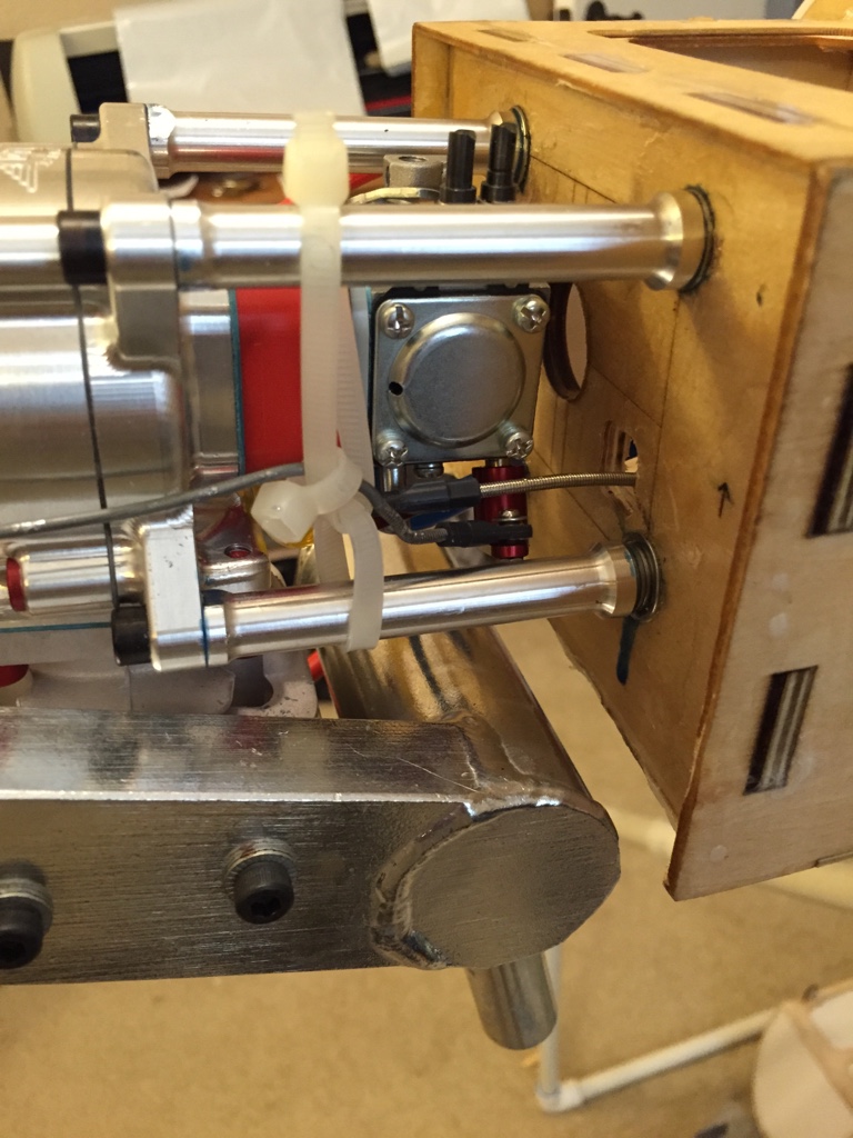

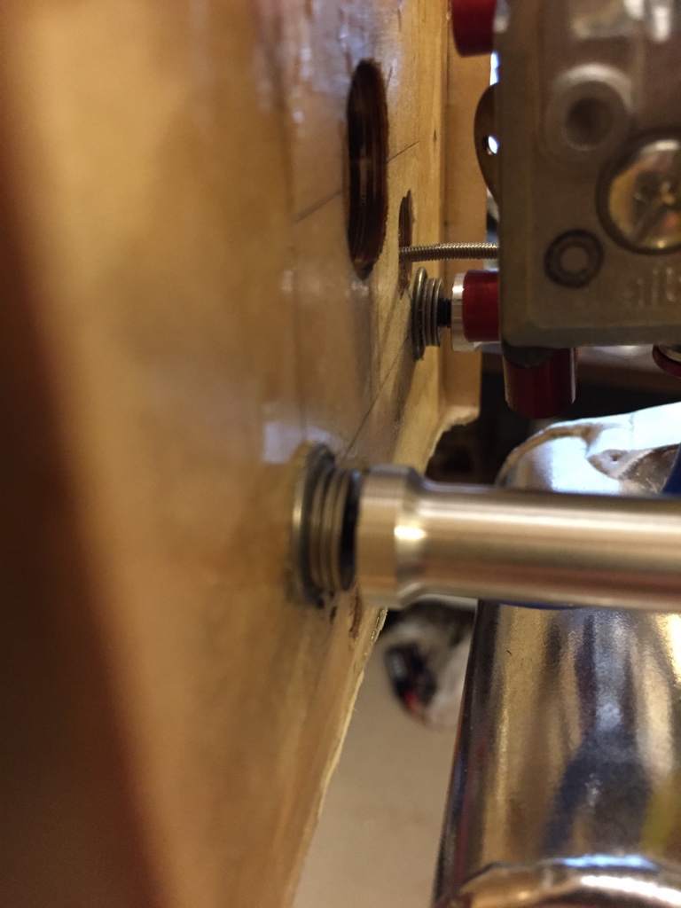

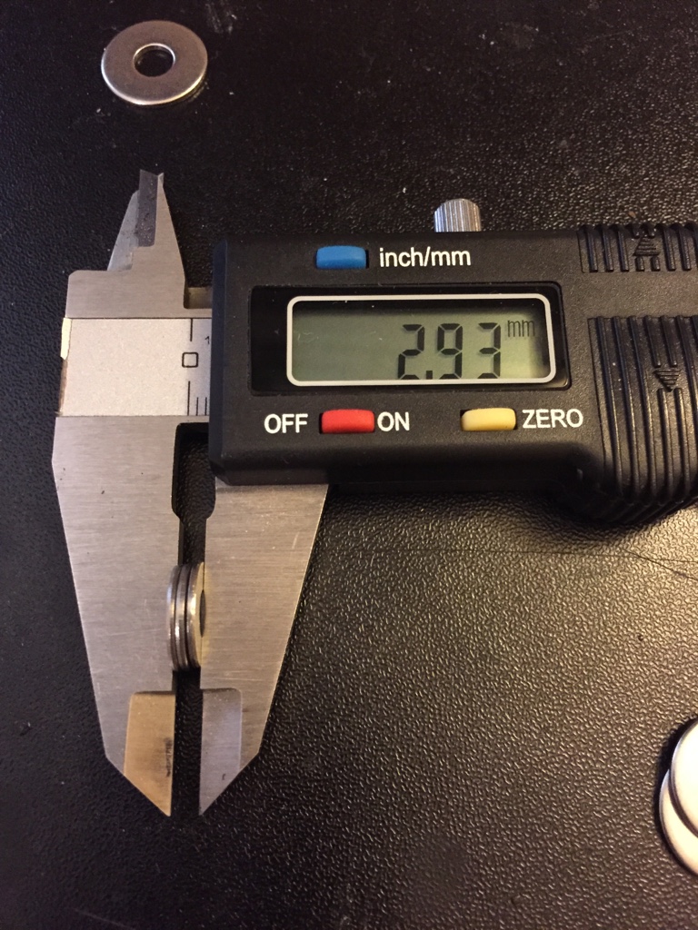

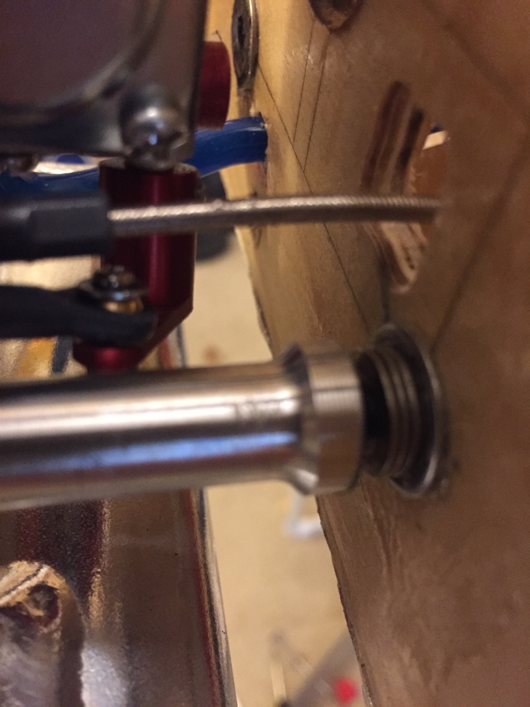

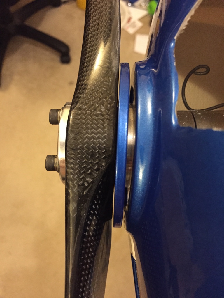

The up thrust was an experiment by myself and Tim at redwing to improve performance on the plane. Redwing is in the process of issuing a service bulletin and instructions, but the short version is adding 2 degrees of up thrust really makes the plane fly even better than the original design.
To do it, add 3 small washers on the bottom motor mounts where they meet the firewall. You may need to also shim the cowl to match.
I'll be adding a few more washers to mine (I've only got one on each side right now) and will take some photos of what I do.
So as you saw in the video, it flies fine with only a small improvement on the thrust angle, I'll get another vid as soon as the work is done.
